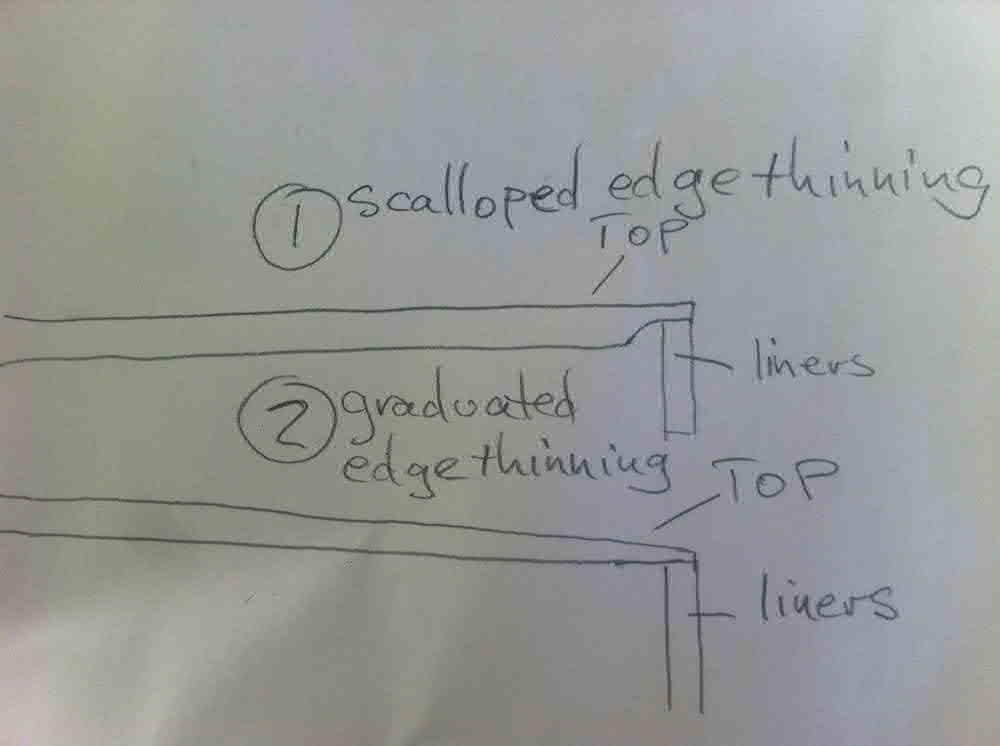

When I carved the soundboard, I experimented with a scalloped edge around the inside perimeter of the top for two reasons.
Firstly, I had this hair brained idea that scalloping the edge would minimise the amount of edge thinning post assembly, and that the scalloped edge would give a slightly larger area of the soundboard at full thickness. Taylor guitars do a similar thing with a routed groove.
The downside of this is that there is little control over the amount of edge thinning post assembly, for top tuning purposed. With the edge tapering method, the amount of spruce removed can really only be measured by the frequency drop, the flexibility change, and by measuring the thickness of the shavings as they come off the plane, but the thickness of the scalloped edge where it glues to the sides can be measured before the top is attached.
However the experiment is a total disaster because I failed to scallop far enough in from the liners, and the glue squeeze out has filled the void, thus rendering the scalloping useless as well as preventing me from any dramatic edge thinning now the guitar is assembled.
The only thing I can think to do is either remove the top, which I don't want to do as it has been lacquered and the neck attached, or try and reach inside with some sort of tool and carve away the excess glue.
Moral: 1)stick with the old tried and true edge tapering method.
2)don't apply finish until all resonance tests are done with
the bridge glued in place, allowing for edge thinning pre lacquer.
Well, that's what I will probably do in future...

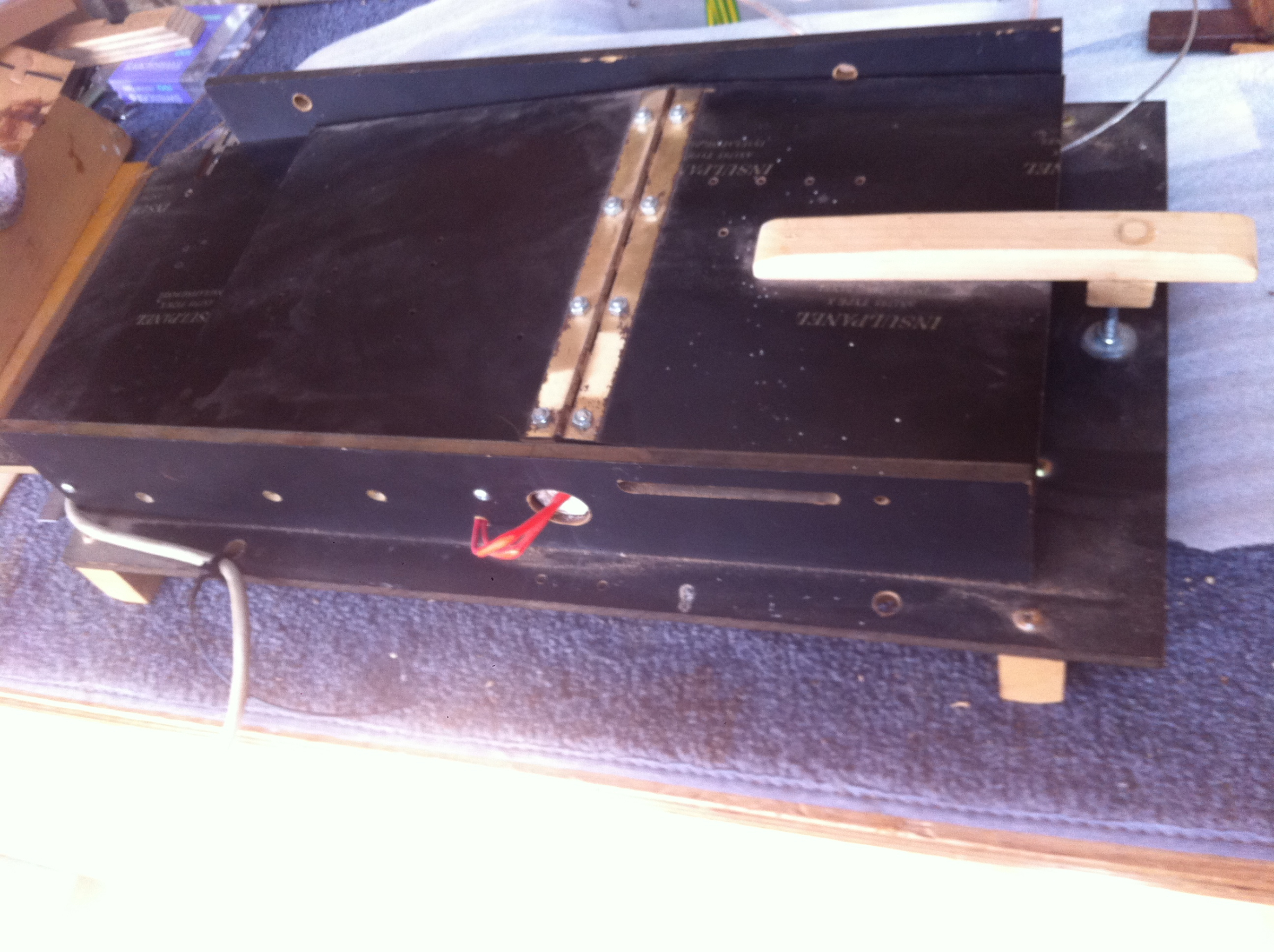

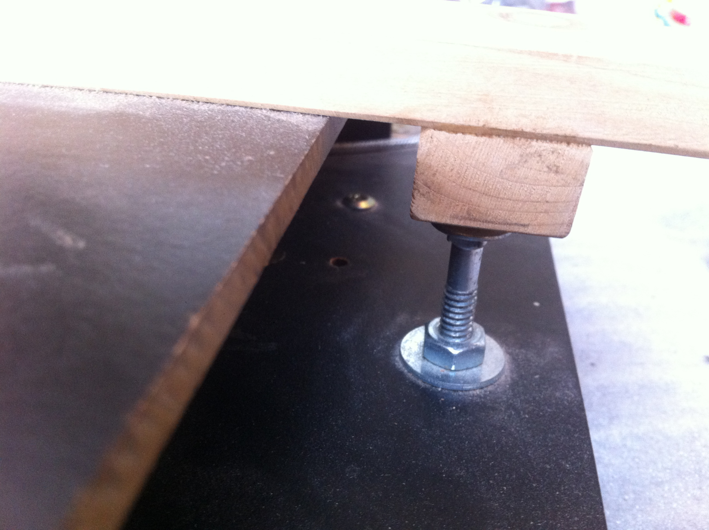

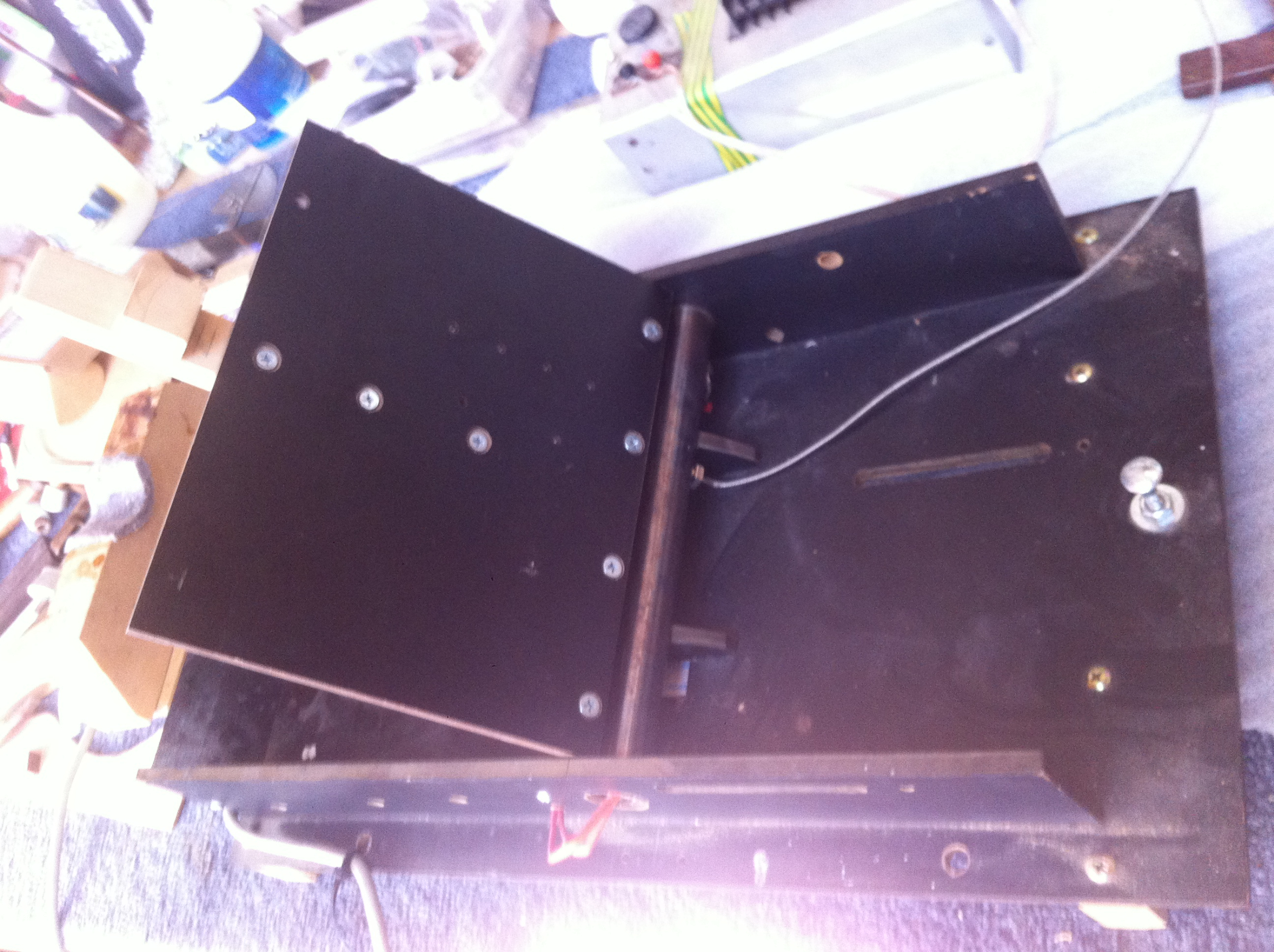

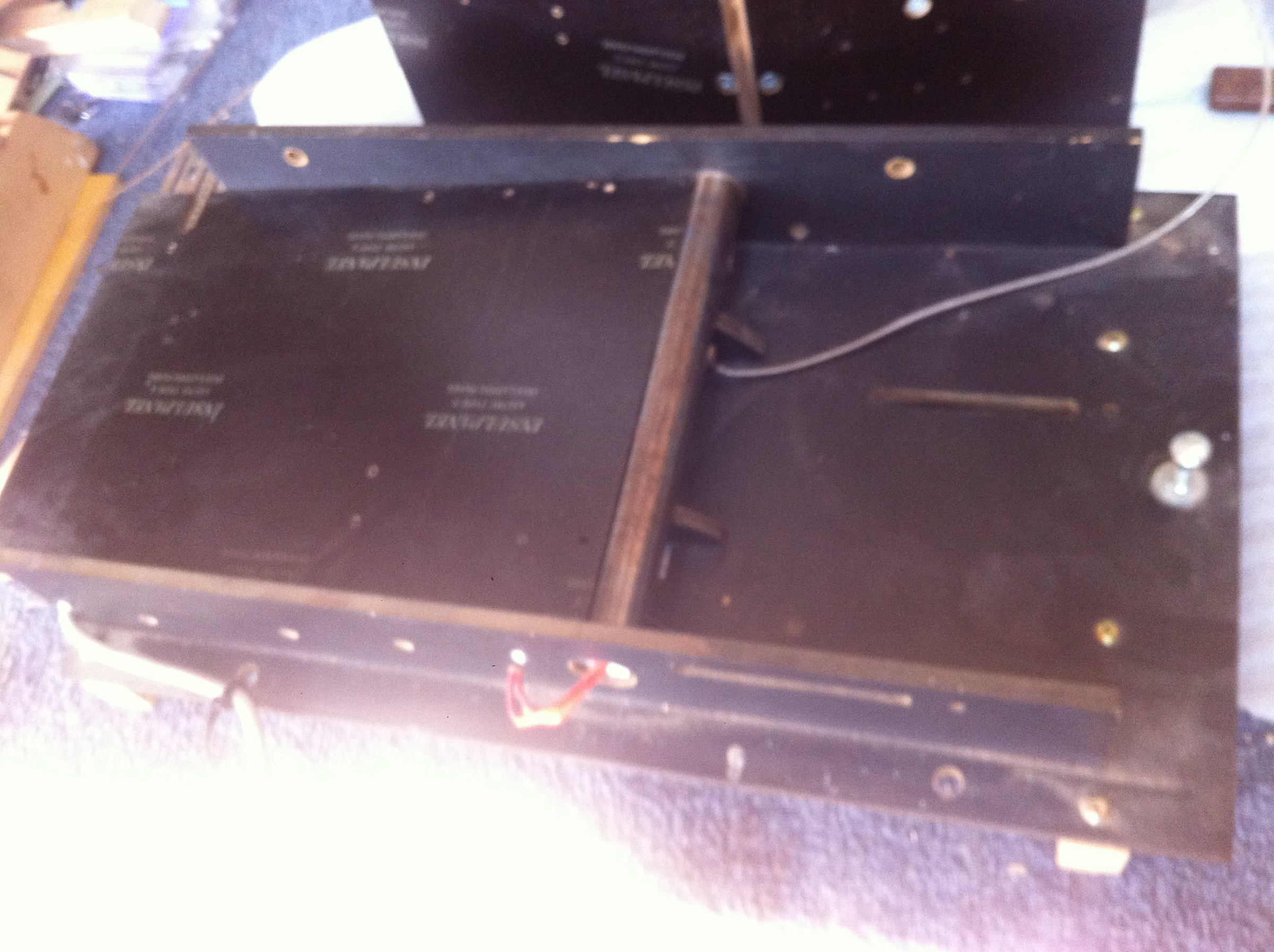

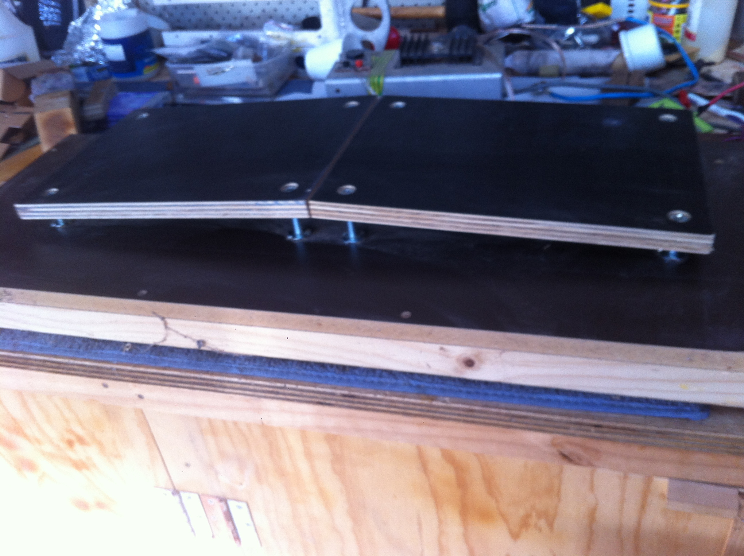

My pliage method. I have a shooting board which is angled in two planes. See pix
I made a bending pipe jig with elements in it which allows me to repeatedly bend to a set angle. It would be possible to make it work in two planes as well, so that the edges of the assembled board are not forced straight again but I don't think this is necessary as the original Selmers weren't bent that way. See pix. The pipe is a piece of stainless steel filled with aluminium, with 10mm holes drilled either end and Chinese bending iron ceramic elements(cheap). There is also a cheap Chinese pid control and sensor, all off eBay...The bolt adjusts to get whatever bending angle is required, in this case 6 deg as in the FCharle plans. I spritz the board and place it over the pipe then put the top piece with the hinge in place and hold one side down whilst pressing on the handle to form the bend
The joining of the halves can be done the Collins way, or with a jig like the one in the Selmer book, or with an angled jig a bit like the Collins one and a go bar deck and tape.

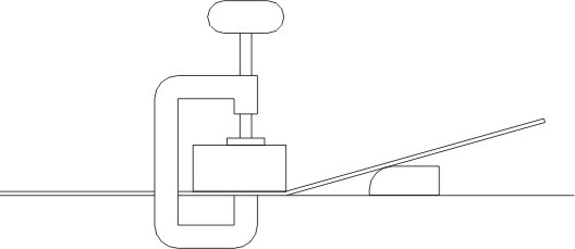

Thanks! Here's a little sketch of my pliage setup. I may have posted it before, but any thing worth saying is worth saying often
The only changes since this is the block at the bend has a 1/2" radius. The block forcing up the angle is now a wedge instead of a rounded block. I heat the top before clamping, now using a a heat blanket, but early on, I laid the pieces on my wood stove until they got nice and toasty.
