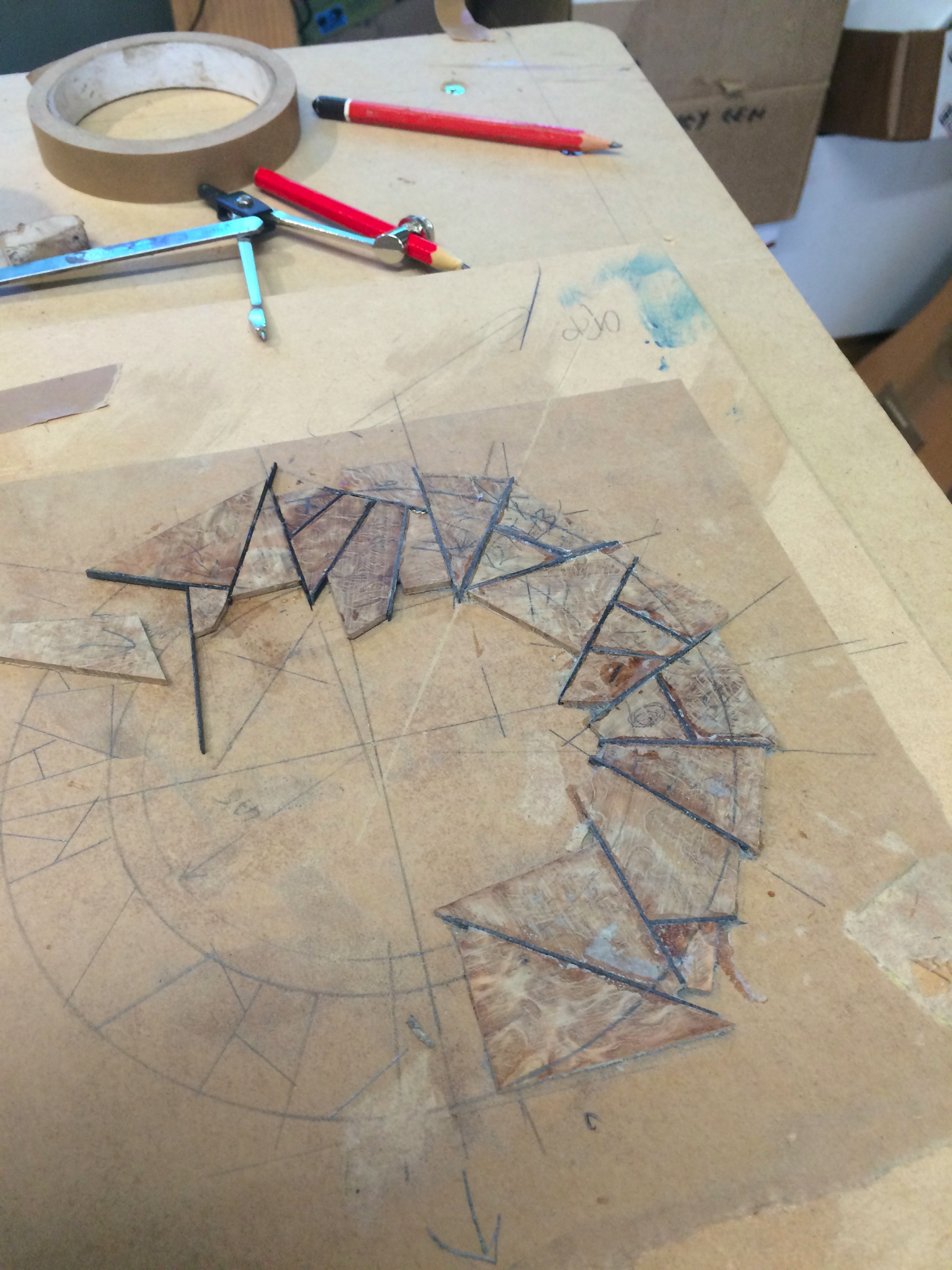

You can generally do without it. Depends what sort of work you're doing. Eg the other day I was gluing up pieces of burl into a rosette. The accelerator allowed me to speed up the job. One thing to watch is that you don't spray on too much accelerator as it will result in a hard white crust.
