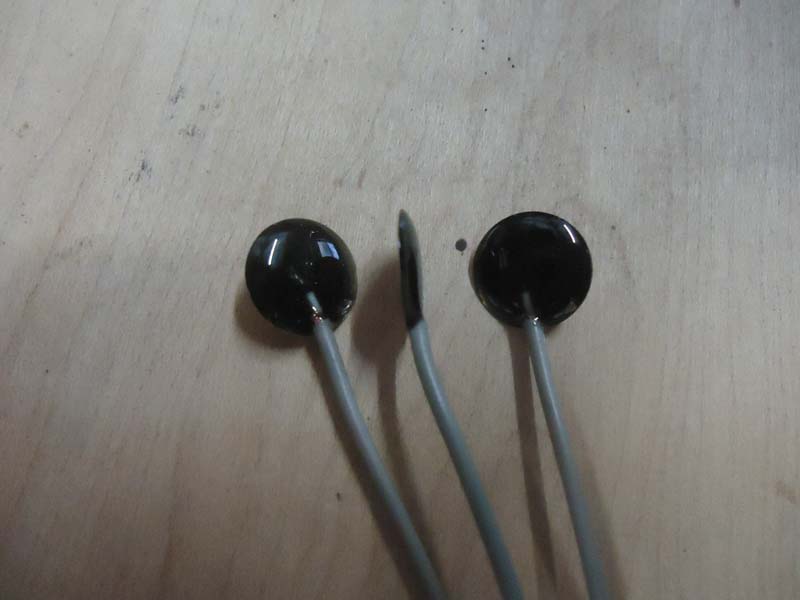

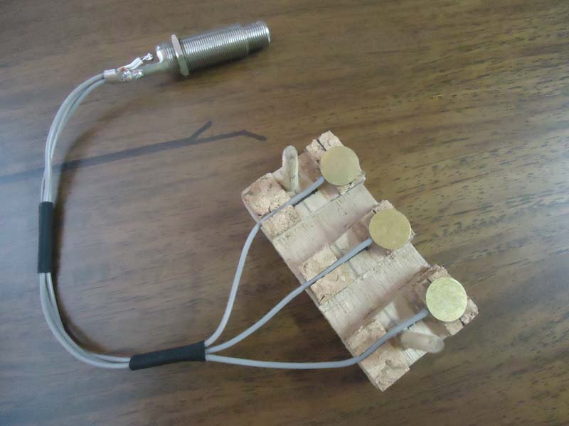

Almost a year since the last post and I am finally back on to this. I have only just installed pup today so have not got around to any comparison.
I bought new disks that are not pre-wired and soldered in the coaxial leads then potted again using potting epoxy.
I also improved my mounting jig as I find the blue tack alone can shift a bit as you fiddle them into the box(wire gets in the way), I have previously compensated for this by using more blue tack but found I was getting a little ring of blue tack stuck to the CA squeeze out, not bad but a bit ugly. So this time the cork holds the wire and I just need a little bit of blue tack.
fake kk2.JPG (45.86 KiB) Viewed 3013 times
fake kk.JPG (56.96 KiB) Viewed 3013 times
