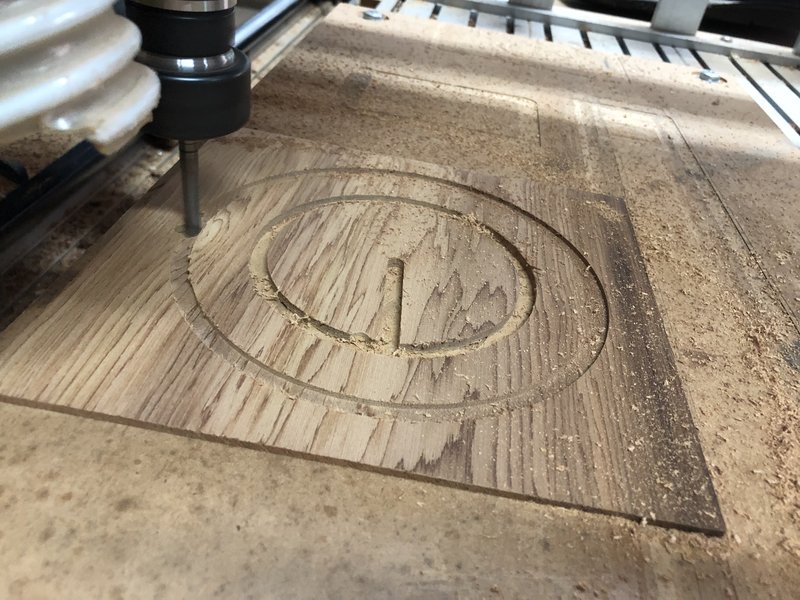

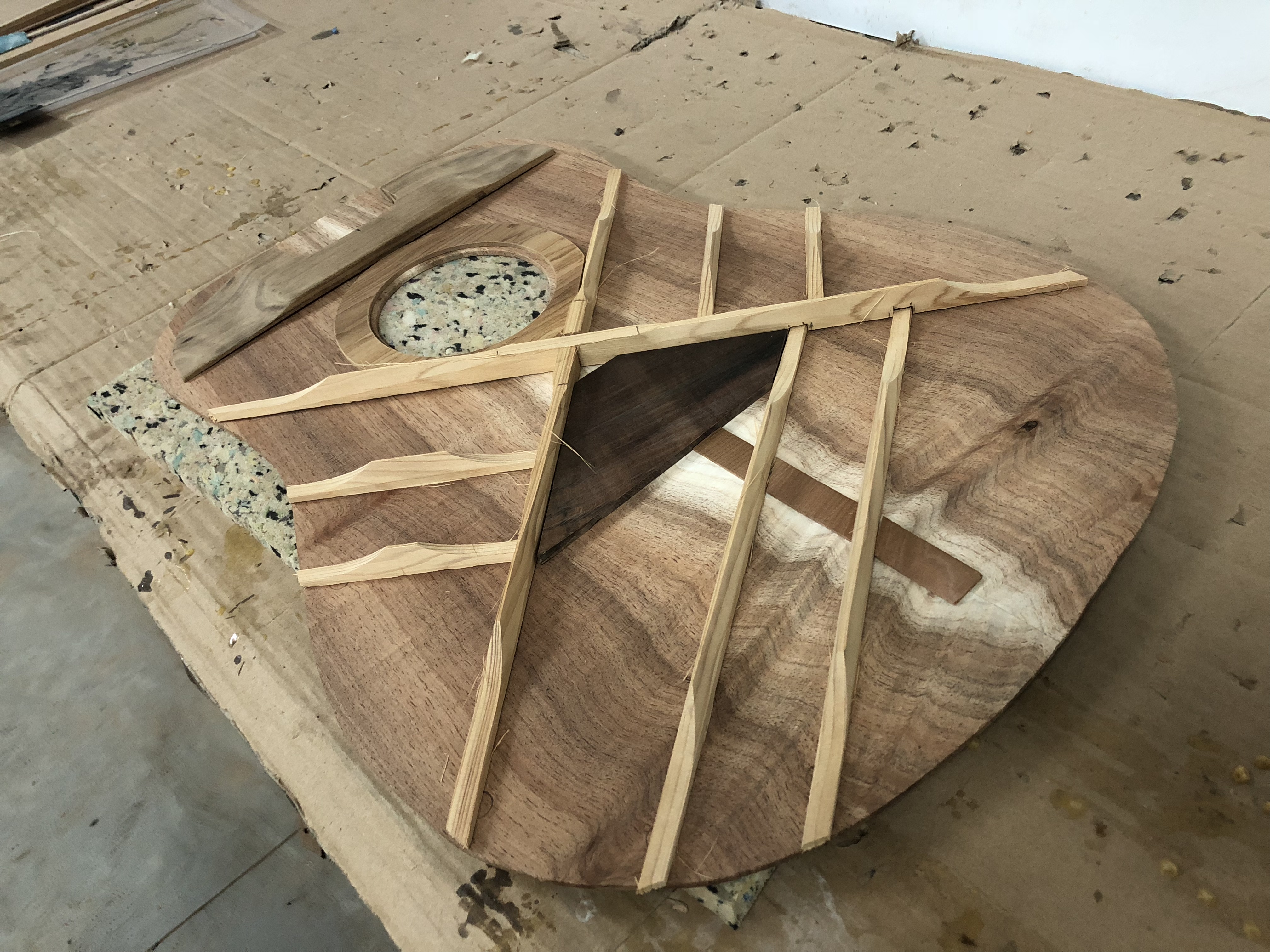

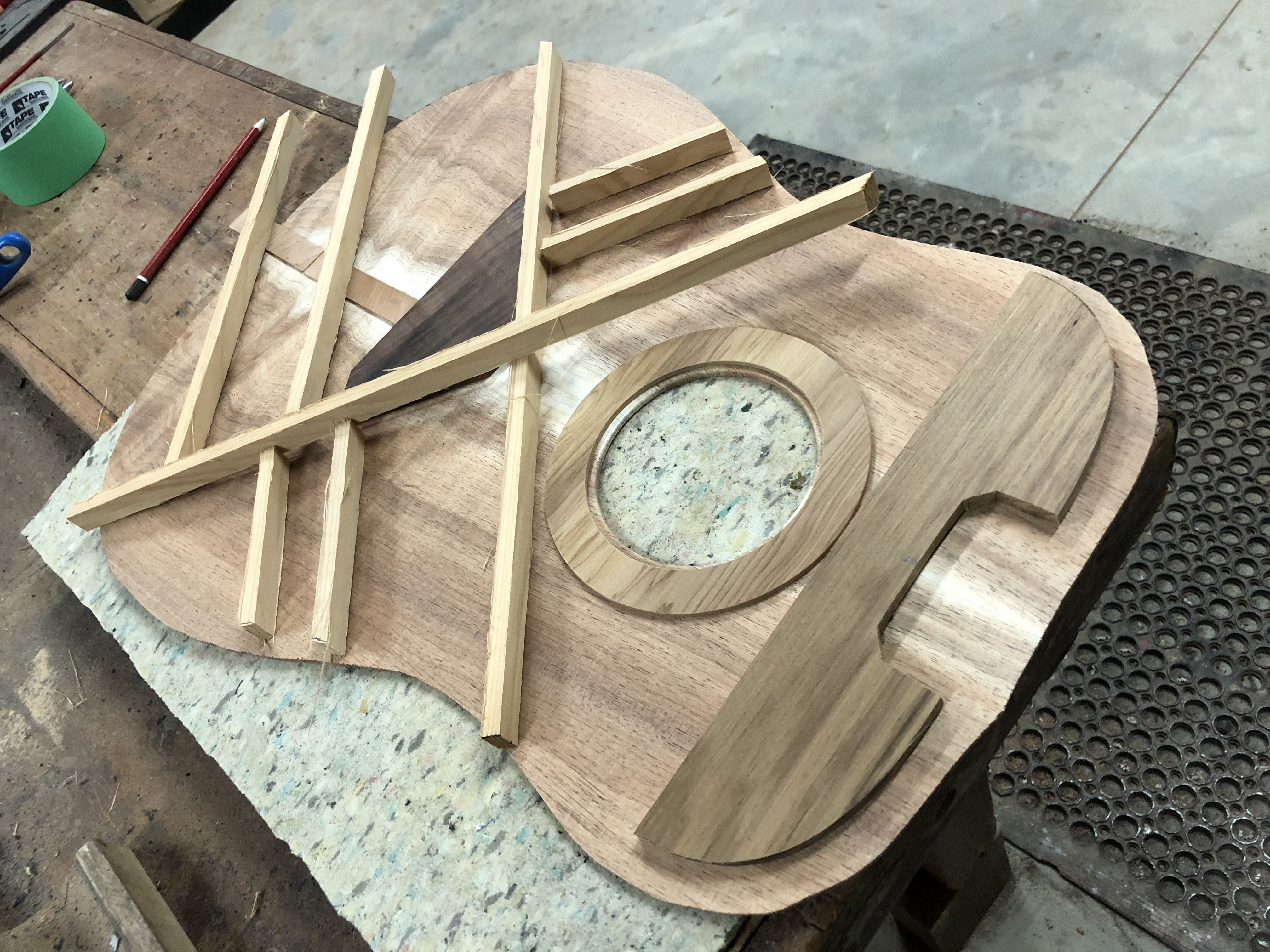

I had a little bit of time to fill in after lunch break, so I roughed out the top bracing and used the magic circle cutter thingy to whip up a rosette support ring.

The customer I had booked in after lunch was a no show, so while I was on a roll I did some pretty shaping and cutting in of the top bracing.
I leave just enough flat on the top surface that I can clamp in the go bar deck, but it’s shaoed enough that it saved time when it’s all glued up.

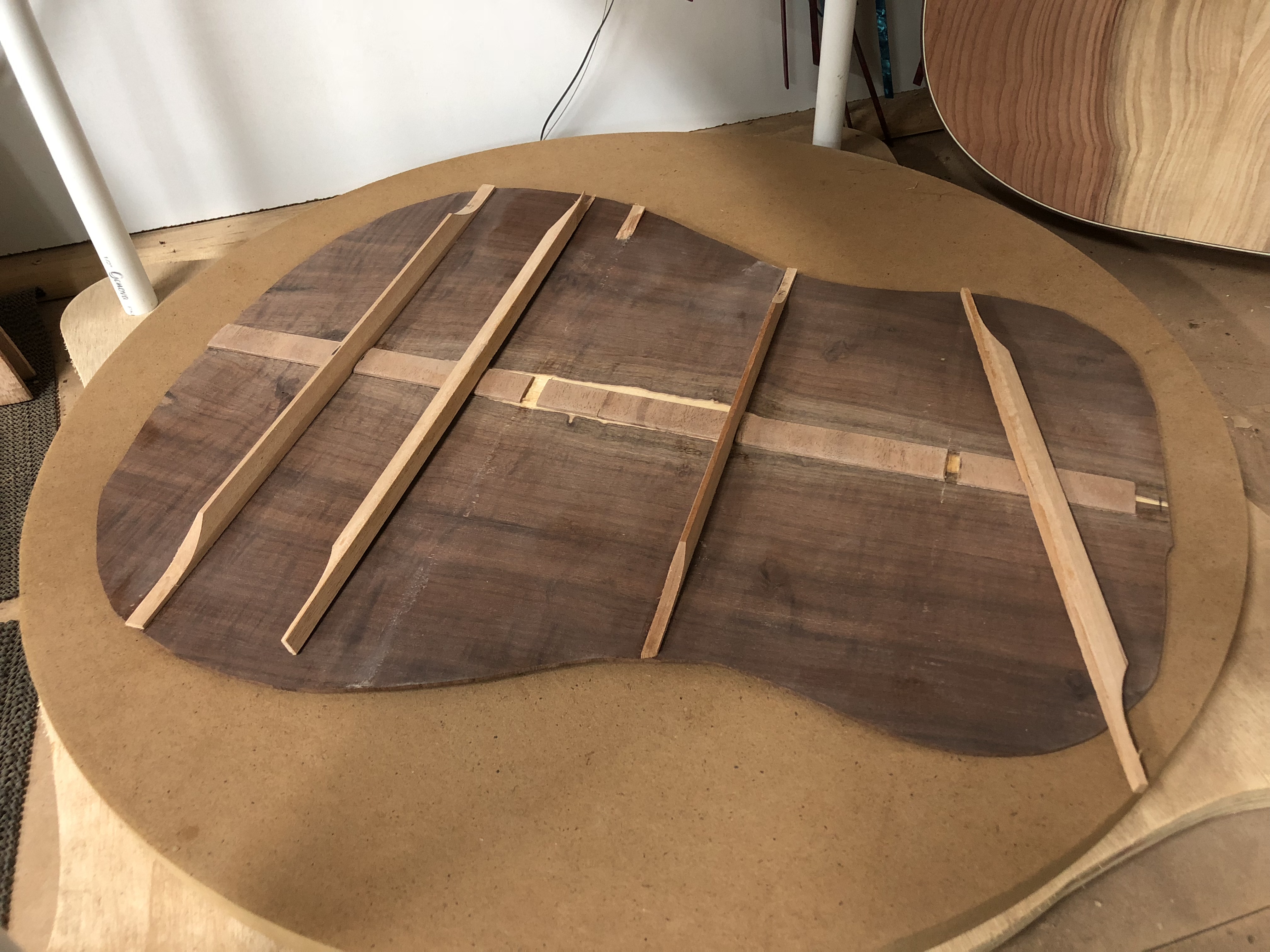

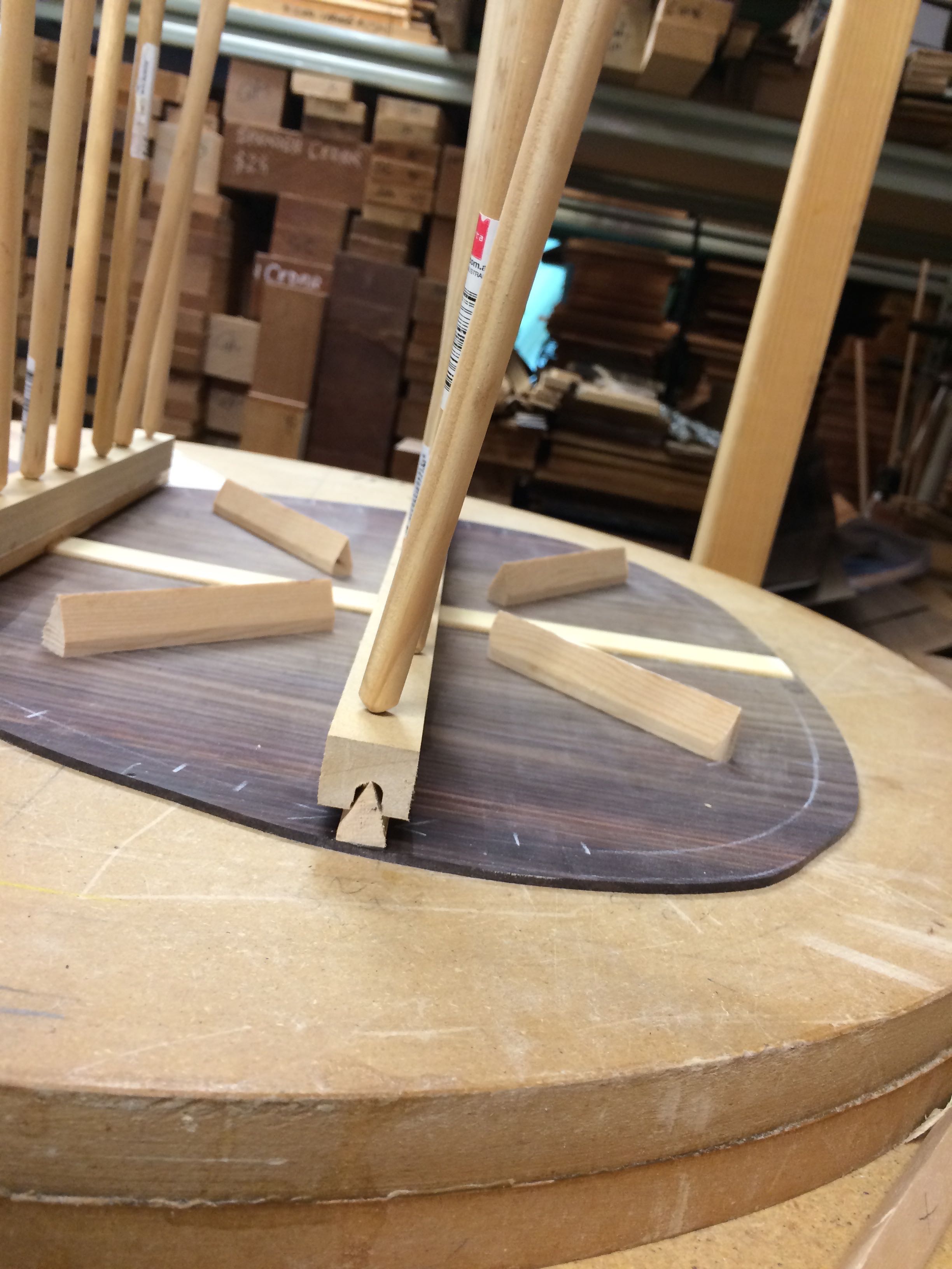

As everyone knows, there is always “something”, and if this is the biggest “something” that happens during the build I’ll be a happy man!

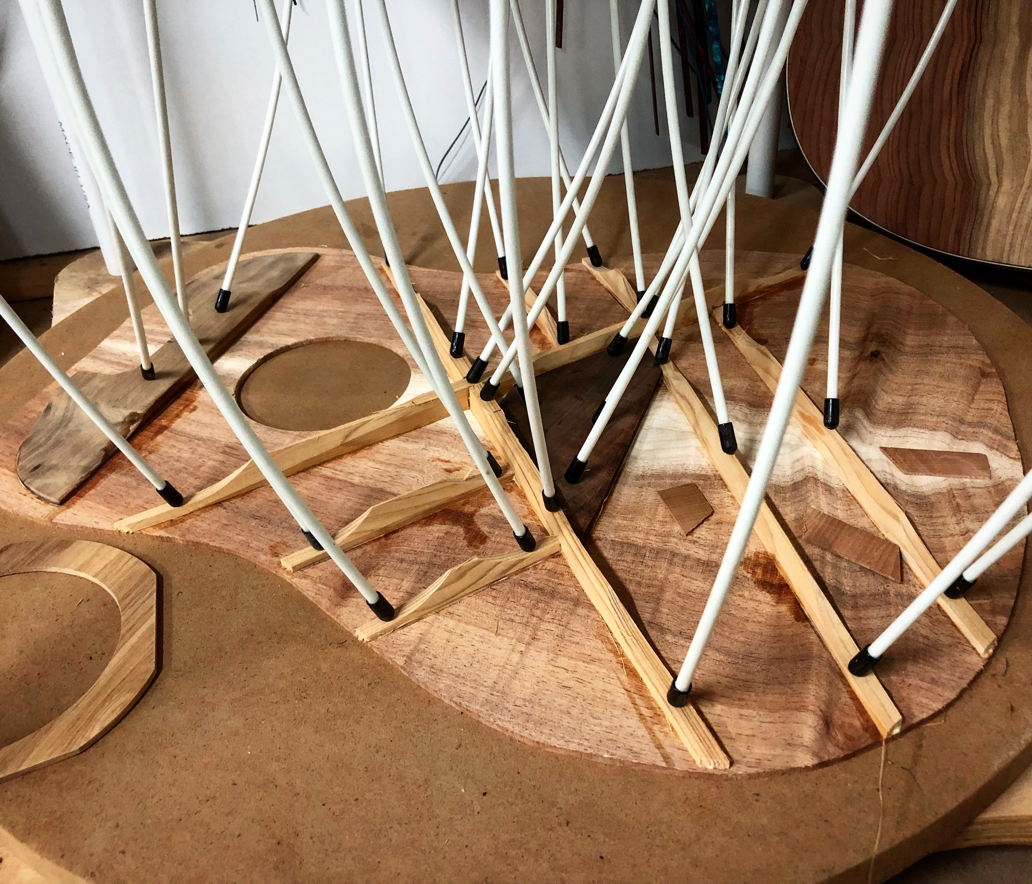

When I clamped the back bracing in the go-bar deck I only used 3 rods pre brace as opposed to the usual 5 that I would do. No particular reason, it’s just what I did on the day. Everything was flush when I walked away from it, however upon inspection the day after I noticed the strength of the Gidgee had fought back against the clamps and two of the four braces hadn’t glued flush.
I removed them with a decent amount of effort. So in reality they could have been left as is, however I’m fussy and like things to be “right”, so the surfaces have been scraped and sanded and will be re glued today.

All looking good Allan do you shape the bottom of the braces to fit the dish radius?
Trevor Gore has a neat method for securing braces in the go bar deck. A strip of MDF with a channel cut down the middle with a ball end cutter. The channel fits over the top of the brace and the go bars apply pressure to the upper side of the strip. This method is especially effective for the short tertiary braces on the falcate braced tops.
demonx
Posts: 1395
Location: Ballarat Victoria
Re: Acacia dread build thread
Post by demonx » Sat Nov 10, 2018 3:32 pm
I have mini clamping cauls that I’ve made similar to that for other jobs, however when I glue the braces I leave the top flat so there’s a surface for the rod to press down on, then I shape after it’s all glued up.
Yes I sand the base of them prior on the radius dish so they match the top radius, and then I use the radius dish in the go bar deck at glue up.

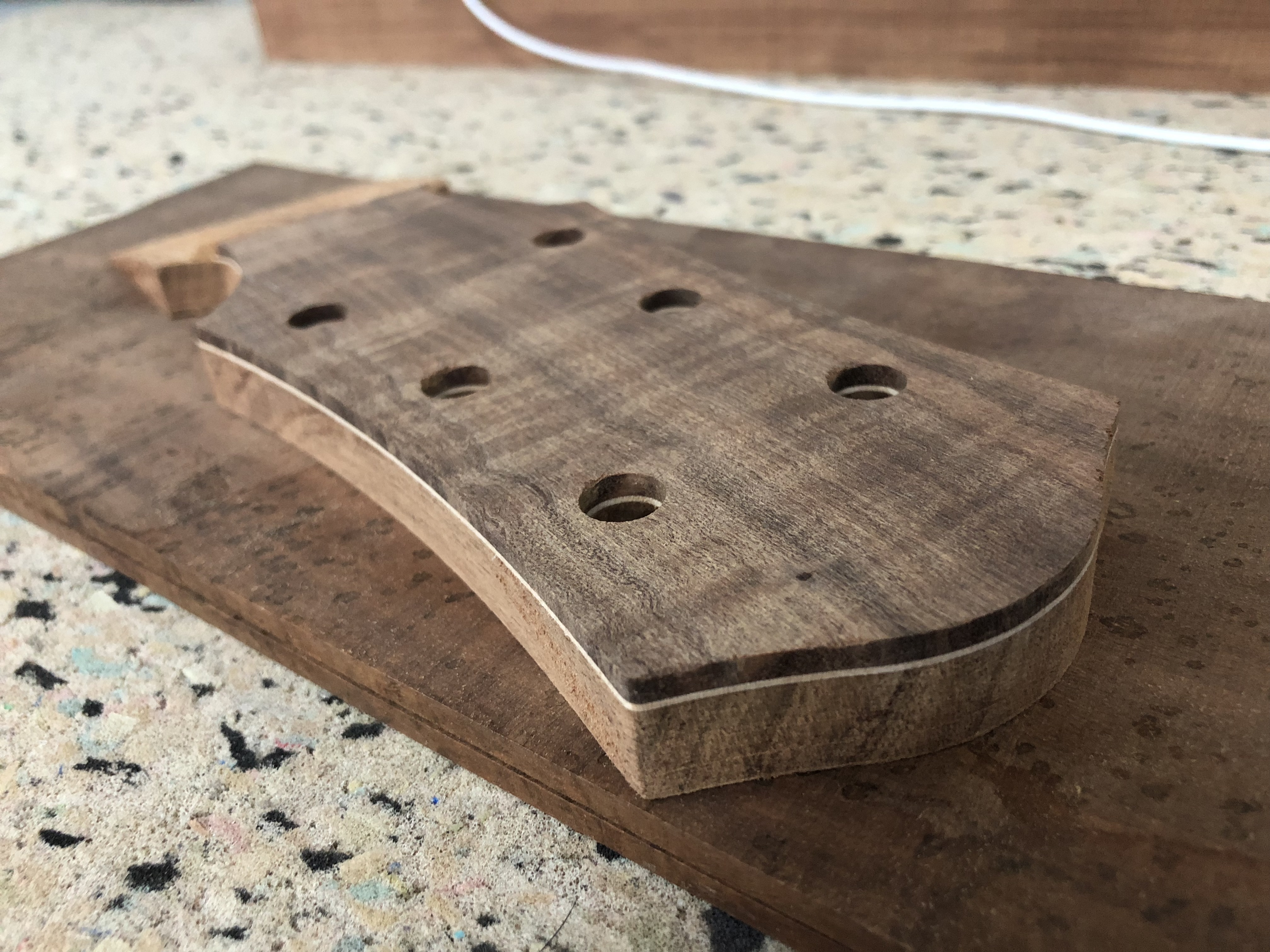

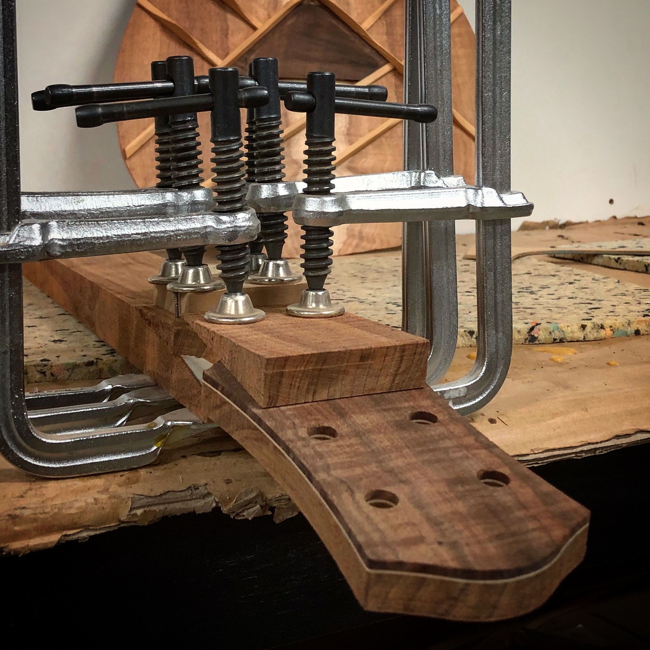

I had a big of spare time at the end of today’s word day, so I knocked out the headstock, glued the scarf and started shaping the top bracing by hand.

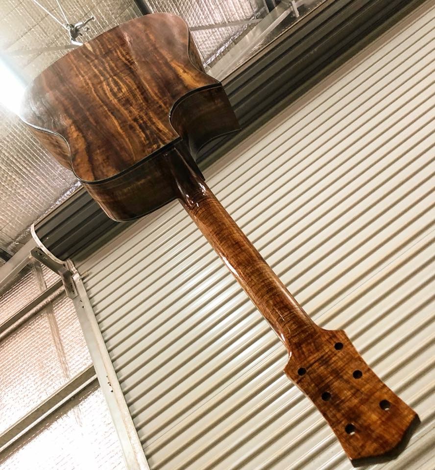

I haven’t taken any finished pics of it, but here are a couple that were on my phone:

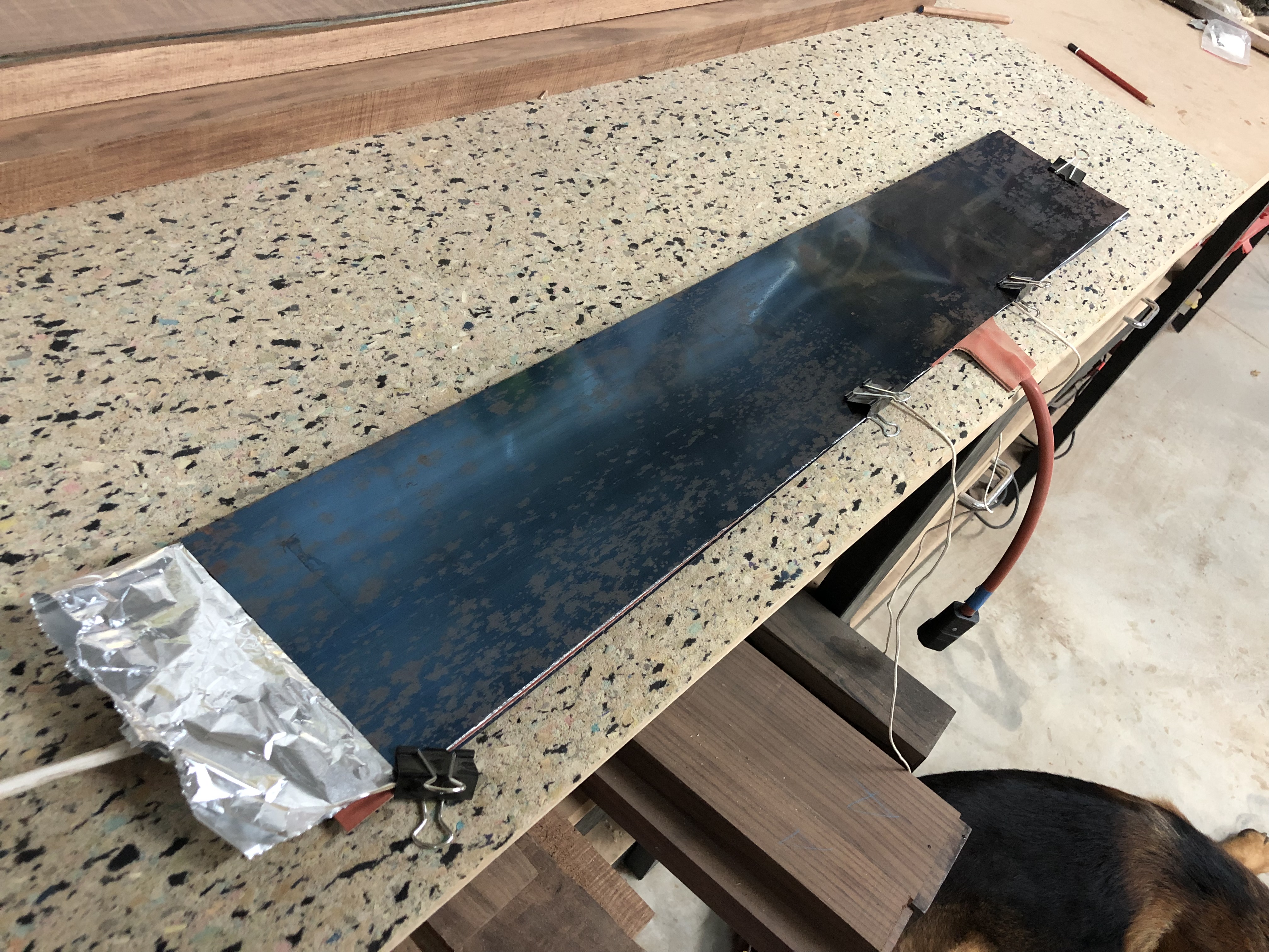

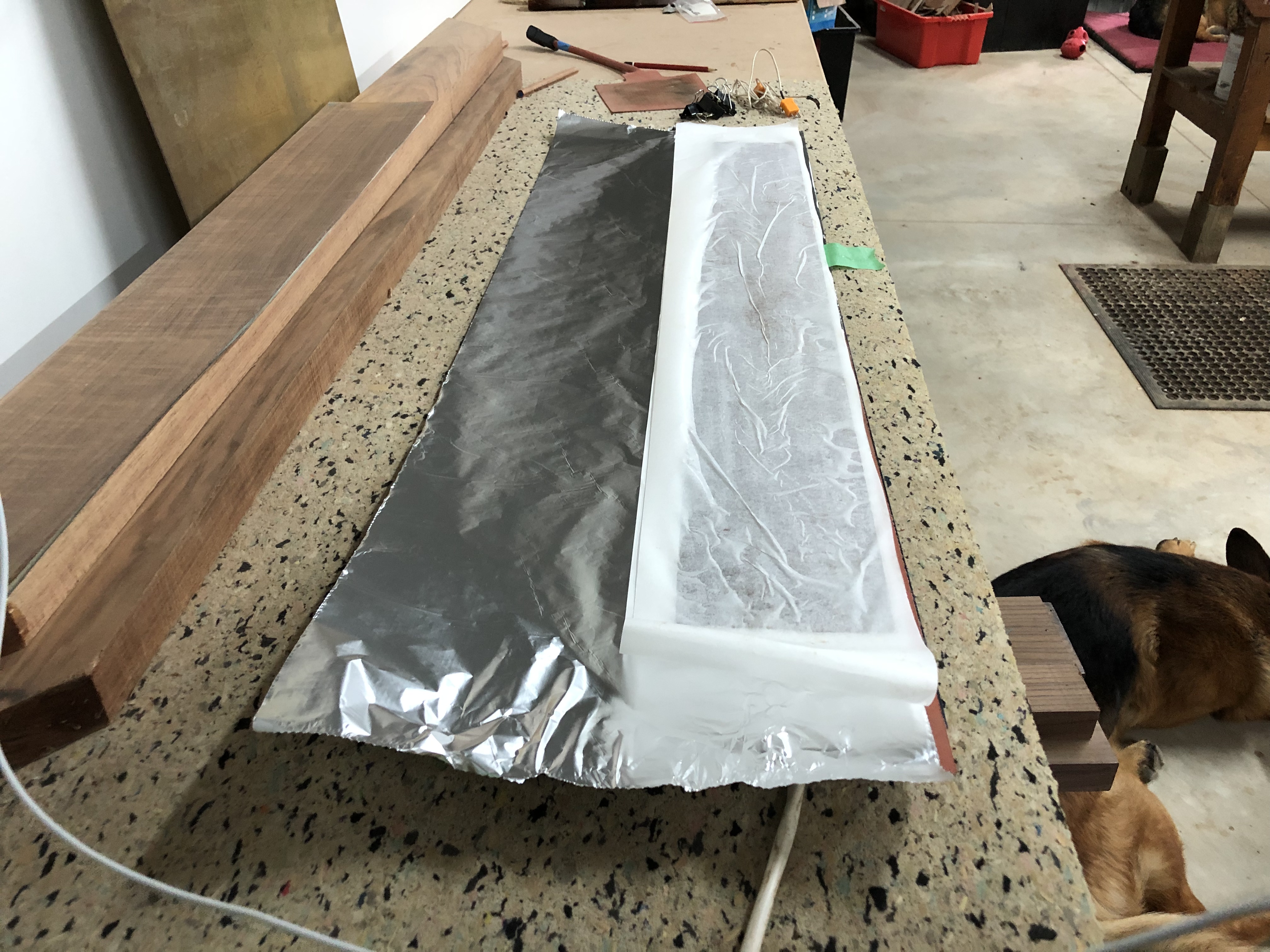

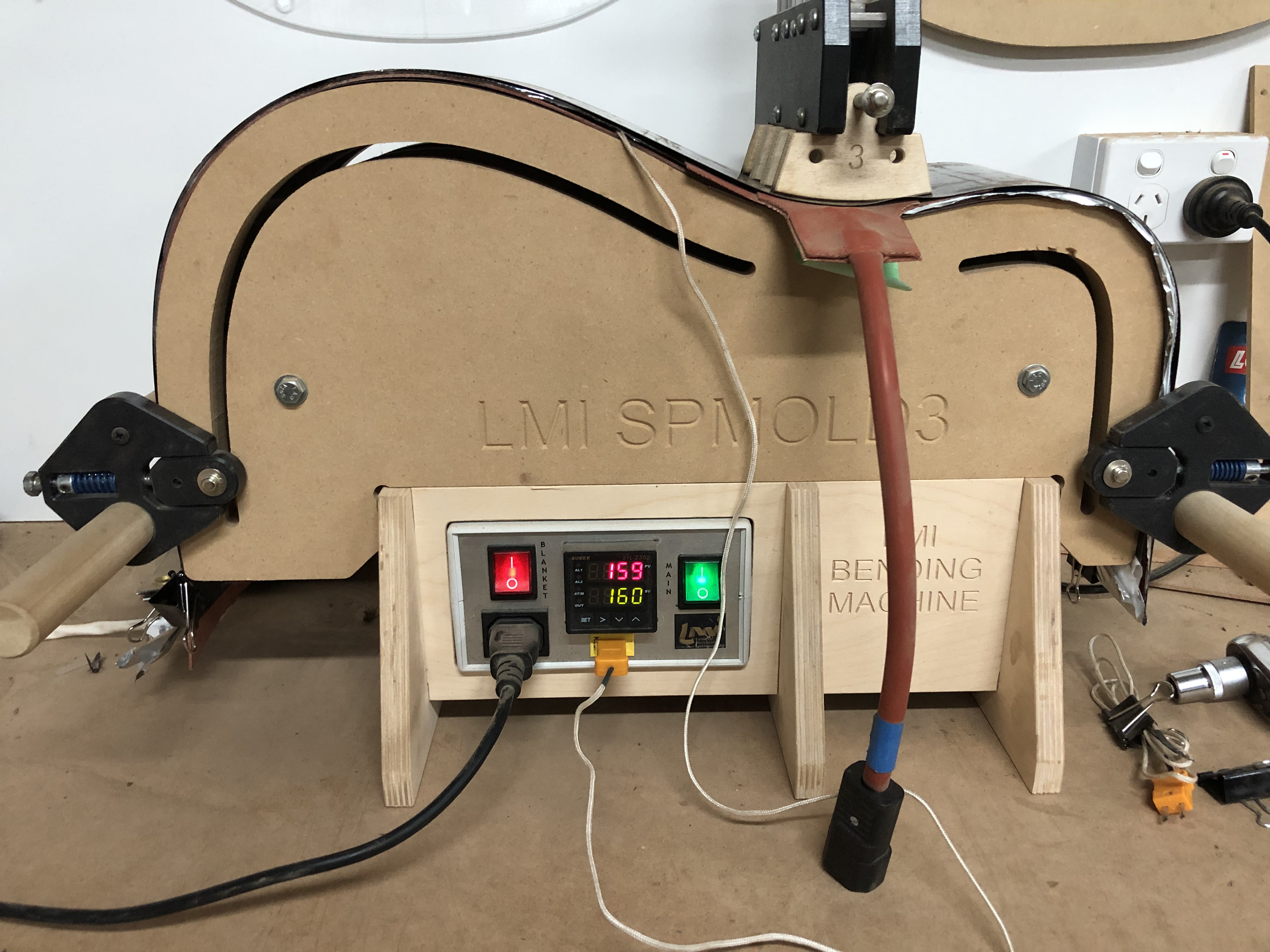

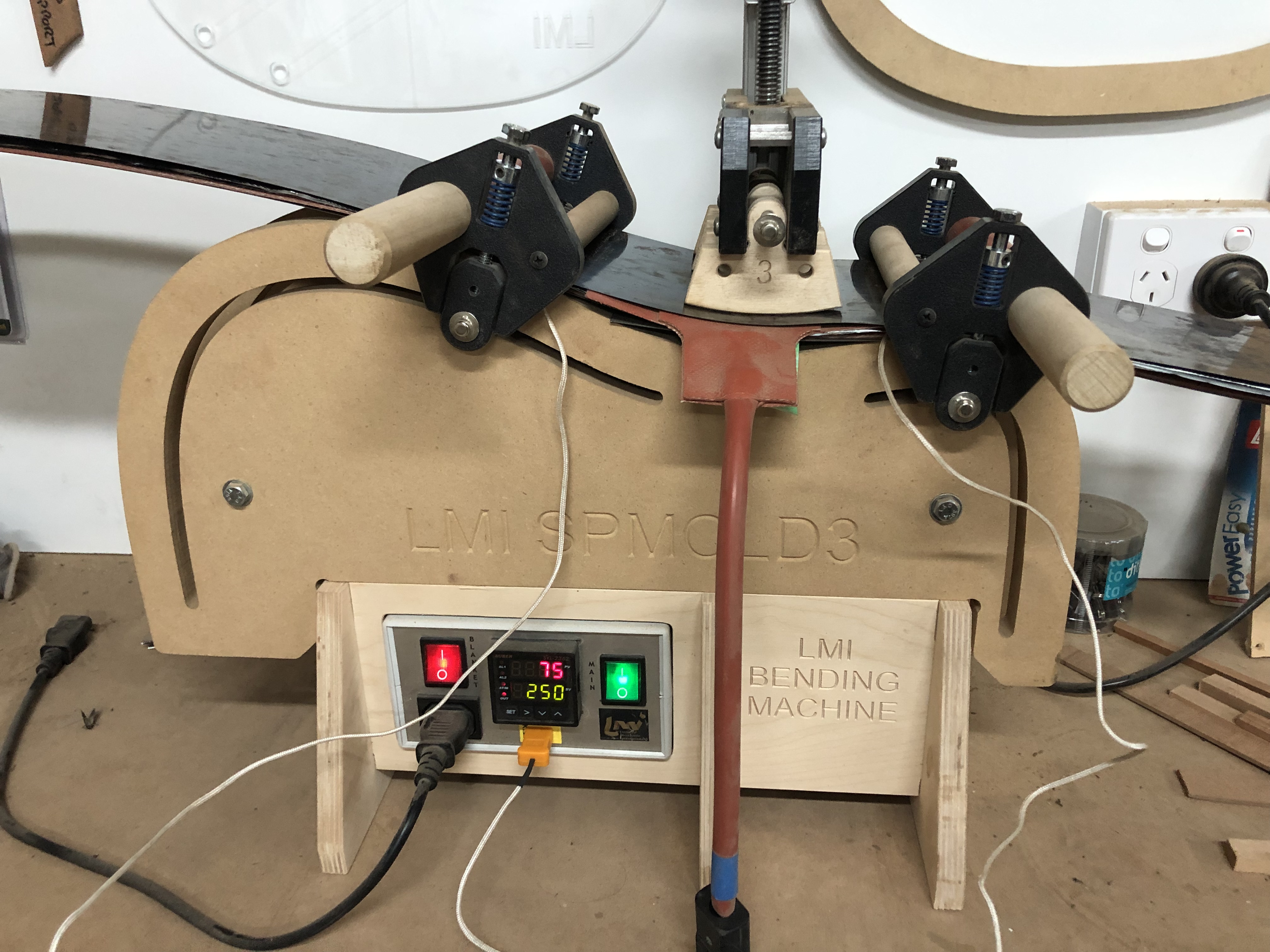

The sandwich I use is spring steel, blanket, aluminium foil, cooking paper.
I put a bit of tape which hangs out )green in photo) at the waist so I can find it easy incase the blankets move.
Wood is spritzed lightly with mineral free water.
This photo I took whilst I was patiently waiting for the blanket (which I’d forgotten to plug in) to heat up!
demonx
Posts: 1395
Post by demonx » Mon Nov 12, 2018 4:54 pm
The bulk of the bending I generally get done before it even heats up to the “250” setting, then I bake for fifteen minutes at “160”. Then I let it cool down inside the bender before it’s removed and put in the form.
I did some trials a couple years ago on different methods and I found this helps it stay in shape as opposed to being pulled straight out.

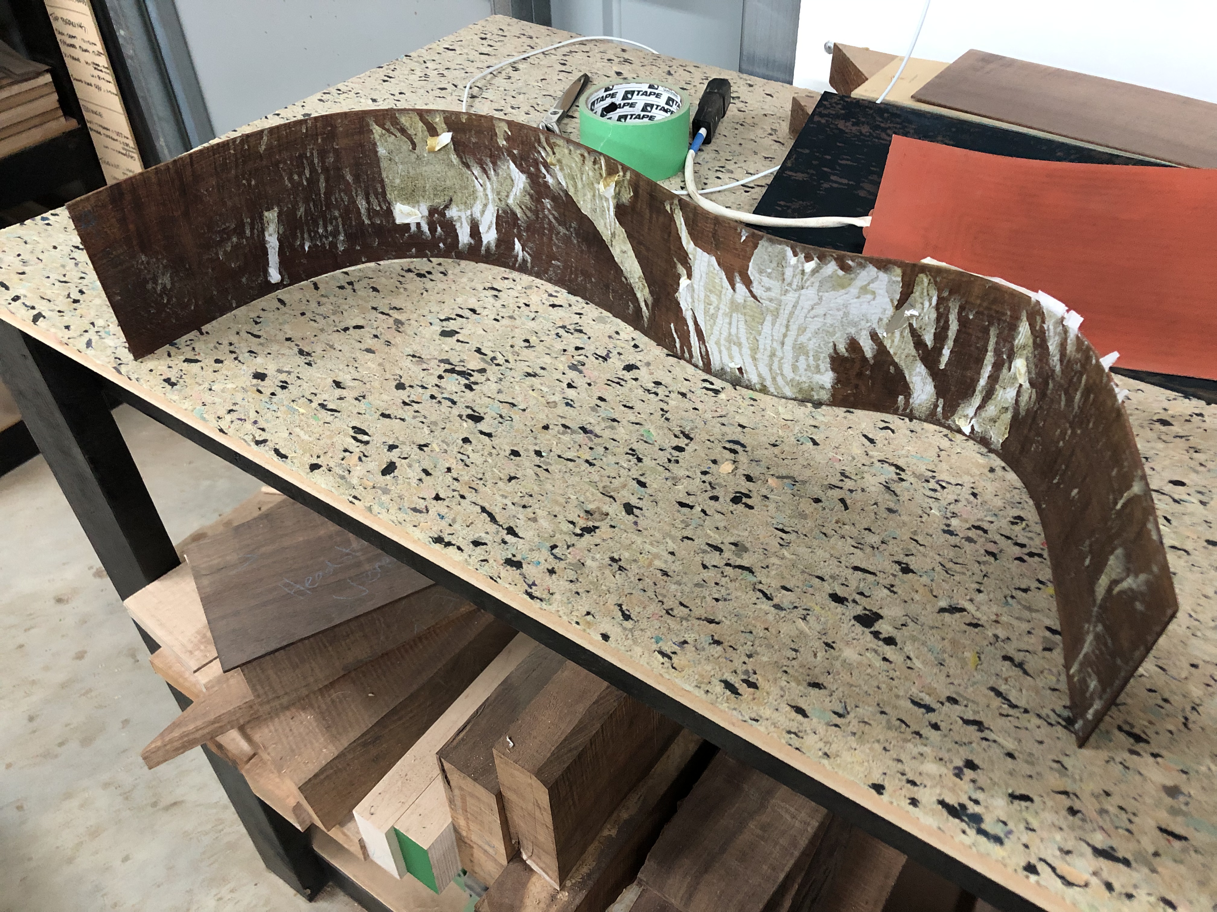

I was going to pull the bent side out and take pics before I knocked off tonight, however someone came and I was distracted. I left it in the bender overnight, will pull it tomorrow morning and bend the other side before my first customer shows up.

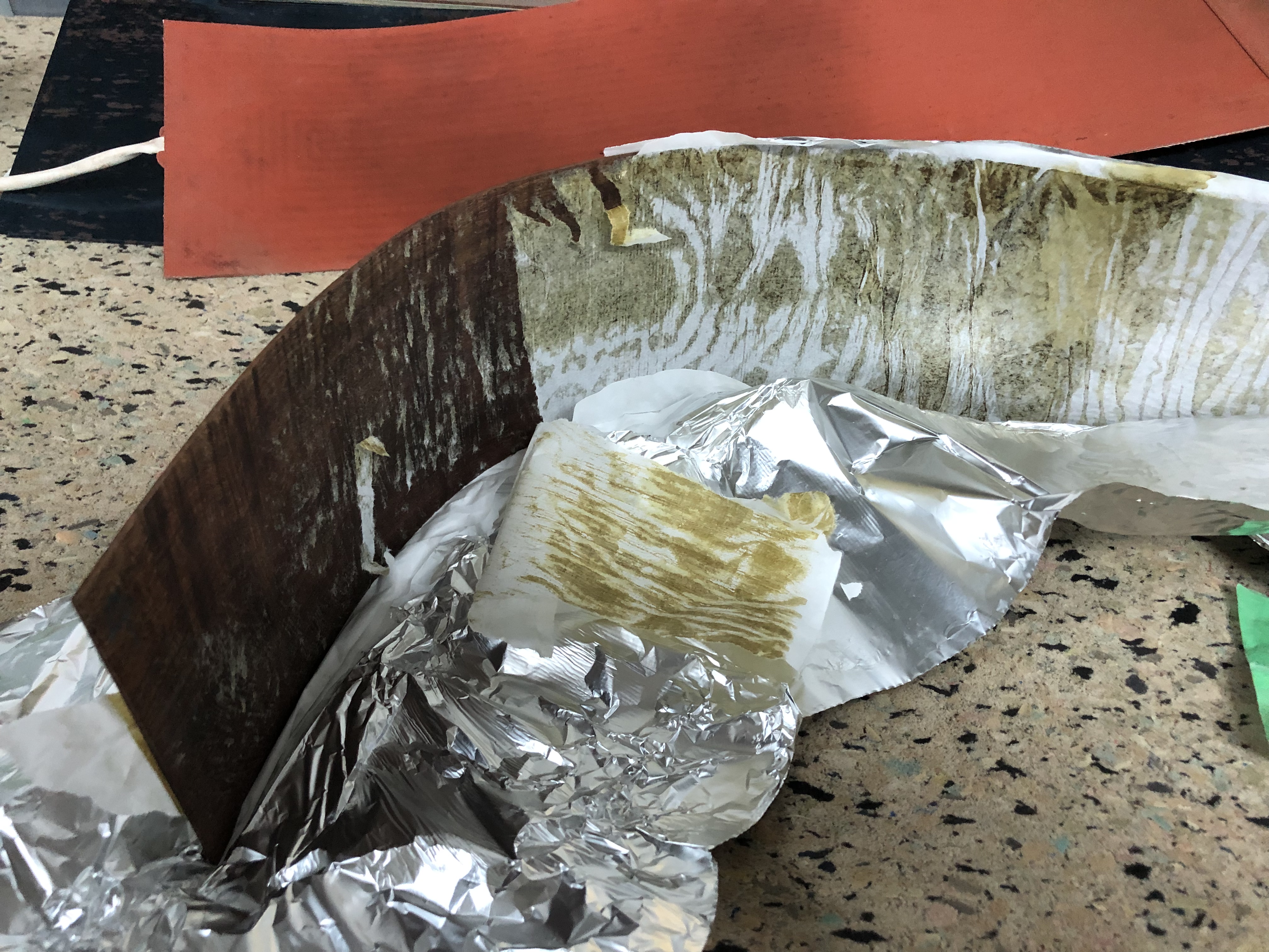

Always a first for everything, this time it’s the paper gluing itself to the Gidgee.
I’m wondering if it’s because the Gidgee is extra oily and it was left in overnight... no idea, I do know I’ve left both Blackwood and rosewood sides in overnight before and never had the paper dry up like that before. Oh well, suck it up and add paper removal to the list of jobs to do!

Well... there goes that theory. I’ve just pulled side two from the bender AFTER baking but before it cooled down and it is the same.
I guess it’s the Gidgee but I didnt have this happen on my last Gidgee set.
Oh well
