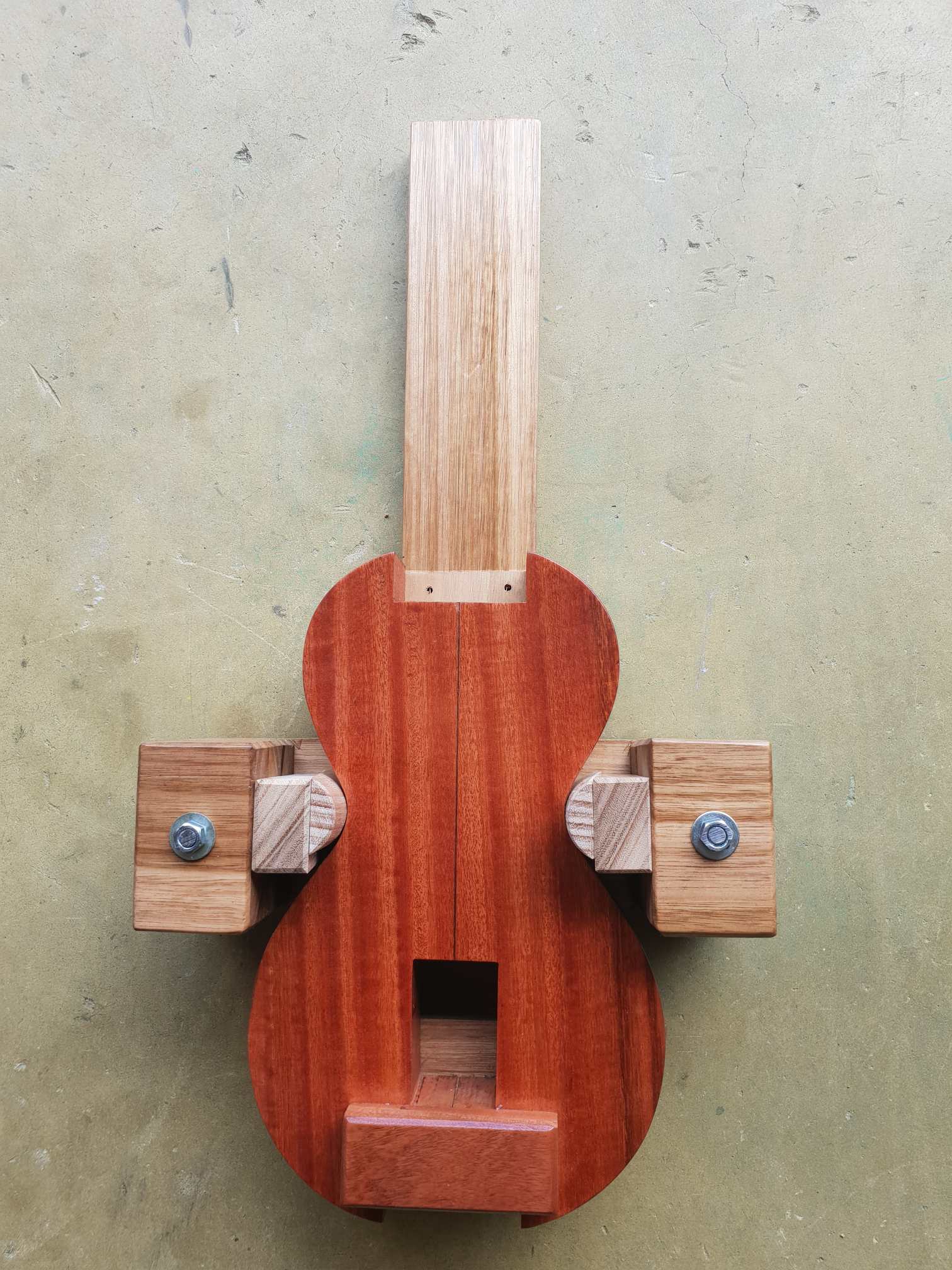

Re: Bushwhacker Ukulele builds.

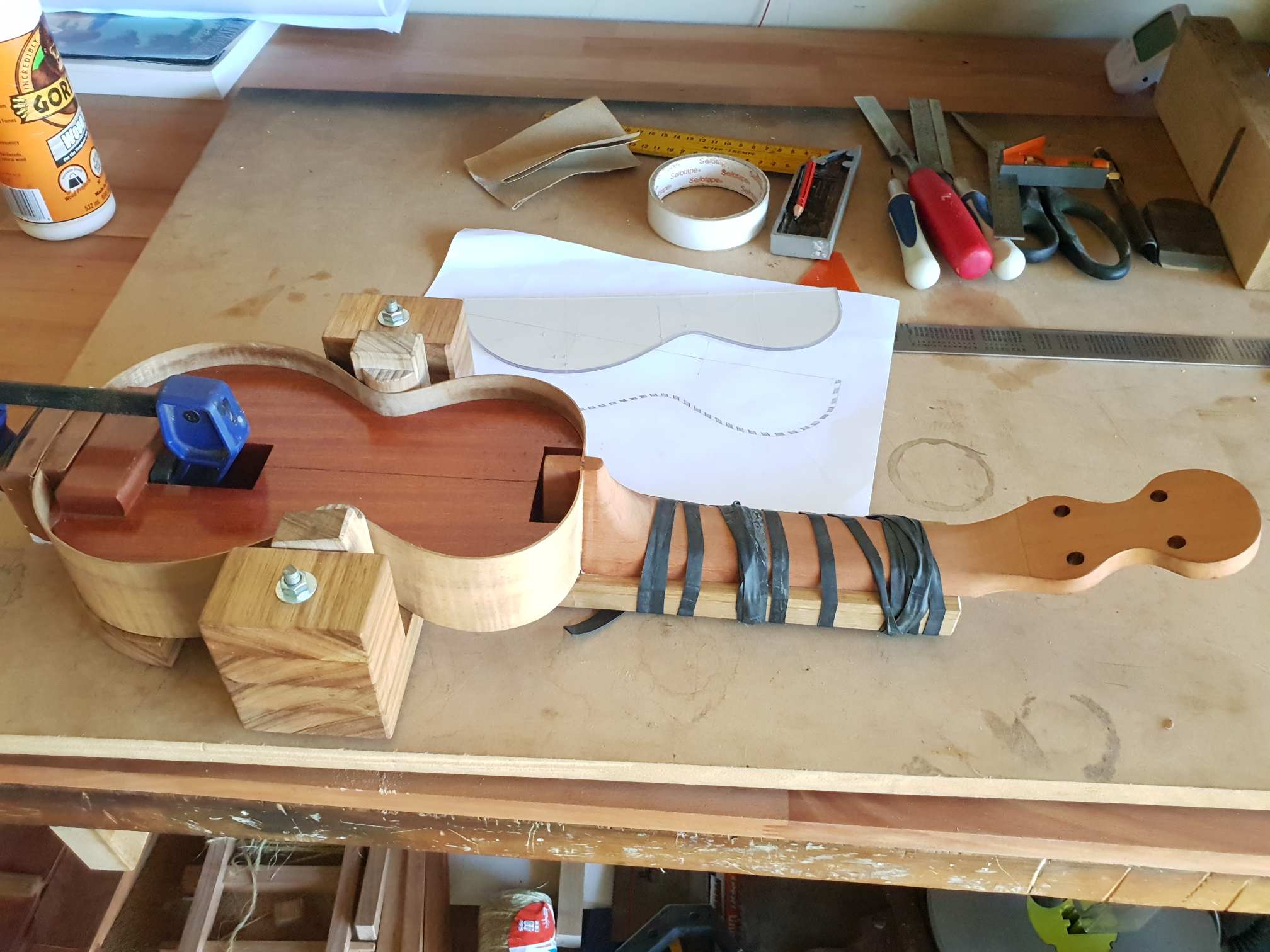

Here's my new mould.
Getting excited now.
Nothing new as Ken Timms has covered this.
Just wanted to show how I am getting on.
Here is my new mould.
Pete
Next step. Build the neck.Pete

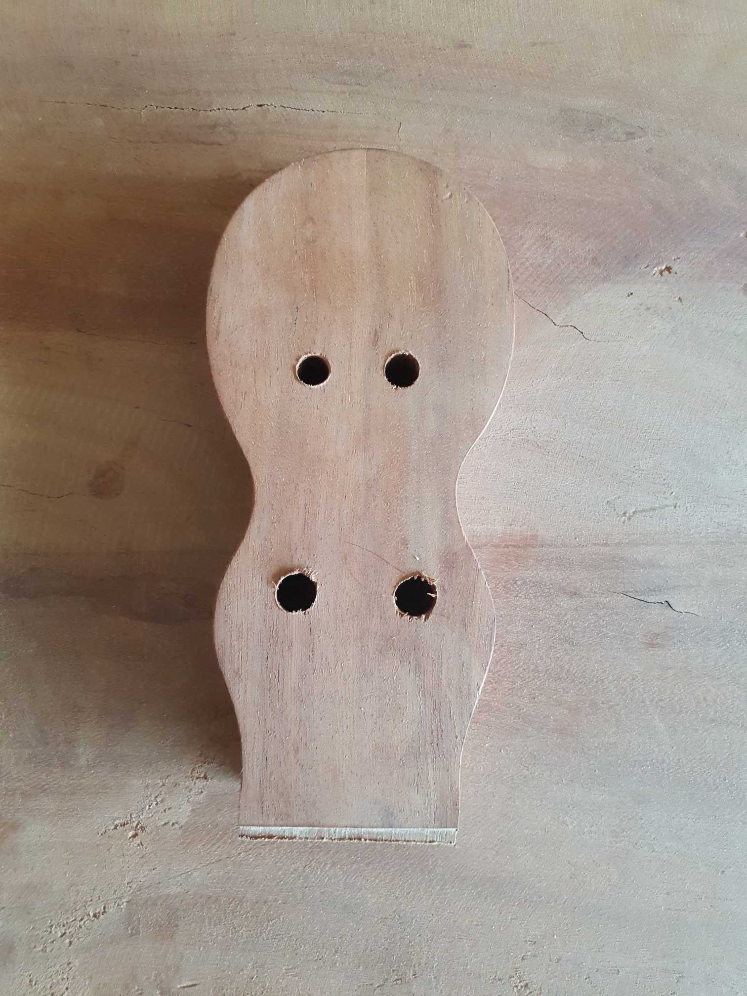

Well...they say ( Mistakes!) Happen for a reason.
I had in my mind a nice roundy woman like curvy head stock.
I tried to design it so the strings would run in a straight line to the periphery of the pegs.
Completely blind to the fact that the pegs also have the other end on them apart from the immediate hole diameter I went ahead and built the head part of the neck first.
I thought I would just put the pegs through the peg shaper and then ream the holes out to fit.
BUGGER ! .
The peg heads fouled each other!
Thats what I get for trying to be smart.
Bit miffed about it but Gore / Gilet books say make two necks at a time.
I know their reasoning but in my case ....good job too!
( when you bugger it up).
And mate!...I buggered it good and proper so went to bed!
" Woke up the next morning"!!! La la la la Lahhhh.
A La Blues!
Designed a new head using the Martin peg head spacing.
Did a bit of Geometry wiv my French curves and compasses and came up with " Just the shape" I imagined in my mind!
So that is why the mistake ( Bugger up) happened.
So hopefully here are some pics of the ( Bugger up ) and of the new shape after a nights sleep.

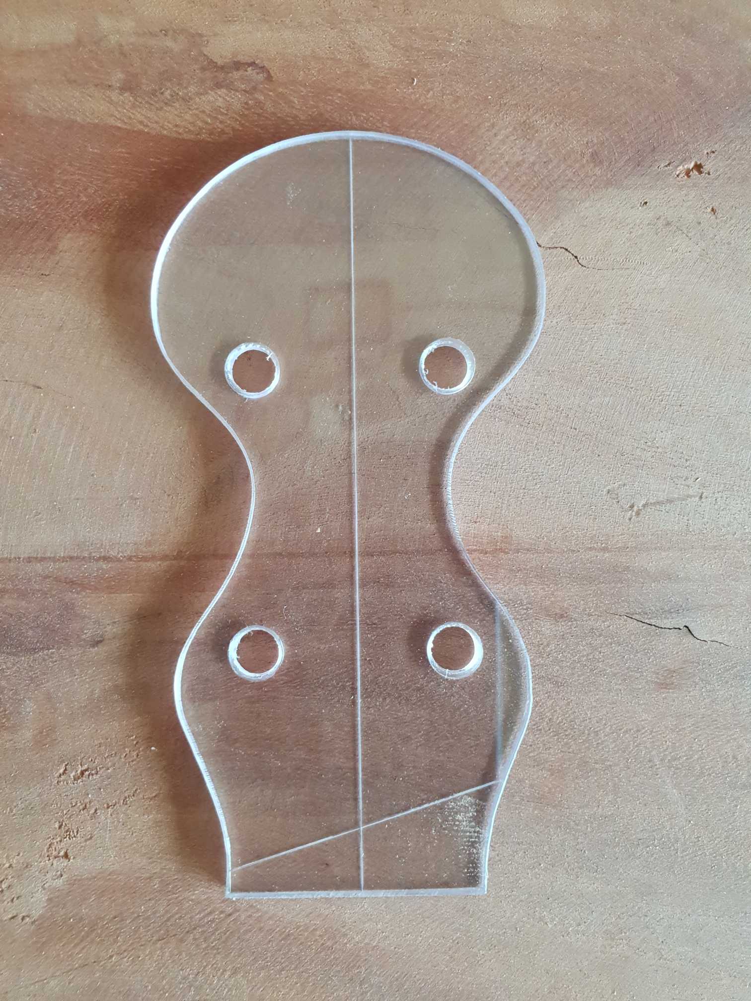

Sorry just getting used the photo bit.
The above image is what I had in mind but the shape just was not there....and the pegs fouled!.
Here is an image of the new shape non fouling pegs.
It is " This shape" that was in my mind.
Often we visualise something but cannot get it down on paper???
Now I have done due to the "Bugger up ".

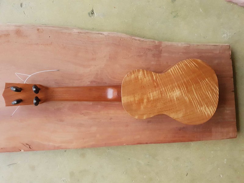

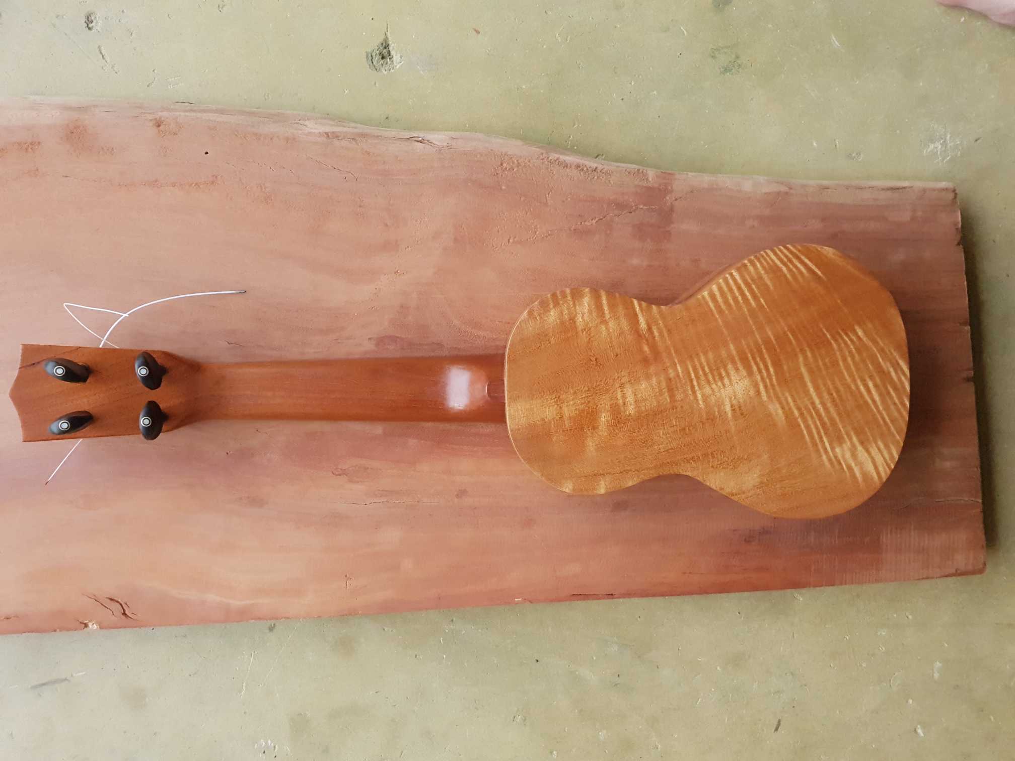

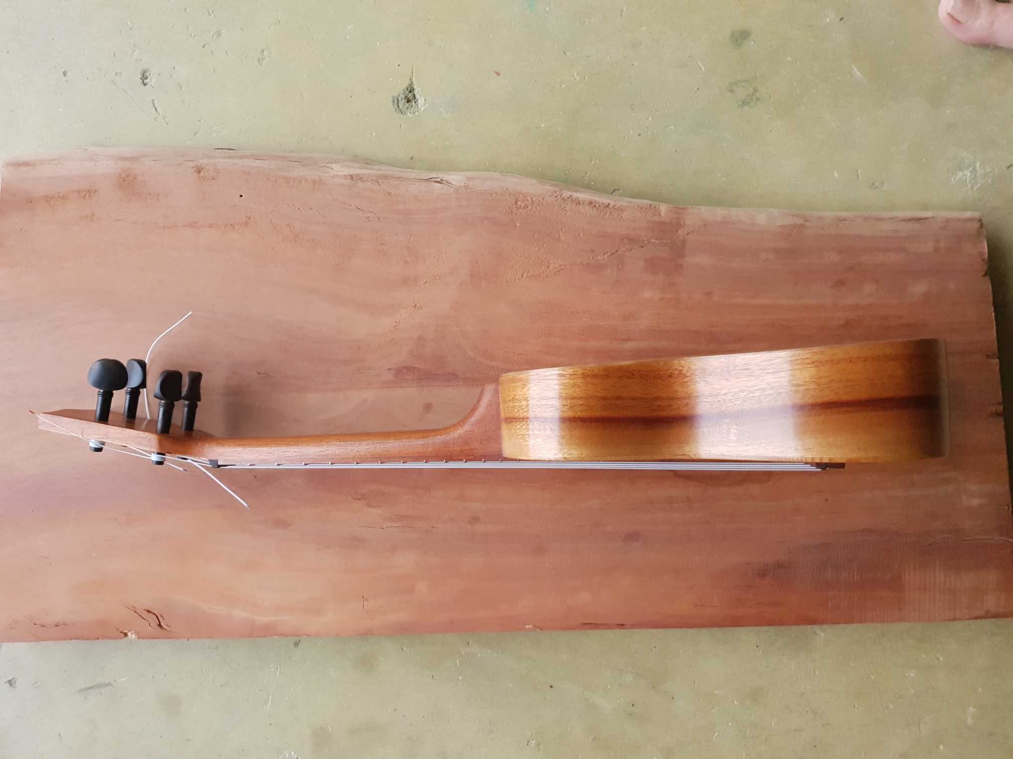

Today I strung up my second Soprano Uke.
When we string to pitch...be honest now!
Do we anticpate the bridge twanging off?
Well I did and fortunately it held!
I will leave it a week or so to bed in before giving it away to a friend.
It is very personal.
I have spent my time and money building it.
It gave me great pleasure.
I learnt as I built and will always learn. I find this forum invalueable . I have my limitations craftsmanshipwise but I hope to lift them.
I cannot yet measure up to the gorgeous creations you guys make but I like to think there is hope for me.
This is a wonderful way of life and I have made something that someone will love and cherish.
What I have built cannot measure to the beautiful instruments you luthiers on the forum build.
But I have to start somewhere and I also have my individual preferences.
I favour light construction. Super light. ( Kiwaya soprano ukes)
I fitted Gotoh mini tuners to the head at first and the whole head weighted down.
This is not good for the player.
The Mini Gotohs were of the black encased type.
Super machines but not for a soprano Uke.
Any way here is what I have done.
Pete

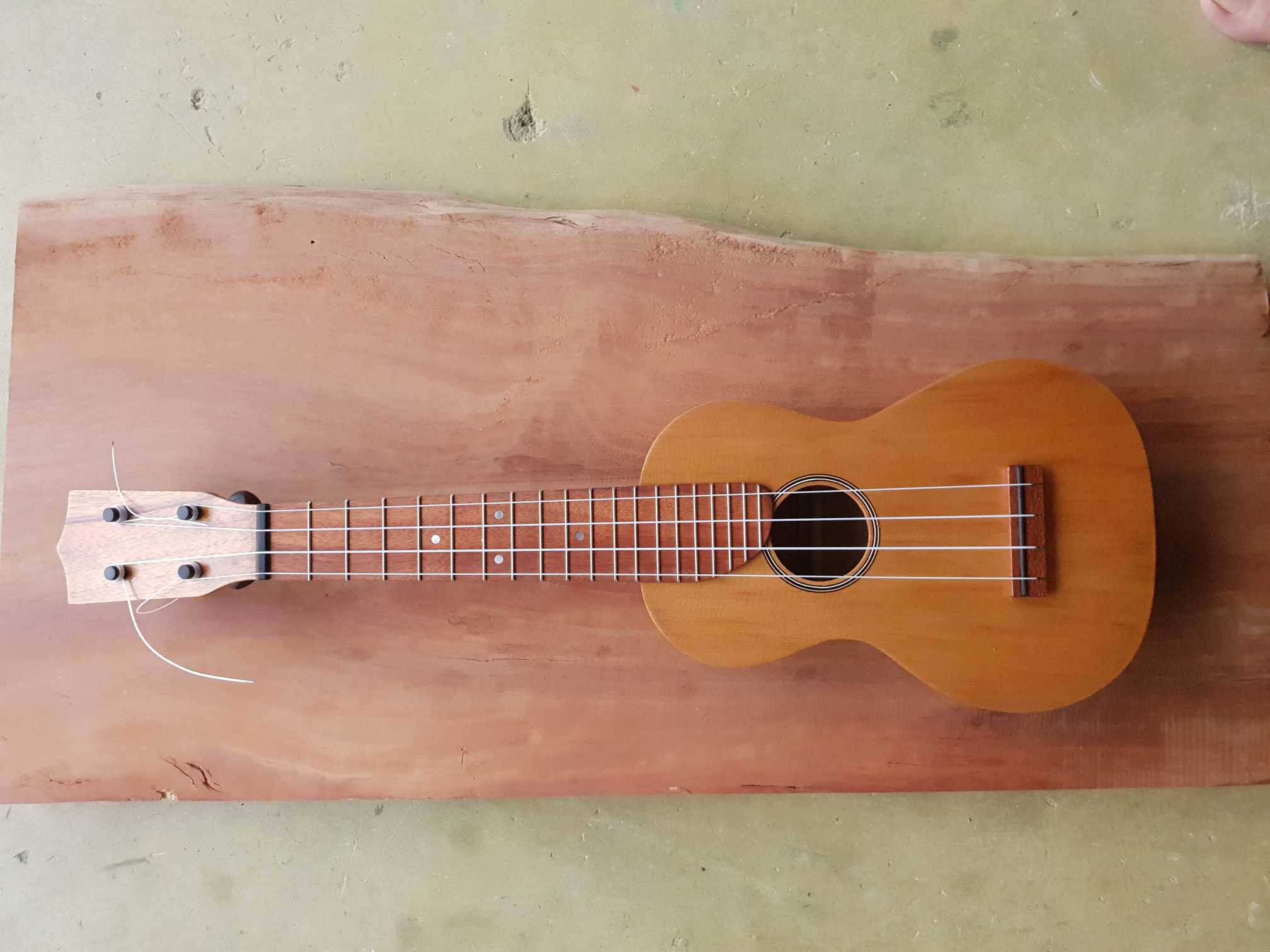

Hopefully a top view?
Thanks.
PeteThanks.
The bridge needed to go to the right a few Millimetres!
I find bridge set up really hard.
I used a protactor from the 90 but still buggered it!
It plays nicely though.
Has a good bark although Cedar wood top.
Intonation bang on!.
My ear tells me in an instant if its wrong.
Pete

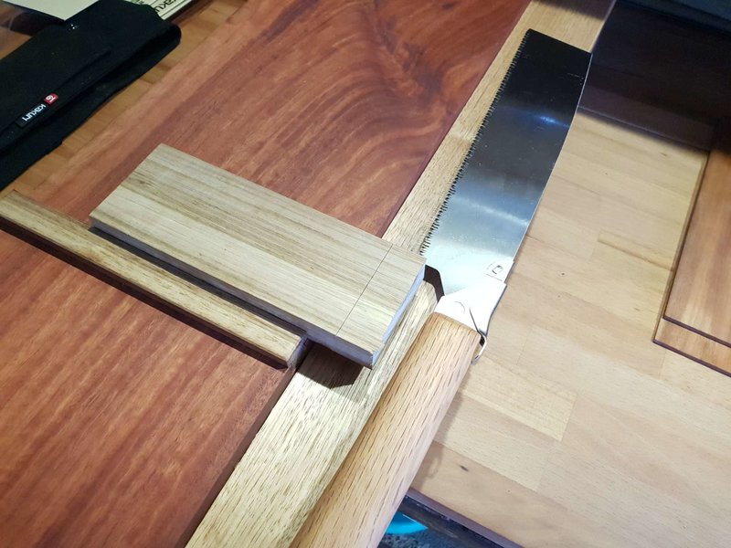

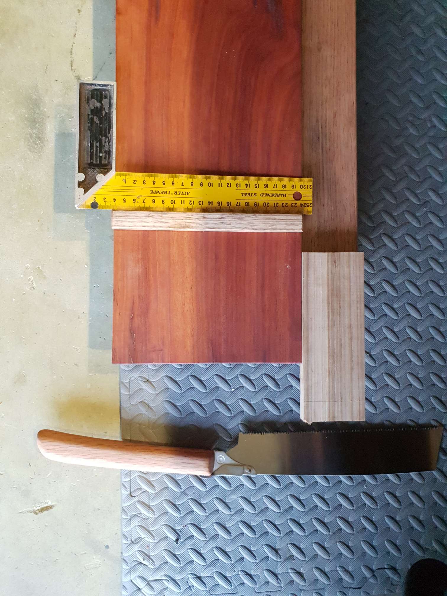

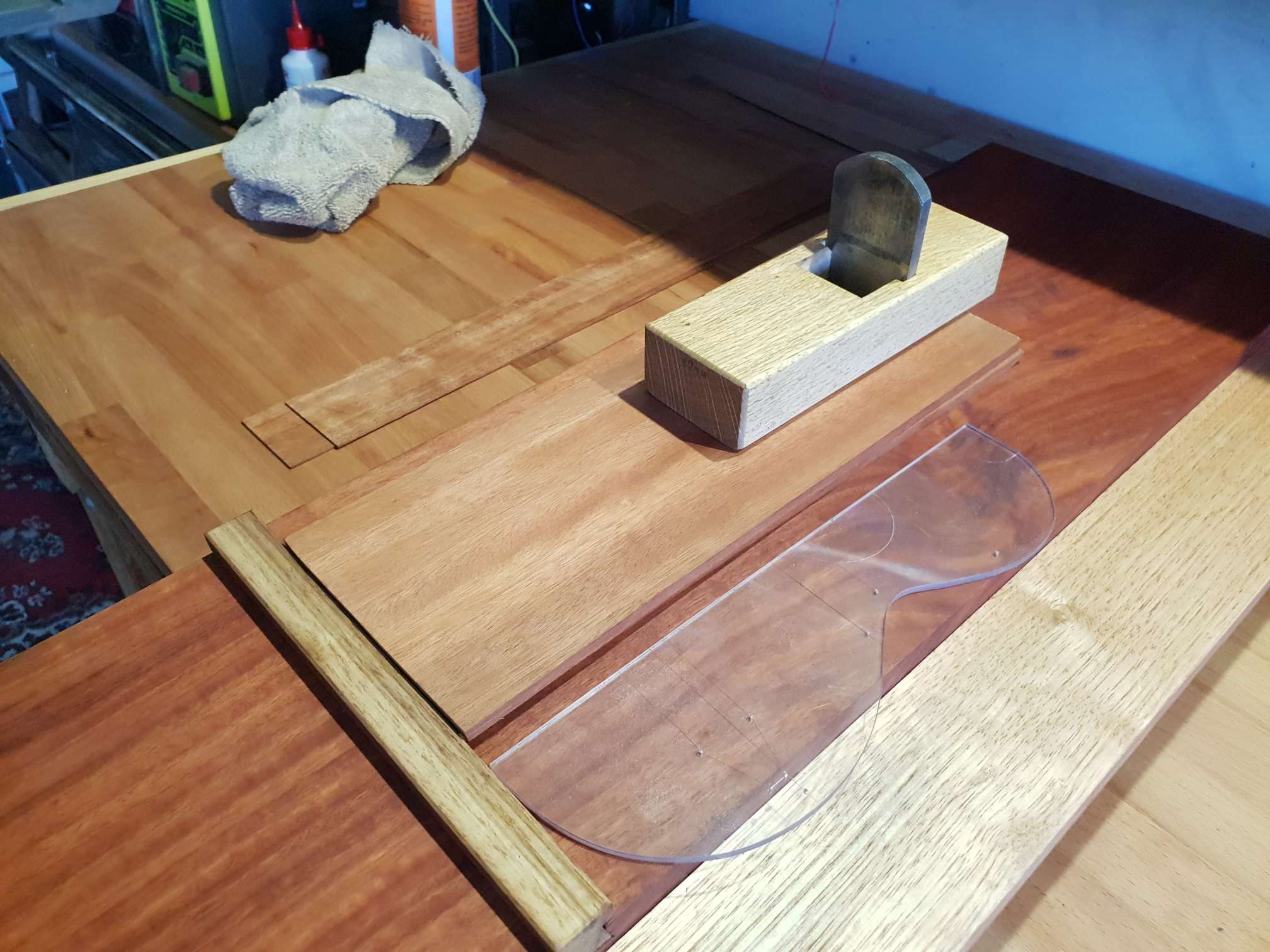

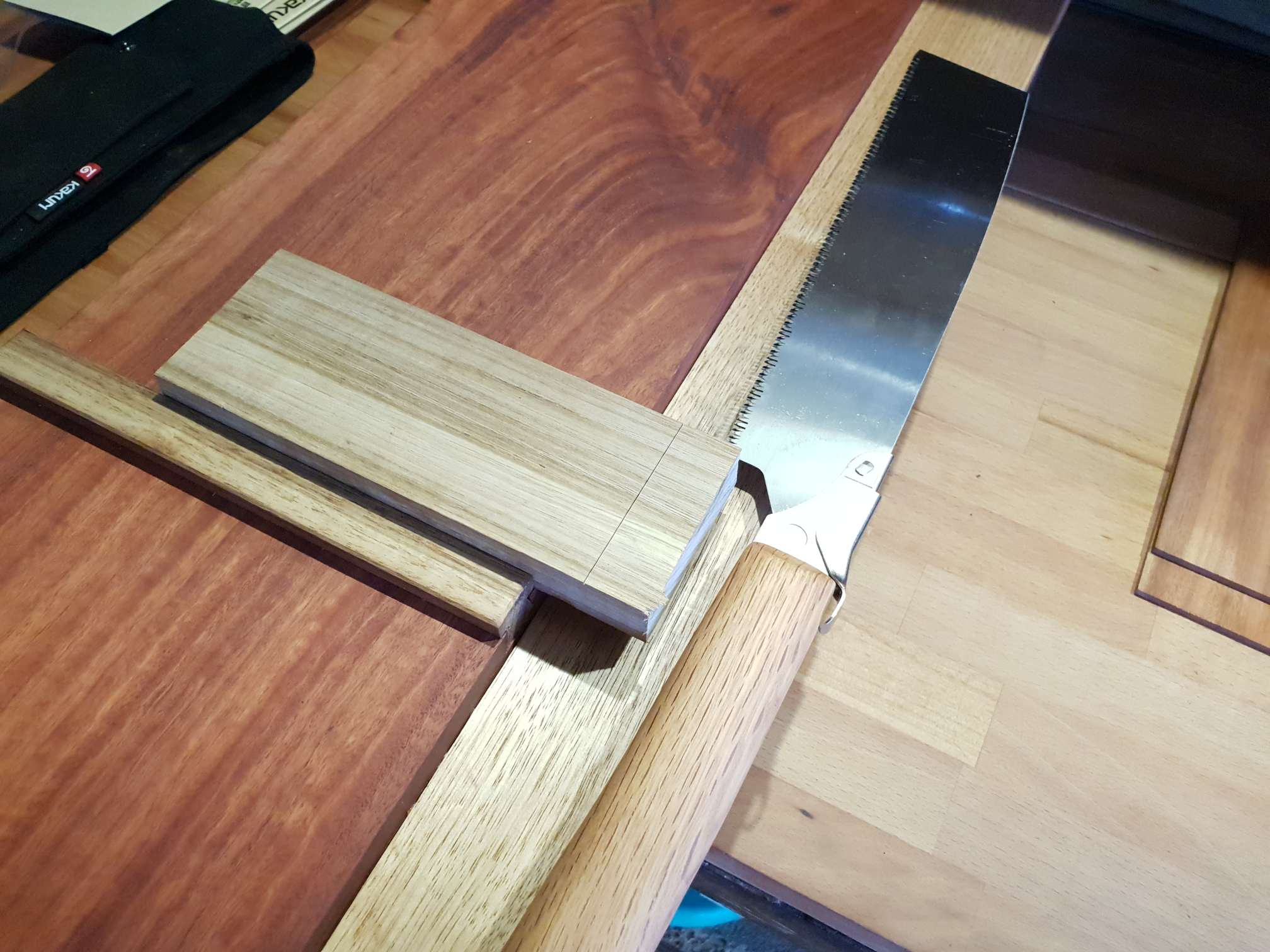

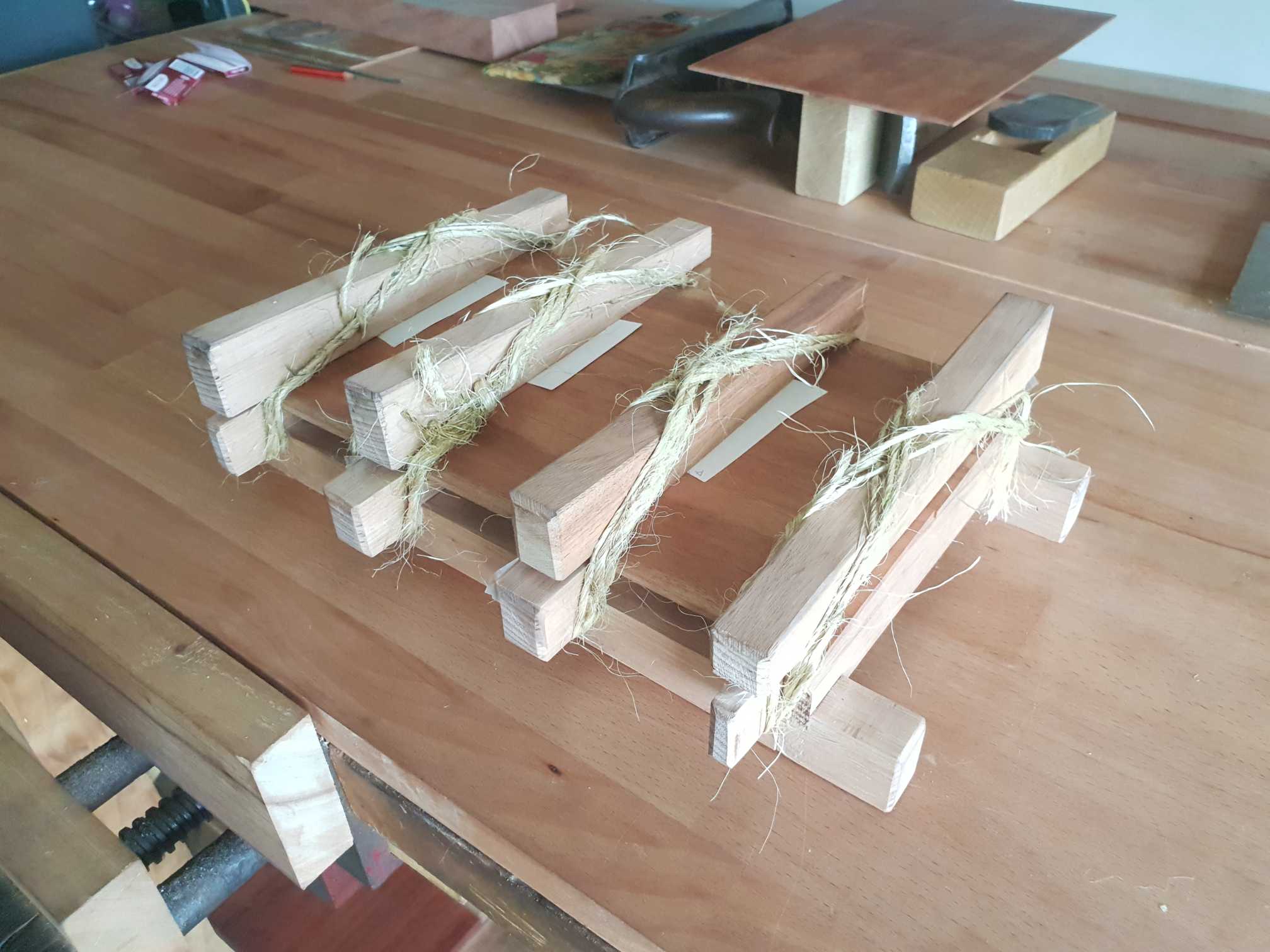

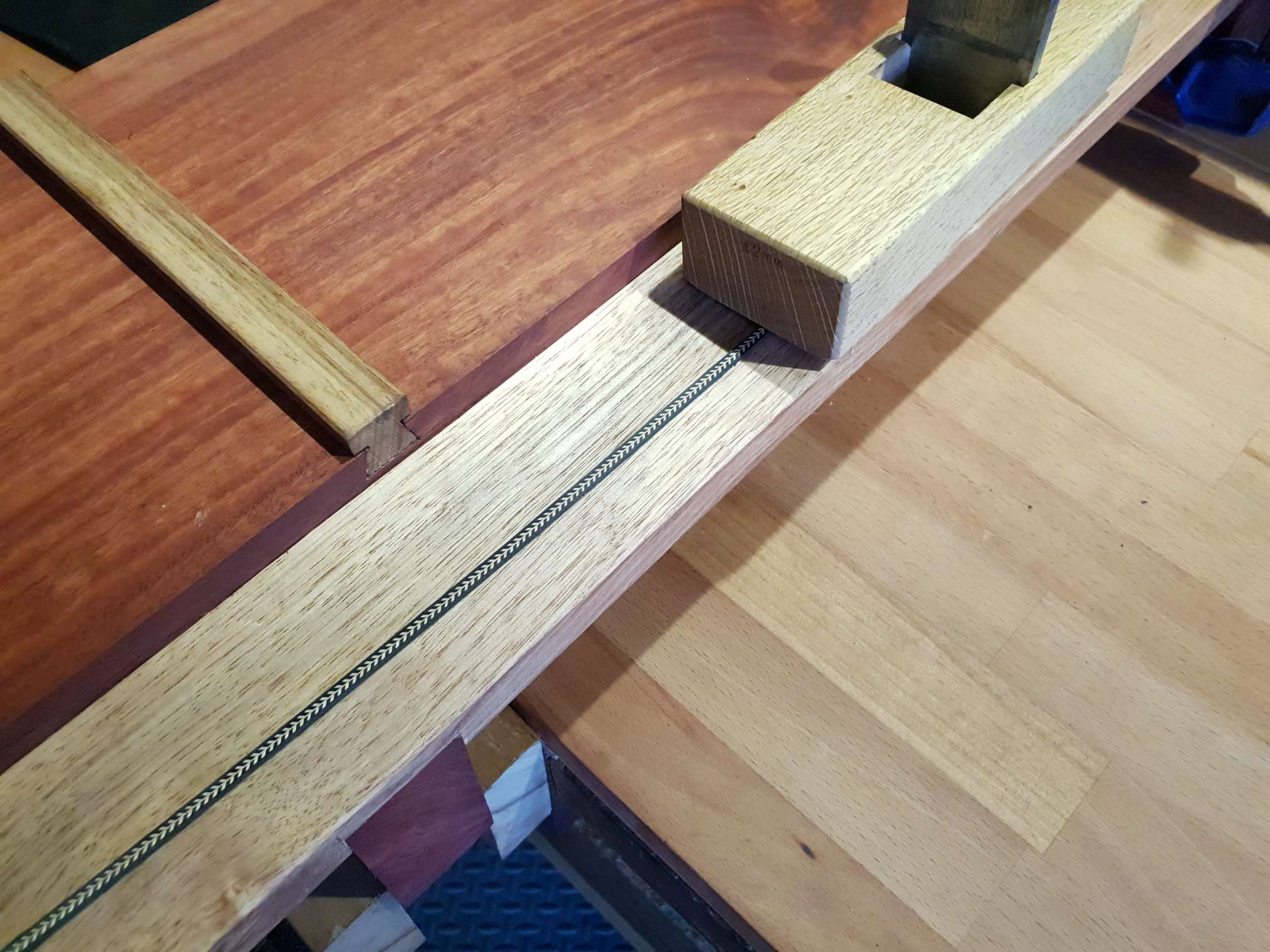

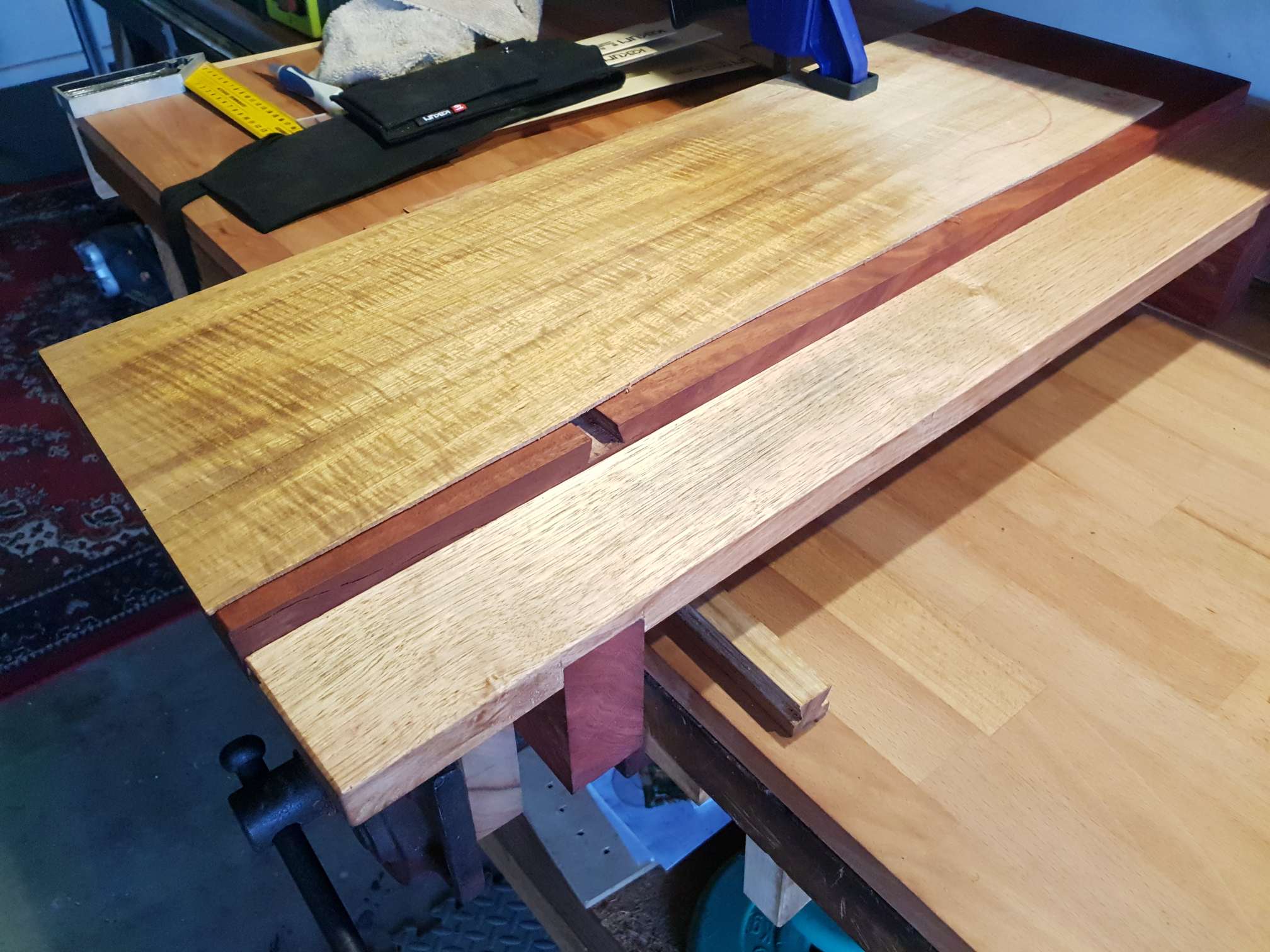

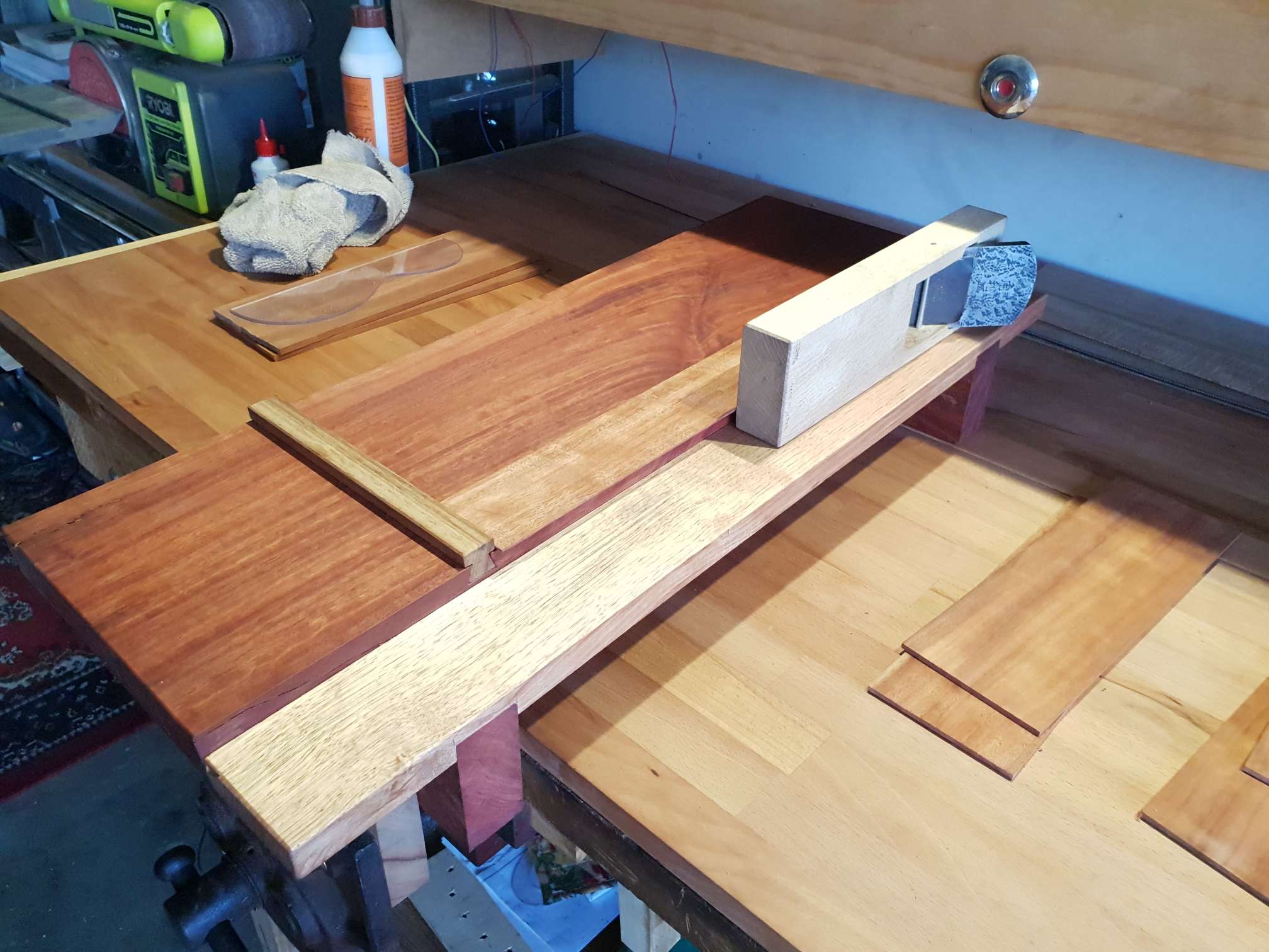

So it took two days not one but I am delighted with my Japanese style planing, scraping and sawing board.
Don't know how I managed without it.
It is a good heavy solid piece of kit which can be used on the floor or bench mounted.
I prefer the bench mount.
I am just starting to get used to the Japenese tools.
Well impressed.
I have tuned up the scraper plane which took a few hours and can now thickness two Uke sides quite accurately without using sand paper.
The blade in this thing is a monster and razor sharp now.
Here are some shots of the table in its various guises.
All the professionals amongst you of course have your own methods.
I am at the stage where I have to learn my own methods due to cash flow and tiny work space.
Well impressed.

Shooting mode.
Scraping uke boards mode.
Thats about it I guess
Some nice kit there Pete. Those Japanese planes are a joy to use.
Martin....Thanks.
I am on a new learning curve and well into it!
The Japanese planes need some setting up and nurturing.
I am still learning how to use them.
My blades are honed on only up to 3000.
I need a 6000 or 8000 waterstone to get shavings micro thin.
I am more than happy with what I have and need to master these first before deserving a master made blade and block.
I have tuned the large smoothing plane so that I could shave Tassy oak end grain. ( just to see if it would)..( and thena 30 mm thick piece of blue gum end grain) ...And it Did!!!!
I gobsmacked myself because you usually need a block plane for this after wetting the end grain.
This thing did it dry.
I am sold!
Thats why I was interested to know if anyone else uses Japanese tools?
I still have to learn what the best makes are as I do not know.
My planes are the cheaper versions but when set up correctly they are the business.
Pete

- lamanoditrento
- Posts: 617
I’ve never heard of wetting end grain. Can you expand on that a bit Pete?
If you have a really hard piece of wood and want to plane the end grain, by applying water to it wth a small paint brush it softens the wood at the end and makes planing it easier.
Pete
Pete

I have made a Uke version of the plates joining press from " The Books".
Gore has said that this device is an old luthiers trick.
I made mine from Tassie Oak.
I did a trial run using nylon cording.
It worked but there was a lot of slippage due to man made fibres....Nylon slips.
So I went to Millers and bought a roll of good old fashioned sisal string.
This stuff does not slip and is the business.. but looks a bit rough! .....well it IS rough which is why I used it....there is string and " String ".
Whoever thought up this device was a genius.
1 Air gets to dry the glue joint due to the open rack.
2 The sides are compressed together due to lateral pressure from the wedge driven through the figure of eight knot
3 The plates are held down by the wedges and the downward pressure of the figure of eight knots.
It is so simple and I love it to bits.
The pressure attained with this system is truly immense.
I needed a hammer to knock the wedges home.
I am truly wowed and glad I bought "The books!".
Pete
Guess what?..
It is 36 RH here right now so I have been belting along with the Nunes style Uke.
Well the head is not!..
I have seen this head design before and thought it would blend in with the skinny Uke shape.
I am going to see If I can thickness the back today and glue it on as RH is right.
It is such a small uke I am not going to bother with bracing. Hopefully then there will not be a splitting problem.
I found binding the neck to the mould easier and more friendly to the finished neck by binding it with strips of inner tube rubber rather than leave string indentations and wedge Mark's on the neck.
Back to the cave!
Pete
Back to the cave!
Pete
