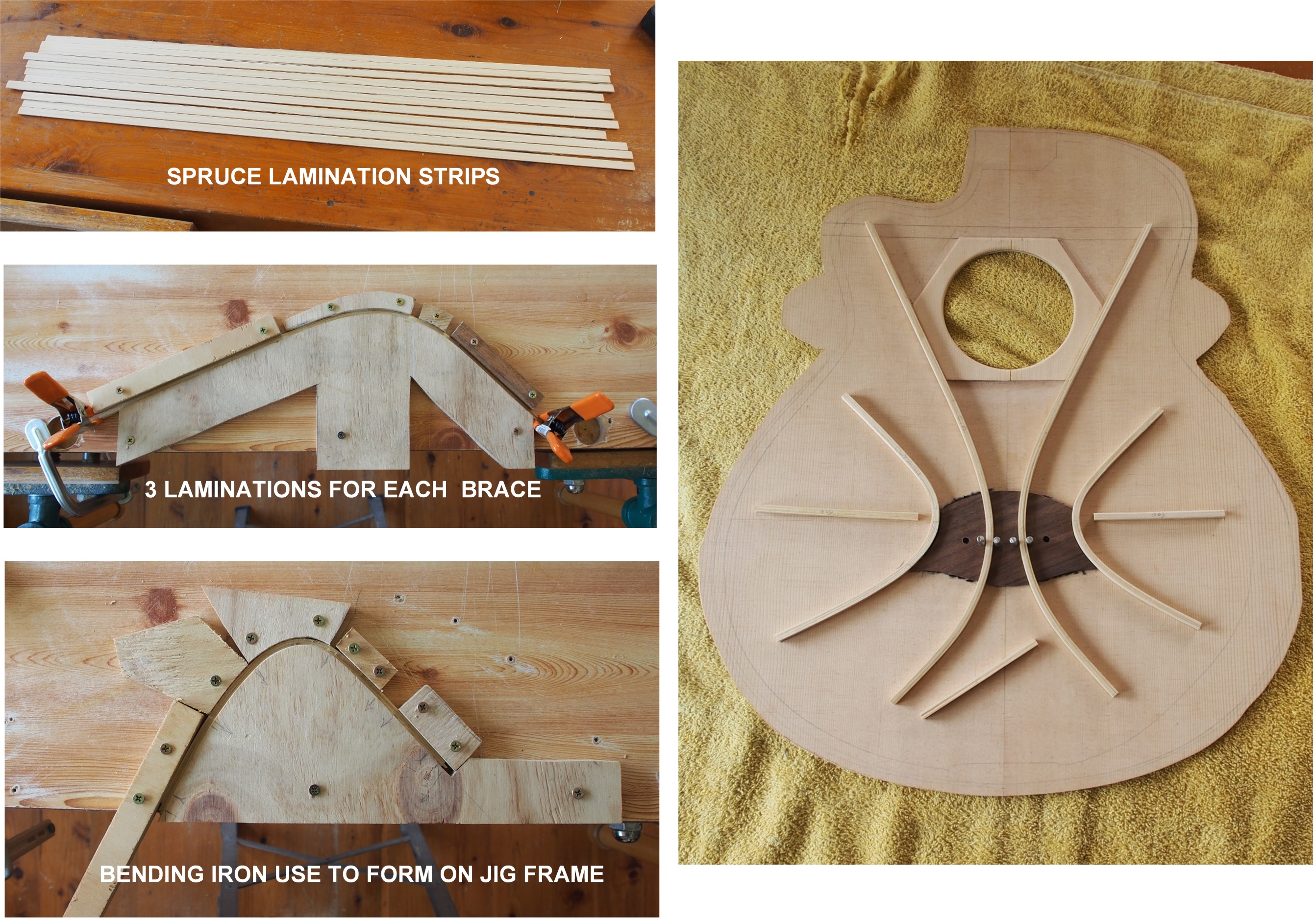

I have also used spruce to make Falcate Bracing and had no issues. Refer to photo attachment.
Re: Classical Build (s) - Hopefully falcate!
I always struggle bending spruce so use 4 laminations. Particularly the secondaries. It works fine

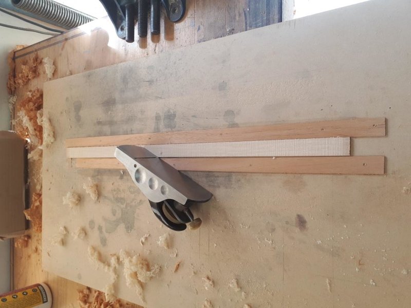

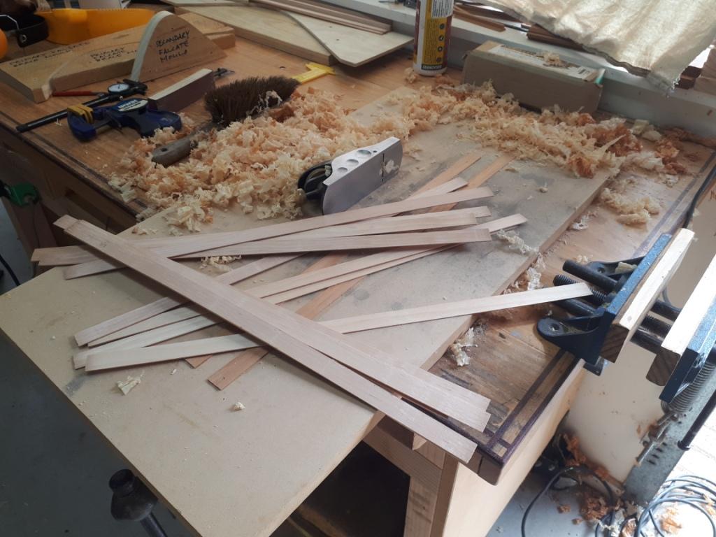

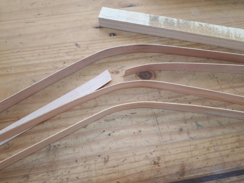

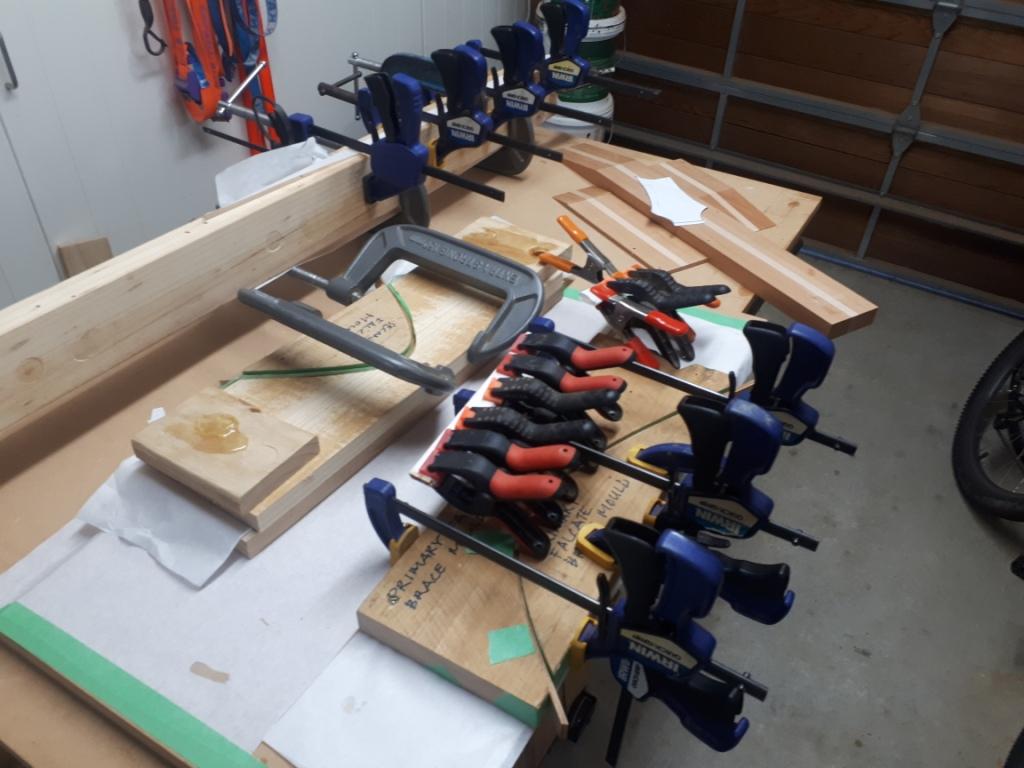

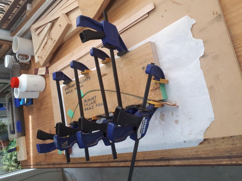

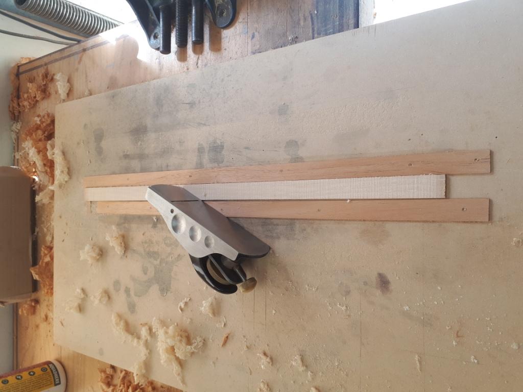

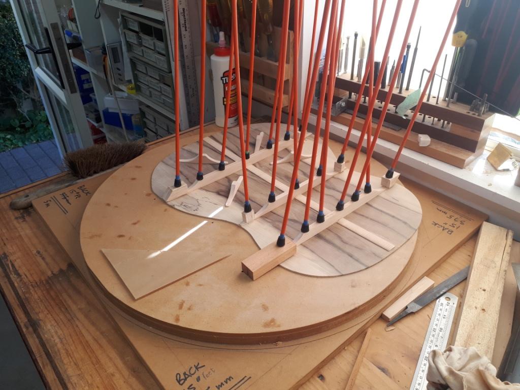

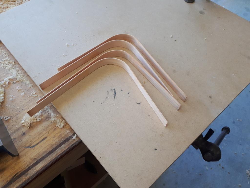

Today was brace day... The primaries are easy but the secondary braces gave me a lot of grief even using 4 plies. The only way I could get the spruce to bend was to wet it. I've put that in the mould to dry out over night and I will attempt to glue it tomorrow. Might start again though, as its not perfect.

Great to see you keeping up the various challenges as you progress.
I used 'Adirondack Spruce' for my braces. The secondary braces were a little more difficult to bend. I did break one laminate. I then had to be more careful and patience when using the bending iron for the secondary brace bends. I was able to only require 3 laminates per brace.
My build is a Steel String version and I have now finished the guitar last week and I am very happy with the result. I will post it in the 'Gallery' soon.
I'm certain you will succeed! It will be worth the effort.
Yup lots of those misshapen and broken plies. As Wayne says real care on the iron and one does get better. I still do 4 plies and sometimes you hit a spruce that simply won't go. Try a completely different batch.

Cheers Dave, problem is I only have one batch... But all is well as I bent them no trouble this morning, with a lot of wetting. Ill glue those up tomorrow. Had a big glue up session to day and not much else got done on my guitar. My sons electric is coming along though!!

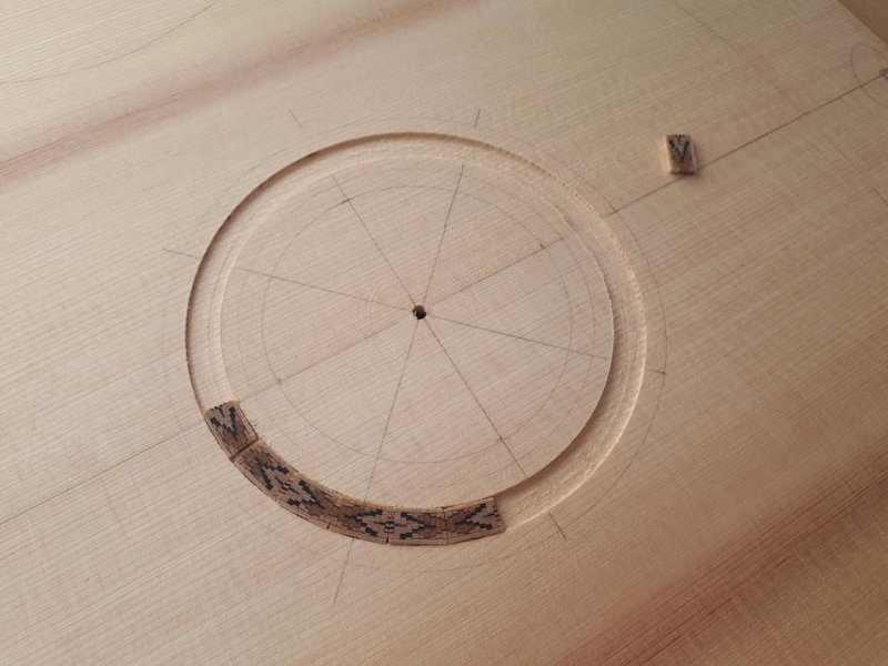

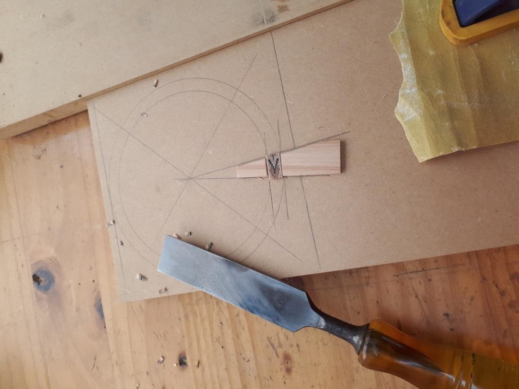

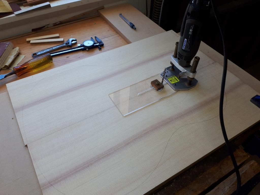

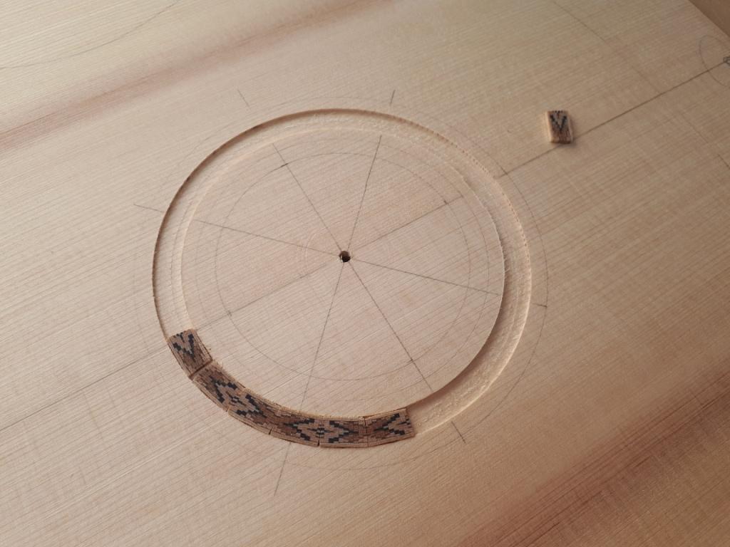

Routed out the rosette channel and put the first and main ring in using the block I made before. One "stick" about 200 long will do two rosettes.

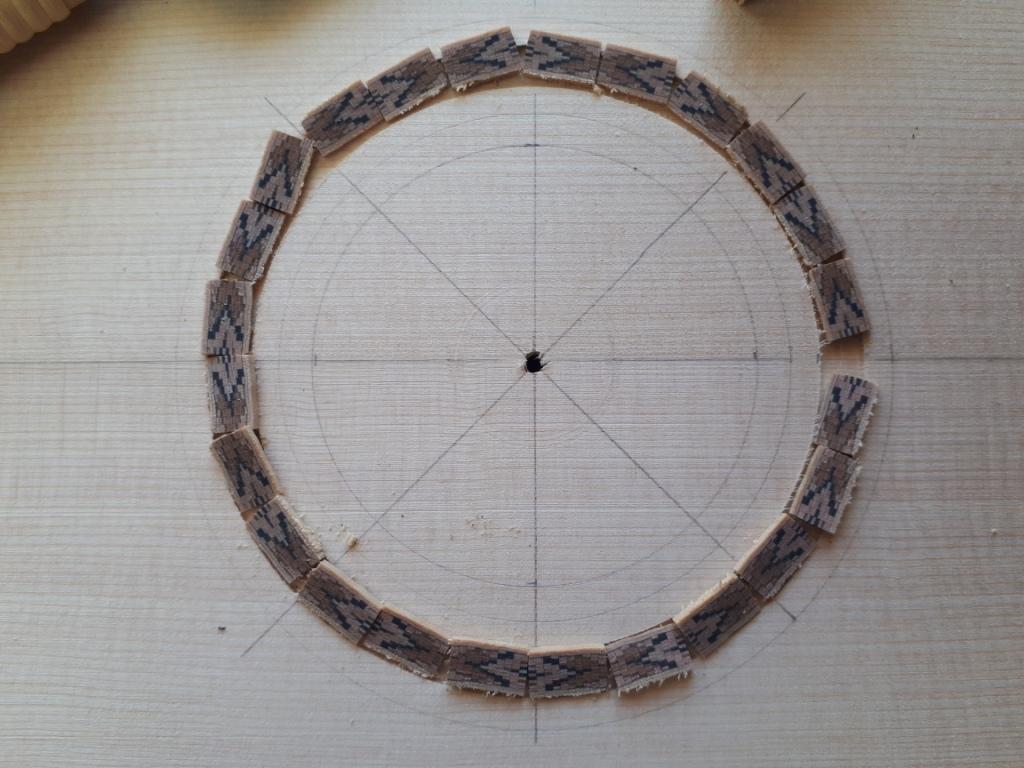

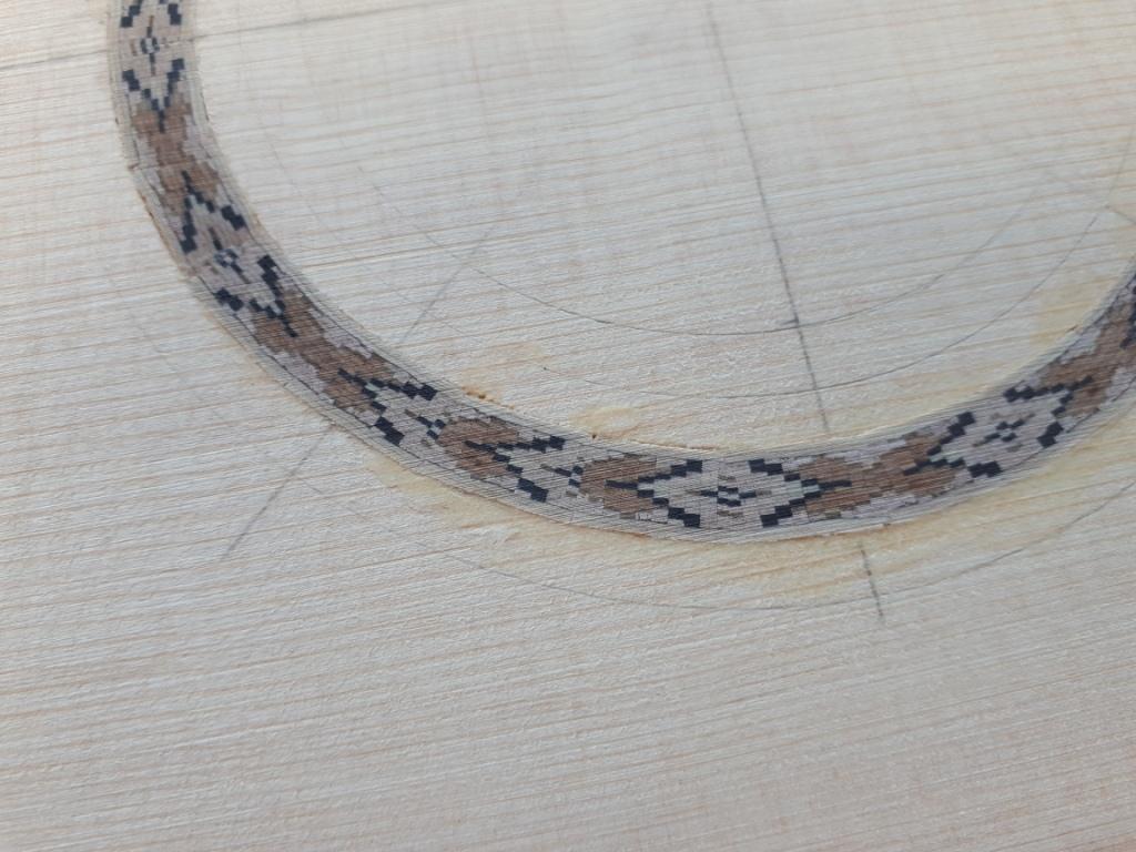

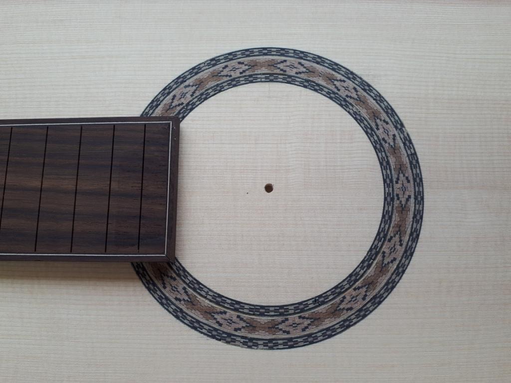

Oops. 15 mins with the dremel fixed that though and overall I am very happy with how the rosette has turned out. It definitely looks hand made which was the whole point of the exercise. I really enjoyed making it and I have enough "block" to do another one of the central bit, just need to make more outer which I would do a little differently anyway - less black more brown. The back is braced and fitted to the sides. I have left the central brace unmolested for now. Easier to take material off than put it back as Trevor says. With this done I can turn my attention to the all important top bracing.

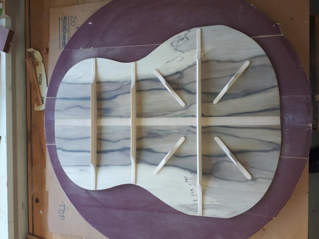

I have nearly finished my first falcate braced top. Just have the CF to go on the top of the primary braces. Not as hard as i had expected but not the prettiest to look at. Bits of CF peek out from underneath the odd brace and i managed to put lots of epoxy in places that didn't need it.

So bracing all done now. Neck finished. Back is done. Next job will be to start closing up the box.
