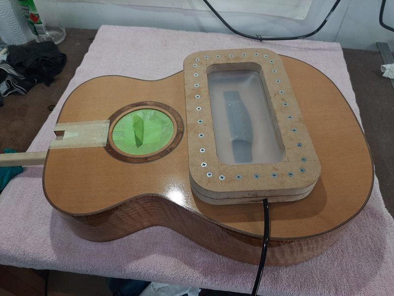

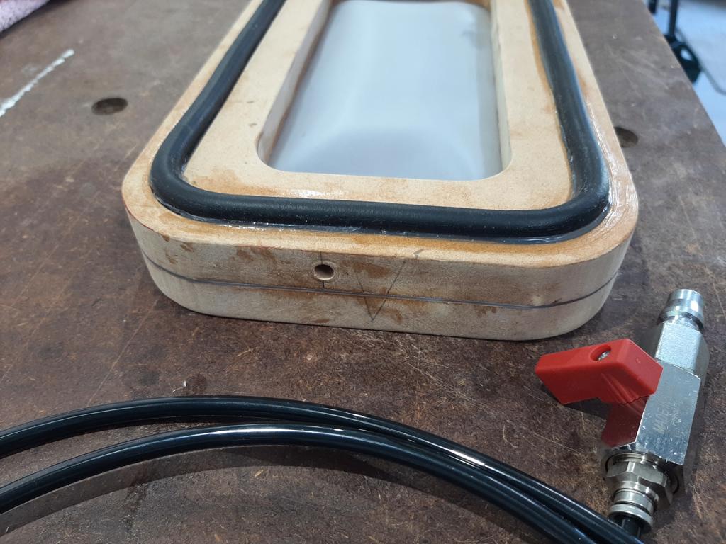

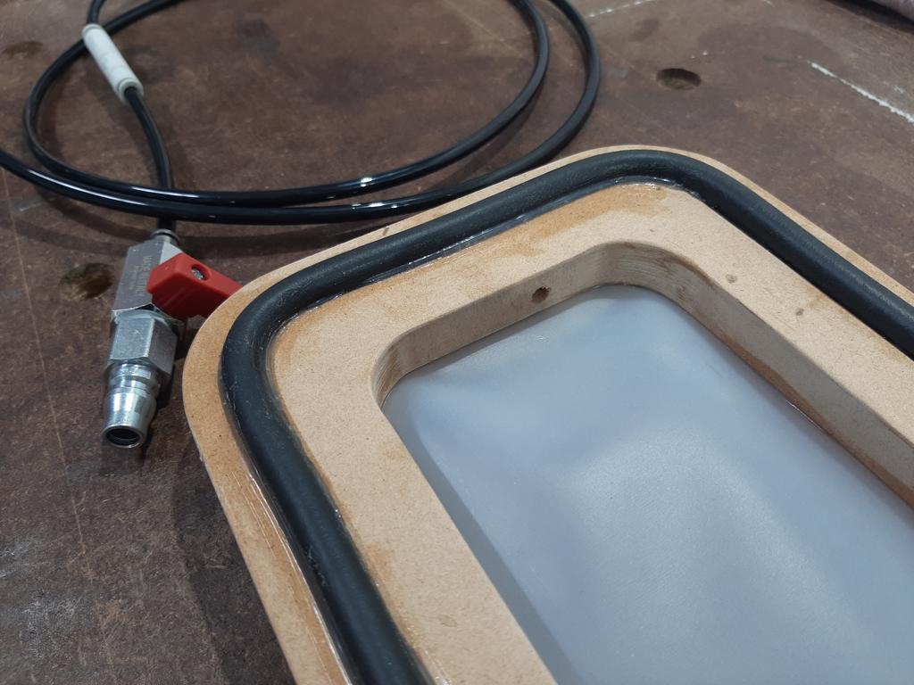

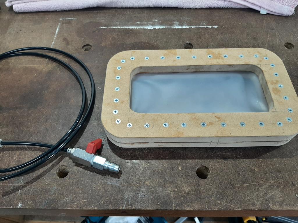

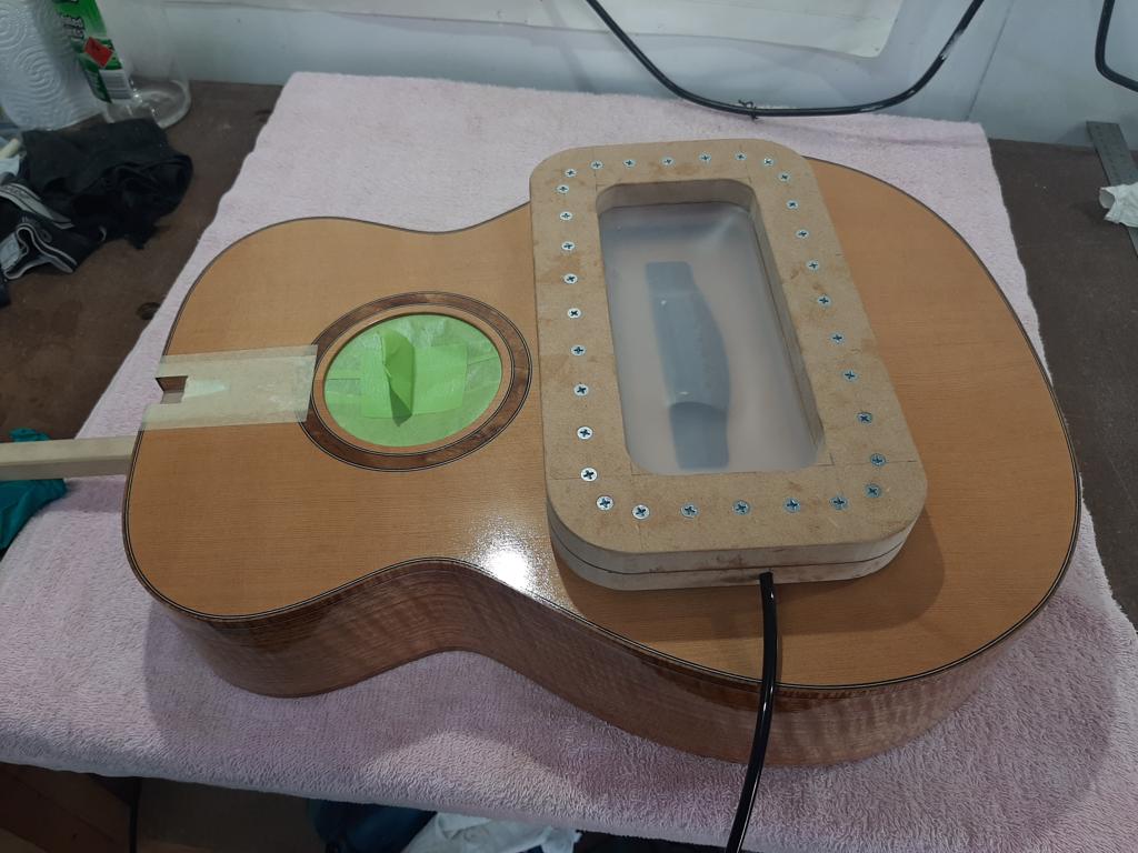

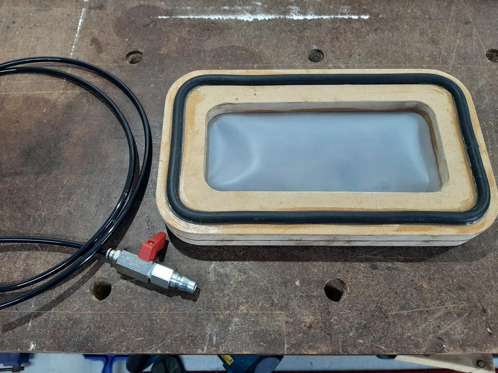

Here's some pictures of a vacuum clamp I made.
Frame is 19mm MDF.
Silicon membrane is a 2mm or 3mm silicon cutting mat I bought from an art supply store.
Sandwiched together with silicon sealant.
The vacuum generator, tubing and compressor connections are from guitartemplates.com.au (A local Brisbane business I can recommend. They also sell more professional versions of this clamp in large and small sizes. Check them out.)
The vacuum tube is simply a friction fit in the clamp hole. Worked very well for my build.

:cl Wow that is really good. And you've added a valve so that the clamp will hold its vacuum without a pump. A commercial one I saw didn't have that. Thank you for this post. I started a cam clamp today and ordered the Titebond, but I might have a go at a vacuum pump one day.

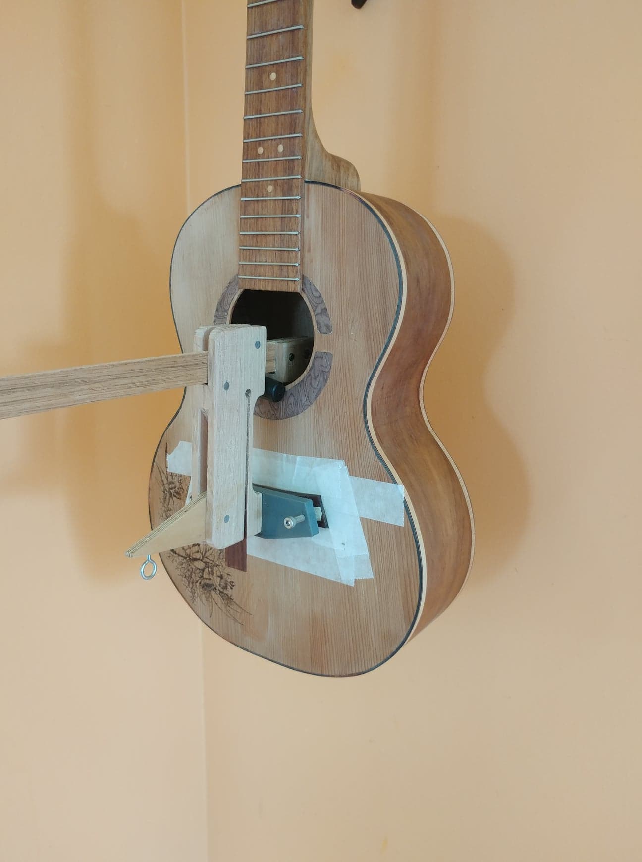

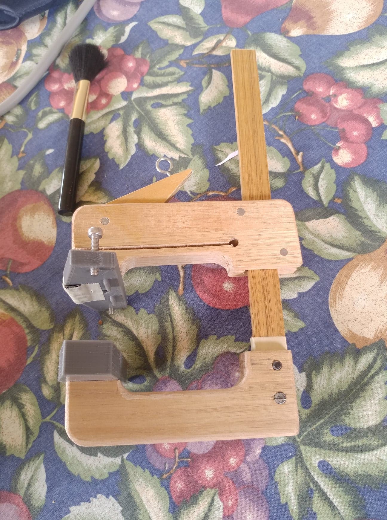

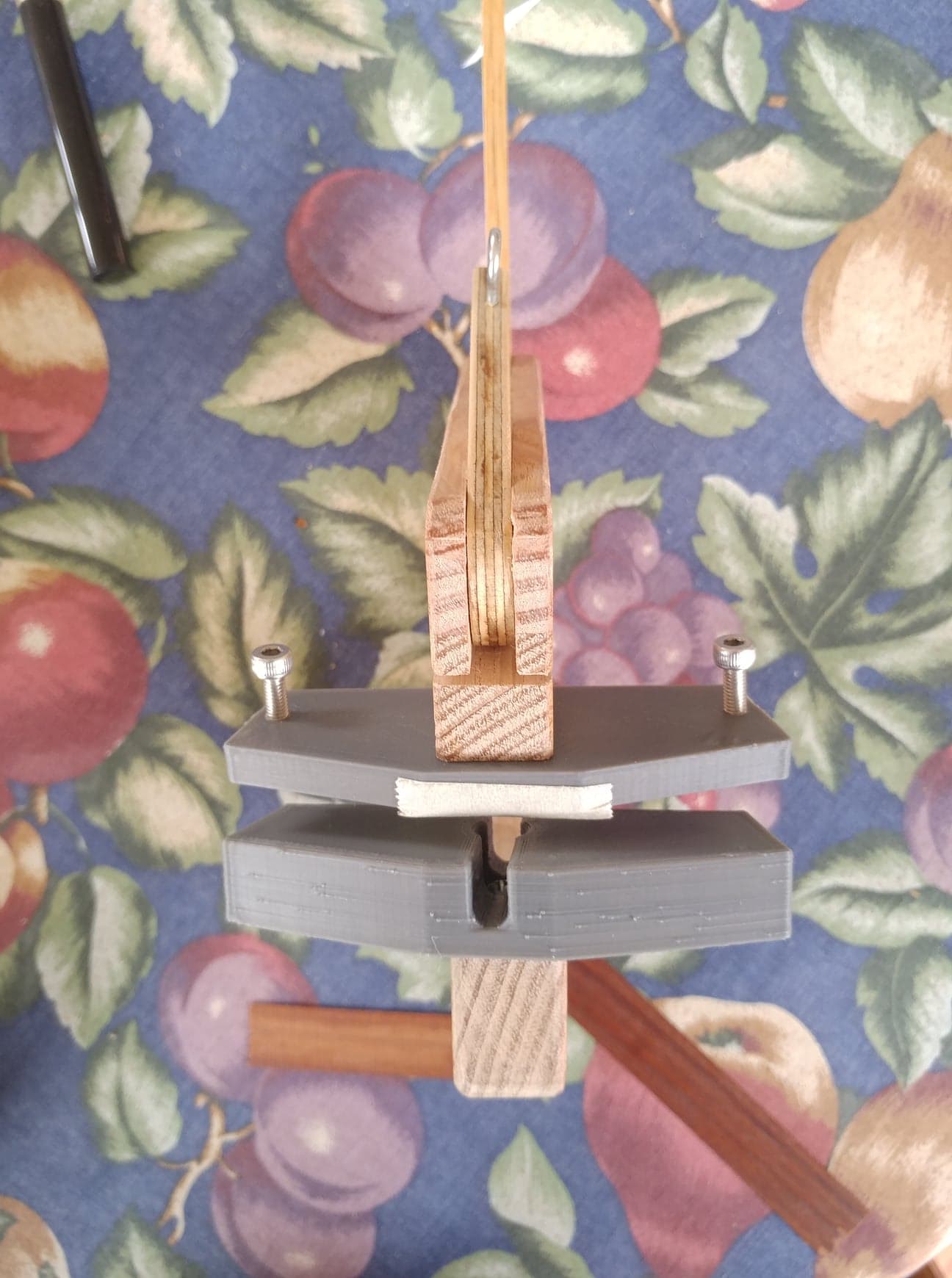

I thought I would show my appreciation for advice given by providing an update.
1- Made a small cam clamp with purpose made 3D printed clamp pads - this ensured that the pressure was spread evenly over the bridge while the glue set. Note the groove on the bottom pad - This groove straddles one of the braces that runs under the bridge. Two M4 screws ensure that there's pressure at the thin ends of the bridge.
The clamp bar is made of hardwood (VIC ASH). I tried steel but it was too slippery, and the weight distorted the top while in use. The 5 mm wooden bar strong enough and makes a considerably lighter clamp.
2- Cleaned up the back of the bridges (2 ukuleles), re-sanded the top both around the bridge area and generally, masked the bridge area so that squeeze out was not a problem.
3 - Glued using Titebond original. left the clamp on over-night. Restrung several days later.
All of that occurred several weeks ago... so far so good.
I am now convinced that the No-Name PVA that I was using was either poor quality, perished or both, but I thought that I may as well eliminate any other problems by being careful with sanding, clamping etc.
Thank you for taking the time to provide advice.
Jorge
