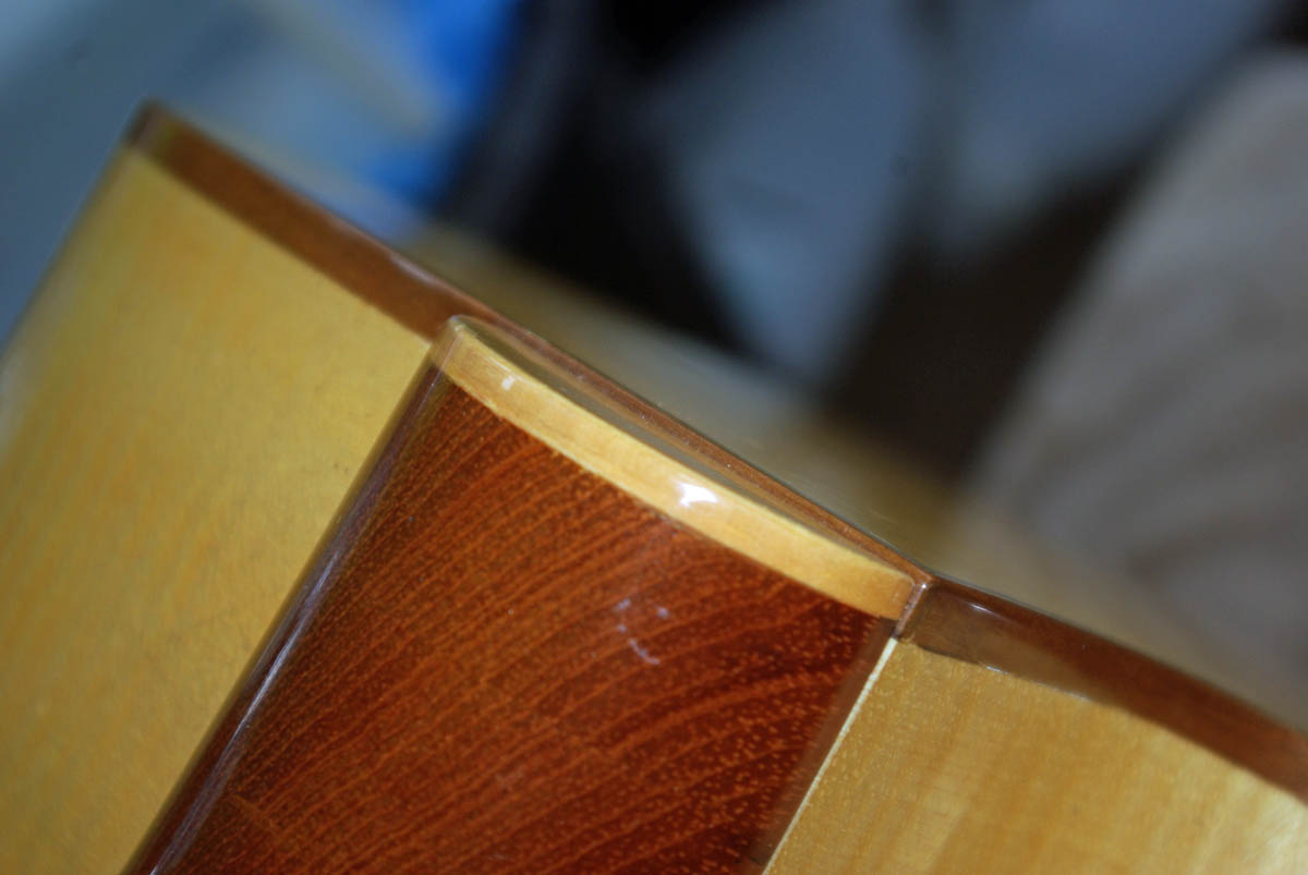

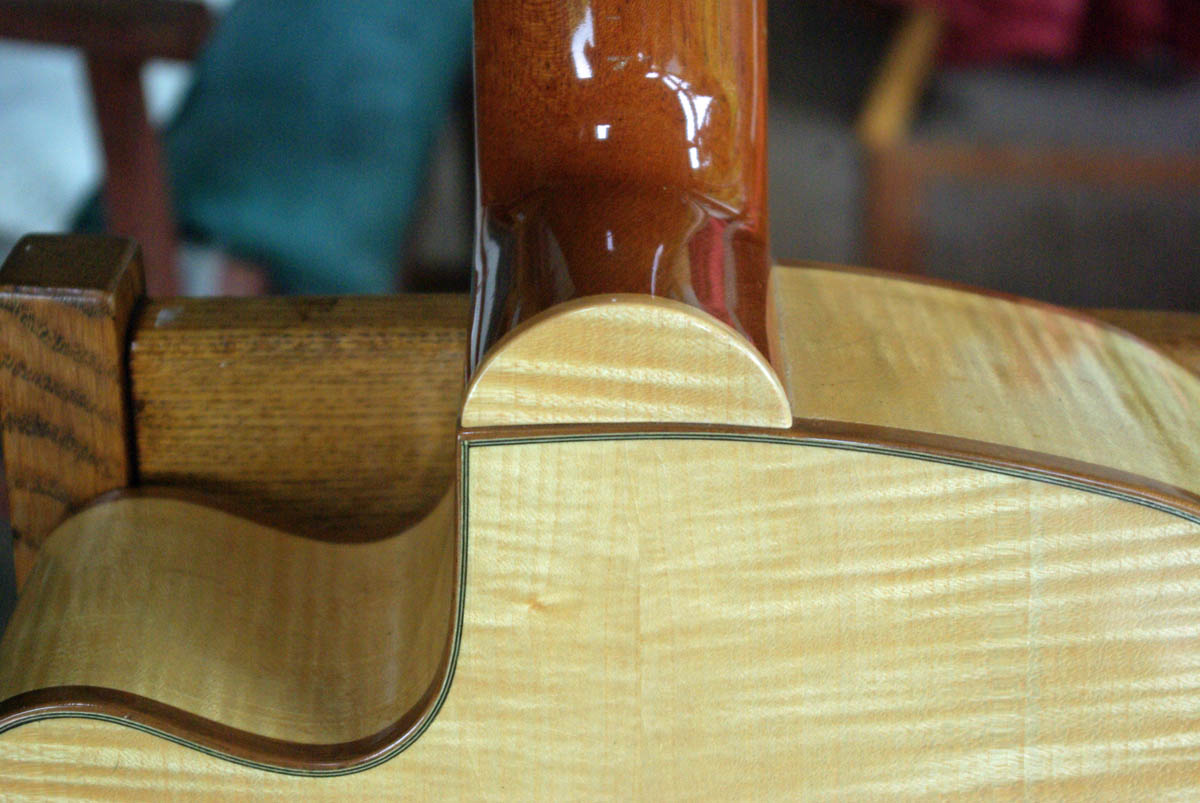

Post by Dave M » Thu Aug 08, 2024 8:38 pm
Like this:
Like this:
That looks great! Thanks for sharing - I'll keep that in mind for the future.

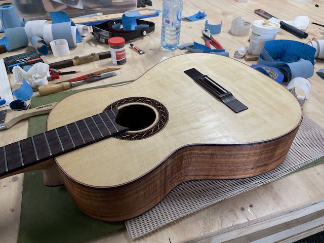

I arrived at the workshop, and took off the clamps. Here we are with an attached bridge:

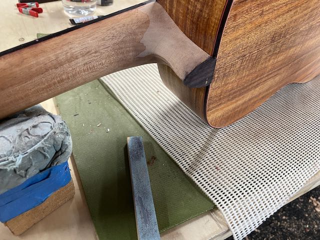

Shaping the heel cap to fit:

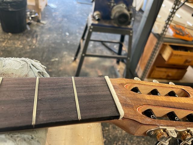

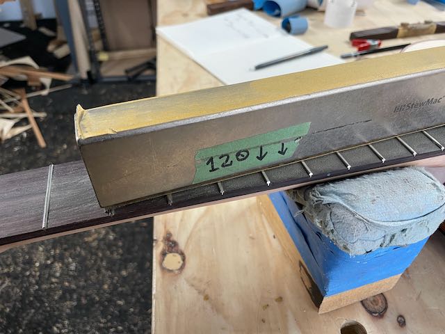

Levelling the frets:
240809 fret levelling.jpeg (309.97 KiB) Viewed 11023 times

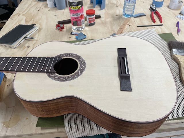

Adding just a little french polish for protection:
240809 a little FP A.jpeg (342.97 KiB) Viewed 11023 times

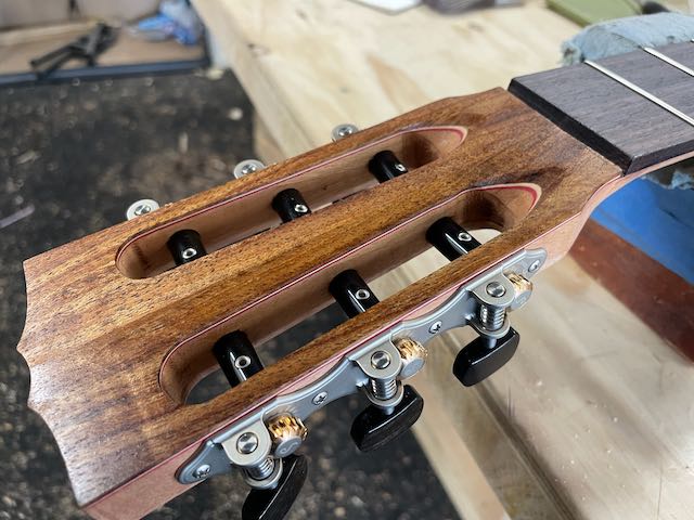

nut installed:

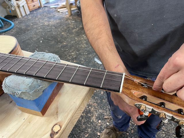

And strings going on:

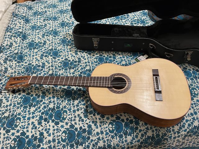

From here I didn't take any more pics in the workshop. I was too interested in actually testing out the finished guitar. It sounds really good and plays well. Nice attack to the notes, lots of volume.
Here's a pic I took at home yesterday:
