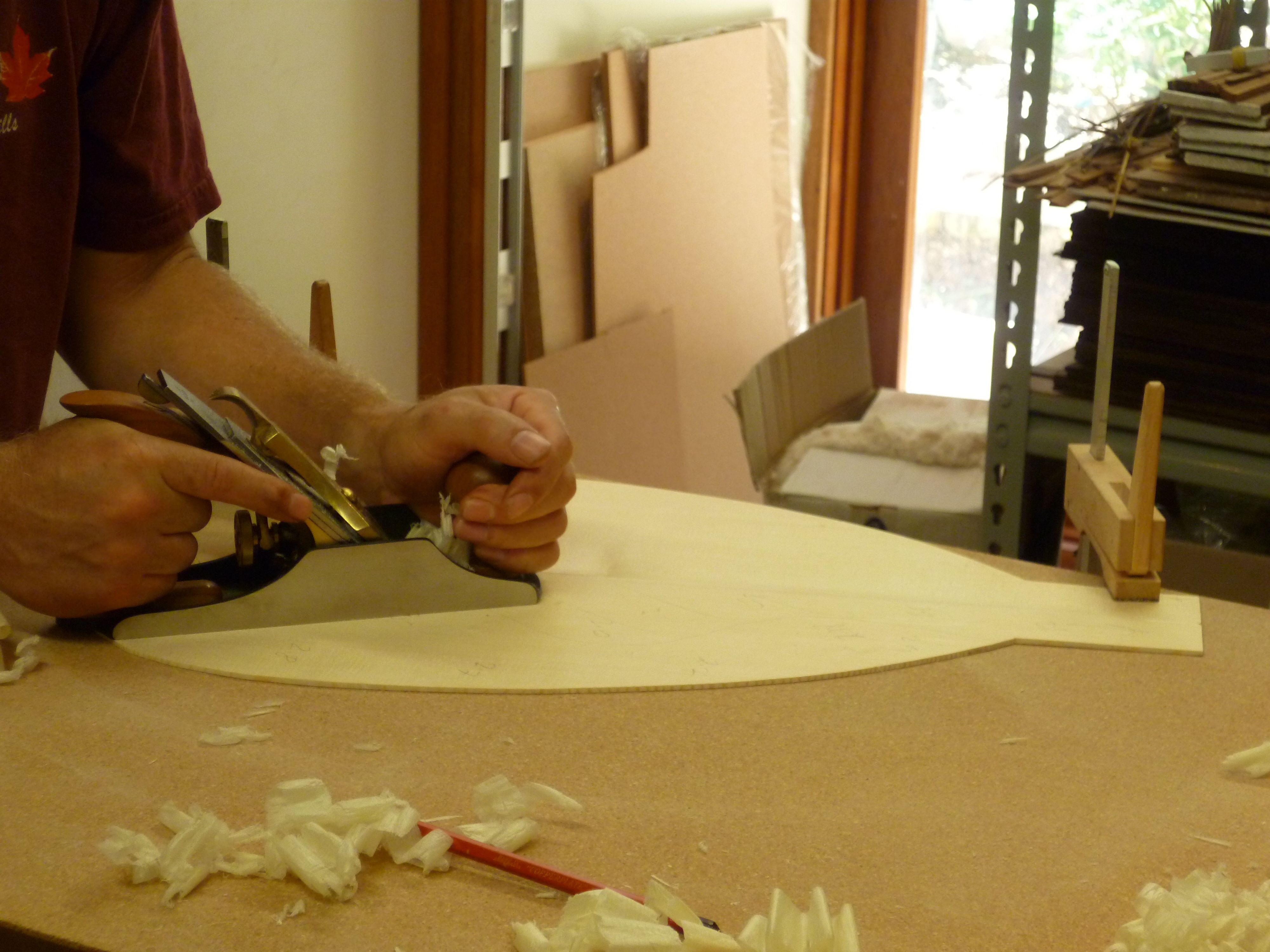

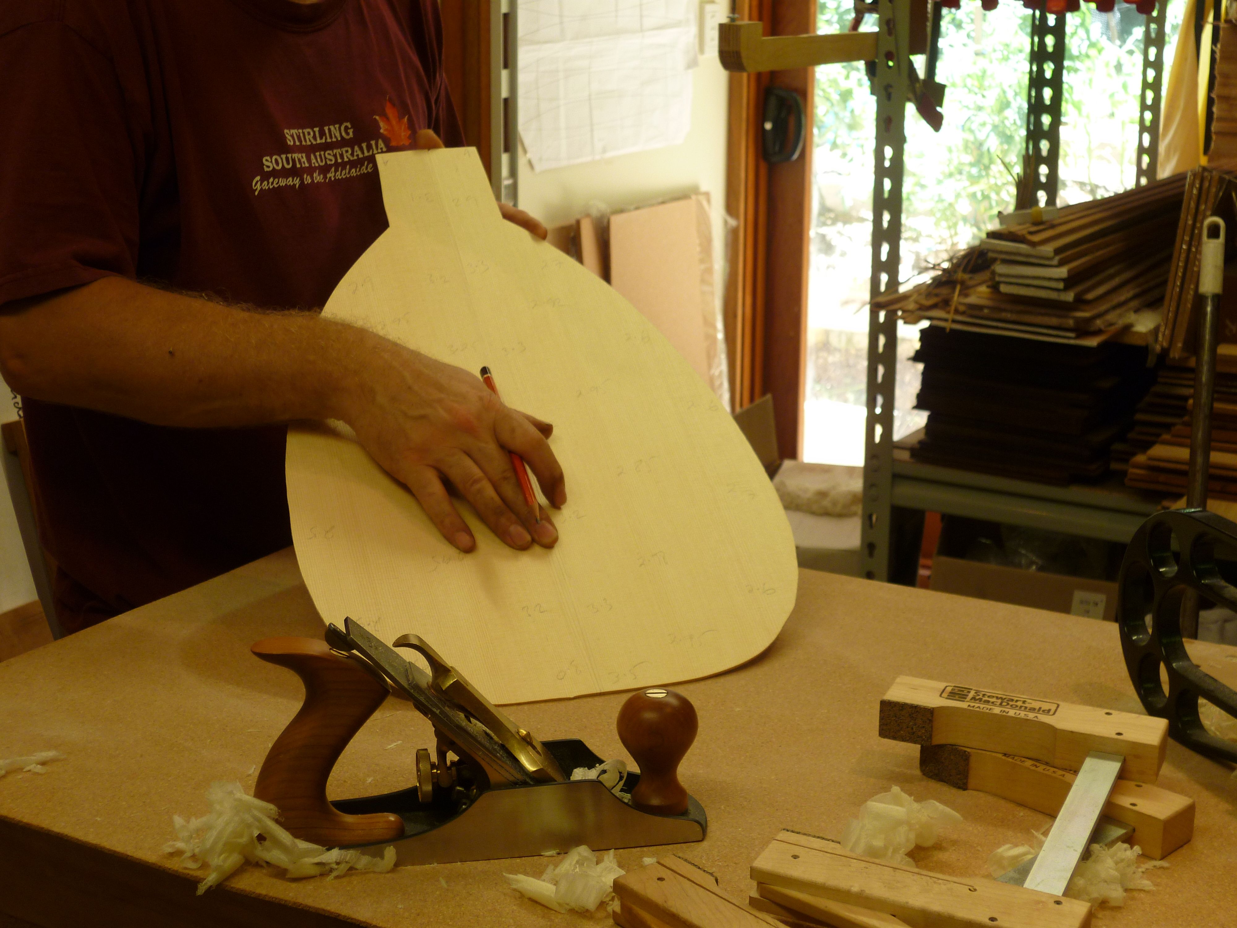

Found a bit of time this week to work on the lute in between hours spent on the bike training for the SA Police run ride this Sunday here in Adelaide.
Glued up the swiss spruce soundboard (from Tim..thanks) and got it rough thicknessed to around 2mm. Exact thickness was determined by flexing the board after each planing session as shown in the photo. Next step is working to final thickness with scrapers and the block plane. The top on a lute is thickest around the bridge area and thins down to around 1.3mm around the rosette area.
Re: Lute Progress - Test runs for cutting the rosette
Post by Kim » Fri Jan 14, 2011 7:37 pm
Lovely silky swiss spruce shavings coming from the L&N smoother Marty. 8)

Post by kiwigeo » Fri Jan 14, 2011 7:56 pm
Yeah I really love that plane.....ya cant beat a well made hand tool. I usually work with a toothed blade in my guitar tops but for the lute top I sharpened up the standard blade and had it adjusted so the shavings coming out of the throat of the plane were transparent.

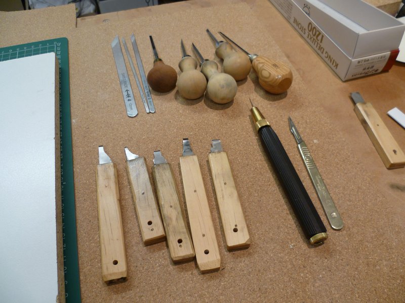

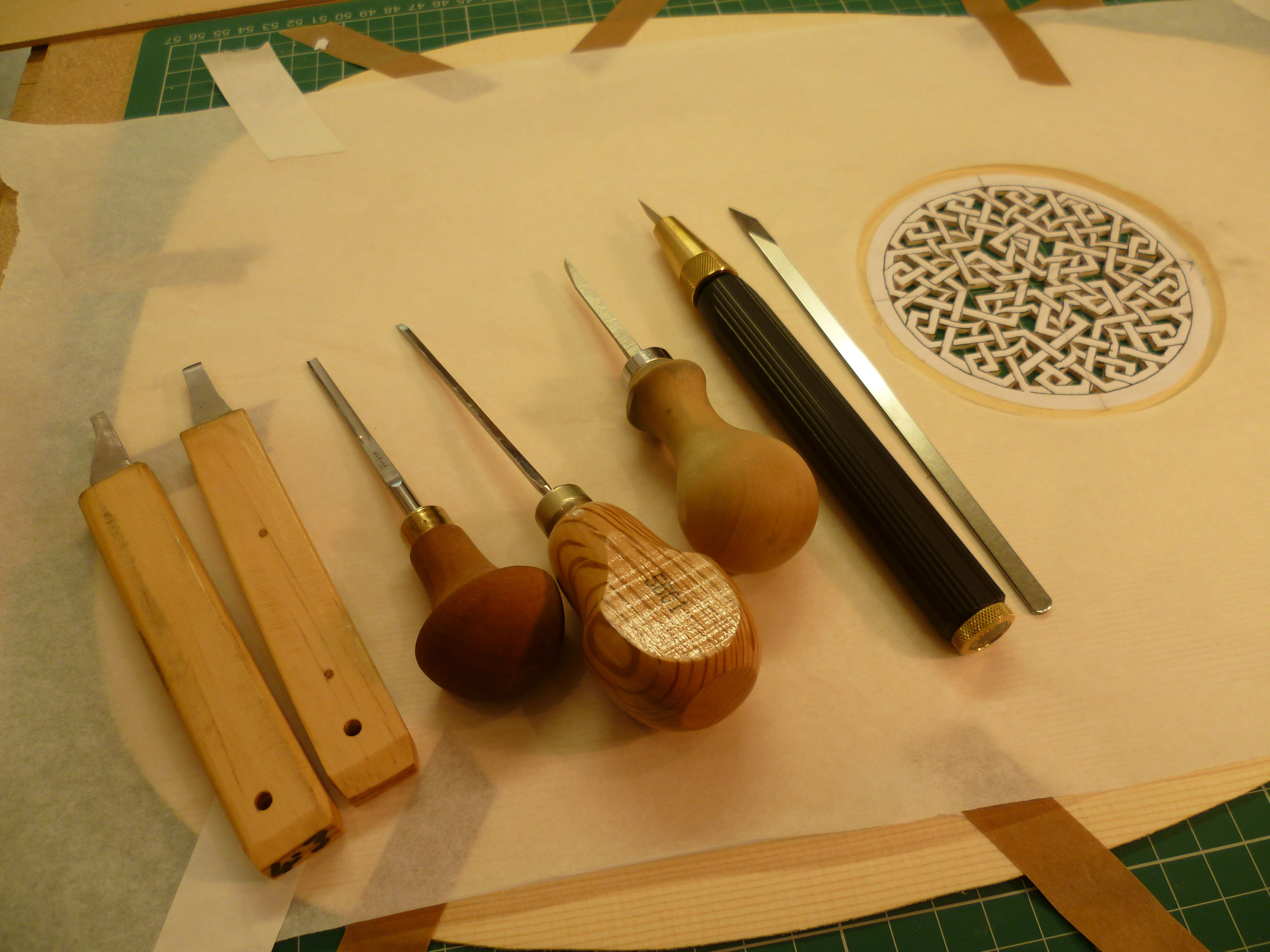

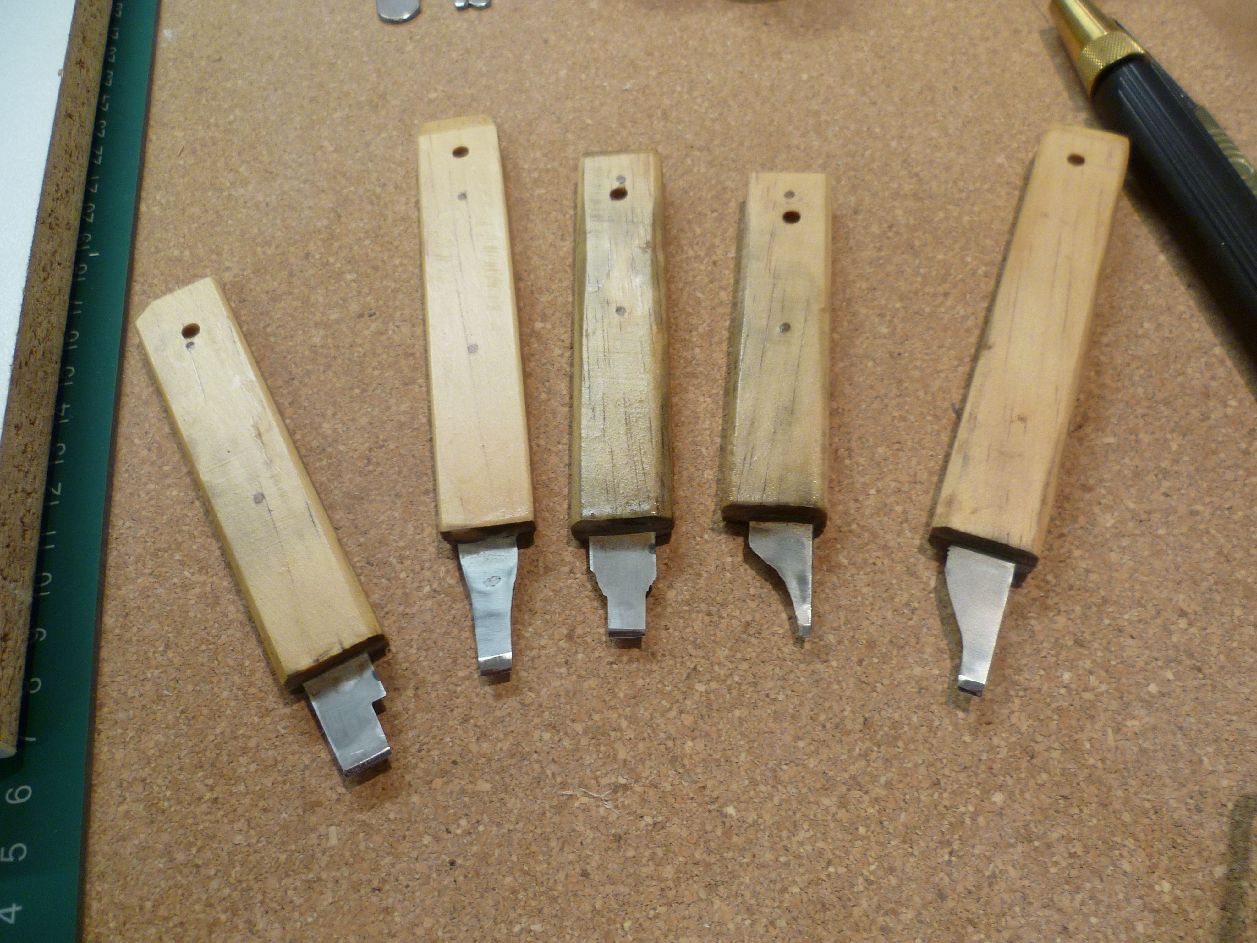

We wanna see those microchisels you made
Posts: 10873
Post by kiwigeo » Fri Jan 14, 2011 10:27 pm
matthew wrote:We wanna see those microchisels you made
Oh yeah I forgot about them. Theyre not as pretty as the LN plane but theyre functional. Ill put up some pics tomorrow.

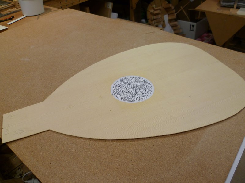

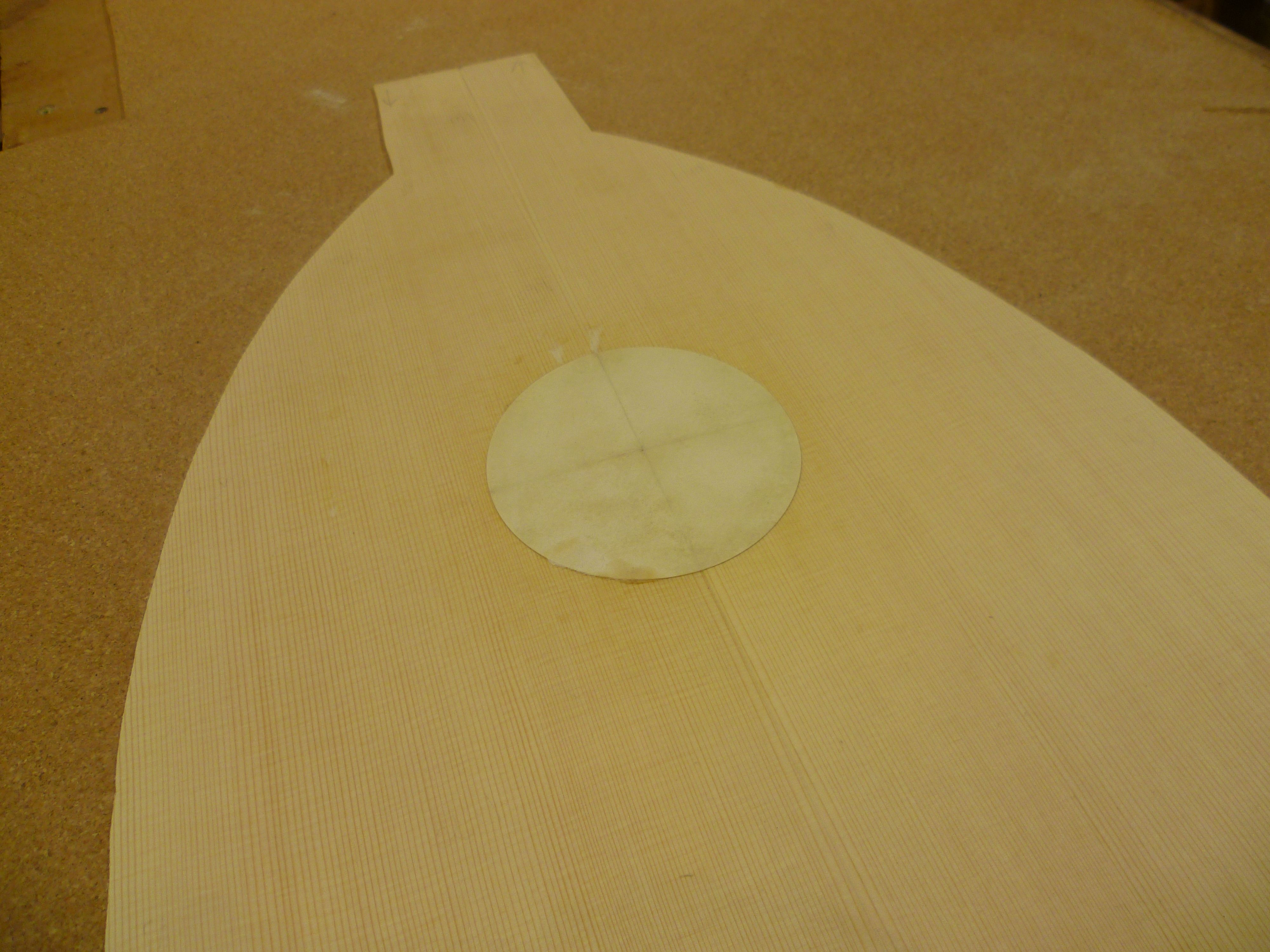

Post by kiwigeo » Sun Jan 16, 2011 6:38 pm

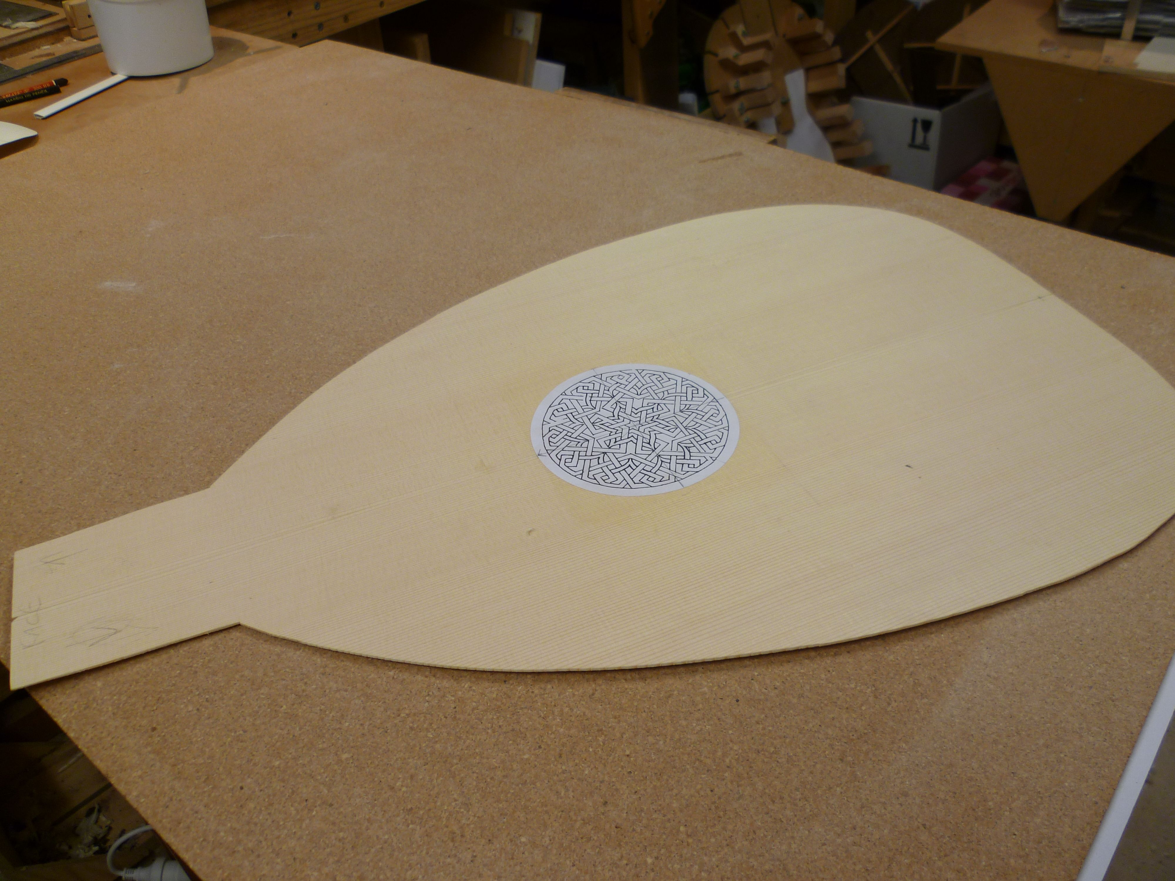

Latest progress. The top has been worked to final thickness with a block plane and then scrapers. Thickness is around 1.8mm just south of the bridge and gets down to 1.3mm in the rosette area. The rosette pattern is glued on the front of the top and a reinforcing patch of fine art paper is glued on the underside. Pics of the tools Ill use to cut the rosette are pictured including the microchisels I made up from hacksaw blades. The handles are a bit rough but the blades are razor sharp.

Seeing those chisels reminds me I have a few knives and thumb planes I must make for the next build. I enjoy making tools, but it always seems like a distraction from the main game.

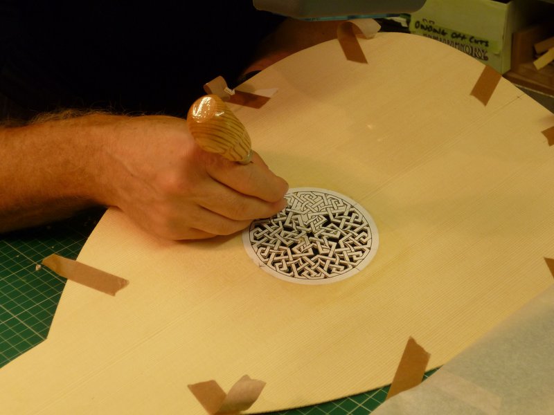

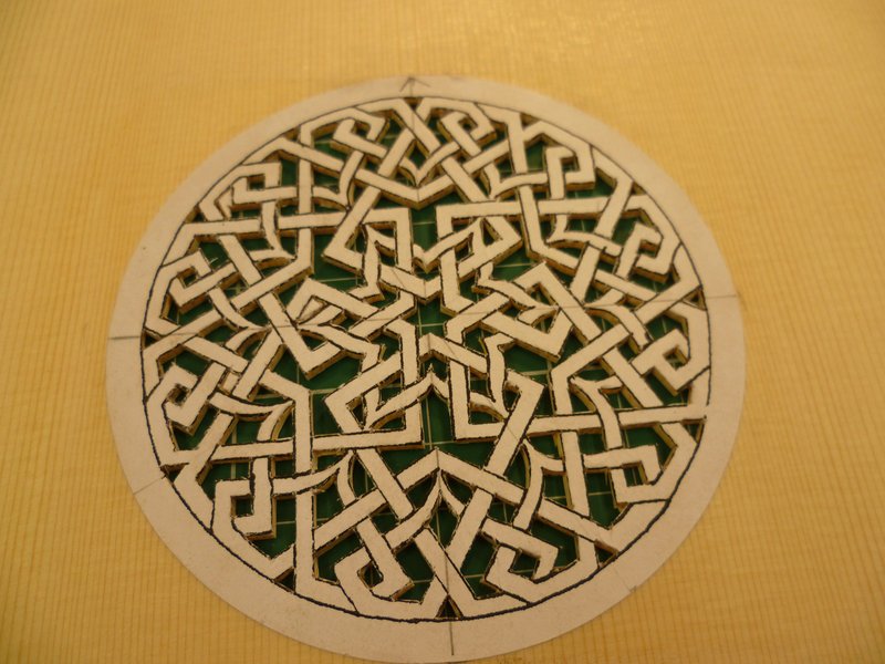

Post by kiwigeo » Mon Jan 17, 2011 6:13 pm

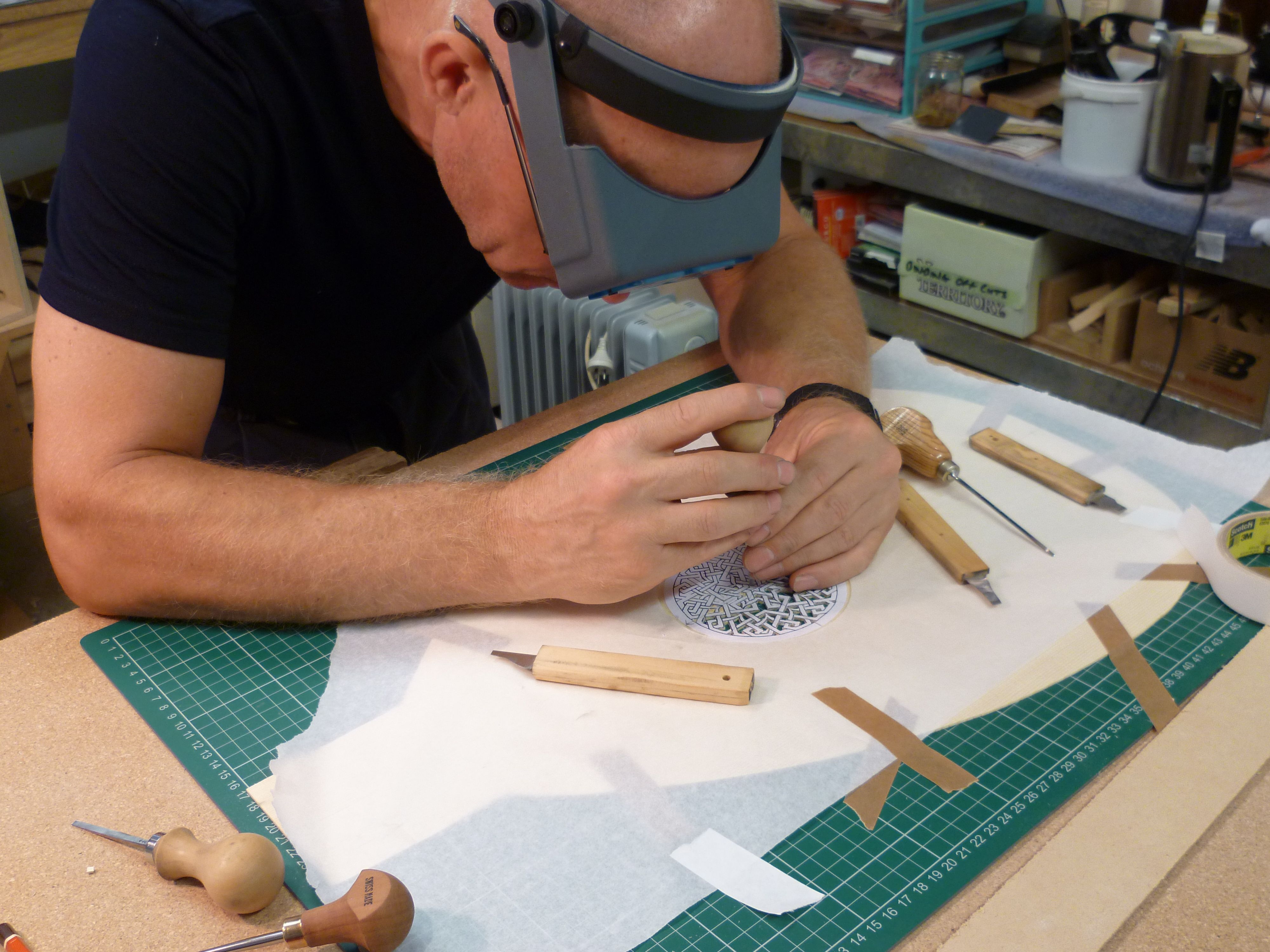

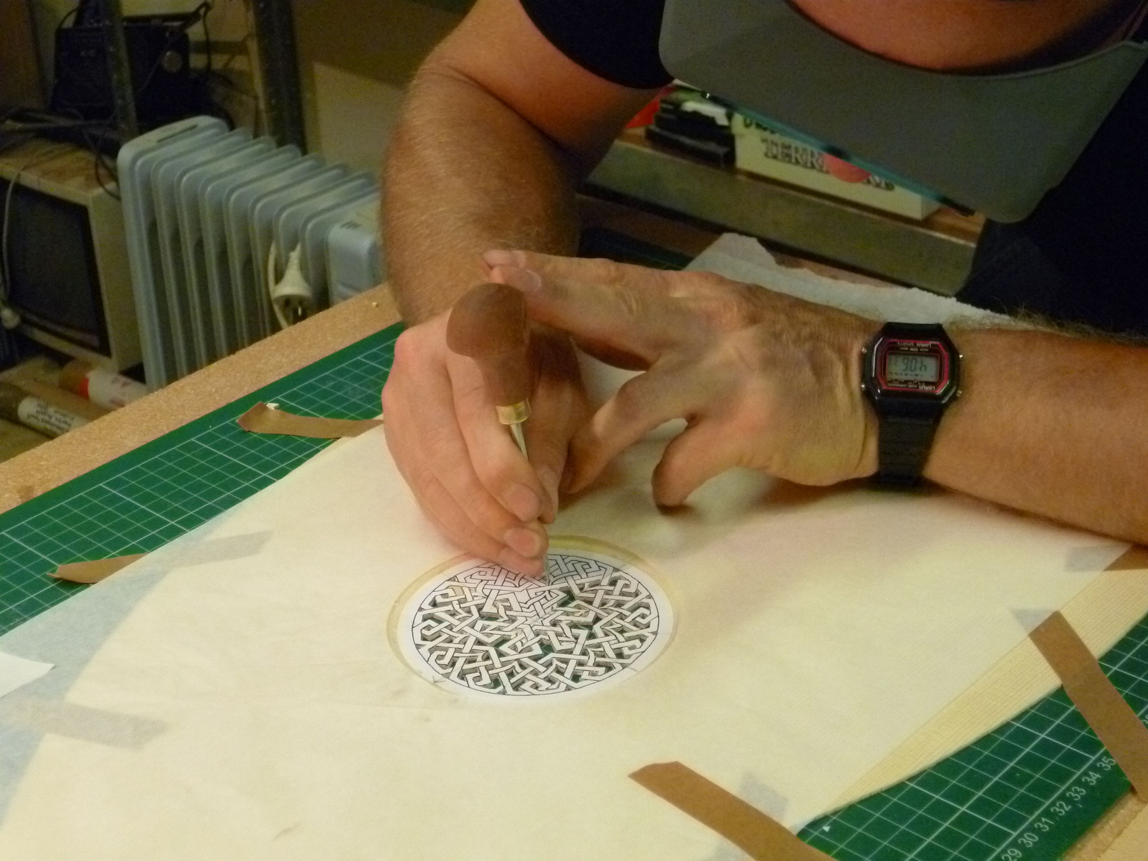

More work on the rosette today. Got all the cutting/punching out done. It went pretty fast as Ive already done this pattern 5 times during the practise runs. From the arsenal of tools the ones that got the most use were two of the home made microchisels and 1.5mm and 3mm Pfeil microchisel. I would have got more done but the rest of the day was spent f******ng with the workshop dehumidifier....the thing finally choked up with wood dust and started overflowing into the shop.
Post by Allen » Mon Jan 17, 2011 7:21 pm
I just showed the progress pictures to Karen and she said "Oh my Lord". Pretty well sums it up.
Does the Optivisor work well for this sort of thing? I had thought about getting something like that, but I'm worried that it's so bloody hot and humid up here that it would just fog up on me.

Allen,
The Optivisor is useful for work such as a lute rosette where youre working small scale. There are only two negative comments I would make:
1. I often forget Ive got the Optivisor on my head and walk down to the shops wearing it. Not a huge deal as most of the locals know Im a nutter anyway.
2. the Optivisor leaves a big fat line around my head when I take it off......on my nearly nude nut it looks like someone has whipped off the top of my nut, extracter my brain and then popped the lid back on.
Cheers Martin

Shit that did go quick. :shock:
I expected that to take a couple of days.
Nice sharp corners too.

That came out well Martin, good job you'd done a few practice runs beforehand :wink: Should look sweet once you carve the 'under & overs'. My workmate quite often wears an optivisor with his own glasses & on occassion uses a magnifying glass as well! It was only ten years ago he was giving people who wore glasses a hard time, coming back to bite him on the bum now!

kiwigeo wrote:Latest progress. The top has been worked to final thickness with a block plane and then scrapers. Thickness is around 1.8mm just south of the bridge and gets down to 1.3mm in the rosette area. ...
I built a 10 course renaissance lute a long time ago. If memory serves it was about 1.1mm at the edges and 0.9mm at the rosette. I was using someone elses for and I believe it was based on one by Frei in the the museum in Vienna. I found doing the rosette quite nerve racking.
Hi Simon,
I could have gone a bit thinner in the rosette area but my thickness guage has a margin of error that made this a bit dangerous. Around the perimeter of the top I went down to 1.5mm. The top was starting to get a bit floppy so thats where I stopped.
