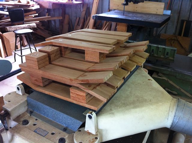

I just depends how good your blade and saw are as to whether you can glue up without sanding or planing.
This batch of necks has the scarf joint just off of the saw. All put together with HHG.

What sort of timber are those necks Allen?

liam_fnq wrote:What sort of timber are those necks Allen?
New Guinea Rosewood Liam. They're the batch for the Cairns Uke Festival. I've got 2 bodies closed up and waiting for some stuff sent up from Micheal to finish them off.
I also have a bunch of video footage and photo's to put together so people can see some of what it takes to make large pieces of timber into shavings and little pieces of timber.
