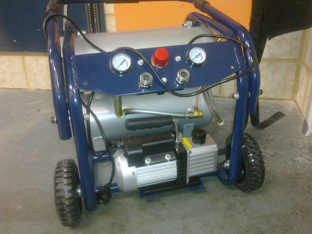

Post by simso » Sat Jan 21, 2012 9:27 pm
So just waiting for the evs kit.
The vacuum pump takes up so much less space than a compressor
Does vacuum work the same as pressure, that is can you put a pressure regulator in the line to wind down the amount of available vacuum, I ask becuase the current rig up allows you to display available and regulated, and this is not a bad situation, obvioulsy I would have to swap out the pressure gauges for vacuum gauges, and the quick couplings to the vacuum couplings
Vacuum rig.jpg (40.86 KiB) Viewed 7950 times
Dominic
Posts: 1098
Re: Anyone used vacuum jigs
Post by Dominic » Sat Jan 21, 2012 11:22 pm
Steve, you will get gauges and a trim pot in the kit. Once you have a load on your pump you set the trim pot and check the result on gauge. Simple. What the gauge says is what you get as the pump will operate until the vac pressure in your tanks equals your set amount.
