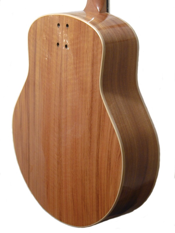

But then in reference once more to the Fender design that inspired you to a heel-less neck, I thought of Graham McDonald and his Bouzouki's too. This was the best image I could find on his site -
So it has and is being done. I pointed out why I thought Gabriel's work worked earlier and the same could be said again for Ken Parker. The whole design is integrated so well, it is not a factor in and of itself alone.
I think you've an uphill battle to convince the punters perhaps, just as undoubtedly those above have had and likely still do, but that should not stop you.

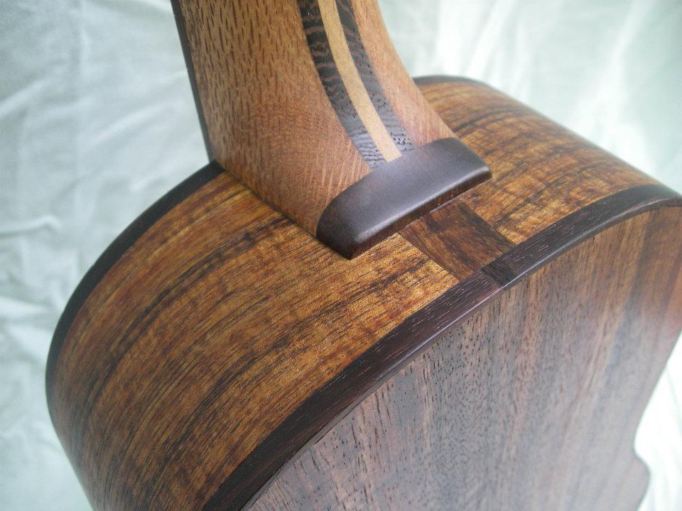

And one more Jim... !
Randomly came across this one today that 'looks' much more like yours, but I doubt it is attached in the same fashion. Possibly just a set neck but don't know for sure... A Matti Custom Ukulele - made in Qld? Had not heard of them until today.
More proof that they are "out there"...

Cheers Jeremy, more food for thought in that one. A few more millimeters longer and it would be a heel.
