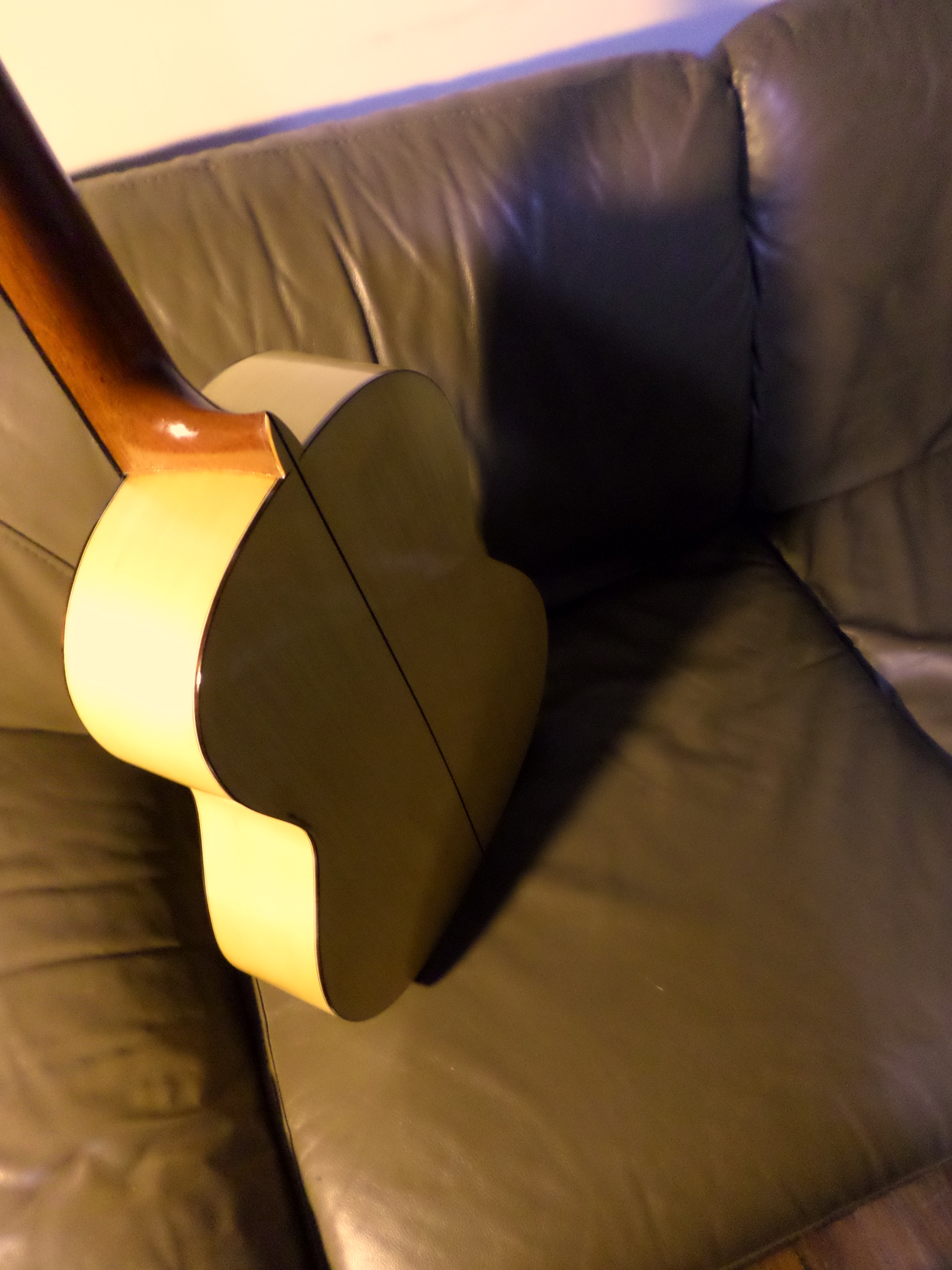

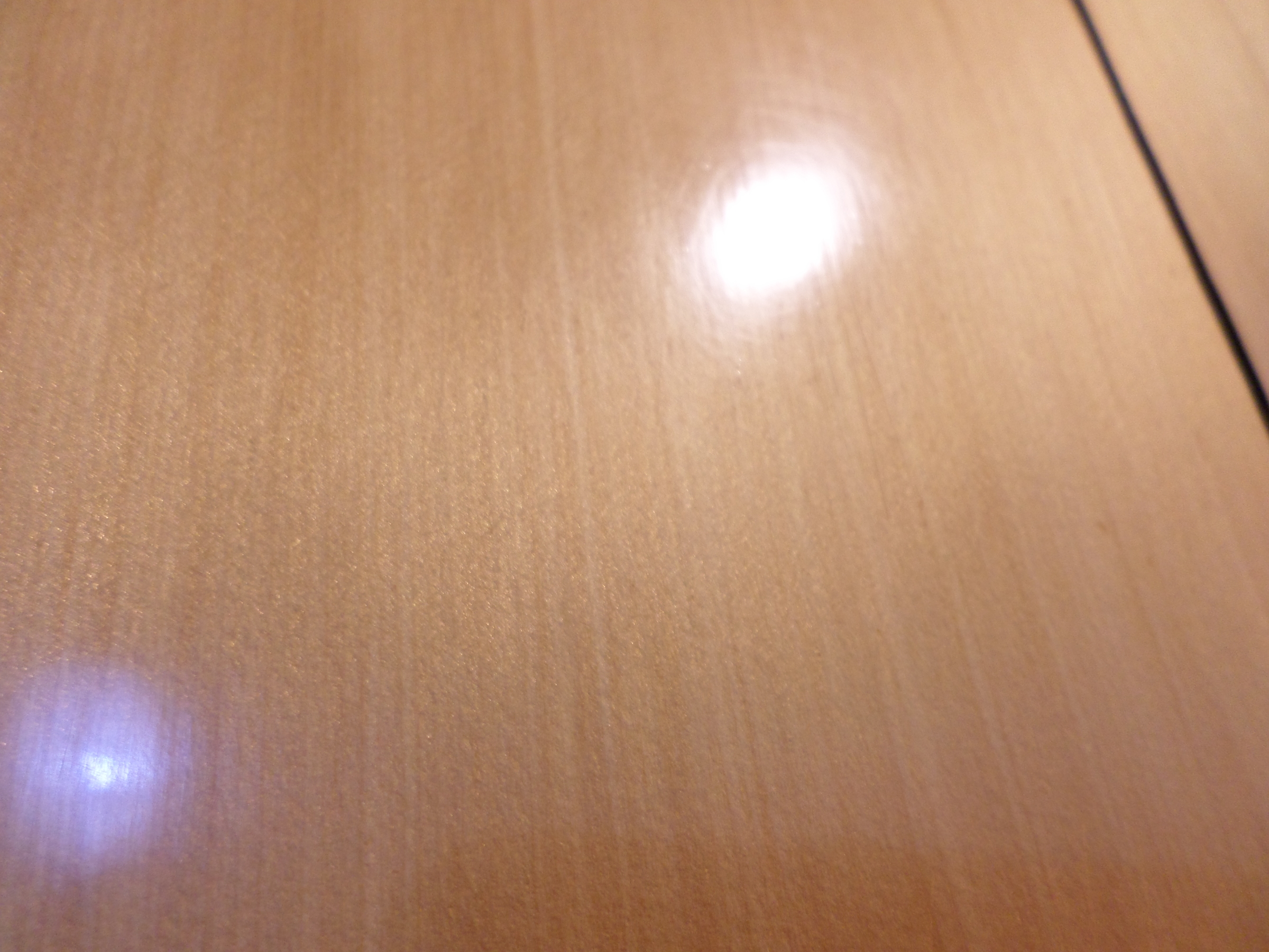

I tried Tru-oil for the first time, on the back and sides of a flamenco guitar.
it is an interesting finish... 56% mineral spirits, 33% modified oil (whatever that is). and 11% linseed oil.
Is it a real oil finish?? NO, just look at the percentages above - some people say it works like a polymer finish... yet it doesn't apply as quick and thick and doesn't work as negatively on the sound as most polymer finishes. the result to me almost looks more like a lacquer. thin coated sprayed acrylic lacqer on a guitar (the stuff used on cars) looks similar, but can be buffed better then tru-oil, which can not be buffed at all really... it is certainly no burnishing oil.
the 56% mineral spirits content... that makes it closer to a lacquer varnish for me.. mineral spirits is used for paint, acrylic, laquer and varnish.
applying it is easy wipe on... but it takes a long time to dry between coats... 12 to 24 hours is recommended. but I think in warm weather with touch dry after a few hours you can recoat - but I am not sure if it is fine to steel wool between coats after only a couple hours. I personally waited a day between most coats as I was not in a hurry, but at the end did a couple coats a day. i had a bit of tiny bubbles form from my finish (dust particles?), in the same way i have previously got on French polish, so had to level between coats.
it takes about as long as French polish to be finished overall. I think you only need about 8-10 coats, but it depends if you are "wiping on", or if you are "wiping on and off". I experimented a bit between coats.
I aimed for a fairly shiny finish. no oil finish can look as shiny as well polished French polish, but this was OK looking . Since it doesn't really work with buffing, you want to wipe it on evenly and not wipe too much off if you want a nice shine.. steel wool will give you a nice sheen or matte. you cant really"polish" this finish unfortunantly.
one thing I like about it, is that it is a very thin finish, even after 10 coats much like French polish, so it is good for sound. it does not fill pores (like French polish), so you need to prepare the wood well, and also even very light sanding marks not going with the grain show up.
One last thing, this finish was designed for gun stocks... yet speaking to a few gun people, it doesn't seem that popular because of its long drying time, and gun guys can get a shinier coat with a wipe on poly, and a matte coat can be achieve quicker with Danish oil. It seems that the guitar world is a bit more focused on this finish at this current time then gun owners who refinish their guns.
I enjoyed the process and will use Tru-oil again.
