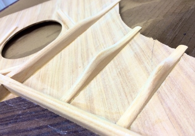

Started on the brace carving today but ran out of time.

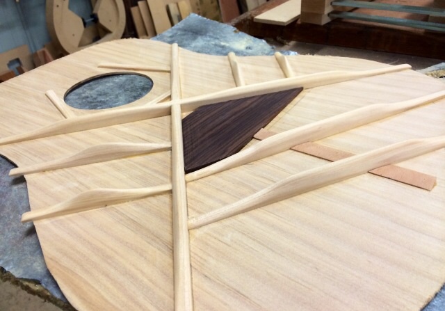

Looks like bracing to me - but what do I know??!!
Every picture of bracing I look at is different and everything I read is another opinion, so I went with a standard straight brace with a gentle scallop from the center

demonx wrote:Looks like bracing to me - but what do I know??!!
Trevor's got a few opinions I'm sure but I've found his books contain mainly facts based on carefully thought out following scientific method.
Re: Build thread - Blackwood & Bunya Dreadnought
Post by jeffhigh » Fri Aug 15, 2014 6:25 am
Hmmmm. scalloping the actual intersection of the x braces, that's an unusual decision. is that really what your mentor does?

jeffhigh wrote:Hmmmm. scalloping the actual intersection of the x braces, that's an unusual decision. is that really what your mentor does?
No, he doesn't scallop, except for the standard end curves. His opinion on the matter varies from others and he insists the top choice is more important than the bracing carve. He's not too impressed with my choice of Bunya and Blackwood! In the actual construction/installation of the bracing he's very particular but said just carve it to look nice as long as long as it's started from particular dimensions according to the top choice.
It was just something I added for the hell of it, it's only so very slight it's barely noticeable anyway.

Post by kiwigeo » Fri Aug 15, 2014 12:03 pm
Maybe just my preference but I'd be taking a bit more meat off alot of those braces.

kiwigeo wrote:Maybe just my preference but I'd be taking a bit more meat off alot of those braces.
I'll take it around and get it looked at in a week or so. I won't be touching it again until the new quarter sawn back and sides arrive and I get the new matching back up to speed, then I'll focus on the top again.
I'll probably end out taking more off the sides of the X bars and the lower face bars.
Yep....keep the height but just shave some of the fat off the sides.....it works wonders on braces and fat b****ds like me :)

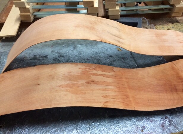

I was curious whether the "bake" stage was really worth the effort, so I did a test with these two pieces using up the last of the flat sawn test pieces is cut
Neither were put into a form, one was baked for the recommended 15 minutes and the other pulled straight out. Both were sat on a flat bench and left to their own accord.
Even though both have are unusable, it clearly shows the bake does actually help it keep shape.

demonx wrote:I was curious whether the "bake" stage was really worth the effort, so I did a test with these two pieces using up the last of the flat sawn test pieces is cut
Cool, I will definitely bake.
I am with Martin here...I would be tapering the lower legs of the X from about 1/2 way through the bridge plate down to nothing at the linings...I pull mine up well short actually, tapered to nothing, but most people tuck them into the linings in the traditional way....but yes less wood.

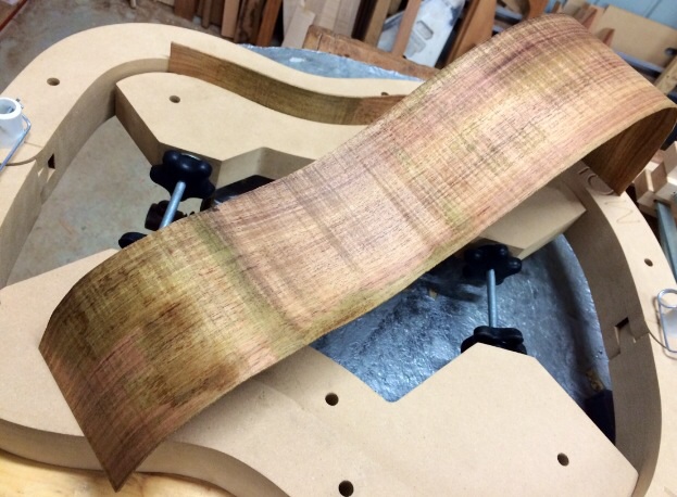

Test bends are over and I just unwrapped the first of the quarter sawn sides I bought in fiddleback blackwood.
Shape is good, no ripples (thankyou!) and no damage.
I'm really hoping the acid you guys are suggesting is a miracle worker as this stuff has colored immensely, even though I'm using the demineralised water and barely any of it
Is this normal?

Hi Allan,
I'm afraid I can't offer any help, sorry. But I would be interested if you could post what finally works for you at the end of your journey. I have some Blackwood sides to bend in future, it would be useful to know any tips and tricks (I have bent Mahogany and Australian Red Cedar sides with no problems - though that's probably pretty easy timber to bend).

Post by colburge » Thu Aug 21, 2014 4:49 pm
Oxalic acid works in no time, you will be right.
