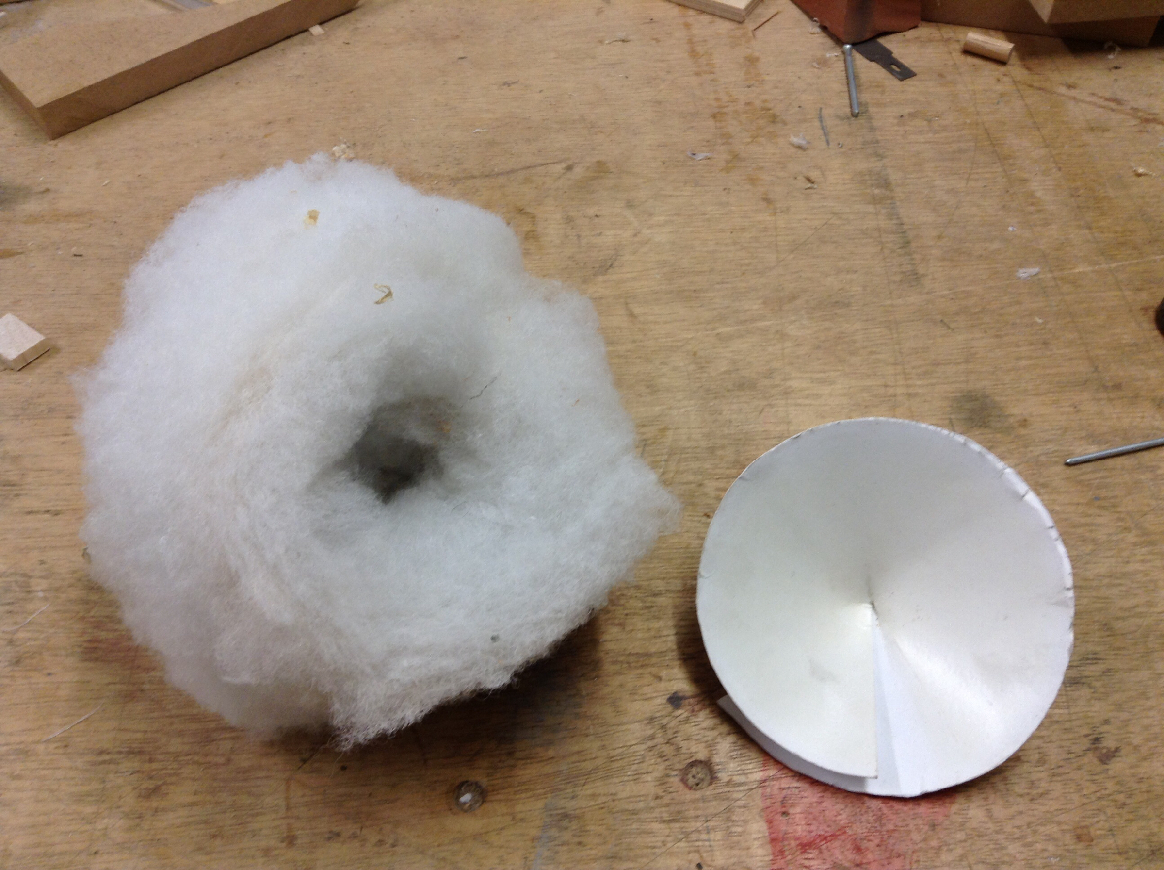

This is the easiest method I have used. A light cardboard cone supported by a roll of wadding. It is a few mm wider than the sound hole and just pops into place. Has the advantage of being quick to remove when sanding and the back spray seems to coat the sound hole edge better.
Garry.

Post by garryalb » Wed Nov 11, 2015 8:20 am
Photo didn't load,
Garry.

Post by kiwigeo » Wed Nov 11, 2015 8:54 am
garryalb wrote:Photo didn't load,
Garry.
Santa's missing part of his beard... :mrgreen:

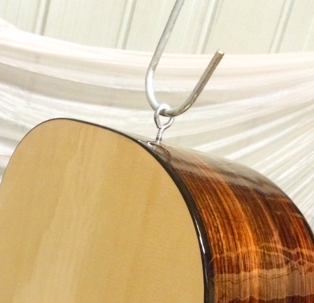

Back in the spray room again. This time I screwed a hook into the rear block and hung it upside down.
Seemed a lot easier to spray this way. I've always planned on building a rotisserie but it's still on the ever growing "to do" list.
