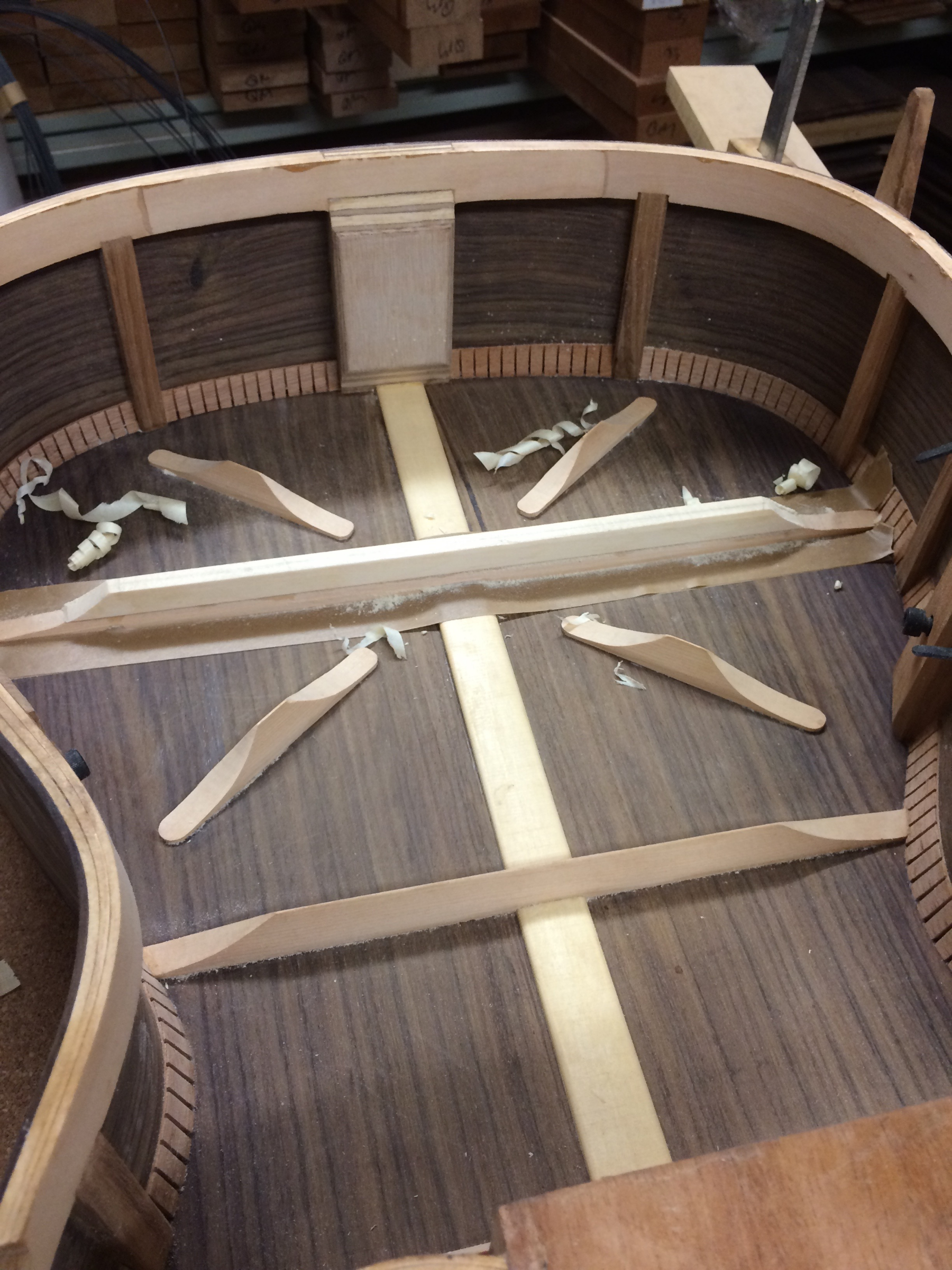

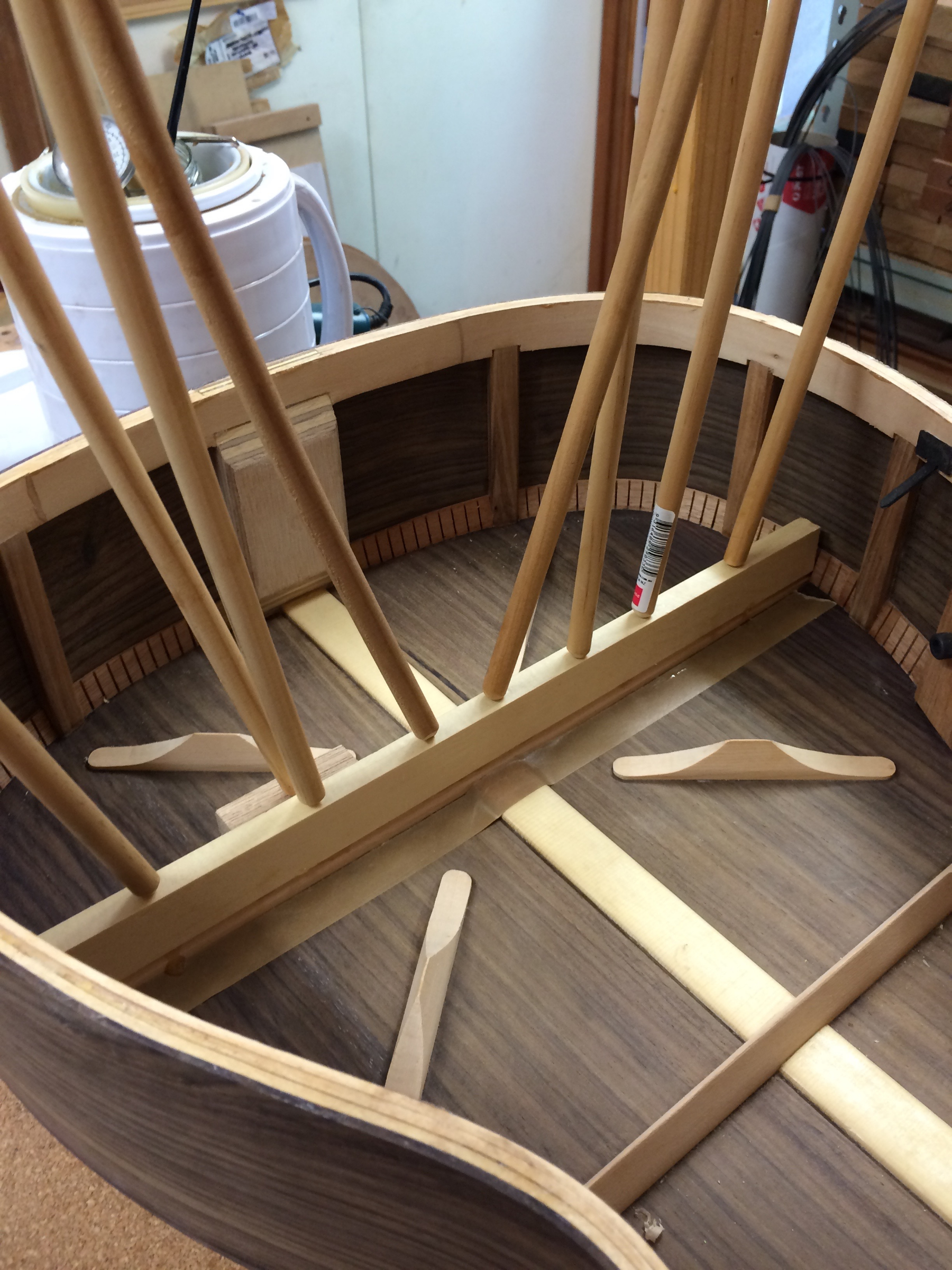

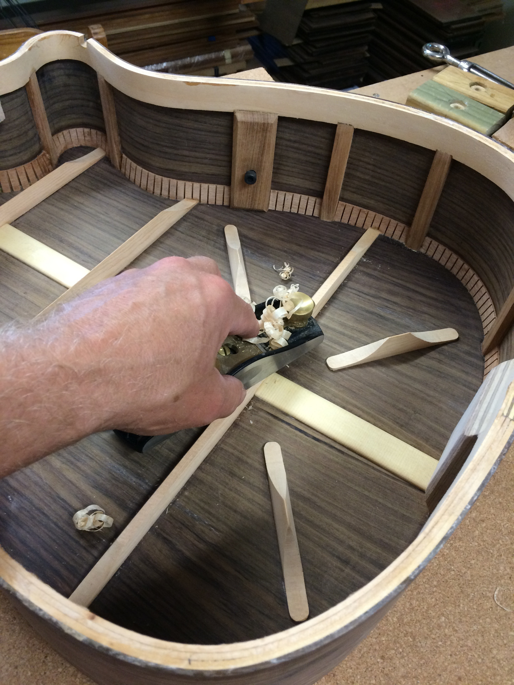

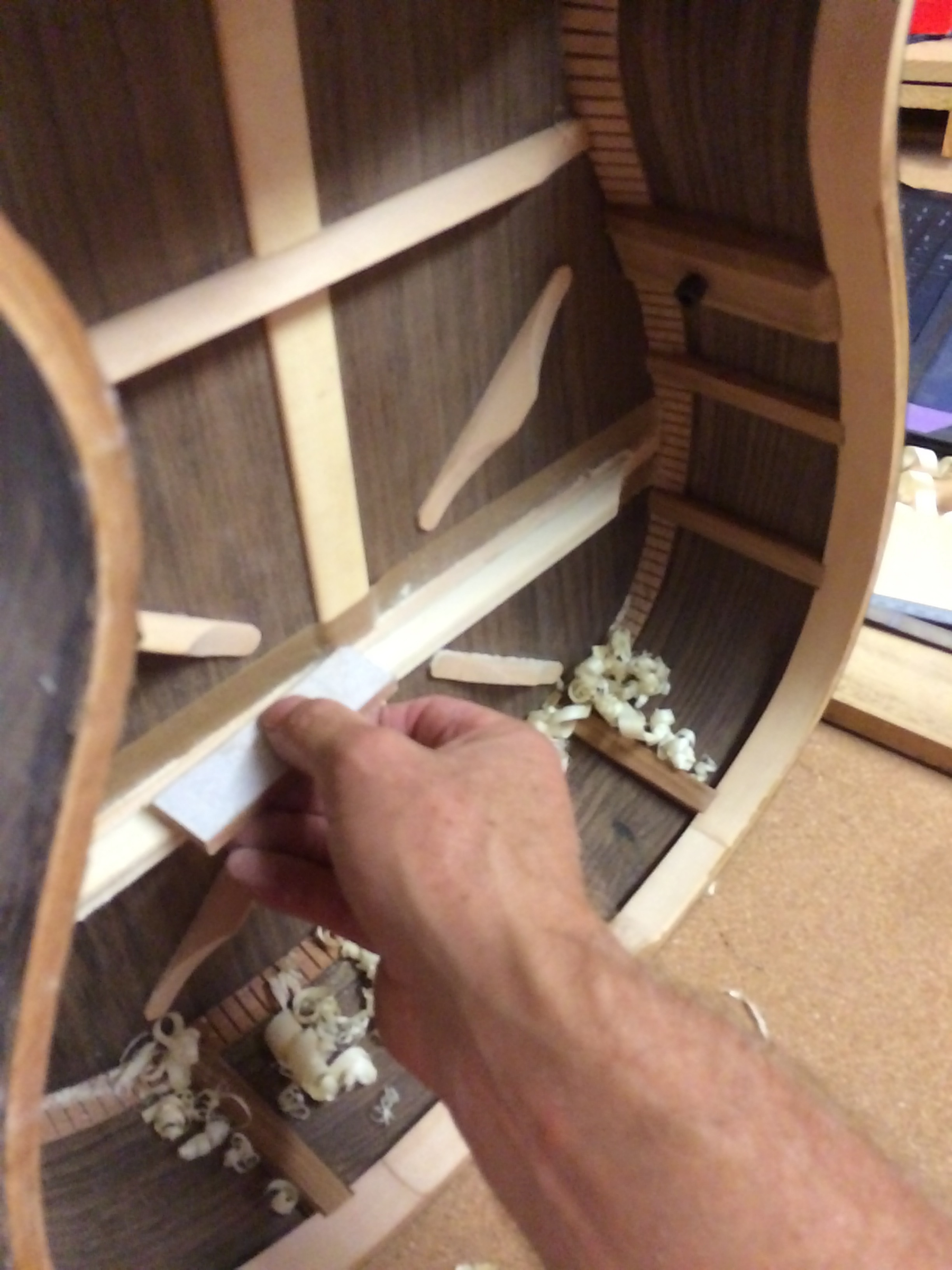

The rosette....actually since I managed to split the centre seam while removing the top it's a write off so rescuing the rosette is an option. I plan to cut it out and then run it through the drum sander to remove spruce from the back of same. I can then mount the rosette on an MDF base plate and rout inside and outside of the rosette.
Ive bulked up the lower back brace and trimmed it down to around 20mm (original brace was around 18mm). Ill probably leave the brace as is and remove any material once the new top is on.
Re: Current Build - Falcate Braced Multiscale OM cutaway
Post by kiwigeo » Thu Nov 12, 2015 8:37 pm
Pics of work on the lower back brace. I shaved the brace down as far as possible to give a good gluing surface. I then glued on some more spruce and am in the process of shaping same after trimming height to 20mm.

Post by Mark McLean » Thu Nov 12, 2015 9:57 pm
That will be something else interesting to look at through the soundhole. It does look very clean and tidy in there!
