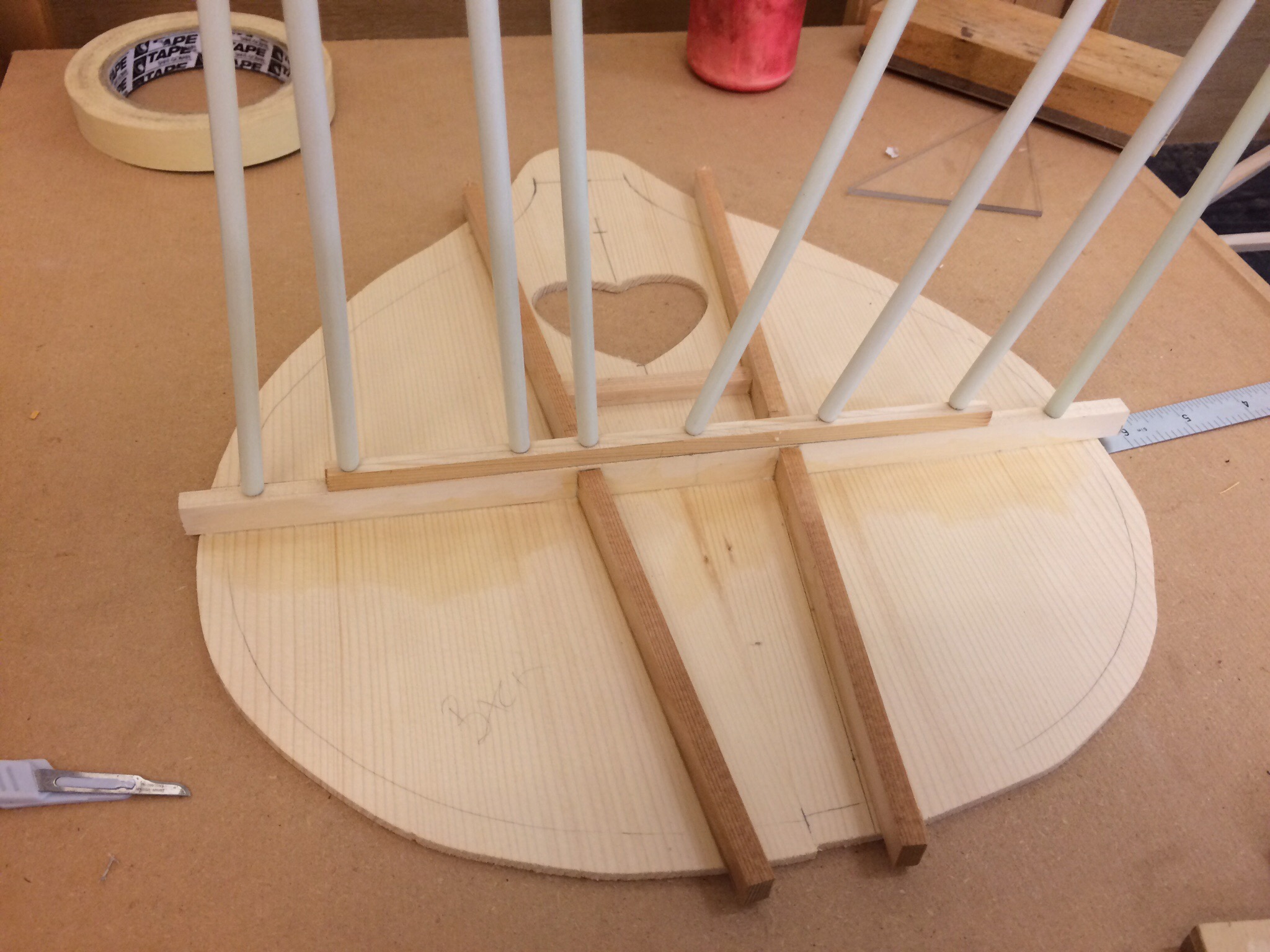

Post by Graham Long » Thu Mar 17, 2016 9:16 pm
I've got nothing compared to Steve!
Just a few.
A couple of flat top Mandolins and a couple of Guitars.

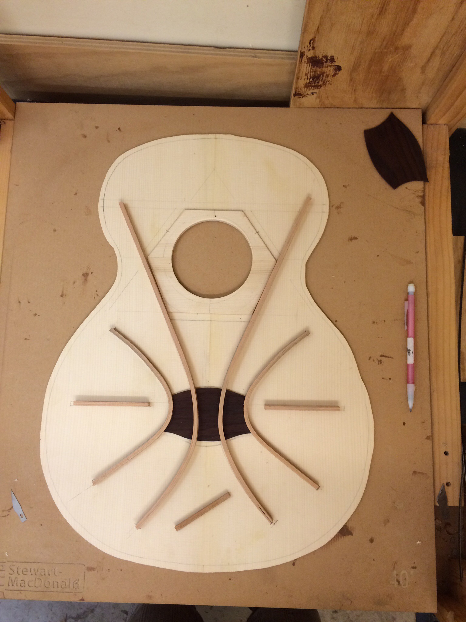

Flat top mandolin soundboard, Graham McDonald design.

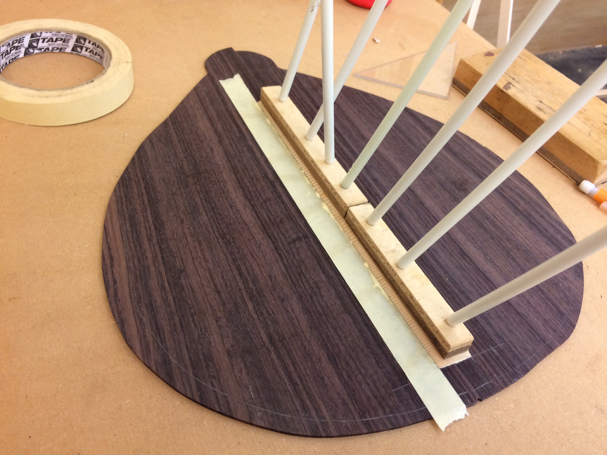

Mandolin marriage strip going on

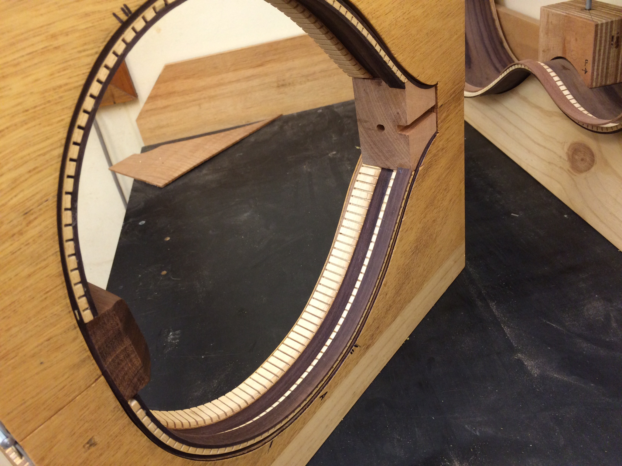

Mandolin sides, one more band to go on

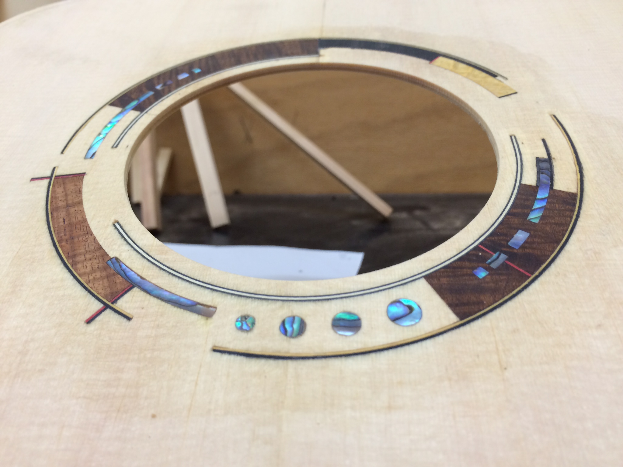

Compound rosette, Ringed Gidgee, Paua, Ebony and Sneeze Wood.

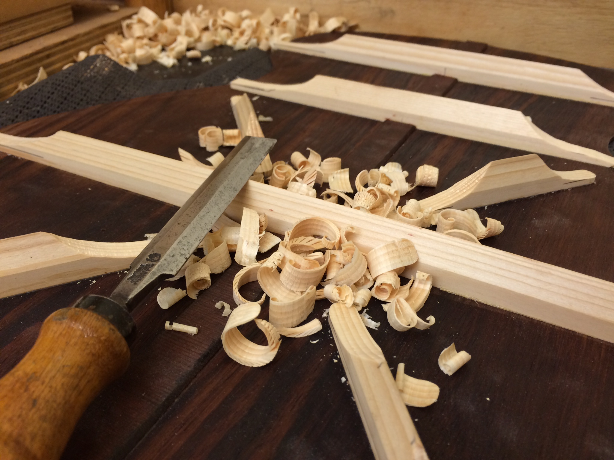

Test fitting Falcate braces

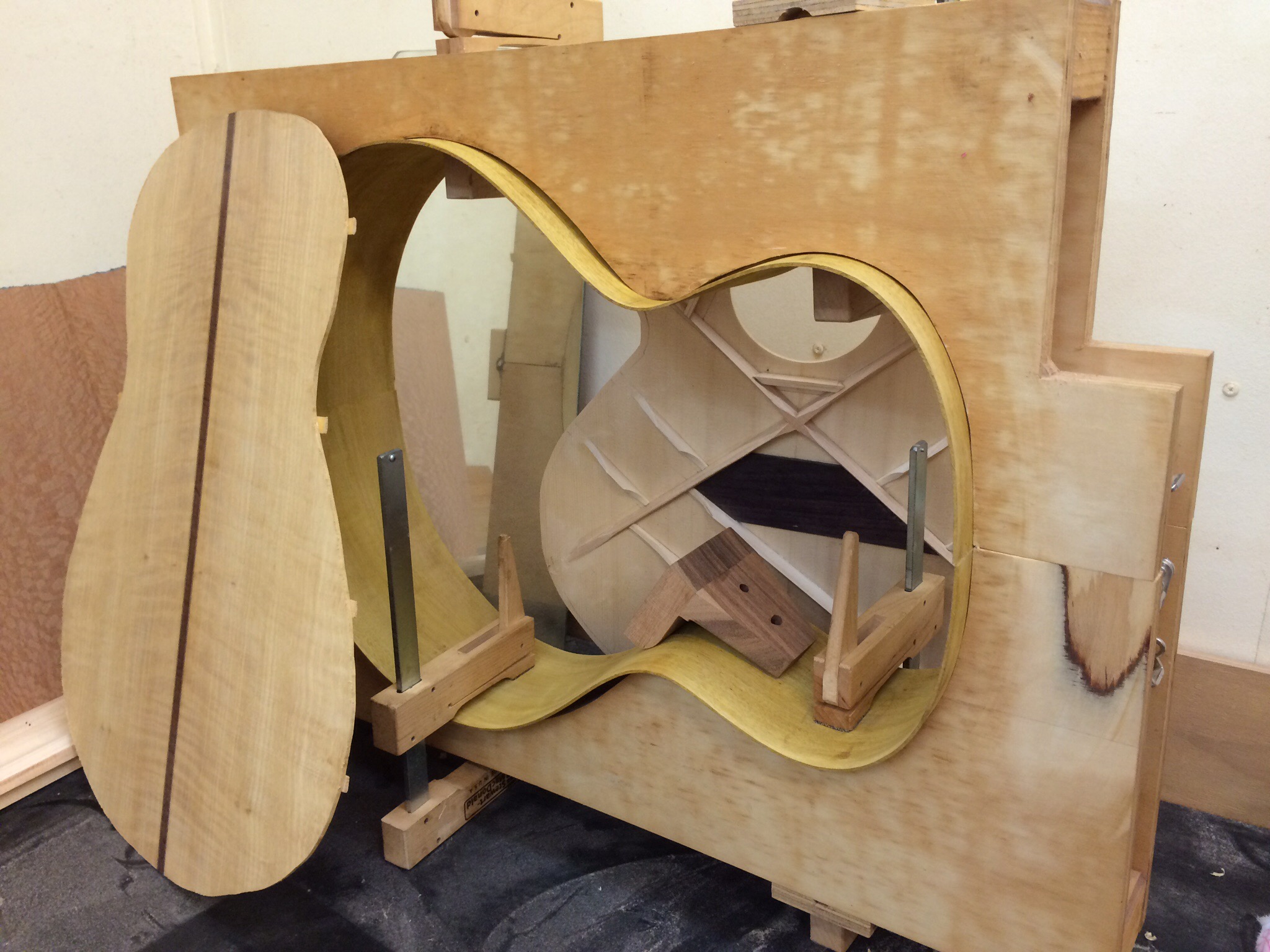

Movingui X Braced Jumbo

Great images Graham. Those are going to be nice instruments. I especially love the segmented rosette with the graduated dots and strips. Very inventive.
Can you tell us about the technique of putting solid strips of lining over the top of the kerfing? It looks good. Any other advantages in your experience?

Hi Mark,
I've been doing that to stiffen the joint/side. Especially when using standard Kerfed linings, they don't add any strength, but after the band goes over them, the side is just as stiff as three layers of solid wood.
And I find easier to do. Try it and let me know what you think.

A very catchy rosette Graham and the lining idea looks very interesting
