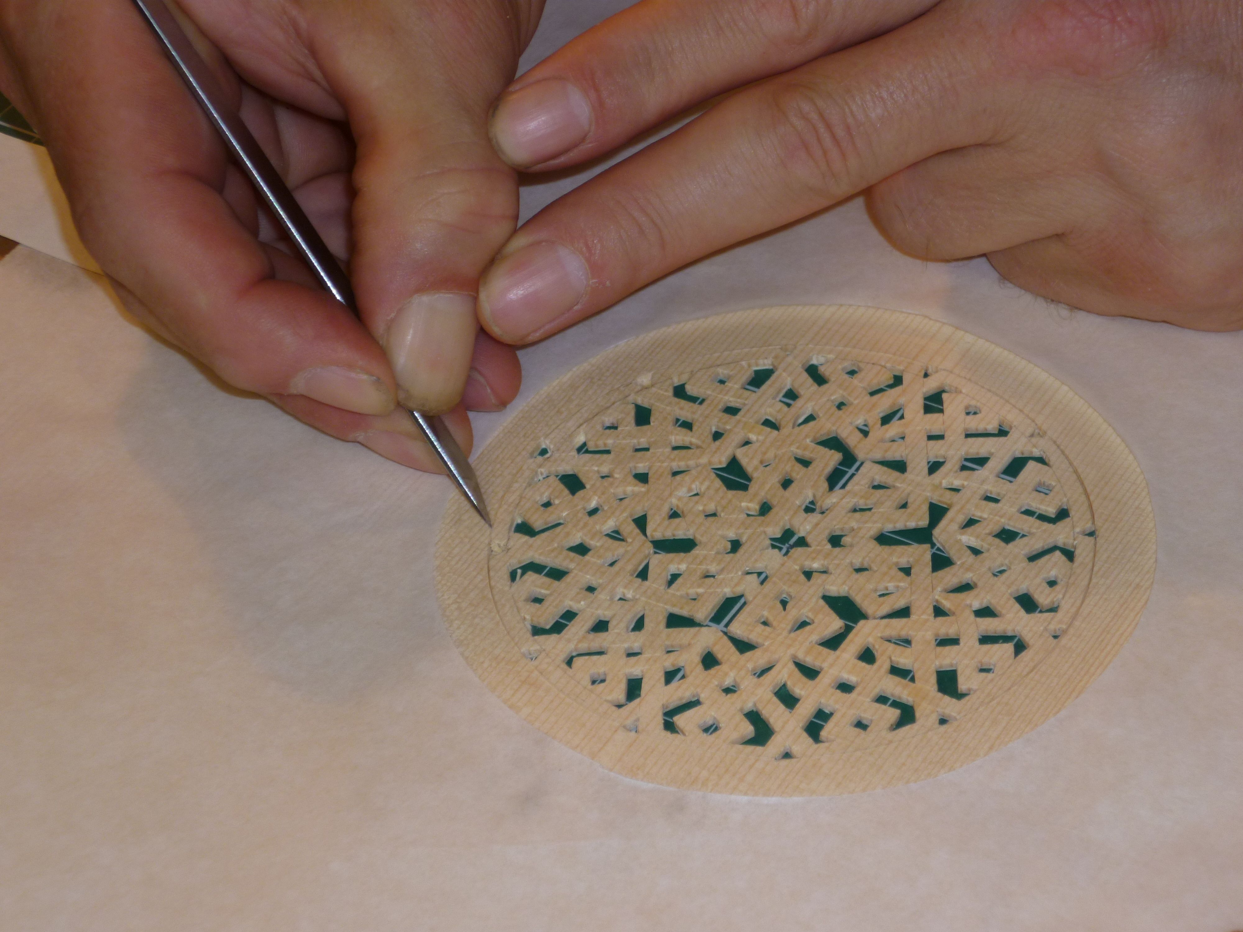

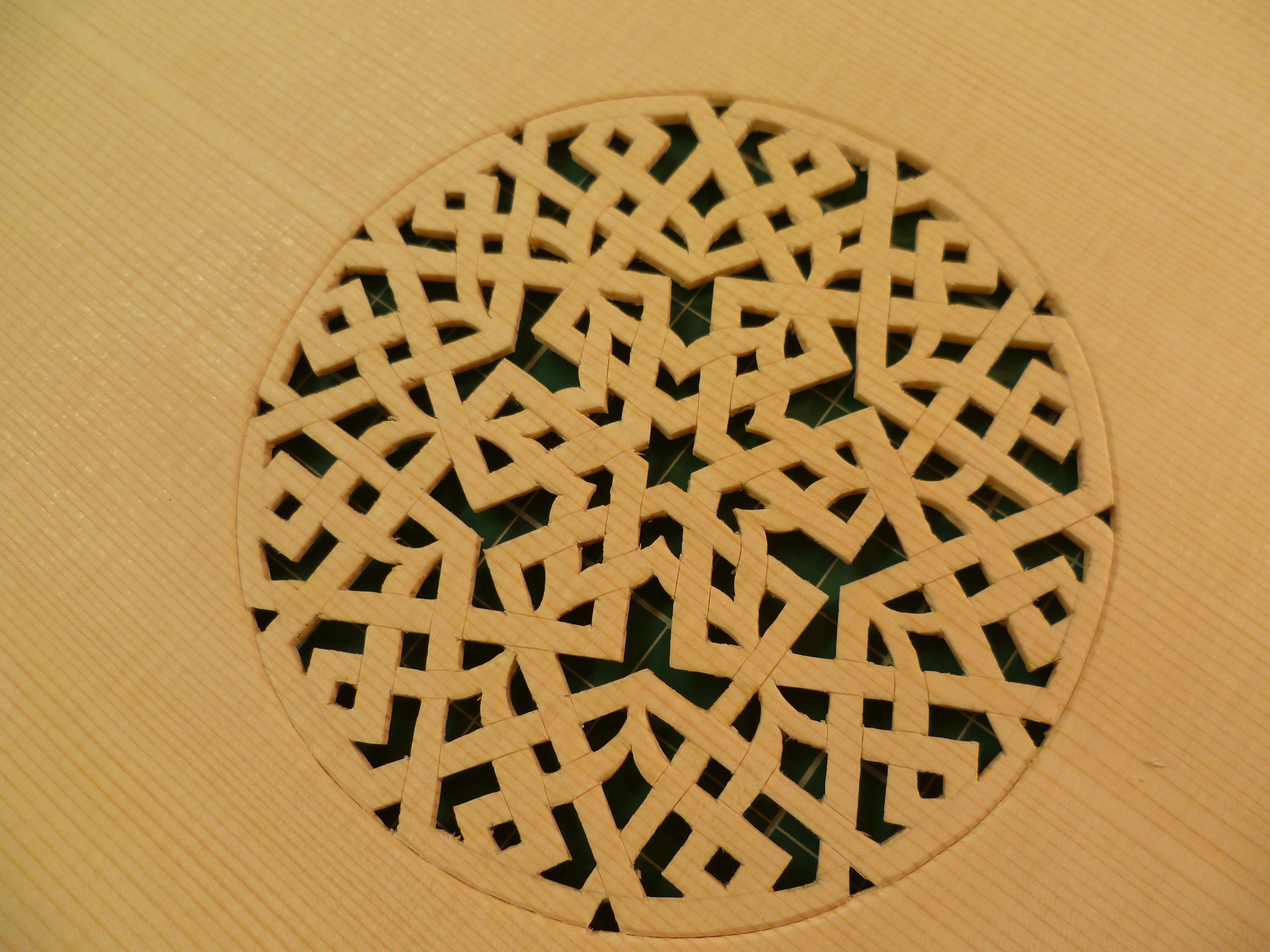

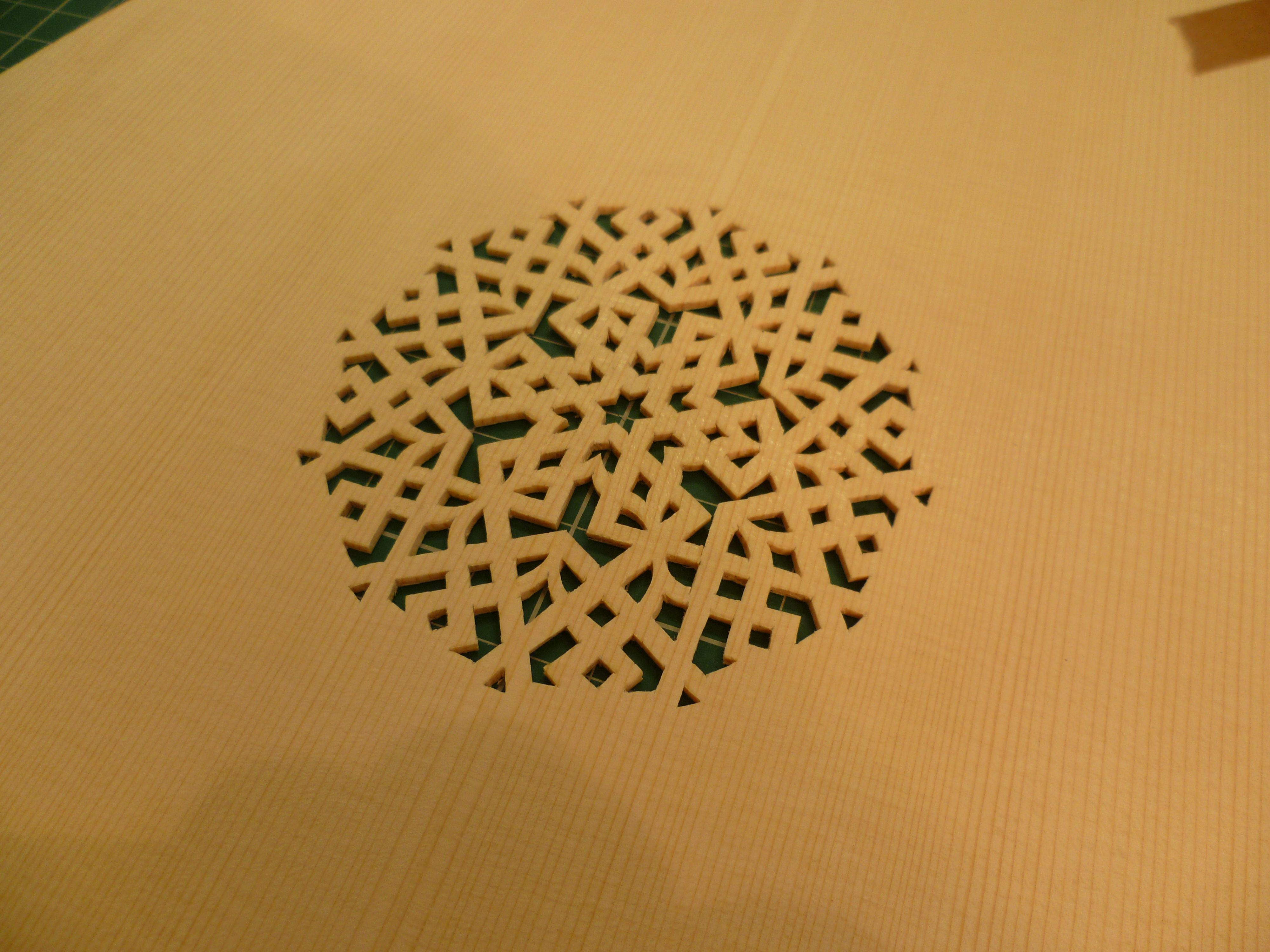

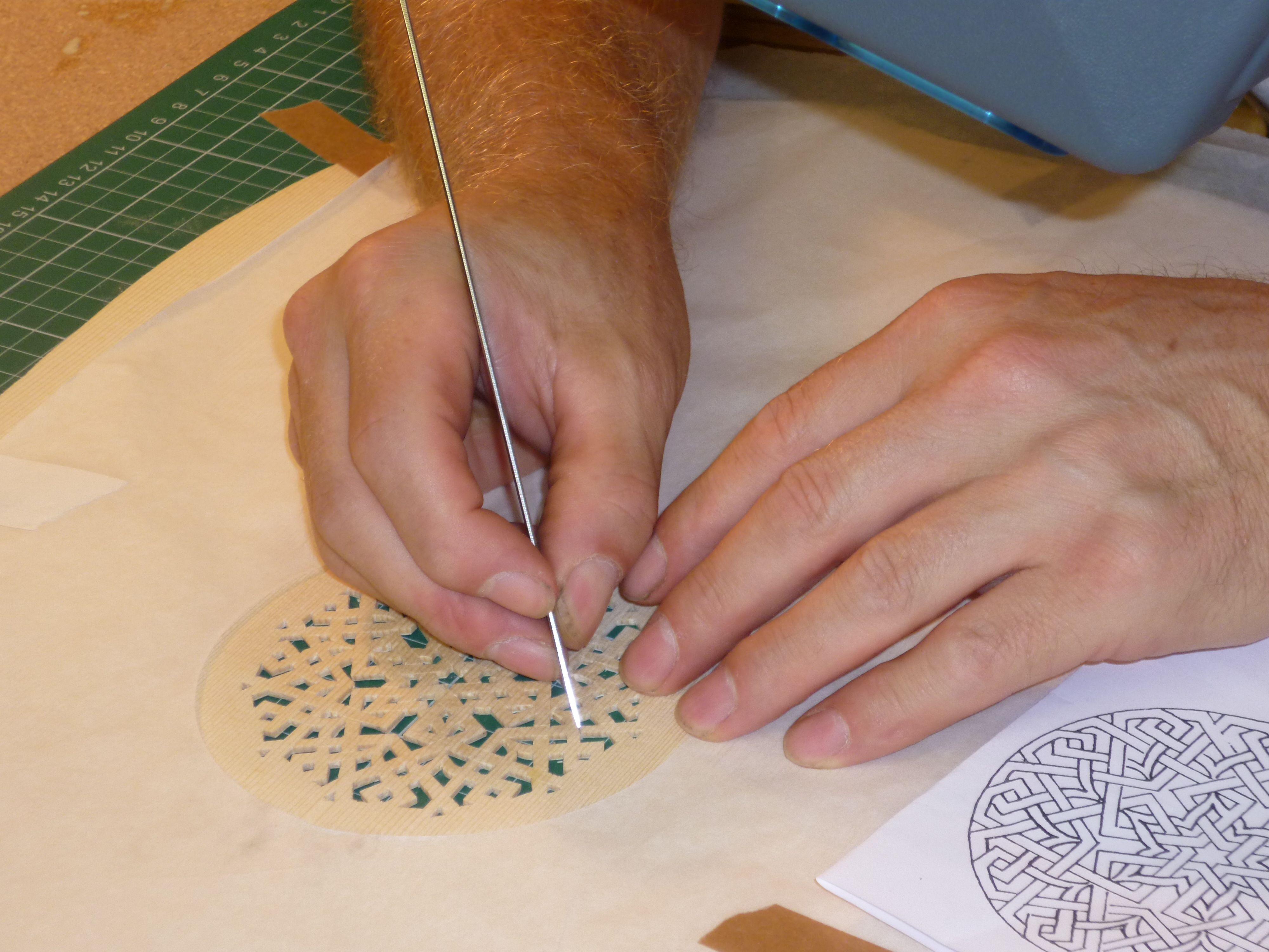

More progress today. Removed the paper pattern and then did the cuts to highlight the interweaving patterns in the rosette. The circle was then cut with an Olfa circle cutter and beveled using a violin knife. Sharpness of the punched out sections of the rosette arent as good as I'd like it but the next one will be better.
Re: Lute Progress - Test runs for cutting the rosette
Post by Nick » Tue Jan 18, 2011 7:31 pm
Sure is purdy Martin although I can see a few 'ragged' edges/corners :lol: :lol: Well done Mr Turner you've done a good job. That Spruce is even better close up! :cl :cl

Excellent fine work Martin. And great to see the weave starting to emerge.

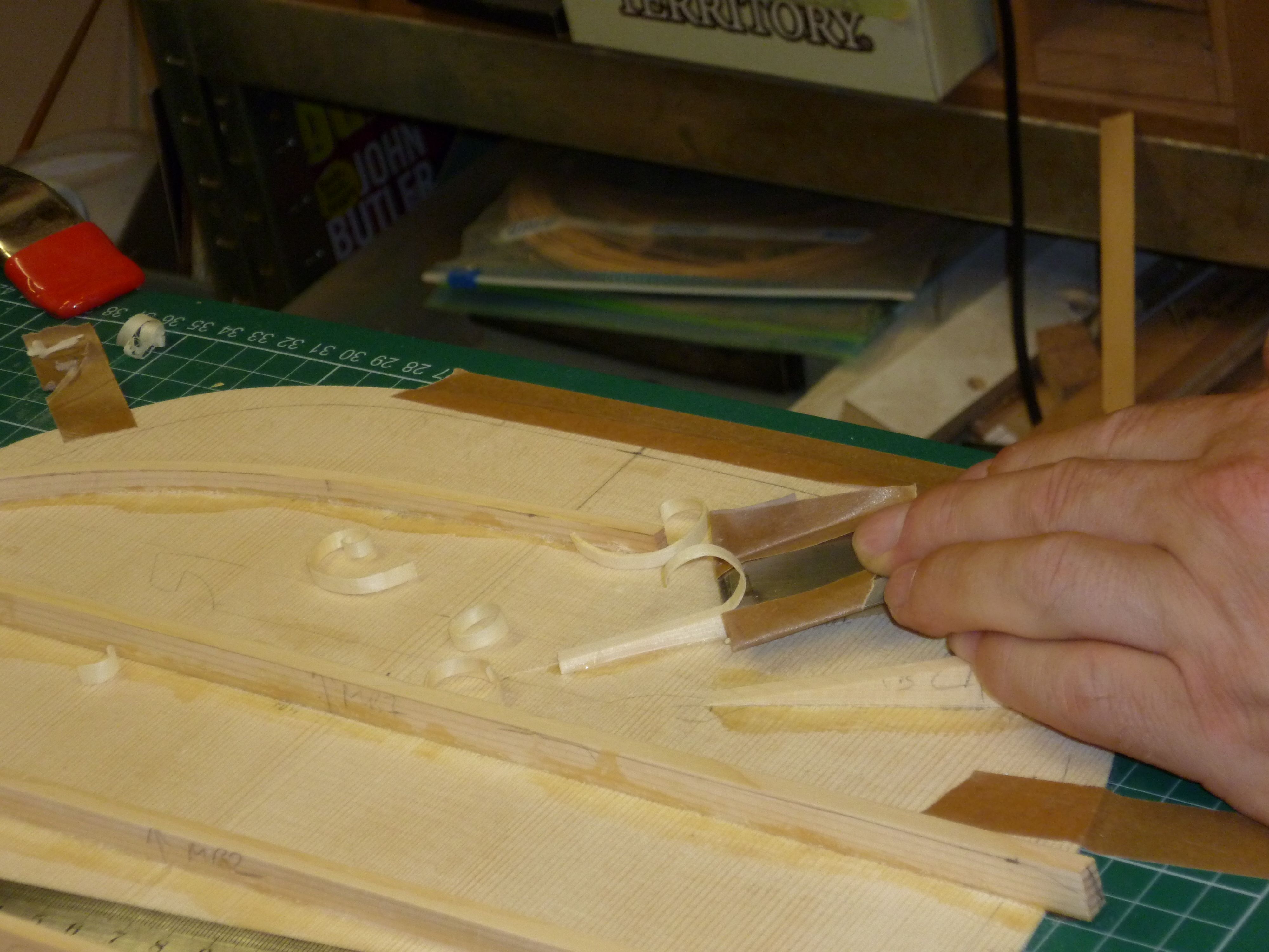

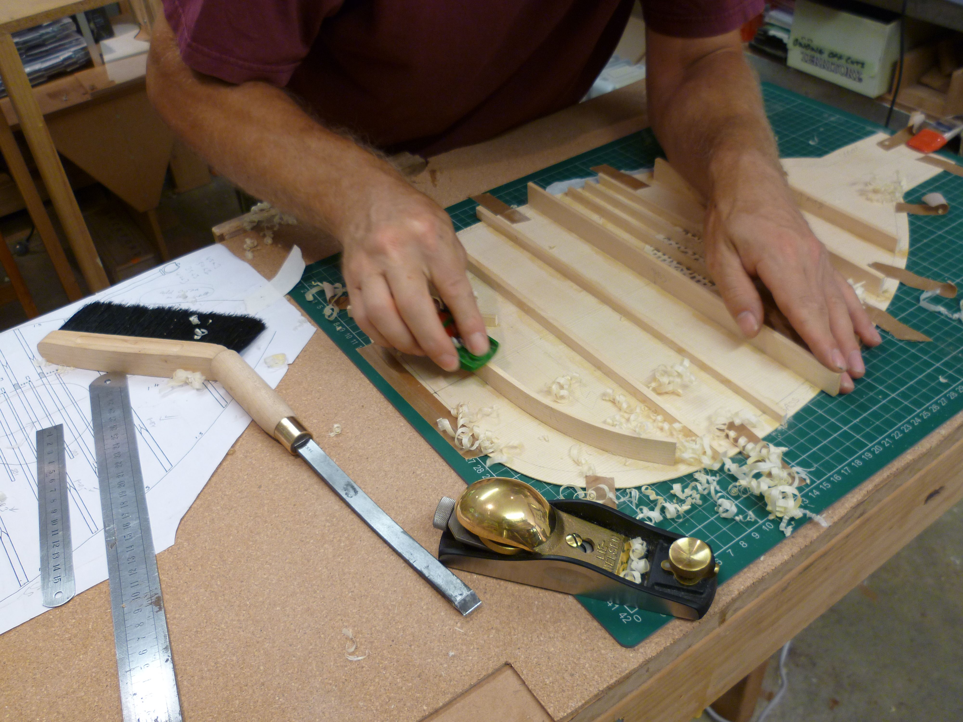

Busy cutting and shaping braces now. Interesting to note that on a lute the grain in the braces runs parallel to face of the top not perpendicular as on guitars. Got a shit load of braces to make up....13 of the buggers.

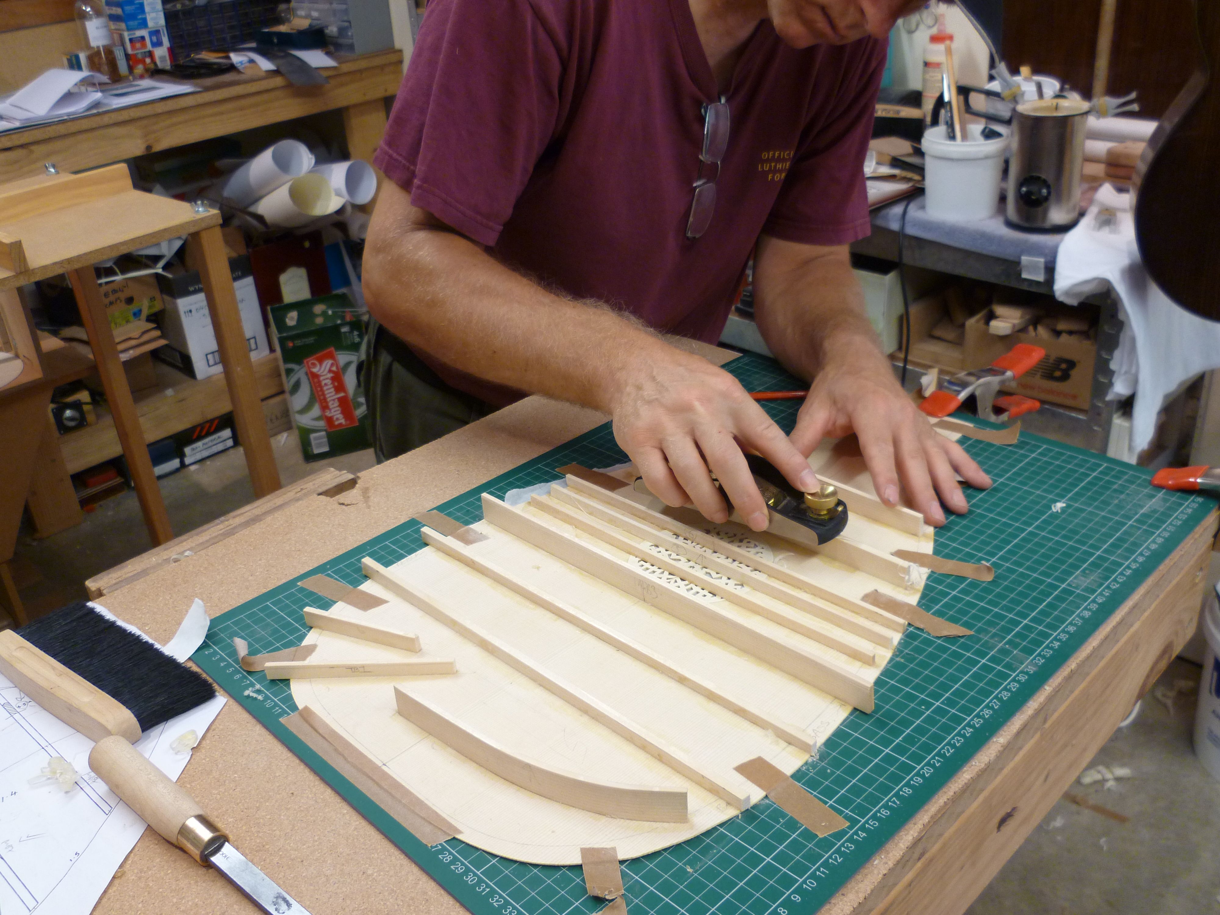

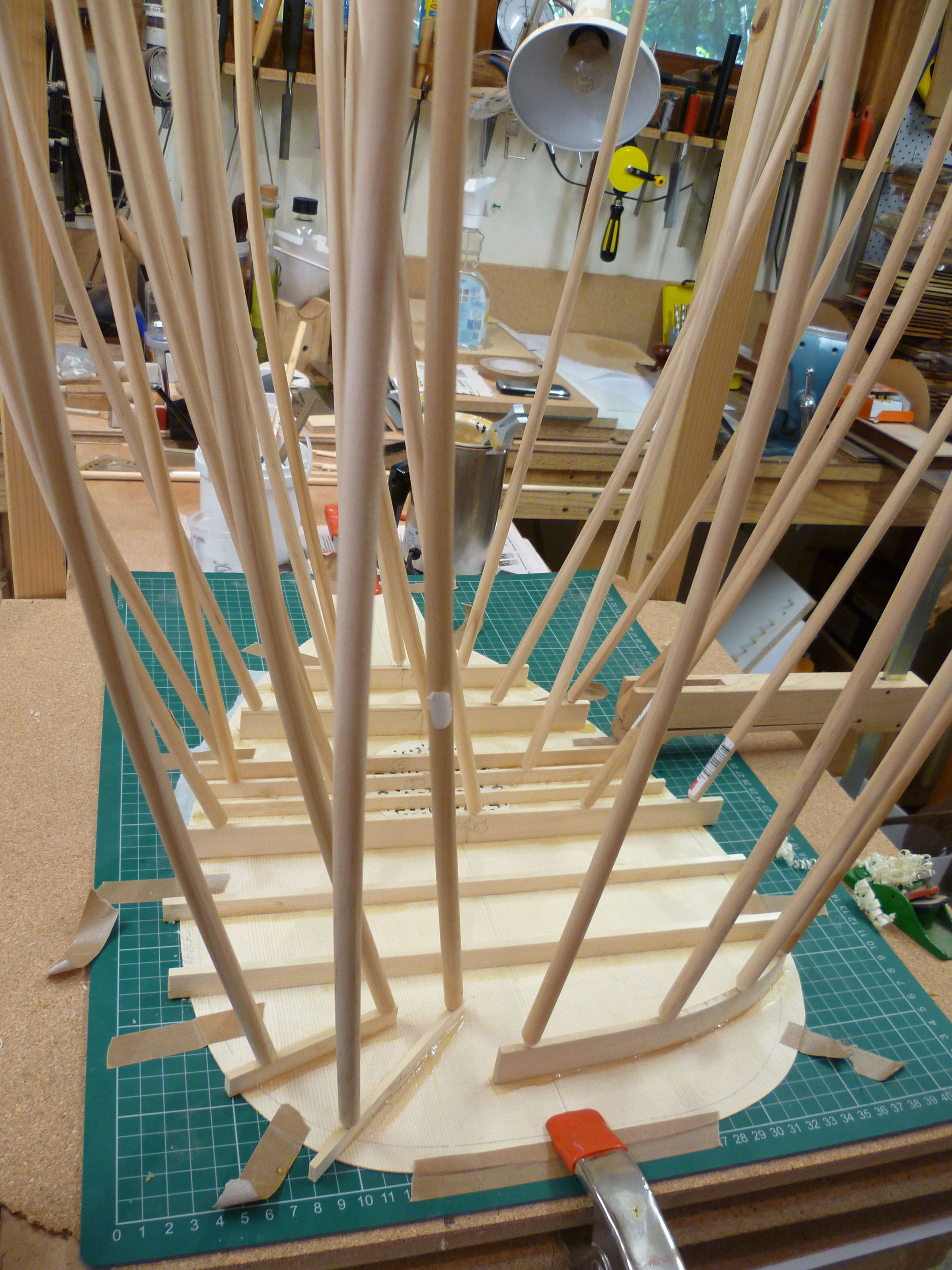

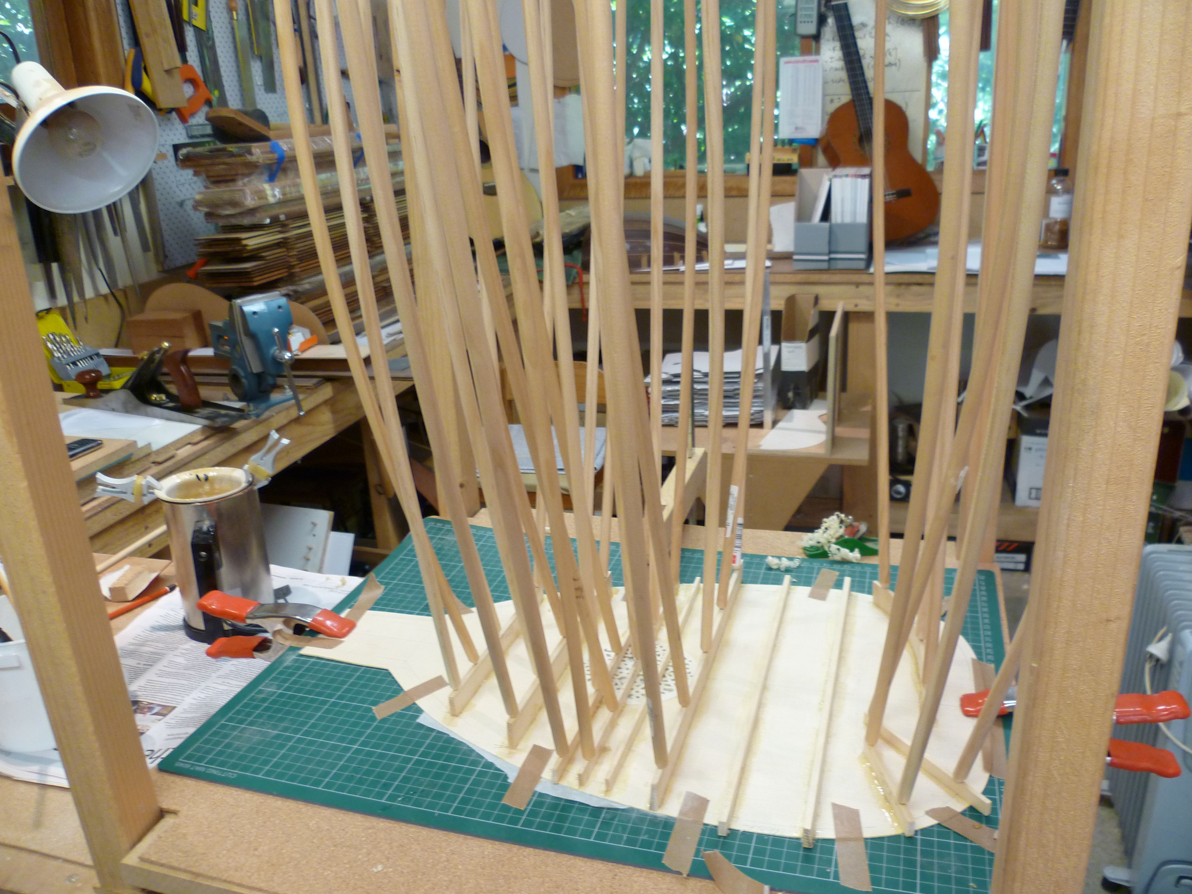

Decided to ignore the aching elbow today and get the braces glued in. The glue is hot hide glue..192 gram high clarity. This is one glue up job where you need to do a dry run first and have everything at hand. No room for f****k ups.
Post by Allen » Sun Jan 23, 2011 2:13 pm
That's a lot of braces. Going to be interesting to see how they get carved.

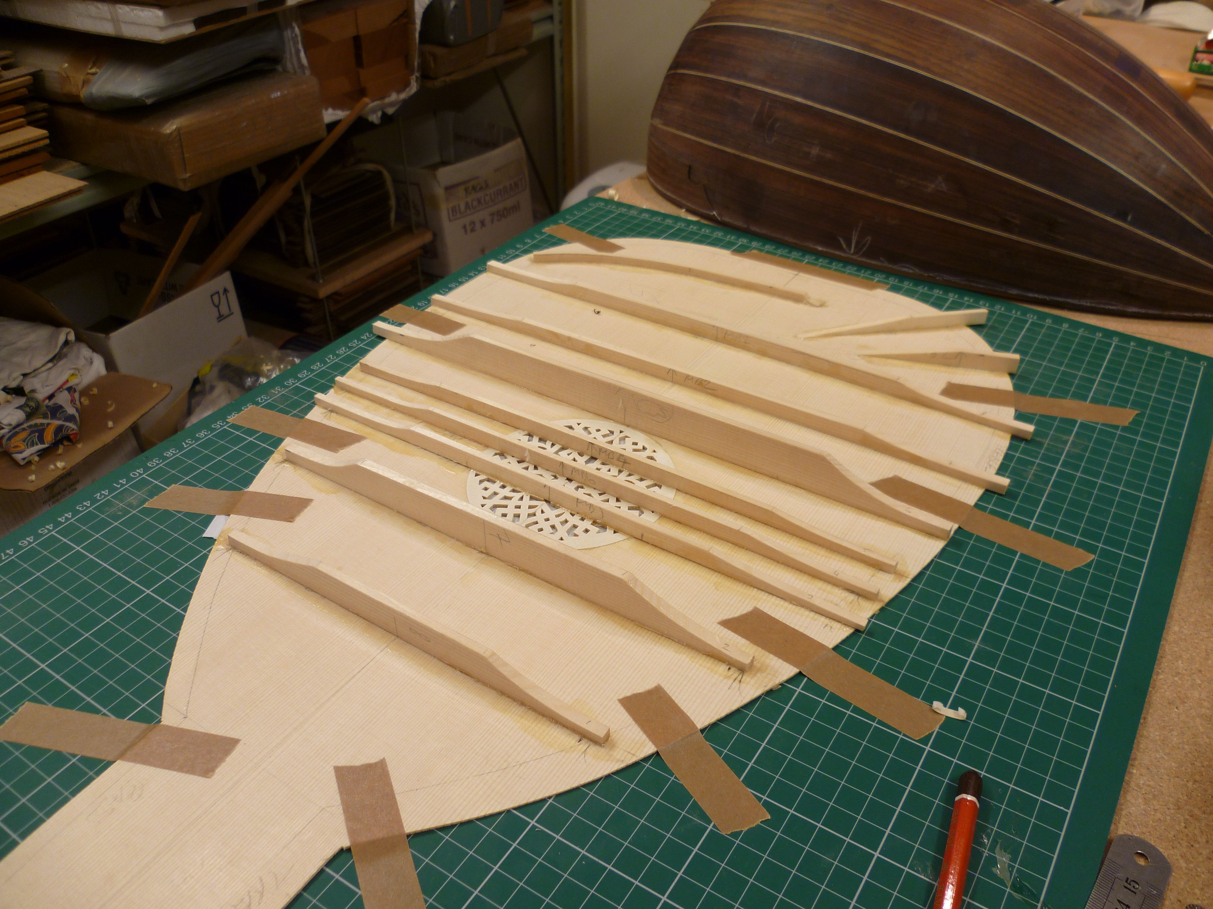

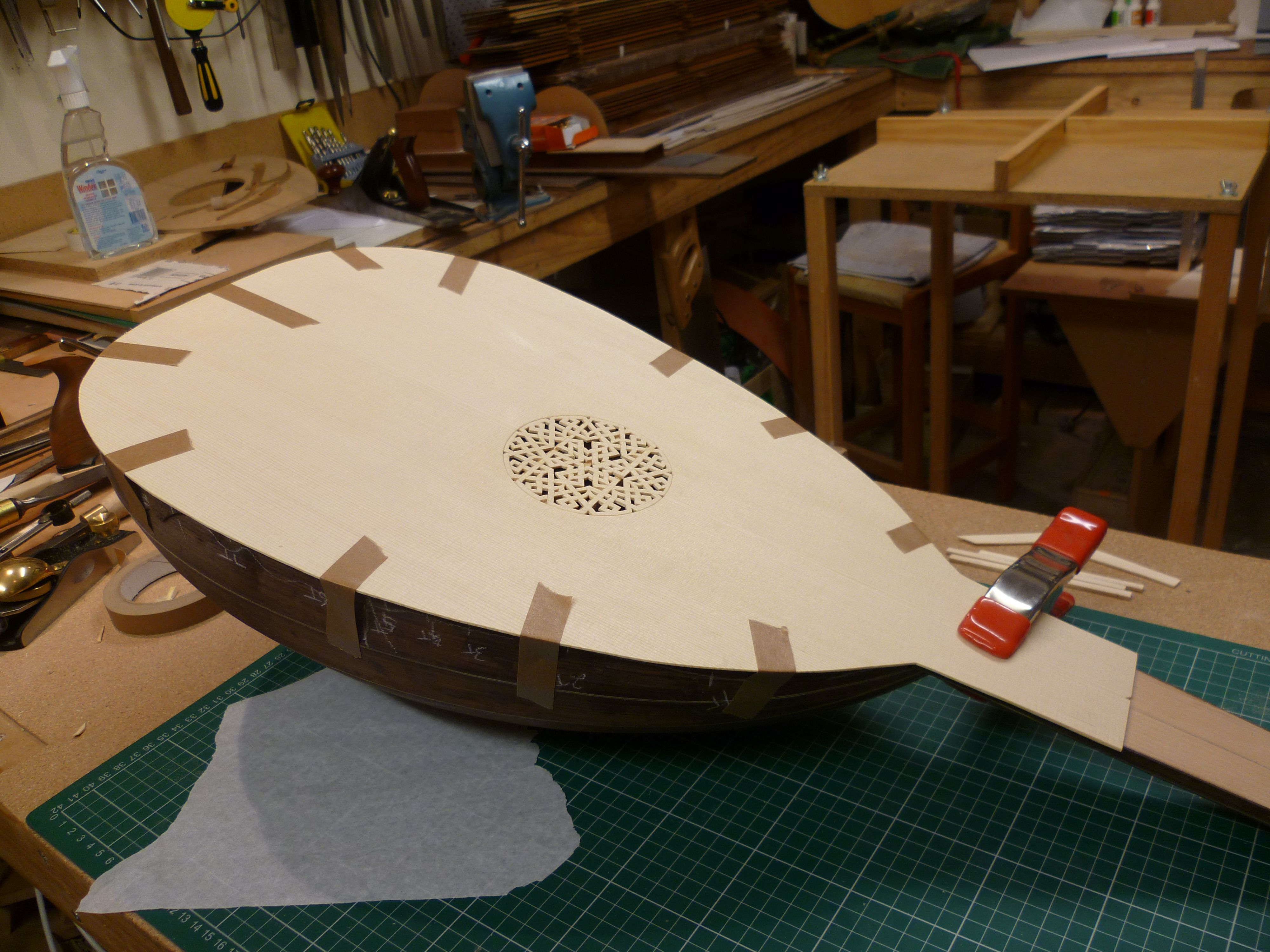

Post by kiwigeo » Sun Jan 23, 2011 10:48 pm
More work on the lute......braces shaped and top test fitted to the body.

Post by matthew » Sun Jan 23, 2011 11:13 pm
Martin that's wonderful to watch taking shape. You are a Luthier in the truest sense of the word!
My question - is the brace glued to the paper at the back of the rosette or just resting on it and glued either side?
Posts: 10873
Post by kiwigeo » Mon Jan 24, 2011 8:53 am
matthew wrote:Martin that's wonderful to watch taking shape. You are a Luthier in the truest sense of the word!
Glued to the paper as well as wood each side. van Andrews removes the paper backing before bracing but alot of makers leave it on. I prefer to have the extra reiniforcing for the delicate rosette.
