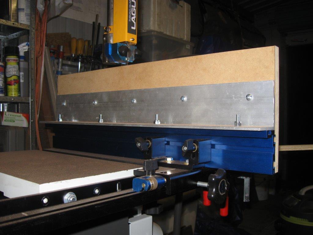

The Driftmaster fence uses 1/2" mounting bolts and so you you may have to drill out the mounting holes on your table to take the bolts (the current holes are just under 10mm on a 14 SUV). I considered getting this fence but the mod is permanent. The mounting bolts on the original fence are 8mm and I didn't know whether I could re-mount the original fence once the holes were drilled out. It was also a lot of money in Australia to buy the Driftmaster and high fence. The original fence doesn't have a great set up for adjusting drift angle. The Driftmaster is also a very large fence system - you could use it on a LT 14 SUV but there would be a lot of overhang off the smallish table on the 14 SUV - would probably suit a bandsaw with a larger table better.
There is a good vid of Les Stansell re-sawing using this fence on a Laguna LT-20 on youtube athttp://www.youtube.com/watch?v=ifW30tIJQMg.

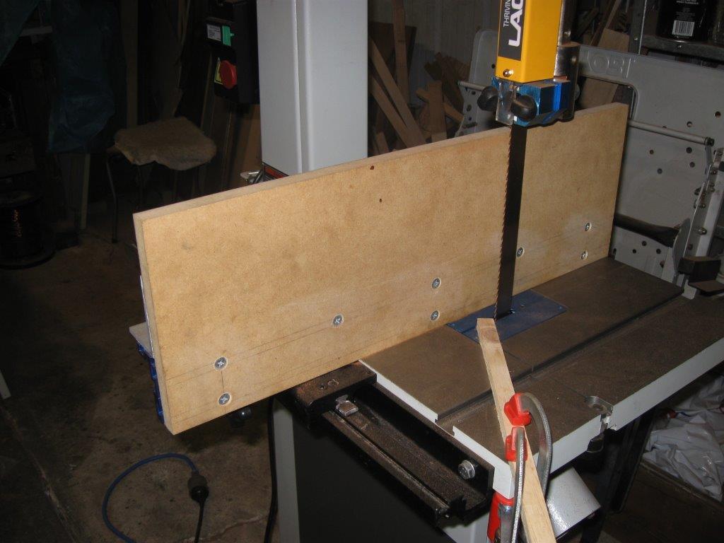

I had a Kreg Bandsaw fence off my previous Jet 14 that I fitted - no mods to the table required and just one additional hole need to be drilled in the fence mounting rail. I also had a long piece of Kreg L-Beam off a Kreg Mitre fence that I wasn't using. Added a high fence and some re-enforcement as per:
When I don't want to use the high fence it just come straight off and the original shorter Kreg L-Beam goes back on for everyday use.

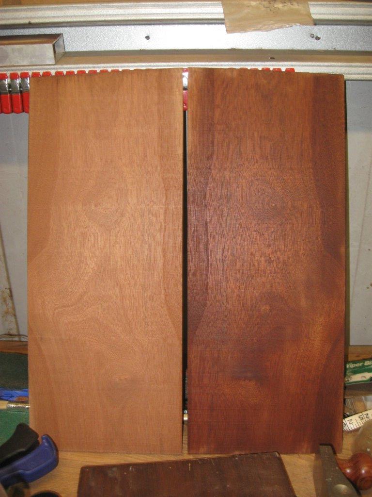

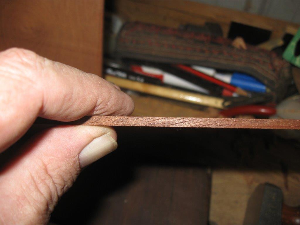

I've only done a few test cuts so far with a Laguna Shear force blade but all seems to work well - a little bit of "barrelling" to the cut - I think I have to play around with the drift angle a little to get a completely vertical cut. Tested it with a piece of Miva Mahogany I had laying around.
