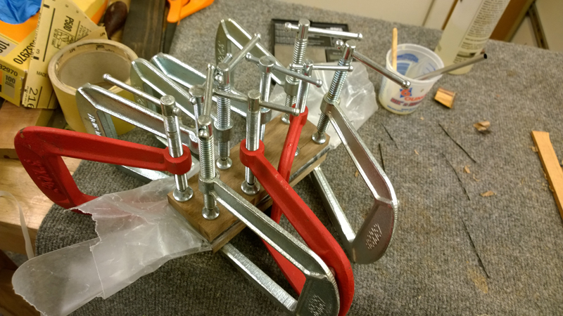

Here is a sequence of photos making a carbon fiber reinforced bridge for the falcate brace guitar out of walnut. Unlike an x-braced guitar the falcate bracing pattern does not have a cross brace across the center of the top in the lower bout so the bridge is used to provide a stiff brace. You will see in the pictures that I laminated carbon fiber in a walnut bridge blank. Walnut was use to as a bridge made with walnut is substantially lighter than an ebony or a rosewood bridge.
I also used a vinegar\steel wool solution to ebonize the walnut to give it an ebony look. That process is like magic and worked amazingly well.
I may make another bridge as I sanded it to the carbon fiber when putting on a 16" radius. It is not super noticeable as it is black on black after I ebonized the walnut. But doing the first is part of learning.
I cut out the shape on a band saw very close and just sanded to the final shape using the template as my guide. I have gotten to where I hate to shape on a router.
I shaped the wings with my luthiers friend in its drum sanding mode.
So far so good.
Here is where things went wrong I sanded a little deep when sanding the 16" radius on the bridge and expose some fiber on the top of the bridge
You can see the fiber. Next time I will have the top veneer a little thicker. Note the weight right around 22 grams with more sanding to go.
I used a brush to apply the the vinegar with dissolved steel wool. This pictures is the length of time to get my camera later.
You can see it is not a bad match for ebony. The ebony bridge in the picture weighs 35 grams.

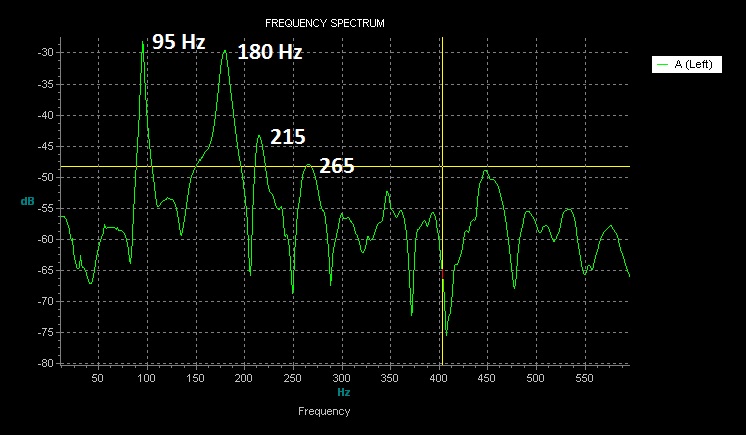

I have the bridge glued on so I bolted on the neck and took a spectrum sample. The helmholtz and the top amazingly came out at 95 and 180, The back is down about a semitone from where I hoped at 215 Hz. I can put some spruce into the brace scallop to raise it a bit. But I will wait until after the back is sanded and buffed. Other than that I am not sure what I can learn from the chart. The tap sound is good and the chart seems to show a bunch of peaks that can make a voice.
- with bridge and neck.jpg (88.19 KiB) Viewed 34954 times

I did a tap spectrum all strung up and I ended up with 92, 172, 214. The guitar is really starting to sound good as I get it set up properly. It is very responsive light strings. All of the notes ring clear. All and all I am very excited.
