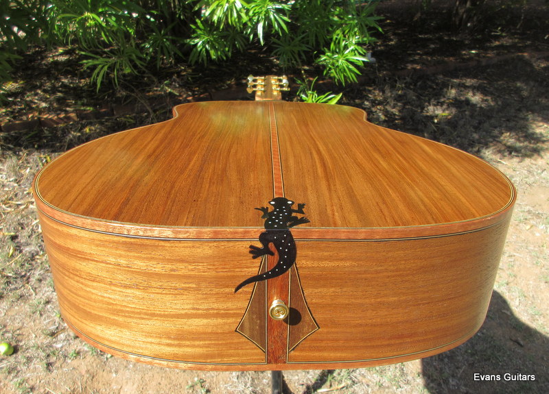

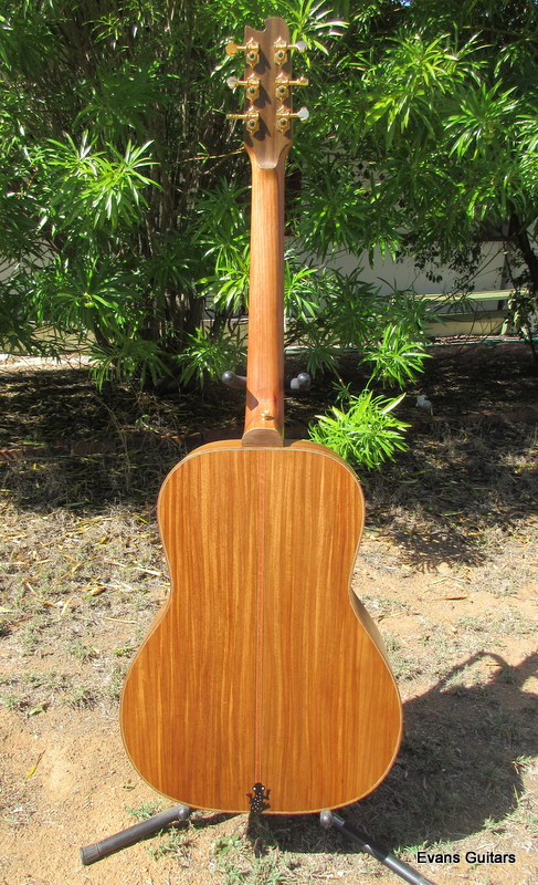

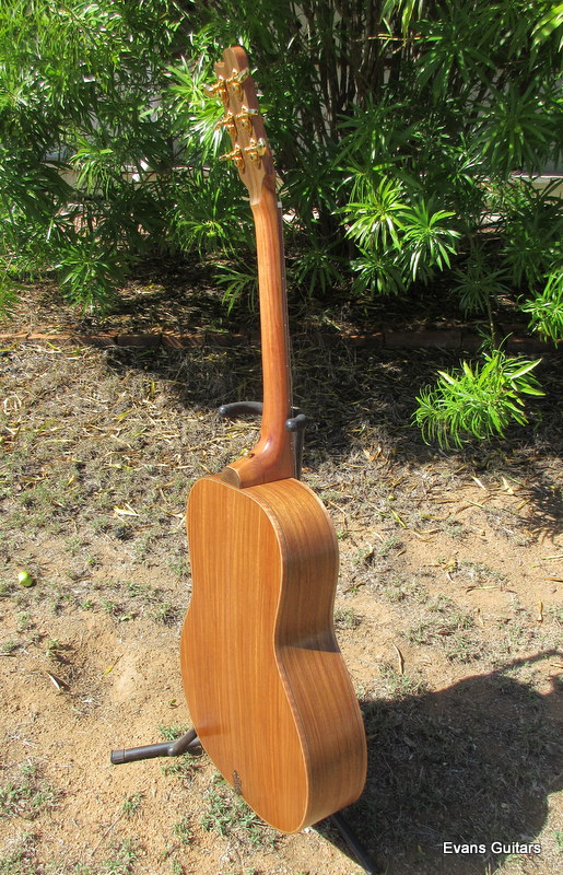

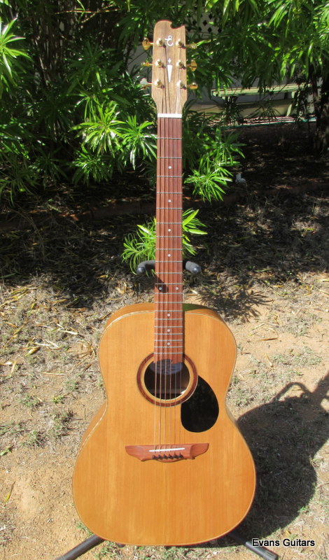

This guitar was finished late last year. It is made using New Guinea rosewood back and sides and neck, with a Cedar top. The inlays are mother-of-pearl and ebony. It’s a “000’ size guitar with gold frets and gold tuners. On this guitar, the sides were laminated as an experiment, which possibly accounts for the long sustaining notes and fullness of sound.
Geckos are regular visitors to my shop, but this is not one of them.
Cheers Taff
Thanks for looking.

I love the gekko! It immediately makes you smile and gives the instrument a fun and friendly vibe. The rest of the instrument looks great too.
