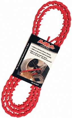

One thing I will add. Regardless of 'which' saw you are currently running, if it has standard "V" belts it's performance will be improved remarkably by simply changing out the originals for Fenner Drives 'Power Twist Link Belts'.
http://www.fennerdrives.com/high_perfor ... bgodFxk1DA
They can be found locally but you will pay far too much. Buy them off ebay in the USA. This guy is good for link belts and urethane tyres for your bandsaw: http://stores.ebay.com/SULPHUR-GROVE-TOOL The 4' length of 1/2" "A" profile @ $26 USD per length will fit most machines. If you need longer you can by 2 x 4' lengths and simply joint the links in as required cause it only takes a second and no tools are required. If you need lots more you can even buy full rolls of the stuff but that would be Xie..
These belts are quicker to fit than traditional belts and can be quickly adjusted to fit any machine in seconds just as long as you buy the correct pulley profile. These belts last longer than traditional belts because of reduced friction, and most importantly, because each link rides over the pulley, the vibration normally generated by a standard "V" belts because of 'belt whip' that is created by 'belt memory', is dramatically reduced. This is because each link conforms to the radius of the pulley even when the machine is not in use and therefore there is no memory to contend with resulting in the machine, be it a tablesaw, drillpress, or what ever it is that is being driven by a belt, will start smoother, operate smoother, and in the case of a TS with improve the quality of cut.

The OP may be old but my post re the link belts is very relevant to anyone with a TS, try it you'll like it.

Thanks Kim for reminding me about those belt links. I wanted to buy them years ago but didnt get around to it (read AU dollar = 60 US cents) but now I would like to revisit that situation (read AU dollar = 99 US cents)
