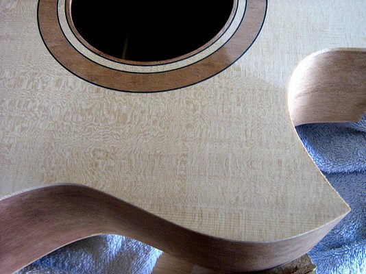

My method is to inlay the binding into the soundboard before cutting out the soundhole.
Leave the soundboard a little thicker than you require .Route a slot which doesn't quite reach the full thickness of the soundboard and glue the binding in. When dry , thickness the underside of the soundboard to expose the binding channel . Cut out the soundhole and you're done .

Forgot to mention , I bent the Mahogany binding ( 3 mm. ) on my hot pipe prior to installing

Re: sound hole bindind
Post by Steve » Fri Oct 15, 2010 8:22 pm
Craig - what sort of timber is your soundboard made from? It looks spectacular.

Post by Craig » Fri Oct 15, 2010 9:03 pm
Thanks Allen .
Steve , it's Sitka Spruce . A really nice well quartered piece. The whole board is covered in that 'silking '. It's exceptional
I bought the back and sides as Pommele figured African Mahogany and used it also for bindings , purflings and rosette etc.
