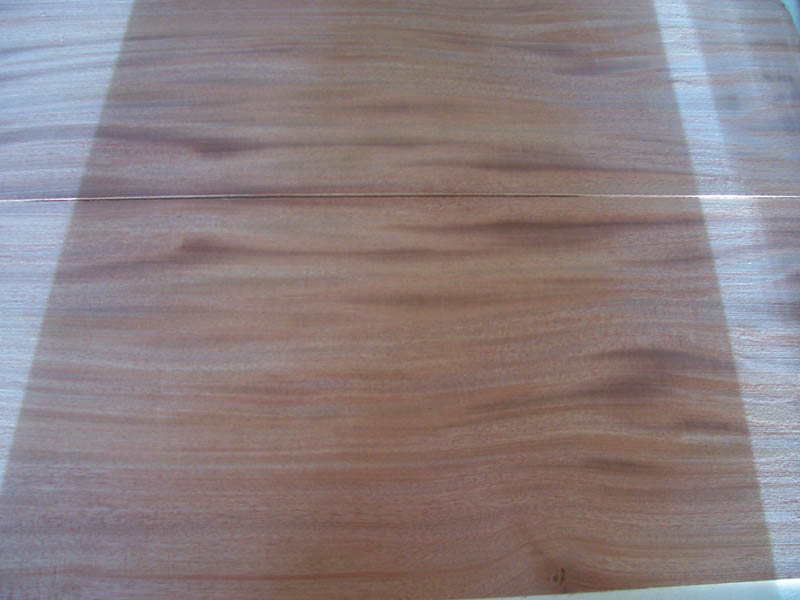

If you remember, I asked about getting some tips on drying the local garden variety of African mahogany. What I got out of it was that when I first tried to dry it 15 years or so ago I think I was letting to much breeze get to it (compounded by drying in the "dry season" here). So now it is the beginning of the "wet season", the humidity is up so I have sawn up a few boards to stick up. This time they will be stored in a small garden shed with little ventilation, that being the gap around the door and the gap between the roof batten and the corrugated iron. I mainly saw up a bit of radiata pine for sticks for dry wood but did not want to use it on the wet stuff so I have bought those disposable chop stick you get with take away food, not the bass wood ones but the bamboo type(or maybe it is some sort of cane?) they are just a little shorter than my back sets but close enough.

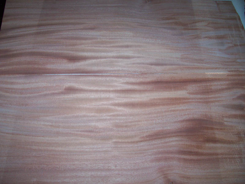

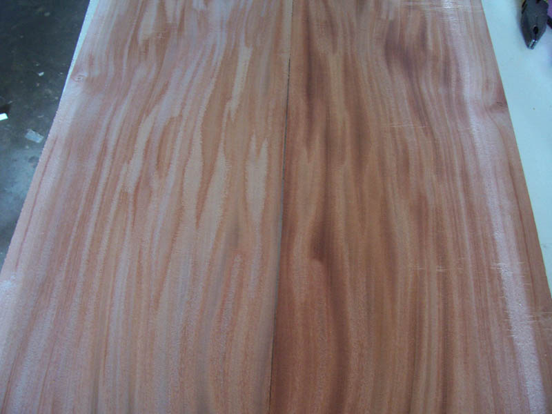

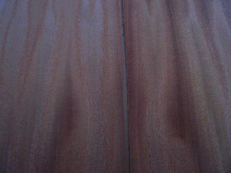

The photos tell the reason I am so keen to get this wood happening, Here is a few shots with different light and angle so you can get the idea of it.

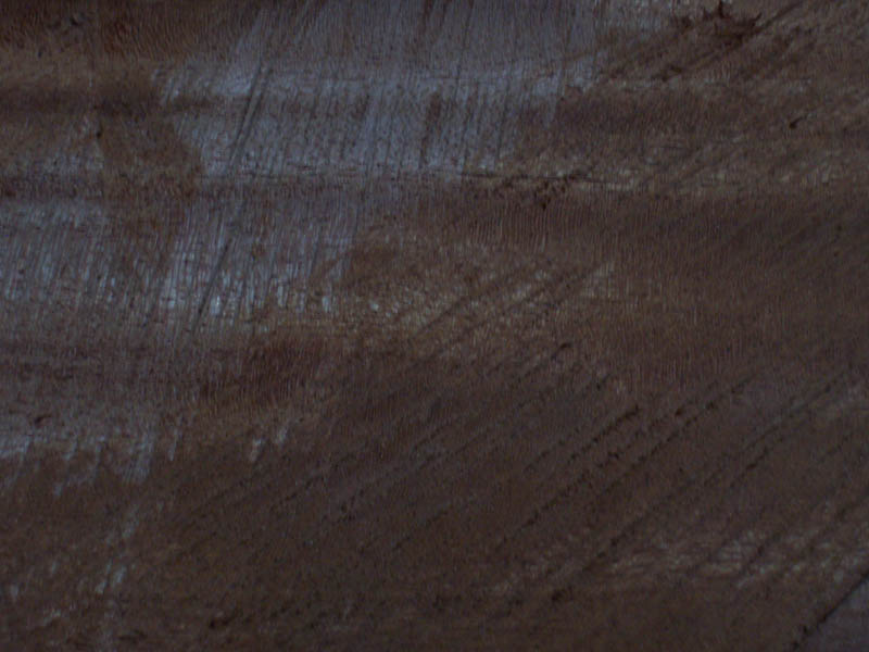

Re: Take 3 Khaya Senegalensis
This is a bit of it chainsaw cut and ran over the buzzer, you can see the pale fresh cut oxidises out to that mahogany orangey brown fairly quickly. It is not quite as dark and less brown than the Honduras mahogany I have here but then it has not been sitting around as long.

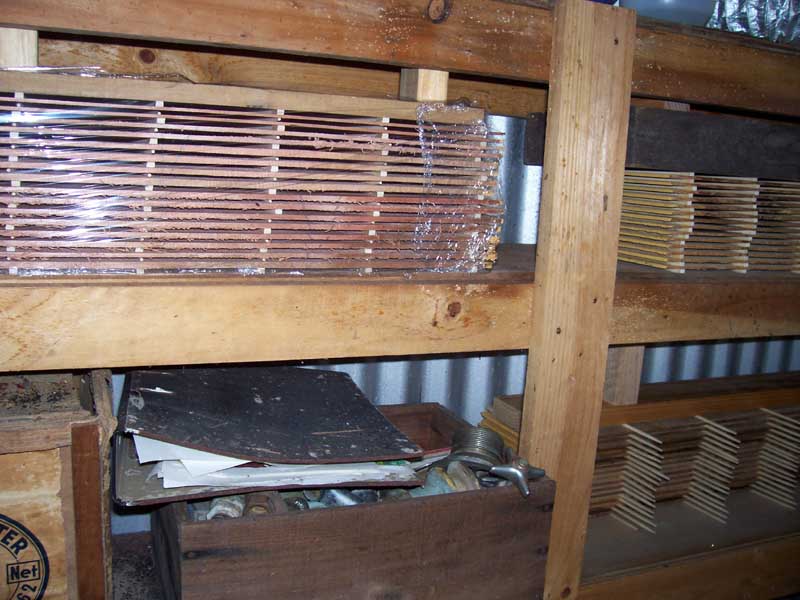

Advice taken, as you can see I wrapped it in clear so I can keep and eye on it, The stack next to the wrapped one is ironwood and I have no fear of that being a problem, it has very little water in it even when green, which is part of the reason it is so stable in service.
After wrapping in plastic I eventually noticed a little fur growing around the sticks (none in the ironwood racks though which are not wrapped). So I pulled them apart rinsed all the boards with a mild bleach solution and have re-racked them without plastic, I will keep my eye on them again till I am sure the mould won't come back.
A little further on this one. It looks as though the mould problem is with my choice of sticks. I noticed that some sticks I had set aside from the stacks in the shed have started to grow fur without being in contact with the wood and also noticed that with the ironwood stacks any part of the stick that is not in contact with the iron wood has started to mould ( a quick spray of exit mould has stopped it). I have now changed to the Basswood chopsticks and am treating them with exit mould before I stick up the boards.
