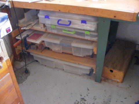

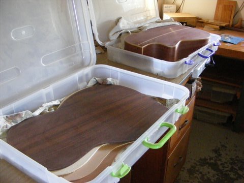

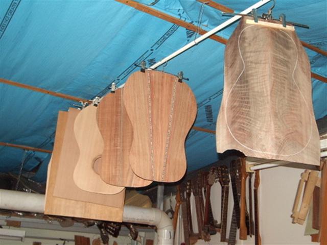

Heres what I have always done, works well for me. The cases hold plates snickered or not, if they are braced they are clamped to a simple form of the correct radius. And when stable they hang as shown, before work begins. When I start working the timber they stay in my controlled work shop, and back in the case between stages, as I build slowly. Not shown , but I have a hygrometer in the case that I can view through the plastic lid.
