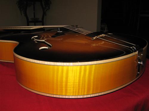

Hey all,,,, i finally finished the curly maple job and have some pics for you, besides looking pretty good it sounds ok too.
Some stats are:- b/s, curly maple
topwood, sitka spruce
neck, rock maple and purple heart
bwb purfling and curly maple binding
f/b, ebony
bridge, ebony
Headstock,finger rest,end graft, eucalyptus burl

Love your work Rod. It looks good enough to eat.
I particularly like the job you've done of the burst.

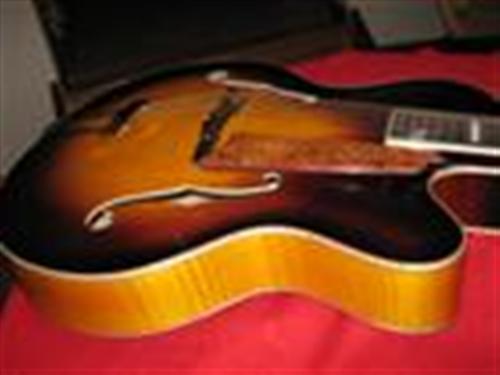

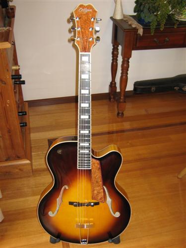

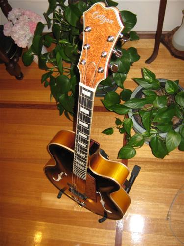

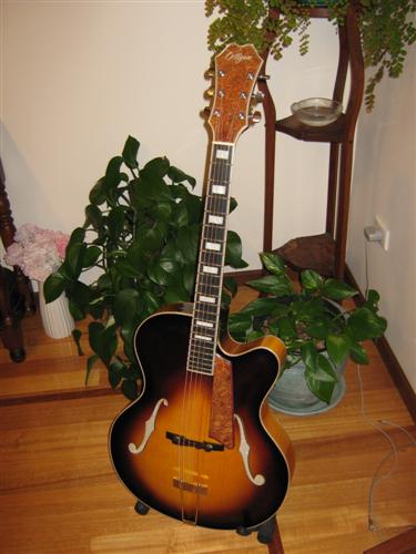

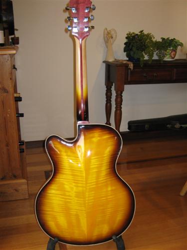

couple more pics, one of those didn't come out too good did it !

beauuutiful, love the headstock & finger rest.
where did you source the wood from? I'm looking at giving an archtop a go in the near future.

Nice job of the burst Rod although I see you didn't fully burst the sides or carry the yellow for the length of the neck, but that's a 'traditional' burst & doesn't have to be followed of course! I still like the bursting you have done though. Any chance of a few close ups of that headstock? that veneer looks the dogs whatsits! I can't remember if this was a parallel or 'X' braced top?
