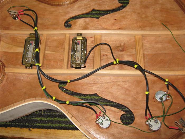

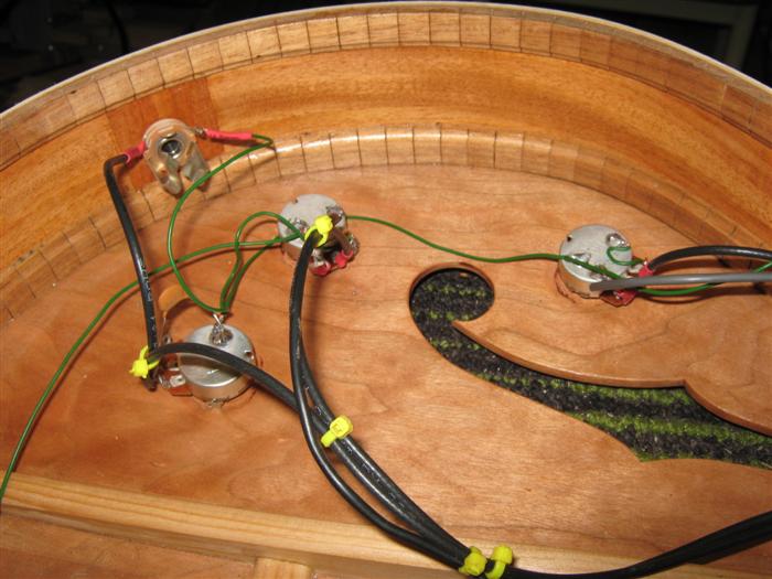

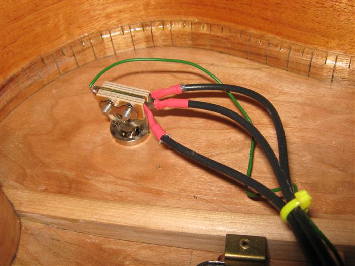

Just finished wiring this, tested, didn't blow up or electrocute me so i'm happy to continue with the build now. A couple of pics for you, criticism or other helpful comments are welcome, this is my first full electric

Looking good so far Rod, very neat & tidy which always scores points for me
Jim, I could be thinking this wrong but was always under the apprehension (or could it have been a missapprehension?) that if your guitar is humming when plugged into the amp and then you place your hand on the strings & it stops, that that was a sign of a poorly grounded bridge (not taking into account all other earthing/sheilding factors of the guitar). Any repairs I've done & hum was a complaint of the guitar, I always checked the bridge was grounding via the wiring & earth contact of the Jack plug. If I was meant to be the ground then why bother running a wire to the bridge (not meant to be confrontational, just wondering if my thinking has been wrong for a number of years)?

Hmmm sure, same, no confrontation just sorting it out as your comment didn't match with what I thought is going on. If I was 100% sure then there is no need for me to question it. I will answer with a question again
. I reason that If the bridge is not earthed well how could you cancel hum when you touch the strings. That is to say if the strings are not in the loop how could touching them affect the circuit and cause any effect.

And then again, if you use a soundhole pickup on an acoustic guitar, it never has the strings grounded anyway

Toejam wrote: I reason that If the bridge is not earthed well how could you cancel hum when you touch the strings. That is to say if the strings are not in the loop how could touching them affect the circuit and cause any effect.

Hmmm got me thinking (Scurries away to do some more reasearch), thanks chaps.jeffhigh wrote:And then again, if you use a soundhole pickup on an acoustic guitar, it never has the strings grounded anyway
Re: electrics
Laying hands on strings will earth what is going through the bridge - best done with non-rubber soles and standing in a bucket of water.
The bridge/trem is IMU used as a collection point for earths (transducers. preamps et al) and that is- in turn - earthed through the output as a single concept.
You can be the earth but you have to be in the loop - so to speak

Every wiring schematic for electromagnetic or piezo transducers I have come across/used has parts earthed. It (the earth) need not go through the bridge but perhaps with a conductive bridge/saddle (metal) that may be desirable. In my understanding the final "earth" is found through and beyond the output jack.
Were it essential that all metal parts "had" to be earthed would not the machine heads be in the argument too - or the nut?
Not rocking- just shopping for more knowledge/better understanding
Nick - if all else has been earthed to the bridge as a collection point then any bad contacts there, either incoming or outgoing, will detract from the overall earthing. Not rocking, not shaking, not stirring - just strummin the mental chords

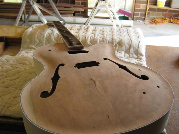

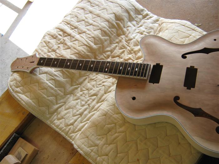

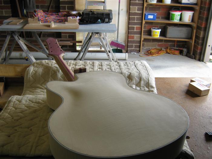

Hi all, I just fitted the neck on this today, thought you might like a preview, laminated curly maple back and sides , carved cherry top.
Cheers,,, Rod
Cheers,,, Rod
Re: electrics
Starting to look the part Rod, that neck looks like a nice bit of work.

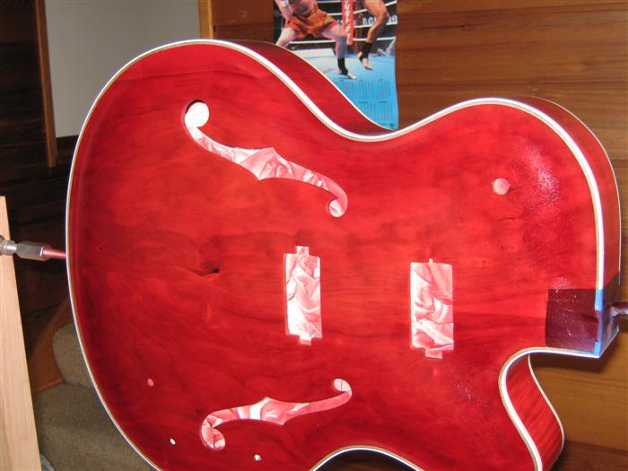

Re: electrics

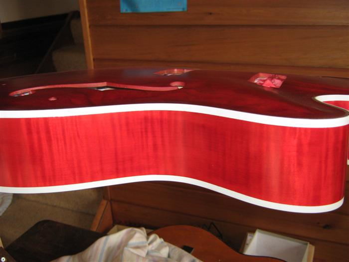

I've got some stain on this baby but the weather has stopped me from puting the clear on, if i can get a couple of coats of clear on it i'll be able to set the neck and then finish the laquer, i don't like my chances though, sposed to keep raining till Sunday. Any idea what that headstock veneer is?
Cheers,,, Rod
Cheers,,, Rod

Re: electrics
Re: electrics
Wood?rocket wrote: Any idea what that headstock veneer is?
Cheers,,, Rod
Sorry Rod but I couldn't help myself, think I've overdosed on me smart arse pills today.
Should come up a nice with some clear over the top, I'm picking that will go cherry when under finish?
