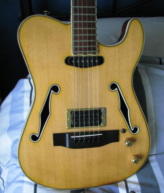

Many moons ago I made a telecaster with an acoustic top & 'hollow' body, my first foray into the acoustic world. The guitar wasn't bad, no good as an acoustic obviously but it had an acoustic wooden bridge...a generic one from Stewmacs if I remember rightly. I wanted it mainly so that I could fit two pickup systems, the standard magnetic type & an piezo undersaddle (with onboard preamp tucked in behind the soundboard) to try & produce an acoustic sound. It partially woked in that respect but running through the magnetics, having an acoustic bridge wasn't any different than the metal style.

Posts: 1067
Re: wooden bridge on electric guitar ?
Post by Taffy Evans » Mon Oct 25, 2010 6:07 pm
This guitar has wooden saddle and electric pickup.
DSCF5086 (Small).JPG (53.15 KiB) Viewed 8865 times
Puff
Posts: 461
Post by Puff » Mon Oct 25, 2010 7:58 pm
From the angle of the spider there's a tad of compensation in there too :D Like the wee offset of the tailpiece also. Is there an undersaddle lurking in there too?
