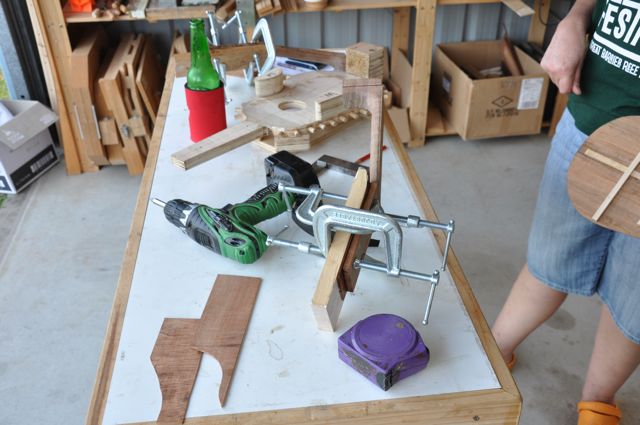

Great stuff Allen - seen this Ken Timms fix for situations where you have few clamps? A stool, a baseboard and a few 9mm plywood sticks - hey presto, a go-bar deck
For radiusing I used a simple caul with the machined radius onto which individual bars could be clamped. Takes an hour total to do a back Assuming a grab time of 10 minutes the proceedure is: glue and clamp 20 minutes each individual bar. Works a treat in the workshop environment and is simple, requiring no tutor assistance.

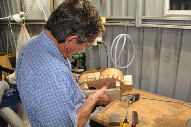

Alan installing kerfed linnings.
