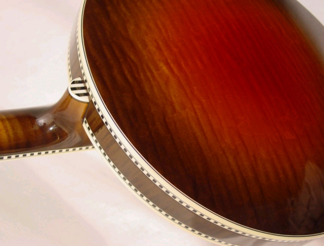

A friend of mine wants to build a guitar and would like to use the chequerboard binding seen on the attached image.
Warning: the following image contains graphic depicitons of banjo-like instruments. Luthier purists view at your own risk.
My question is:
Does anyone know where I might be able to find/purchase such a binding?
I welcome (relevant!) suggestions

I believe Gurian will make it up for you. Gotta buy a shed load though.

If you only want enough for one guitar you could make your own. I couldn't think of a much easier pattern. Still a it of work though.

Sorry no and a point for your friend to ponder - such a binding would broadcast a fraction of asymetry in body shape loudly at the neck joint or tail graft. Embarassed

Thanks Liam, I had a look there and anything is possible. I also found a llink to someone who shows how to make their own rope binding. I could make it at a pinch.
Good point puff, I'll remember to be careful but as this will be a Tele, I think I will get away with a bit of asymettry.

Hi Richard.
Try Veneer Inlay Australia (.com.au) they have a reasonably wide range of timber banding available.
Specifically here :
http://www.veneerinlayaustralia.com.au/ ... tml&Rec=12
Seems they have something along the lines you want but whether it fits the bill exactly is up to you, or your mate.
That is a link to page one and I believe there are 9 or more pages to go through.

That kind of checkerboard binding will work in a straight line, as used on those banjos, but will be much harder to bend in a flat plane as you will have to do to get it around the shape of a guitar. Rope binding with the sections at an angle will be easier to use and bend and will make it easier to hide the gaps. The pic below is the edge of a hardanger style fiddle I made earlier this year. The edging is tiny blocks of ebony and tulip satinwood all glued in place separately, and with lots of them trimmed to fit around the curves. It is quite a relaxing thing to do, with a pot of hot glue and a sharp knife.
