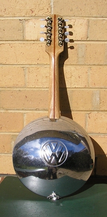

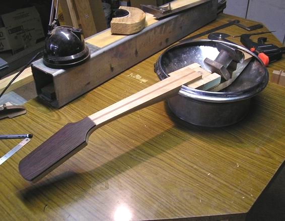

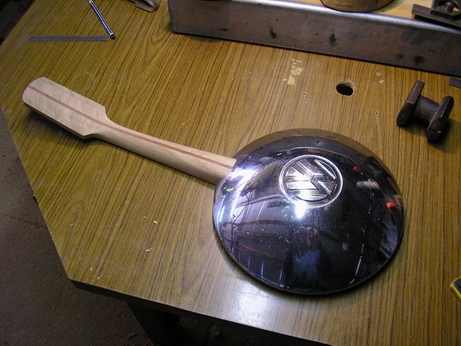

Hi Folks, thought I should show a couple of pics of my latest silly instrument.
I have been thinking about a VW hub cap Mandolin for a while so started to put things together its very early doors and still working it out as i go.
So far I am happy with my efforts. The neck joint is a hybrid sort of bolt on pocket and a tenon down the centre
like a T section.
Shall glue it up with epoxy may be.
Any ideas or heckling feel free. Still thinking about the sound board have some cedar that a friend gave me not decided as yet
Neck is Tassie oak/Vic Ash from local hardware store with a red gum down the middle it was an experiment that looks ok.
Its all some fun.

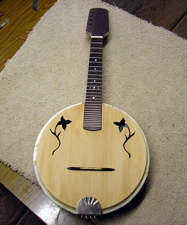

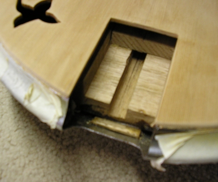

Hi all, here is a pic of the build so far its a cedar top forgot to take a pic of my bracing but is typical of F sound hole mandolins i have spied on the net.
the sound hole design was done by my partner and it was a job to cut out.
managed to snap a bit off but glued it up and have carried on as it is an experiment
The neck is not glued in as yet and the hardware is there as a rough guide on how she may look.
The top is glued to the metal hub cap with a product called Tool Box its a filler/glue stuff that works great on metal.used it a lot on my steel body reso that I posted some time ago.
Might string her up before I decide on final finish etc to see how she sounds.
Shall have to stop work soon as we are planing to move house so have to pack up the shed. I have box's of hub caps, tins, cigar box's etc my be it's time for a good clean out of my junk/objects that I have collected thinking how will this thing sound with a set of strings

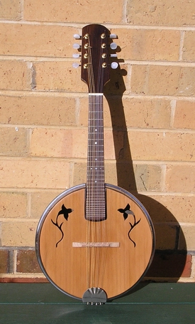

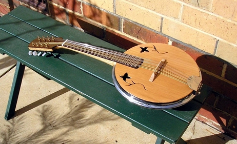

Re: VW Hub Cap Mandolin idea.
Thanks for finding the thread guys.
Here is the finished mandolin,Sounds great. Had a few mandolin players have ago at the Uranquinty folk festival all loved it for various reasons.
Dave O,Neil thought it was cool a great sounding Celtic mandolin were his words
Had my mate give it a run last Sunday on the Reid Street Stage at the Wang Jazz and Blues festival
worked well for some old time string band blues too.
