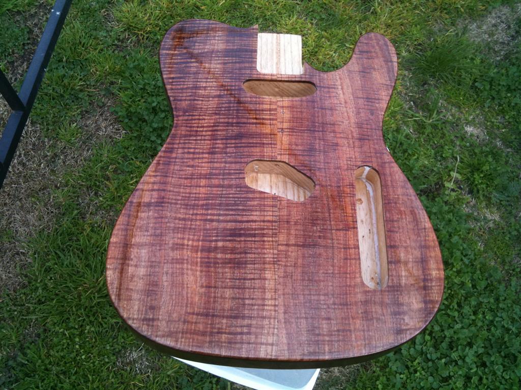

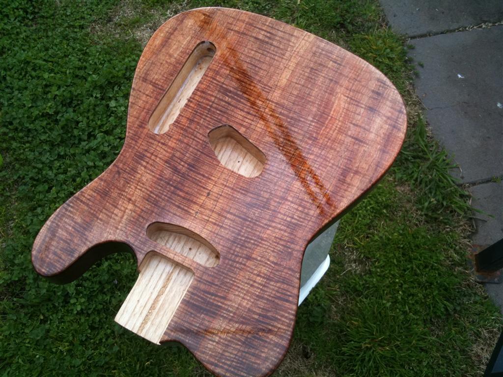

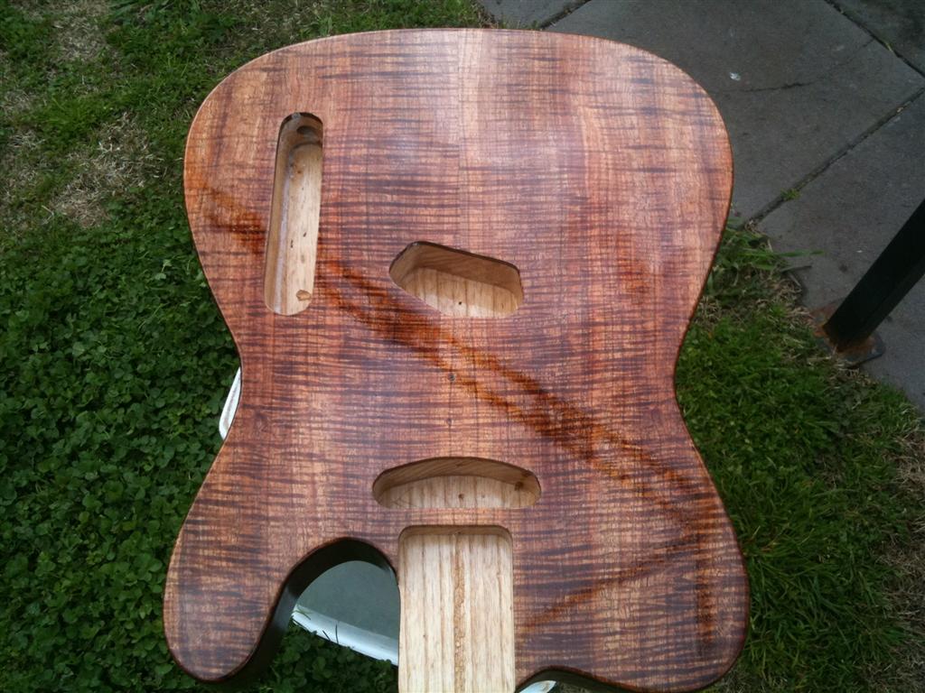

Getting some finish on this beast at present.
Blackwood drop top on Swamp Ash.
It'll be fitted out with gold fittings and a set of Lindy Fralin Blues specials.

Got some finish on to it and it's come up pretty well. It didn't behave itself and kept getting pinholes in the finish so I don't know how many times it got rubbed back and re-done. It's probably got 35 coats on it.
I hope you didn't have to rub back by hand. That'd be enough to drive a man to drink, provide his arms weren't too sore to lift a coldie.
oh yeah, and that blackwood would put a horn on a jellyfish. nice 8)
Re: Telecaster
Post by Bob Connor » Wed Nov 03, 2010 12:41 am
Mate - I'm looking like Popeye. I don't use sanders on finish and prefer to do them by hand. But I'm bloody thirsty.
If I could get a pneumatic sander so I could slosh lots of water at it I'd be happy but the pre-cat nitro balls up a bit on dry orbital sanding.
So it's a sanding block and elbow grease. I actually don't mind it and I feel it results in a better finish.
Usually start at 400 then 600, 800,1000 and 1200 before a rub with fine micromesh then it's to the buffer with fine Menzerna. I use one of those small Ubeaut swansdown buffs on the drill press.
