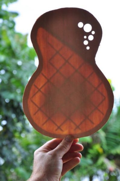

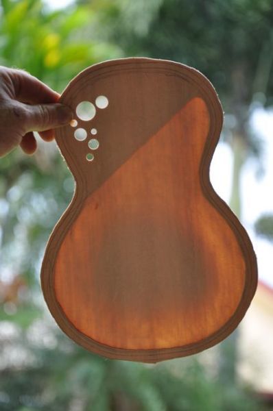

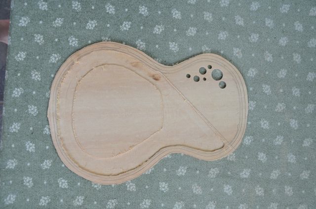

So, I started out with some Sitka Spruce with some nice and subtle bear claw and ran it through the drum sander down to .080. The top at this point is still very stiff across the grain and weights in at 46.0 grams.
I then set my laminate trimmer to route around the perimeter of the area that I'm going to apply the lattice. I took this area down to .035. and it dropped the weight of the top to 38.5 grams.
I then blended the centre section into the perimeter, being very careful not to take that area down any more, and ended up with a top that now weights in at 35.0 grams.
It is also fairly flexible across the grain but only on the perimeter, My thought is that I want the entire lower bout and part of the upper to act like a piston. At least this in theory.

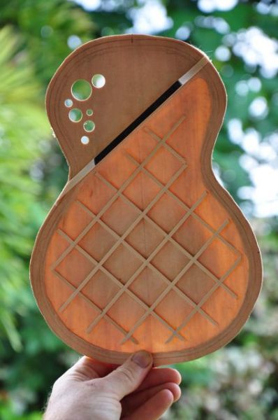

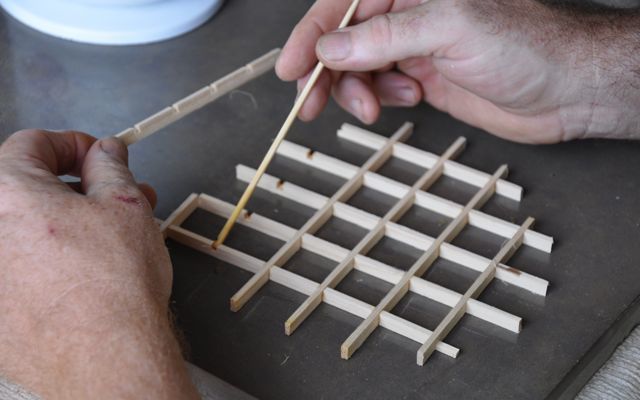

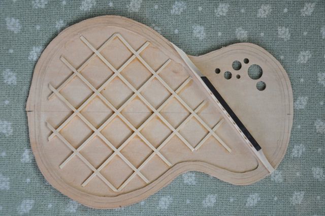

Next I made up some lattice on 30 mm centres out of 2.8 mm x 6 mm tall Red Spruce. These were just some off cuts that I had in the scrap box that I felt would be useful for something, and turns out they are. :D
I made them 2.8 wide because that was the width of my thickest table saw blade, and I could cut all the lap joints and have a nice snug fit quite easily. I then put a dab of hide glue into each joint and pressed them together on a granite slab, so that they were nice and flat.
I dressed the bottom of the lattice on a flat board with 100 grit paper on it after it was dry, then pressed the lattice onto the top with a bit of a radius built into the work board in the lower bout. All glued in with hide glue as well.
The lattice weights in at 13.3 grams prior to voicing the top. I also glued on the UTB today, and the entire top now weights in at 52.3 grams.

Wow Allen, you've really ventured into some interesting territory here! Must have been a great bike ride for all that percolation!
That backlit shot of the thinned top is great, can't wait to hear how this works out.

My first thought Allen is that the lattice pieces could be half that thickness.All that timber will certainly stiffen up the top again.From memory Smallman's lattice was made of 3mm thick timber for a full size guitar.Keep up the good work.

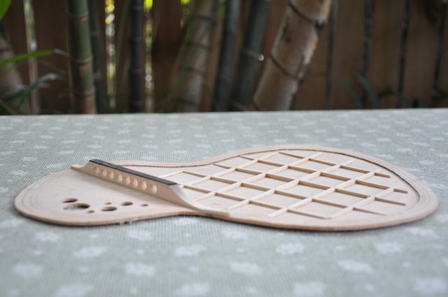

You're spot on with the hight being too much Micheal. I half expected it to be, but it was a lot easier to handle pieces that size rather than toothpicks, and easy to take the hight down, rather than try and stiffen it up after.
Anyway overnight everything firmed up enough to work on it this morning. It was so stiff I reckon I could have stood on the top and not damaged it. :shock:
So I took the Festool sander with some 80 grit to the top of the lattice and took it all down to 3 mm tall. This is where I just started to see the lap joints appearing. Then I started to taper the entire lattice down around the perimeter. Flexing and tapping as I went.
I finally ended up with the sides of the lower bout down fairly thin, as well as up by the UTB, whilst keeping the end of the lower bout just a bit taller. I didn't want to have the top too loose along it's length.
The lattice in the centre of the bridge area ended up at 2.4 mm tall, The top is moderately stiff across the grain with it being far less stiff on the edges of the lower bout. My very best sounding uke with a cedar top is far less stiff than this once across the entire top, but similar to the way this one is at the perimeter.
Now to the numbers.
Original top was 46 grams without the thinning in the centre or any braces. This top now weights in at 43 grams total with all the bracing. So it is 6.5% less in weight.

I am curious. With the blending of the routed channel, what shape do you end up pressing your braces into. Once in the dish, I am assuming you have a radius on the inside with a flat/er section in the middle. Does this sound correct.
Whats the thinking behind it? I get that you end up with a thin perimeter but does it complicate the final shape of the top. Does the outside of the top retain its shape after gluing etc?
Re: Lattice Braced Concert Uke
Post by Allen » Thu Nov 04, 2010 7:39 am
I have a solera of sorts that I build the ukes on Dom. They use a Spanish Heel, and I've dished out the work board in the lower bout up to the area that the lower transverse brace would go just below the soundhole on a conventional top. I don't know what the radius would be, I just scooped it out with a small violin makers plane and sander.
I've kept the area on the solera were the sides and linings will sit flat. That is the dishing out doesn't go all the way to the perimeterl, so as to make attaching the top much easier.
I wanted to keep the area of the top under the bridge thicker in the idea of it being somewhat like a bridge patch, but having a nice smooth graduation in the stiffness. I've seen some tops that were very thin all over, and showed mapping of bridge patch and bracing. Something I hope to avoid.
From the show side of the top, there is a small amount of doming in the area of the bridge, On the underside the top itself and the bracing are thicker than at the perimeter. It even has a nice ring to it when tapped, which is something hard to get in these small tops.

Top thickness around the perimeter ended up at .035 inch or a touch less. The rest of the top is .080 inch. The area in the middle of the lower bout was blended out, and at the highest point under the bridge for a 12 fret to the body is .070 inch.

Yes it is thin, at about 0.88 mm.
Greg Smallman said that his tops on his Concert Line are 1 mm think and that is on his full size classical s, so I figured that going a bit thinner on a uke should be doable. The tension on uke strings for a concert sized instrument are going to be quite a bit less than a full size classical guitar.
Some of the ukes with spurce tops I've been looking at are certainly down in the 1.2 to 1.5 range without lattice bracing.
I get were you coming from with that Micheal, but I have a concern about enough glueing footprint if I went that thin on the lattice. I'd need to change the way I did it to one where I spread out something like epoxy onto a flat surface, then laid the lattice on it to "wet it's feet". Then I suppose the best bet would be to vacuum press them in. All things to consider as "Improvements" should this turn out to be a viable idea.
