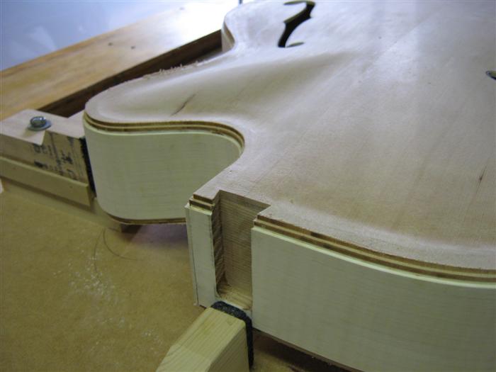

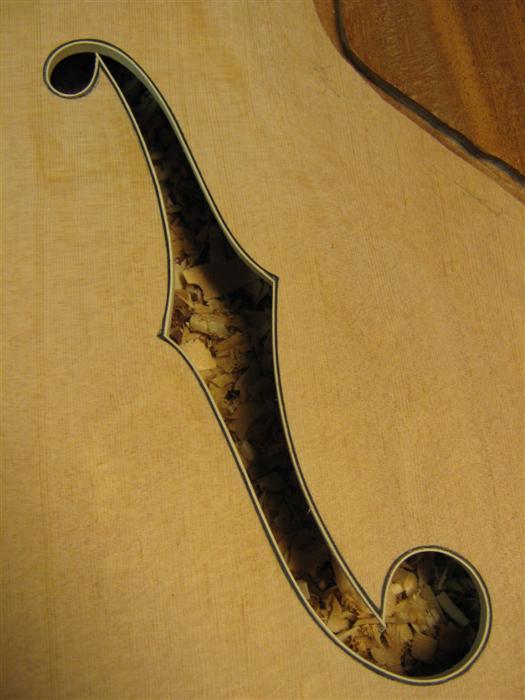

Hi there people, i thought i'd post a progress on that curly maple build.
I cut the sides to aproximate width and sanded to thickness, the offcuts from the sides gave me six lengths to use for bindings so i had a bit of a practice of bending the stuff to see how it will go before i actually bend the sides. Well i have to say the small binding profile bent quite well, easier than i expected. A recent post i put up about spotted gum and using it for bindng, well i tried using it for the "F" hole binding, very unsuccessful, so now i've changed my plan and am using the curl maple for binding the the guitar. I've used black and white maple veneer to bind the "F" holes and i'll use the curly maple to bind the rest of the job.
i've got some pics of the belly, andthe "F" holes, and prralell bracing. Cheers Rod.

Ah Rod,
This is coming along real well, looks like you have the top carved out very nicely and the F hole and binding looks very well executed.

I tried to do some binding like that on a soundhole recently and found that I have 10 thumbs, all on the left hand. Confused
Your's looks oh so much better and I'm looking forward to more picts.

Nice work Rod.
I always cringe before starting the f-hole binding. It's never a simple thing to do.

You're an artist Rod. Wish I could do that.
Re: curly maple progress
Allen wrote:
I tried to do some binding like that on a soundhole recently and found that I have 10 thumbs, all on the left hand.![]()
I replaced thumbs with re-enforced tape Allen, just bind a section at a time
Nice job & looking good Rod.
If you are binding the F holes with figured wood, be prepared to break or split a few bits so have more than you need on hand!

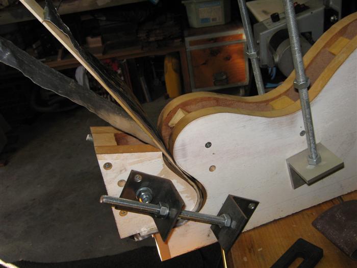

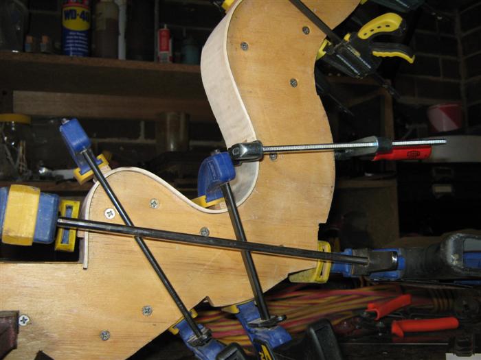

Had a RDO today so i had a go at bending those curly maple sides. It went well with only one crack, that is on the inside thank God, just at the bottom of the cutaway. I used a fairly unsofisticated side bender to do that half of the job and used a hot pipe for the other half. I'll post some pics Cheers Rod. P.S. I am very happy with the result.

It may just be just the close up Rod but the sides seem very substantial. At the cutaway it is quite common to thin down to around .085", even less sometimes especially on figured wood. Looks like it all turned out well for you anyhow but this could be something to look into to avoid cracks in the future.

Thanks for the tip on reducing the thickness in the cutaway area Kim, i'll keep that in mind for the next job. The sides are a bit thicker than usual, 2.47mm rather than 2.3mm, i suppose i'll have a bit more margin when cleaning it up!! Cheers Rod.
I read in Bennedetto's book that he takes the cutaway area down to about 1.8 mm ( if my booze addled memory hasn't failed me ). I did that on my venetian cutaway, and it bent on the pipe without a hitch.

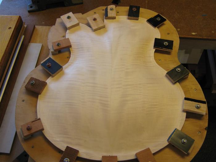

Hi there you lot, hope you all had a good weekend, i had a pretty productive one. On Saturday i fitted the linings and braces to to the sides, still in the mould. Sunday, after a bit of a clean up fitted the back, everything is going very nice at the moment, the only hickup so far is some small stains from the bending strap, which is steel, i had used an aluminium strap in between the sides and the steel strap to prevent this fom happening but somehow some stain did appear on the sides.
Oxalic acid is one bleach that is used to remove this sort of stain from timber, has anyone else experienced this ? and if so what method did you use to remove said stain. A couple of progress pics here for you.

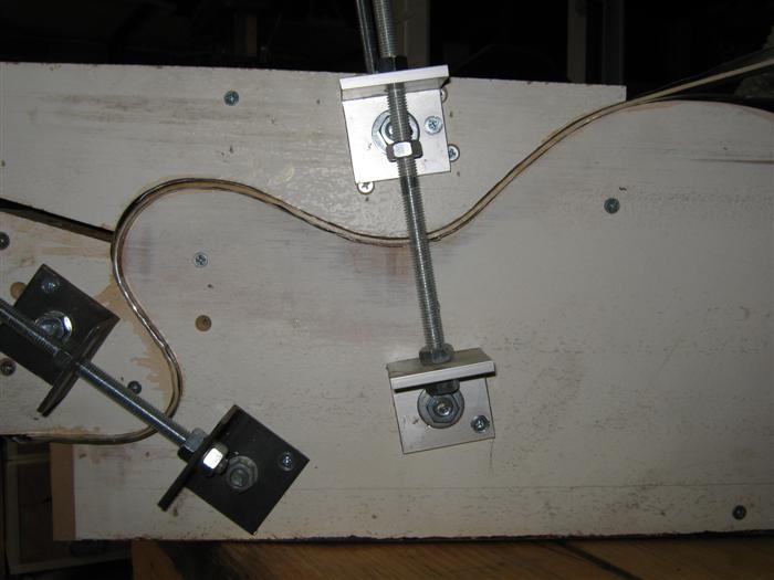

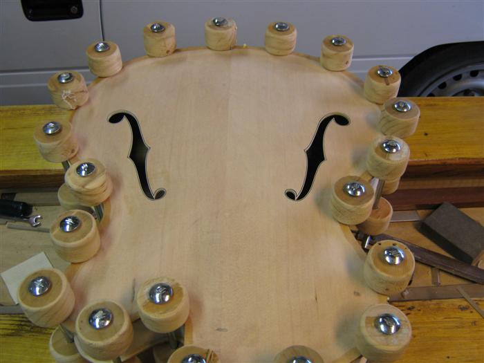

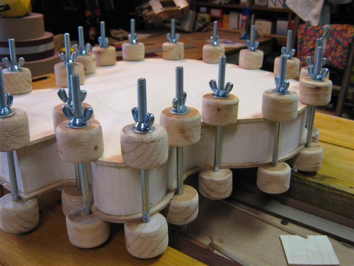

Hi there all! I've just closed up the sound box of this one, very happy with it so far. Thought you might be interested in the spool clamps i knocked up, very easy, didn't cost much and very effective. Cheers Rod

Looking good so far Rod, that Maple is going to come up lovely I can see that already. Now comes the meat & three veg part of the meal....the recurve! (After trimming obviously

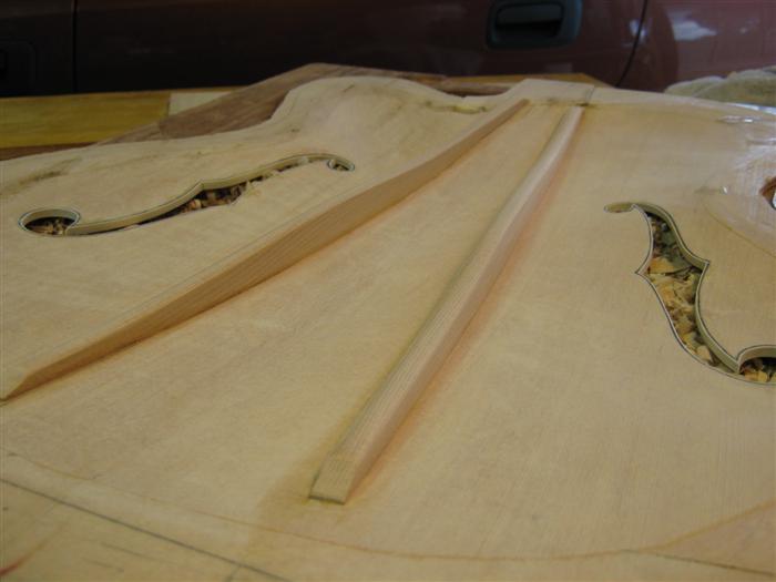

A couple of points to think about for the next one.
Your tone bars probably don't need to be as long. They are there for controlling the stiffness of the soundboard more than they are structural reasons, and you want the thinner edges to be able to flex. Running the braces right up to the linings will inhibit that.
You might also find some problems with the edge thickness once you have trimmed the top and back to the sides. When carving arched plates it is best to make the sides, block and lining assembly first and then cut the top and back outline pretty close (like 1mm) to it. Then cut a 10-12mm wide ledge (as you have done) and leave that there until after the binding have been installed. That ledge acts as a useful guide to the router or whatever you are going to use to cut the binding ledges. I suspect that you are not going to have much of that ledge left when you trim the plates to the outline and the recurve will be very close to the edges. With those fairly wide reverse linings you really wanted the shallowest part of the recurve a bit further inside
I do like your elegant spreader idea for holding the sides into the mould and your f-hole binding.

Graham, thanks for your helpful comments, much apreciated, boy you're very observant. With the ledge around the perimeter i had allowed for the excess to be trimmed off and still have about 8mm of ledge left, however a couple of spots are down to 5mm, still enough for the router to sit on. But i think your suggestion of building the sides first and marking the outline plus 1 mm on the plates would be a far more accurate way to go, i'll definitely keep that in mind next time, thanks. Cheers Rod.
- Posts: 414
Graham - I haven't been through this process yet, but it will be happening in the next week or two. To leave this ledge, is is correct to assume that you are not really tackling the recurve much at all at this stage??Graham McDonald wrote:

There is a body of thought, especially in the violin building world, that the best shape for an arch is a curtate cycloid curve. It is easily googleable and there are even on line calculators that will draw them for you. If you calculate curtate cycloid curves for the transverse arching shapes, it will bring in the shallowest point of the recurve towards the centre rather more than most people carve them. I see pics of a lot of arch-top guitars and mandolins where the recurve is quite close to the edge and it often means that the scoop up to the binding is rather severe. It also makes it hard to leave a 10-12mm ledge around the edge, which isn't critical, but having the ledge there makes it easier to cut the binding rebate. On a mandolin the shallowest part of the recurve is around 15mm in, and on a guitar bodied bouzouki, about the same size as a classical or 00 guitar around 25mm in. That means you can establish the shallowest part of the recurve on the outside shape, but comfortably leave the edges square with the ledge. It also means that when you start work on the graduations on the inside, the thinnest part under the recurve can be easily worked on and still avoid the flat area which will be glued to the linings.
There might be acoustic implications having the recurve further in or out, but I don't know of any experimental work in this area. Again in the violin world there is a lot of consideration given to the shape of the arching, but it doesn't seem to have spilled over into the mandolin/guitar side of things. There it is mostly either a Loar or a D'Angelico pattern, but there are those who do experiment. There are some arch-top guitar builders who are using very shallow recurves and carving the insides to control the sound and it seems likely that the recurve itself doesn't have much effect, more the minimum to maximum thicknesses.

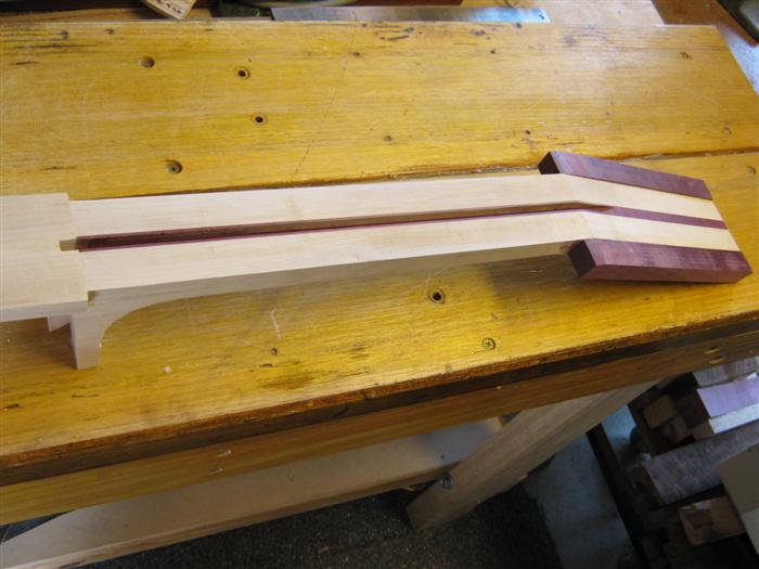

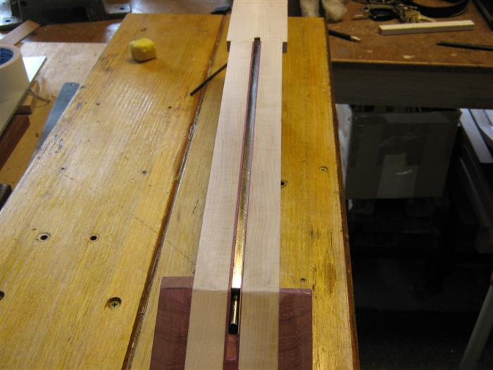

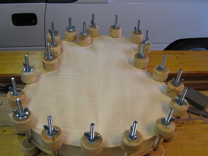

Hi there people, a bit of an update on the curly maple job. Sound box closed, binding rebates cut, truss rod installed, dovetail cut, neck extension fitted, headstock ears on. Some pics. Cheers Rod

Rolling along beautifully there Rocket, the binding stairs look nice and crisp.
