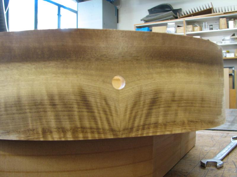

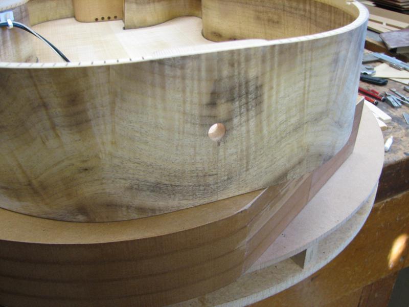

After looking at the pictures I've decided I will do a graft on No1 but may leave No2 as it has some interest.
Both sides have been 'wetted'
No1 hasn't got as much going on at the butt as the rest of the sides
& No2.
What's the concensus among you guys? I'm not usually dithery about these things & tend to have things planned well in advance but this has been niggling away at the back of me noggin since the day I glued them together. :oops:

Nick it looks awesome !!! personally i would'nt add a graft to that beautiful join.

personally I think the butt strip is one of those elements that set the hand-made apart from the factory built instruments but then again Nick, those butts of yours look exceptionally tight. i think you'd definitely struggle to see the sun shining between them :lol:
That is what the wood is telling me as well Nick, great choice.

Those are damn fine but joints! I think # 1, with the little gray patch that lightly breaks the symmetry, will benefit from the graft.

Both those joins are exceptional and you should probably put together a tutorial on how you achieve such a snug fit.
I still like the end graft treatment as part of the binding scheme, but I sure wouldn't feel that either of them would be less for it, if they didn't get one included.

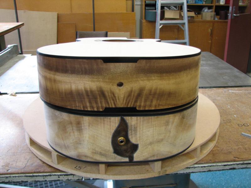

Jury's still out on this but I will have to make a decision soon as I'm getting closer to the binding step. I will go with my original choice and graft the first as this area of the grain needs a little "livening" up, scratching my head with the second, this is going to be the one I supply to the customer now after contemplating grain e.t.c. Just think it's going to sparkle that little bit more.
Re: To graft or not to graft, that is the question.
Post by Nick » Sat Nov 06, 2010 7:32 pm

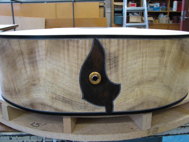

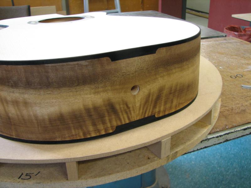

Ok may I present my solution to my dilema. I didn't want to do the 'squared' across at the tail solution. I don't see anything wrong with doing that, by the way, it's just I felt that the grain patterns didn't lend themselves to the look. The original shot of the one that had some feature
I decided not to go with a full graft but just to do enough that it looked like I've spent abit of time on it rather than just gluing two bits of wood together :lol:
And the other in it's original guise
I decided to stick with the fern theme I'd started in the rosette.
Not sure I'm 100% in favour of it now I see it in the flesh but it's still able to be changed for something else, just thought I'd canvas opinion from the forum members.
Post by Lillian » Sat Nov 06, 2010 7:33 pm
Nick, they are both well executed. If I had to pick between the two, I'd go with the demi-end graft. The fern doesn't do much for me. I may feel differently once the finish is on it though. But for the moment it looks like a bit of an afterthought to me.
