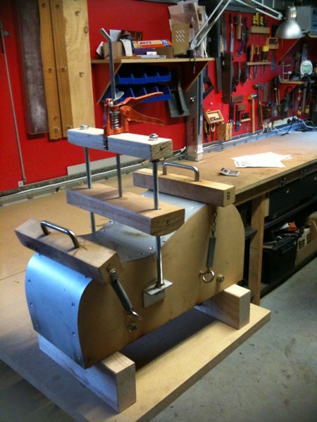

Hi people.
I'm fairly new to the forum and still playing catch up on some archive posts. Found this one and thought I would post my version of the waist press "screw" on my bender. An old broken caulking gun rescued from the bin. I find it super quick and easy to use and has plenty of travel. Cheap as!
Note the scorch marks on the bottom of the form. Before I got my heat blanket I used to throw the thing on the grill section of my barbie. Very Aussie! It sort of did the trick but I always risked setting the whole rig on fire. Sides would have this combined smell of rosewood, smoke and steak for a while.
Pete.
Pete.

Re: Bending jig thread screw
Hey Taff,,are you happy with the amount of leverage you can get using that old bandsaw wheel to turn down that 1/2 inch all thread???
- Taffy Evans
- Posts: 1077
Rod, I use the same jig for my smallest parlor to the dread size molds, so need the movement shown. With a small knob on top it was painfully slow to adjust. Now its just a quick flick and the wheels momentum takes the assembly up or down in one motion, well maybe two.
I thought Pete's idea is a real caulker.
