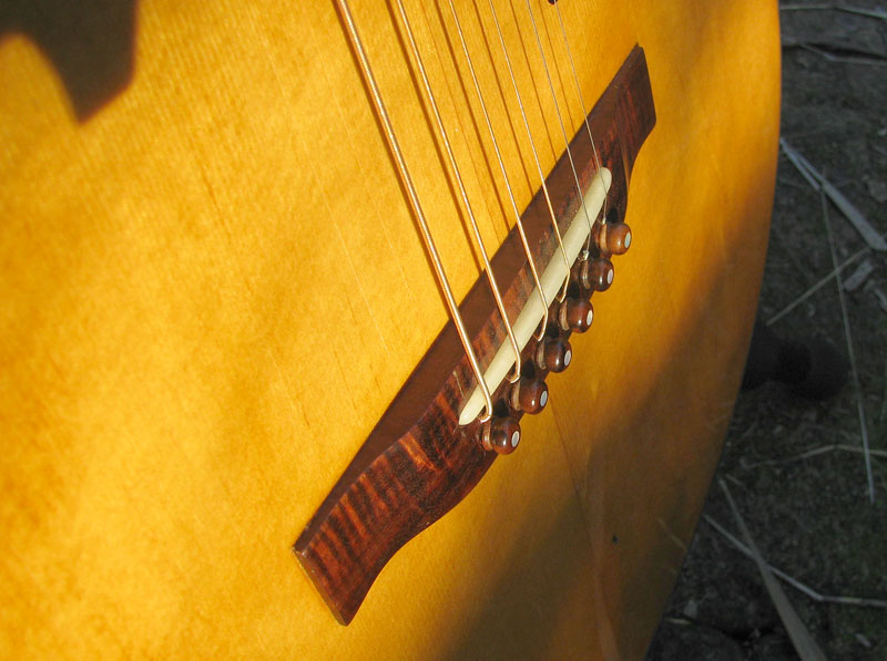

Anyhow here is a copy of that post with an image I uploaded showing that bridge on the guitar. Yes it could be any bridge on any guitar but you will have to take my word that the glue was as old as I say when the bridge was glued on and that this is indeed an image of the same.

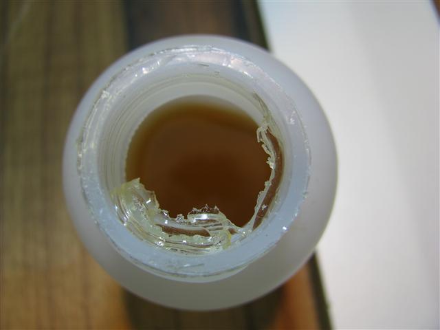

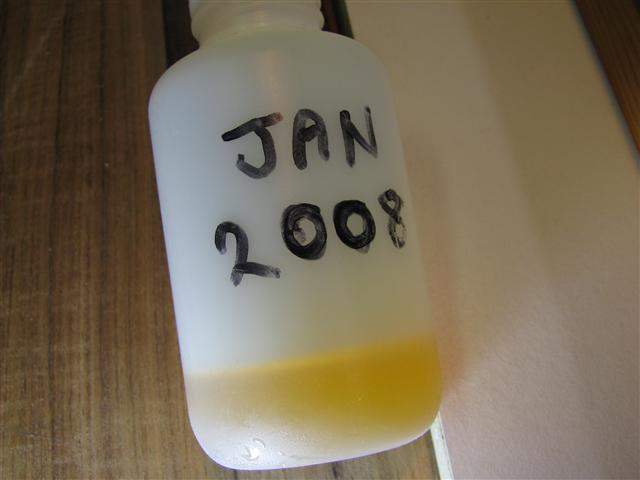

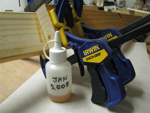

The batch of hide glue in question was first mixed in January 2008. The bridge in the above image was then glued on to the guitar using that same batch sometime in June 2009, which was 17 month later. So here we are today, just over 16 month down the track and now that original batch of glue has reach a fully matured vintage of some '33 months old'. It is still clear, and it smells quite fresh. In fact, as you can see for yourself, it just looks like a nice clear golden jelly in the bottom of the bottle (not much left though).
old glue 6.JPG (29.07 KiB) Viewed 32368 times
old glue 5.JPG (27.32 KiB) Viewed 32368 times

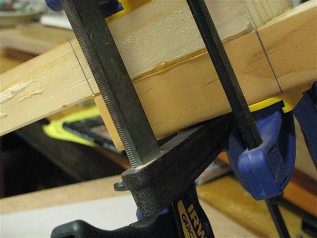

So it it looks and smells OK but how is the bond strength? Well I decided to do a rough and ready test.
I took two lengths of radiata pine, old dry wood salvaged from a single bed that lay in pieces on a kerb side dump day. It is destined to be ripped into stickers for wood storage but was diverted for use in this experiment first. Each bit of pine was 700mm (28") long x 90mm (3 1/2") wide x 35mm (1 3/8") thick and each board was run through the thickness sander to be cleaned up with 80 grit abrasive ready for gluing.
One end of each board was then marked at 100mm (4") forming an indicator for the glue spread area to create a simple face to face glue joint. The 33 month old hide glue was then heated and applied liberally to just one of the marked surfaces. The joint was then bought together, slipped a little to even the spread, and clamped securely to cure.
old glue 1.JPG (48.92 KiB) Viewed 32368 times
Here you can see the squeeze out indicating that adequate glue was applied.
old glue 2.JPG (48.62 KiB) Viewed 32368 times

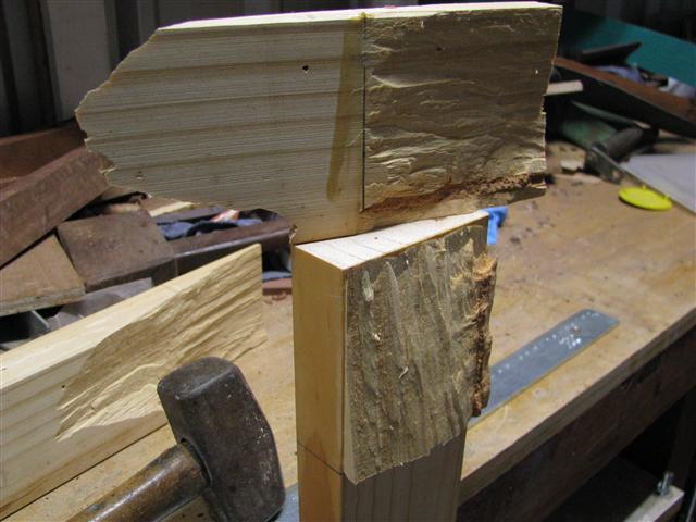

The joint was left clamped for app 8 hours and then the joined pine was placed vertically in a bench vice so that one piece sat low and was well supported by the jaws, and the other presented as a considerable lever with which to apply great force to the glue joint. This was done which resulted in the length of pine which was the lever then snapping cleanly above the glue joint.
old glue 3.jpg (108.96 KiB) Viewed 32368 times
I decided that this result may have been inconclusive as it could have been caused by an unseen fault with in the wood and what I would rather see is 'fibre tear' of the wood at the glue joint itself. I then took a piece of hardwood (jarrah) and placing it at that point which offered the most substantial support just above the unbroken piece, I took to it with a gimpy hammer wielded with unbridled vigorous aggression.

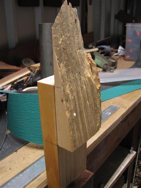

old glue 4.JPG (52.66 KiB) Viewed 32368 times
As you can see I again failed to get any real 'fibre tear' of the glue joint itself. But none the less I think the results are quite conclusive and I would not hesitate to use this same batch of glue to fit a bridge to a guitar again even though it is 33 month old.

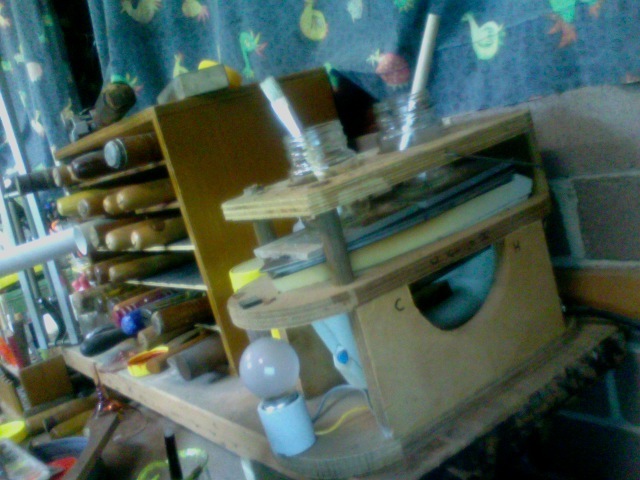

matthew wrote:I use small vegemite jars and an upturned iron and a squirty water bottle and no water jacket and no thermometer and am ready to glue in 10 minutes from scratch.
Matthew, KISS in operation - I like the sound of this. What do you use to dispense the glue? Frank
matthew
Posts: 1193
Location: Sydney, Inner West
Re: Hide Glue: How old is too old?
Post by matthew » Thu Nov 11, 2010 7:58 pm
cheap chinese hogshair paintbrush from the $2 shop with the handle shortened to 10cm.
Fibro pad on the iron softens the heat and protects against spilt glue falling into the iron. Second jar is usually just hot water.
iron set to Cotton.
the lightglobe will eventually be connected to remind me the thing is turned ON. I tend to forget, and a teaspoon or so of glue quickly dries out!
Photo on 2010-11-11 at 19.56.jpg (101.97 KiB) Viewed 32200 times

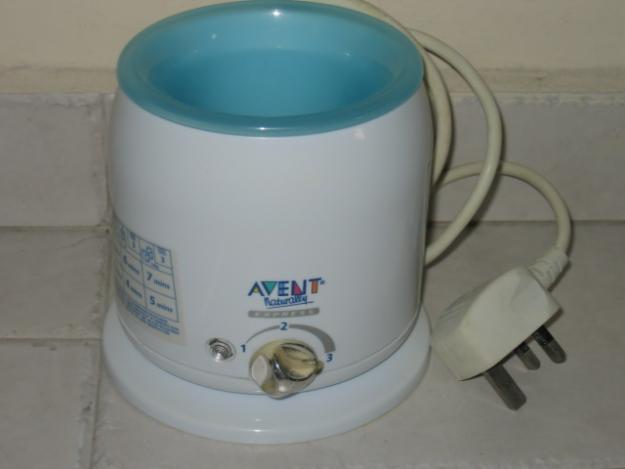

Look for a baby food warmer while you are there, they give great control of temperature and the little bit of hot water they hold to warm the glue is real handy for clean up and they are pretty safe given the target market they were originally directed at...new mums and new babies..could not even begin to imagine the size of the settlement if they screwed up?
Avent is a beauty, look on Ebay at Cashies, or the Op shops.
Mine sits just a tad below midpoint of mark 1 and mark 2 on the dial and cycles happily between 140f and 150f...... perfect!
Post by Lillian » Fri Nov 12, 2010 5:16 am
I have the US version of Kim's baby bottle warmer. It works fine.
Now, I must admit that I'm really liking Matthew's setup. I really like it. Hmmm, I have a warming tray that might just work without needing to buy another iron.
