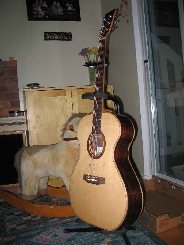

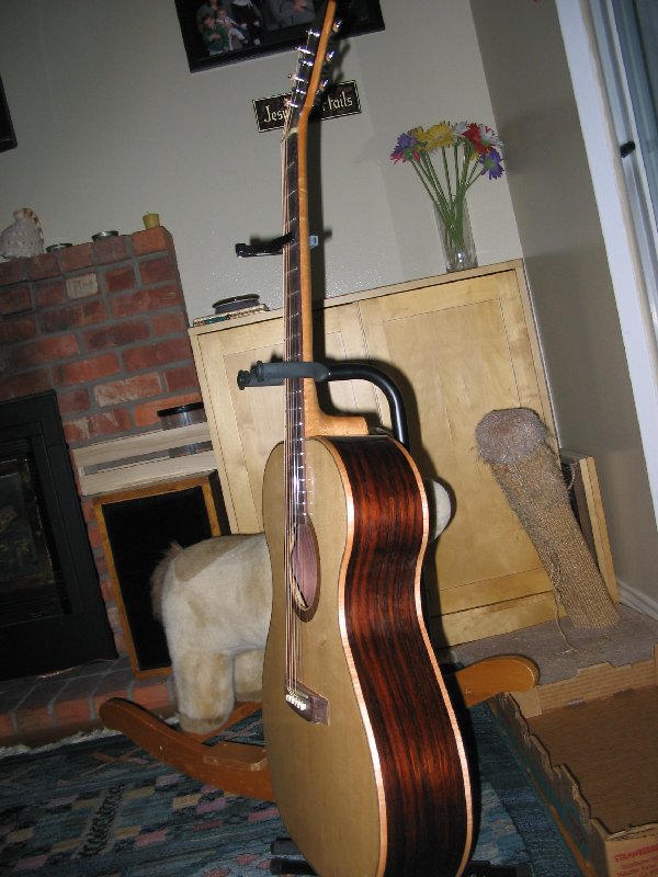

Hi guys --
I meant to post photos of the finished guitar, then the site went down
It has a
sitka spruce top,
IRW back and sides,
a maple neck (flat sawn from the lumeryard -- I don't recommend this, too heavy).
Rosewood fingerboard and bridge.
curly maple binding.
The odd shape is my attempt at design. I won't be doing that again soon. Once I actually know what I'm doing I'll give it another shot. Maybe 5 or 7 years.
It weighs a ton, due to the neck, but it sounds sweet!
