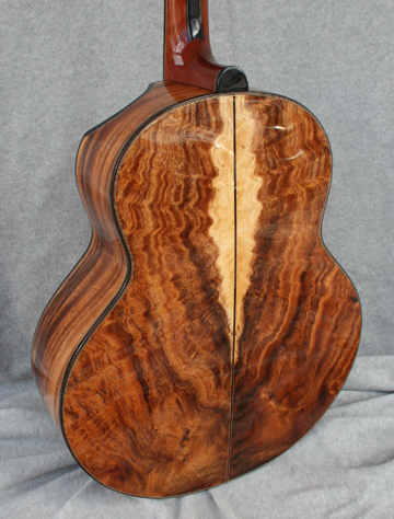

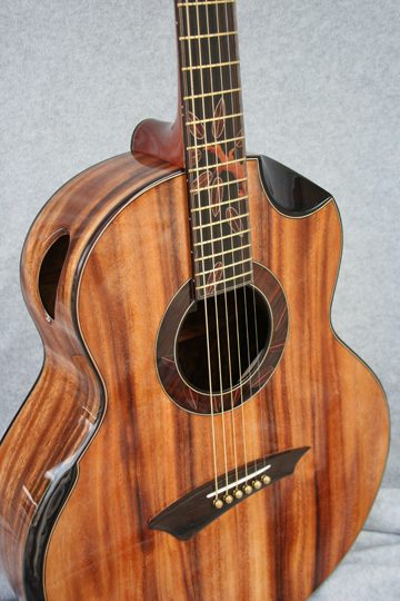

Post by JJ model » Sun Nov 14, 2010 9:28 pm
I've been building with many different wood and it all works well. 8)
Here are some examples.
