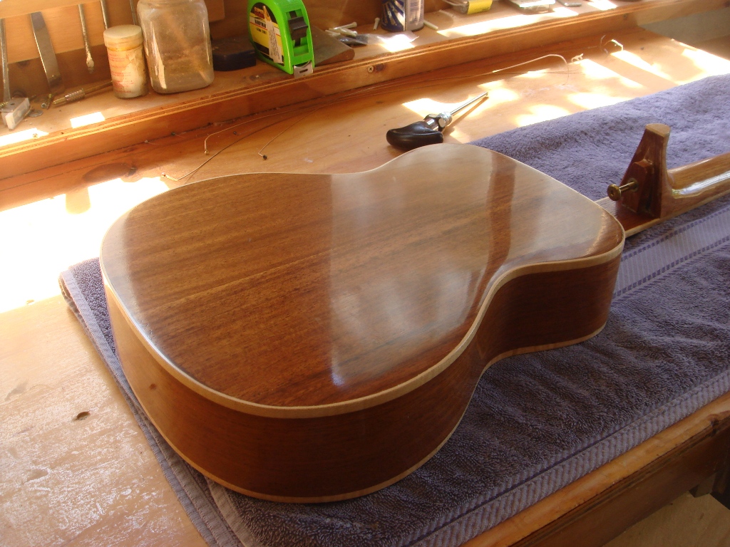

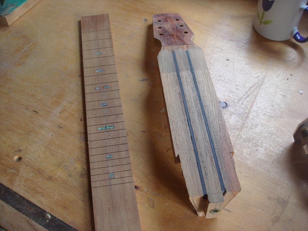

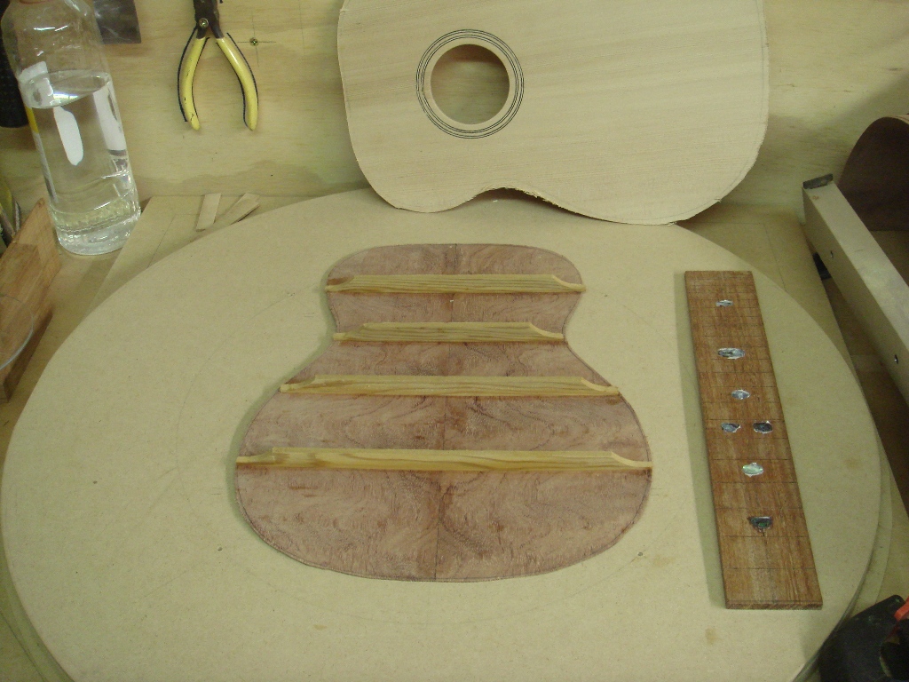

Having made the new neck, I decided I didn’t like it, binned it and then made another. I made a fret board and tried some funky paua inlay – didn’t like that either, so that went into the bin too. You can see why I didnt like the fretboard - what was I thinking?. This pic shows the laminated (almost) back that was.
I made another neck I am happy with, using carbon fibre as reinforcing. And a new fret board

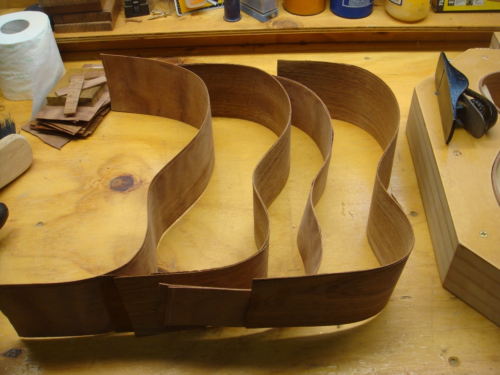

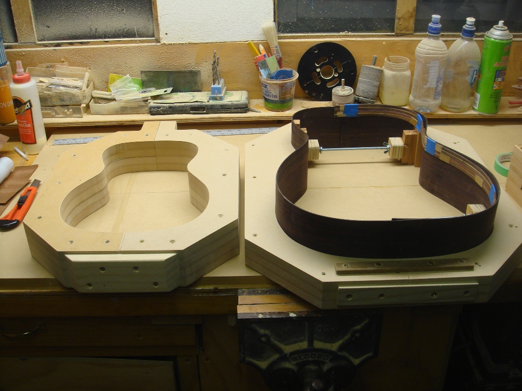

I had bought some kwila in a job lot from a local timber merchant who wanted to get rid of lots of odds and sods he had lying around, and got a trailer load of random lengths and sizes for $100. I was amazed to find a lot of it was sawn dead on the quarter. It was too narrow for normal guitars but was perfect for the mini-OM, so I had my first go at resawing. I put it through the thicknesser and borrowed a bending iron and bent my first sets of guitar sides. I enjoyed that, I dont think I will be laminating again.

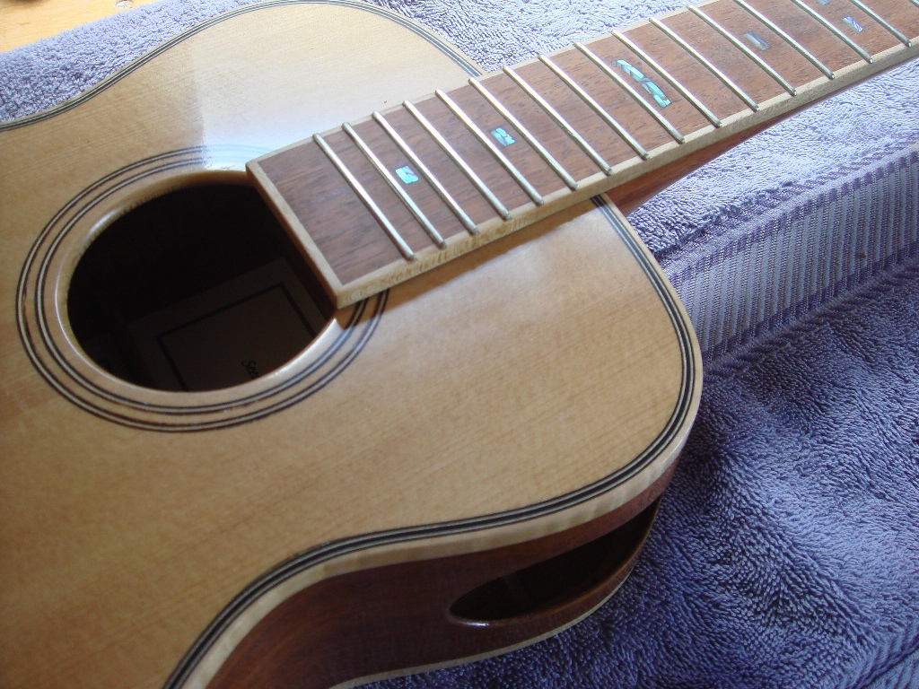

I finally got the back and sides together and made the neck joint (bolted) and glued on the top a few months ago. Yet again, I stuffed up the bindings and they are too big and not tight in the waist in one place – I think building a small guitar is actually harder than building a big one.
Anyway, after a bit of scraping and sanding, I was able to put some lacquer on it and last week I finally got the bridge on – in the wrong place! I noticed just in time to get it off again and it is now in the right place with intonation checked and OK, but with a blemish on the soundboard where I removed the finish in the wrong place.

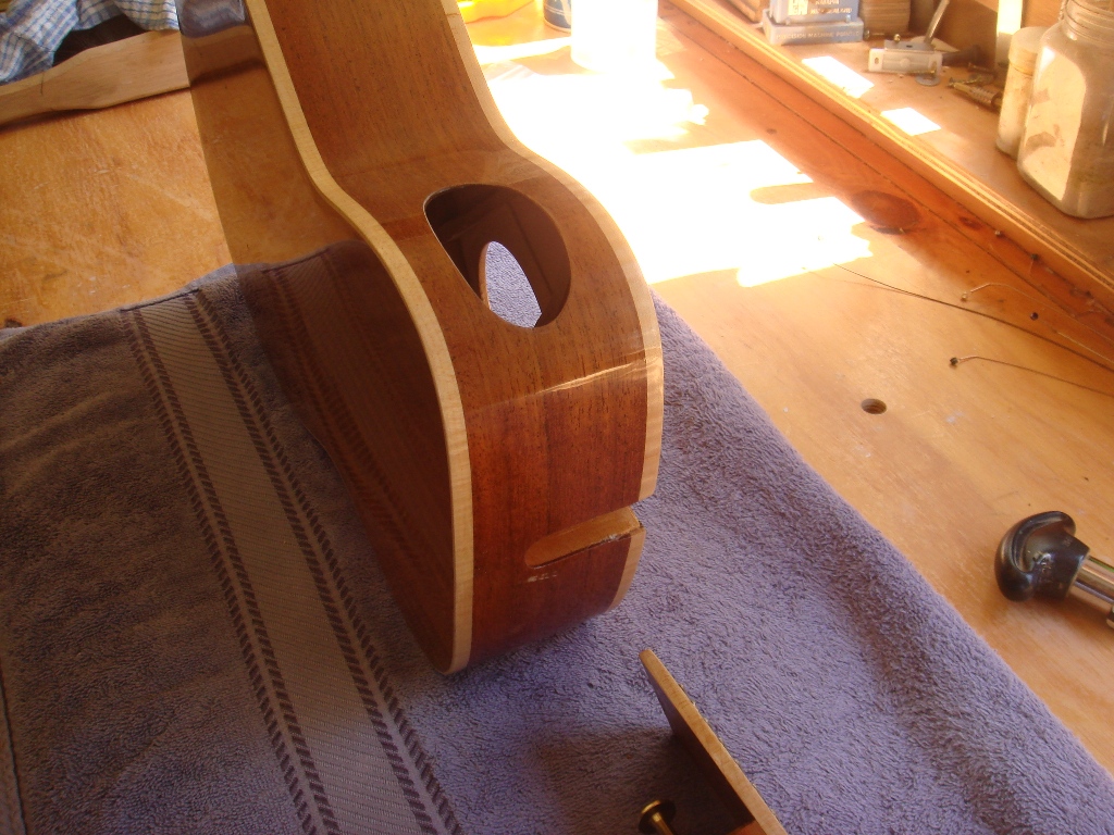

Lefty sound port!!
Kwila back and sides and bolt on neck joint -I really like the colour of the kwila
Close up of the top, binding and soundhole. You can see where the binding is not tight at the waist - I still dont know how that happend as I had a clamp across the waist. I had so much tape across it that I didnt see it until it was too late. I just didnt have the heart to take the binding off again!
