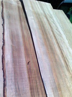

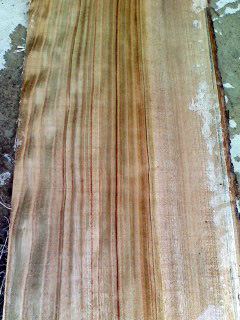

Re: Camphor Laurel inquiry
As promised I have cut some veneers from the centre billet of a very straight camphor laurel log. I thought it best to get stable straight grained quarter sawn material. I'm not sure that the smell is a big problem. In my experience it leaves the wood to a large extent after sawing. If the timber is enclosed in a blanket box the smell is strong but if it is left exposed it fades away.
regards
regards
