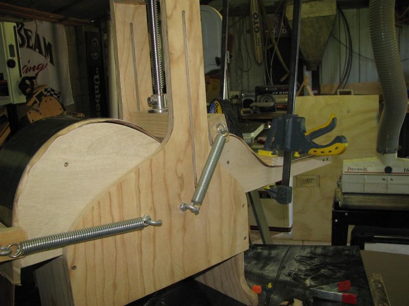

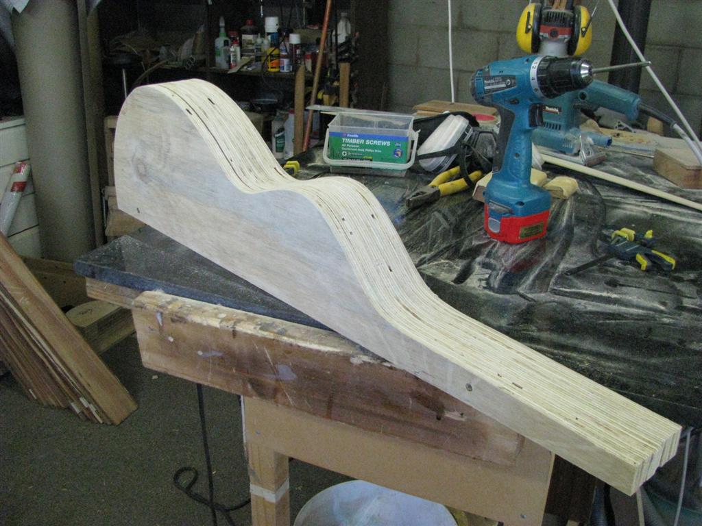

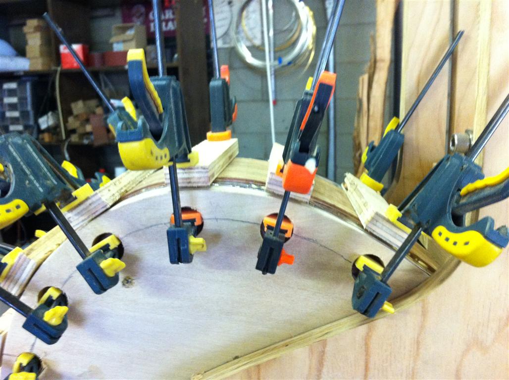

Here are the first pics of the completed mold and almost complete side bending form.

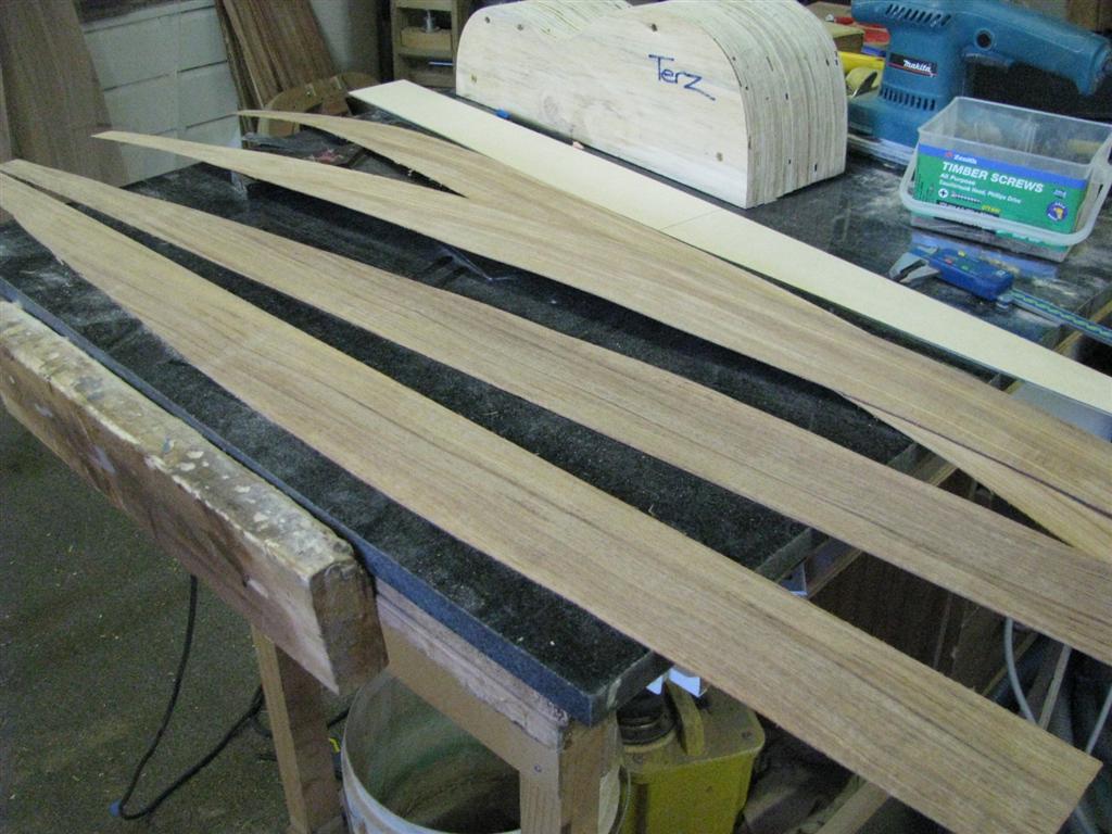

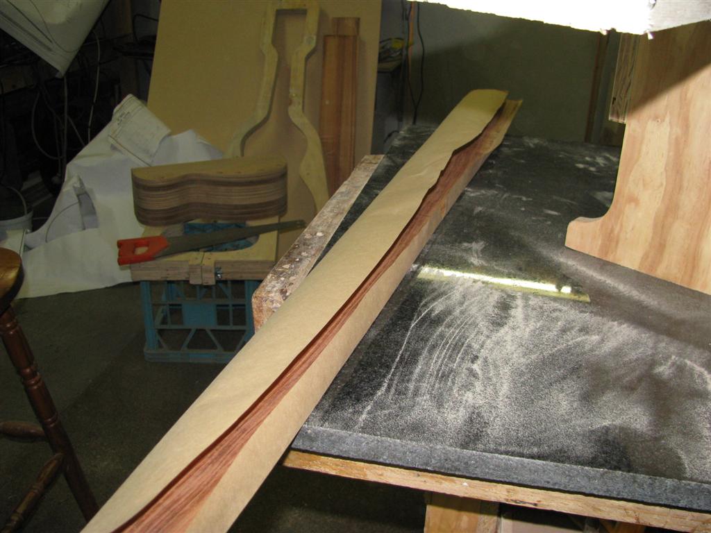

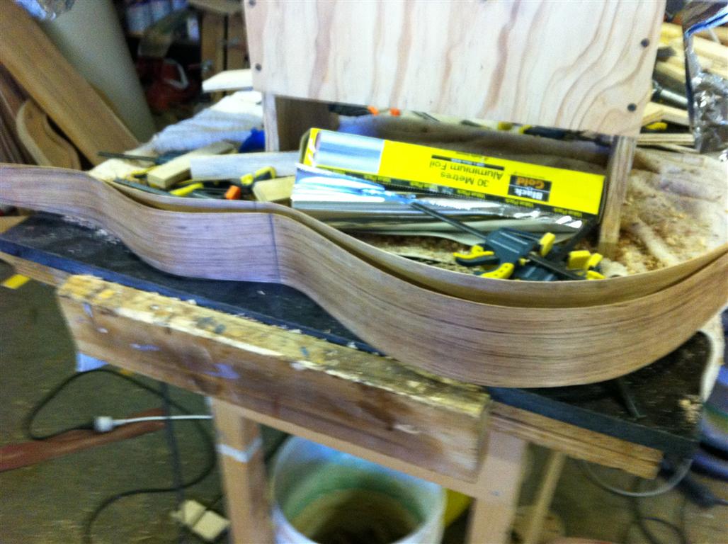

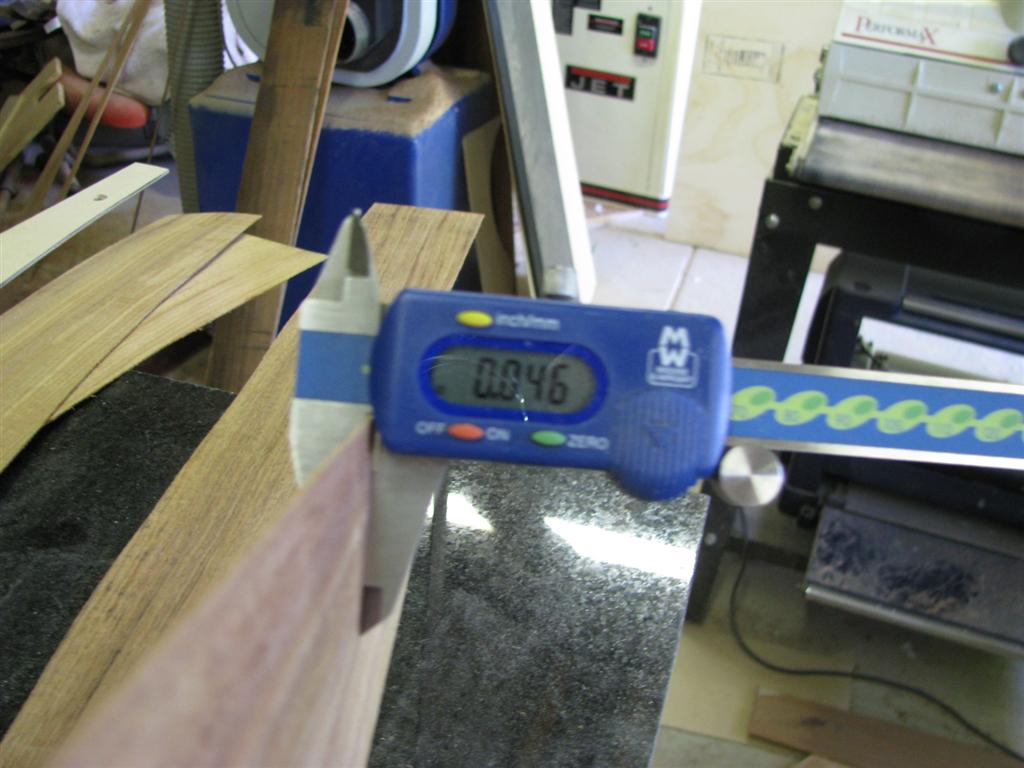

I got the side bending form finished today so I thought I'd better bend some sides.
On the last couple of instruments I've built I left both laminations at aroung .070" so the sides were a very hefty .140". It certainly adds some weight to the instruments.
I decided to make these around .045"
Being so thin and flexible I saw no need to spray them with water so I wrapped them in paper and bent them dry. They actually didn't hold their shape that well but I expected that (being so thin). Once they are glued together they should be fine.
I've stopped using the thermostat on the heating blanket and don't bother with the thermometer any more. Plug it in, start the bend at 3.5 minutes and make sure you are finished at the 5 minute mark. Unplug and allow to cool. Pretty simple eh.

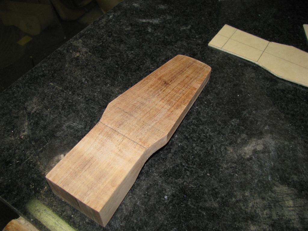

Also made a start on a headstock.

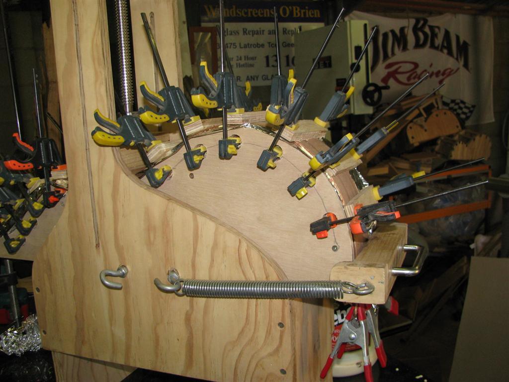

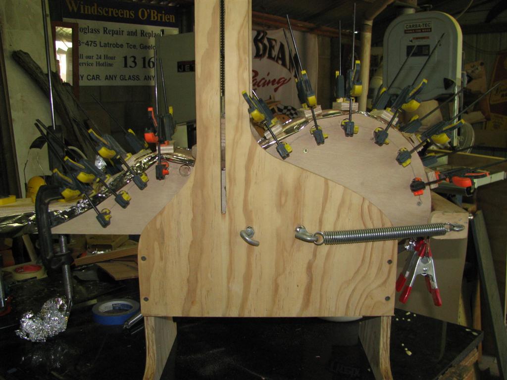

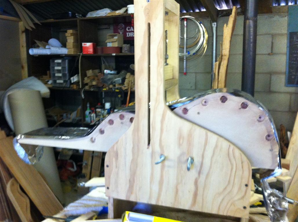

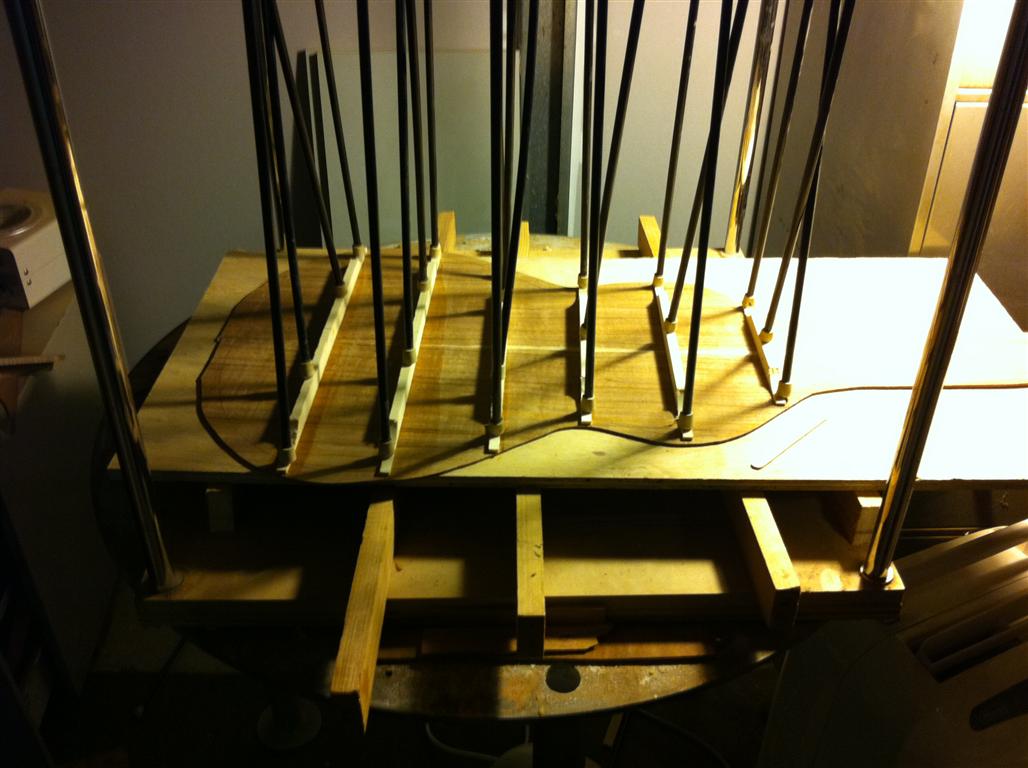

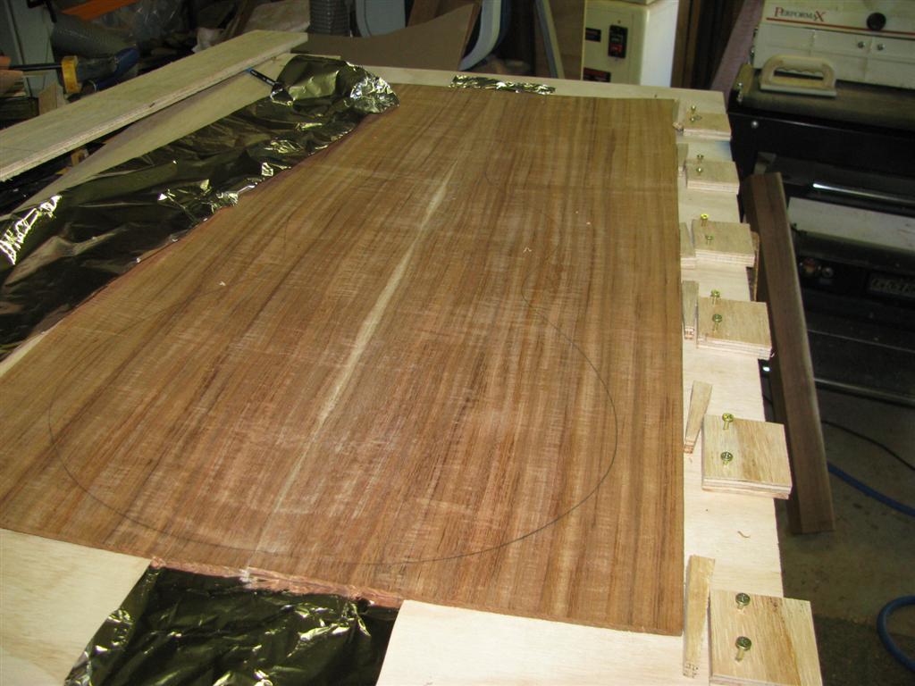

I did some work today glueing one of the sides together. Photos aren't too flash as I only had my phone with me but they're good enough to give you the idea.
I have a vacuum setup but I haven't finished building it. When I do I'll use it for glueing the side laminations together but for the moment I'm doing it this way.
I drilled a heap of holes on the side bending mold with a hole saw.
Here are the sides ready to be glued. I know that a lot of builders in the US use epoxy for this step but it's messy, not that good for your health and I reckon Titebond does just as good a job. These sides at .040" were really floppy and didn't hold their shape coming out of the sides bender so it'll be interesting to see how they are when I take them out of the mold.
I laid a double layer of tinfoil under the sides so they won't stick to the mold and you can see why I drilled the holes in the mold.

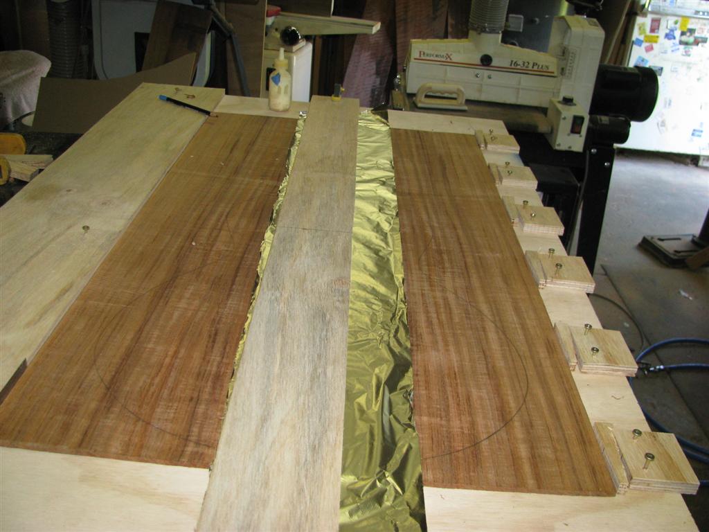

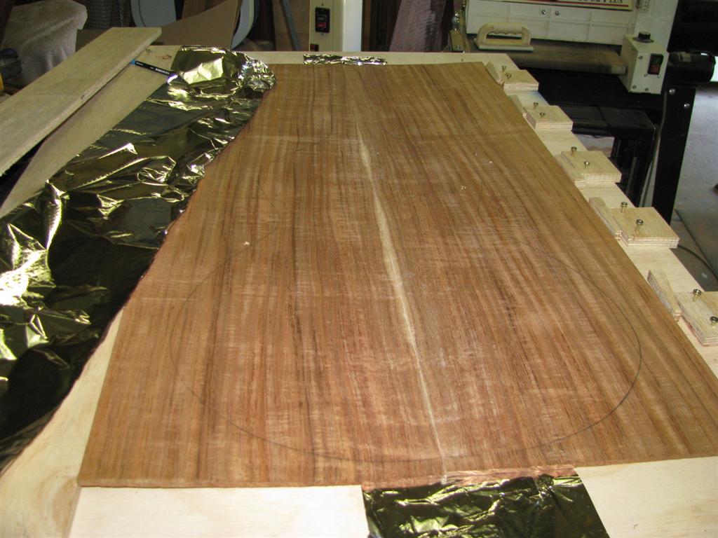

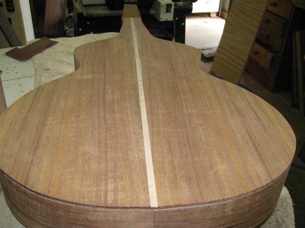

Joining the back. made up a rough jig to do this as my normal one isn't long enough.

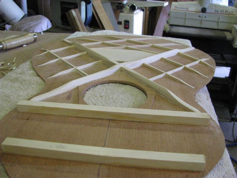

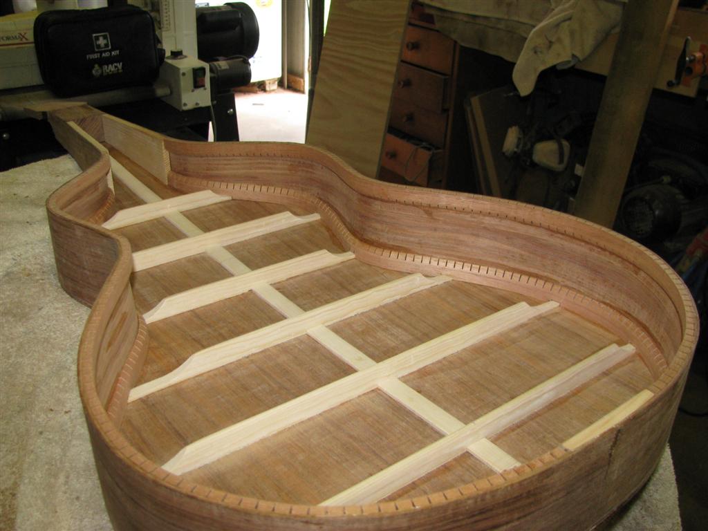

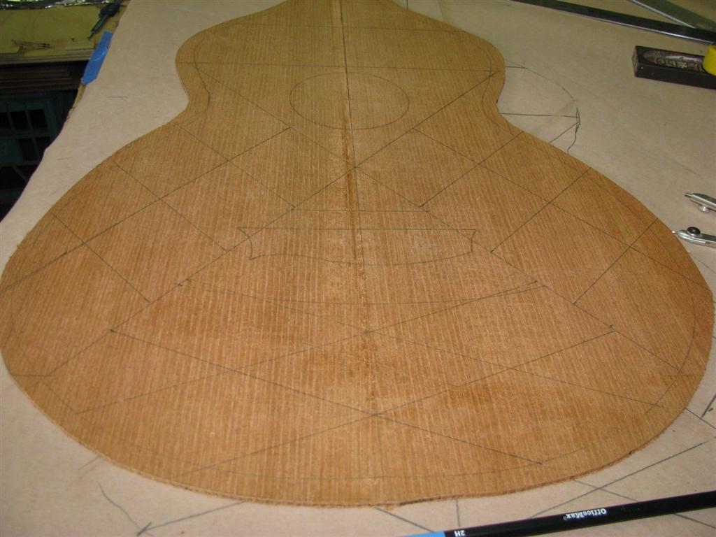

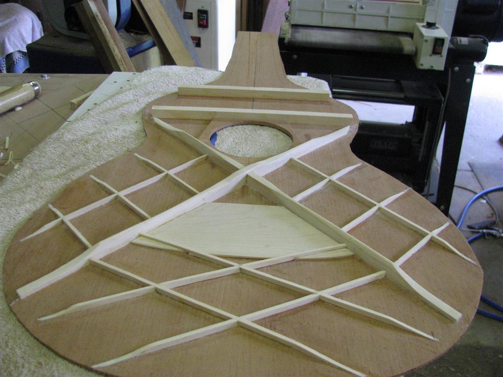

I've got the top marked out ready for braces. The X braces will be 8mm x 12mm. The other braces in the lower bout will be 3mm x 5mm.
I've shifted the centre of the X-brace south by 12.5mm and tightened the angle on it a bit so the wings of the bridge will sit over the braces.
The top itself is 2.4mm thick.

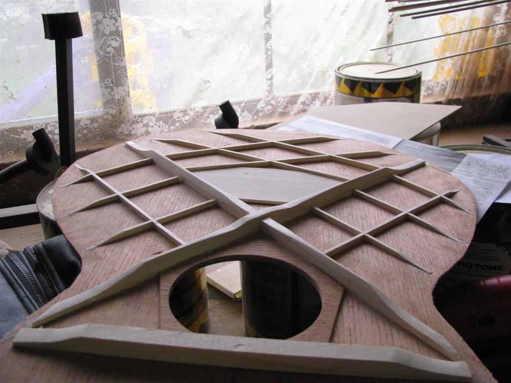

Re: Weissenborn Copy Build
Yes Dave the area where the finger braces usually live will have the intersecting lattice type brace. These braces are very delicate - only 3mm x 5mm but they are very stiff once you glue and cap them. This top is also not that stiff once I got it down to "fighting" thickness. It is very light and not at all like a hardwood. It actually reminds me more of cedar. It's my first one so I really don't know what to do or expect with it. Considering the bracing I've seen on the plans of the originals I think it might be OK.
It will have the soundhole patch, which I now use on all of my instruments.
I've been looking at your extra X brace in the area above the soundhole and I'm thinking I will do something to beef up the bracing in that area. I was going to cap the upper transverse braces with carbon fibre but as I don't have any at hand and I'll probably be wanting to glue the top on over the next weekend I'll probably do something different. Just haven't quite decided what yet.

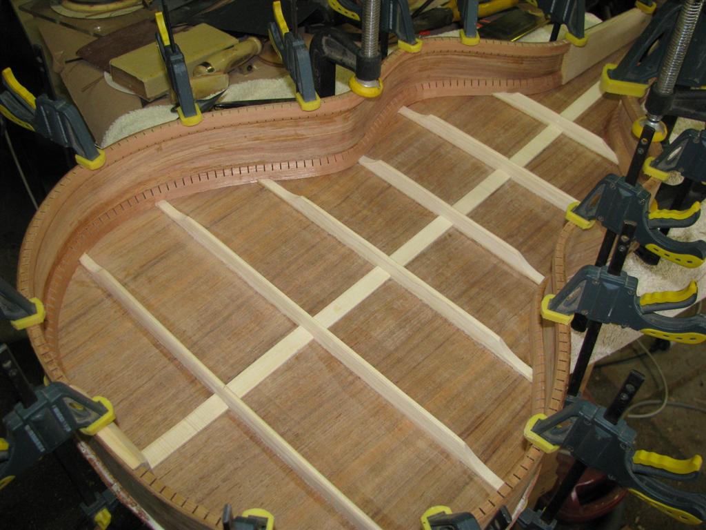

On go the back braces.

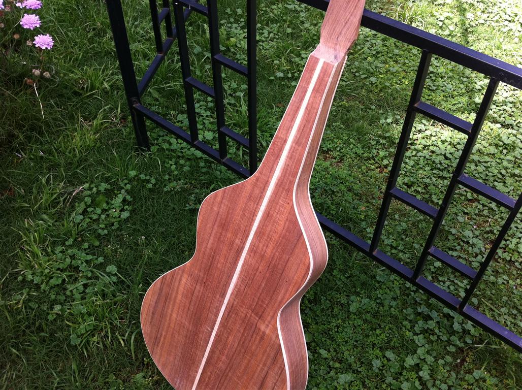

OK. Back's on.
The sides are so stiff with the double lamination and reverse kerf lining that I decided to glue outside of the mold.
These are the first of the pre-made Spanish Cedar linings that I bought from Bob C and I must say it was a pleasure not to have to make the bloody things
The centre strip as Blackwood as well. The same stuff that Steve Kinnaird is using on his King Billy OM.

G'day Bob,
Looks real good mate! Did you arch the back on this one?
- Bob Connor
- Admin
- Posts: 3132
No arching Alan, everything is going to be flat, top included.

This what the bracing ended up looking like.

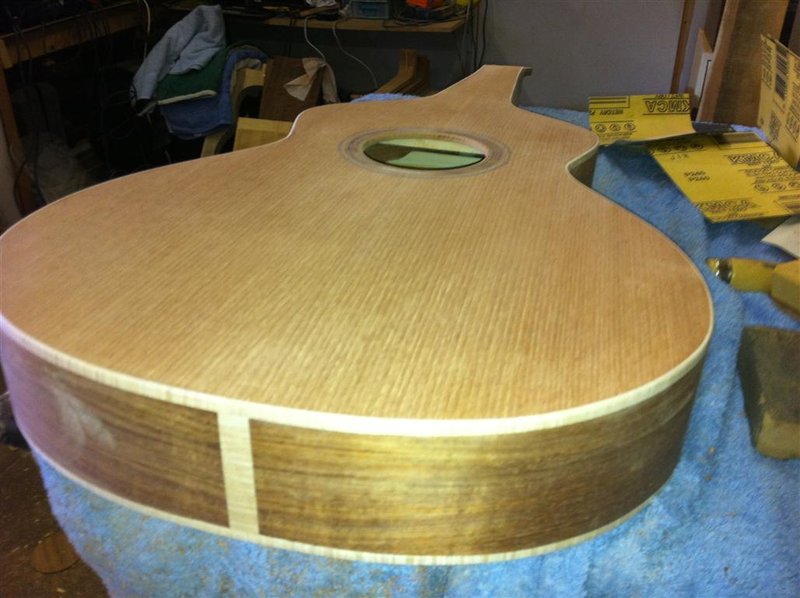

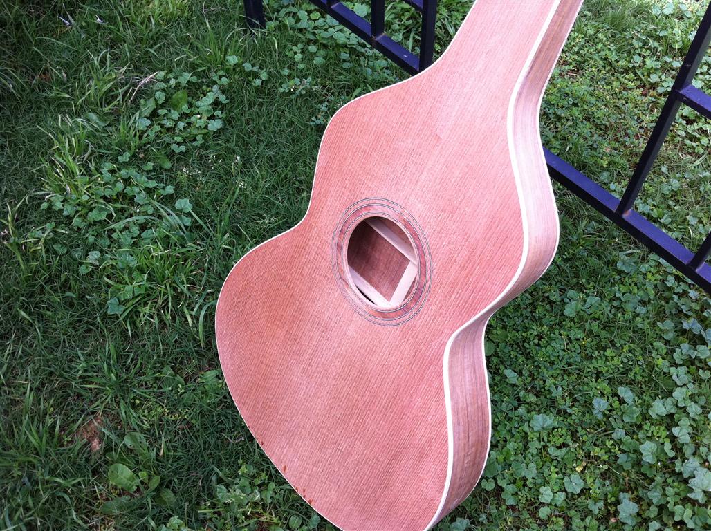

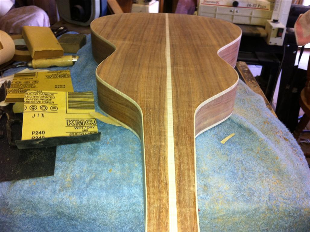

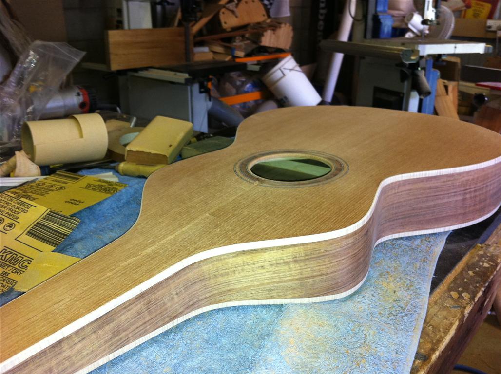

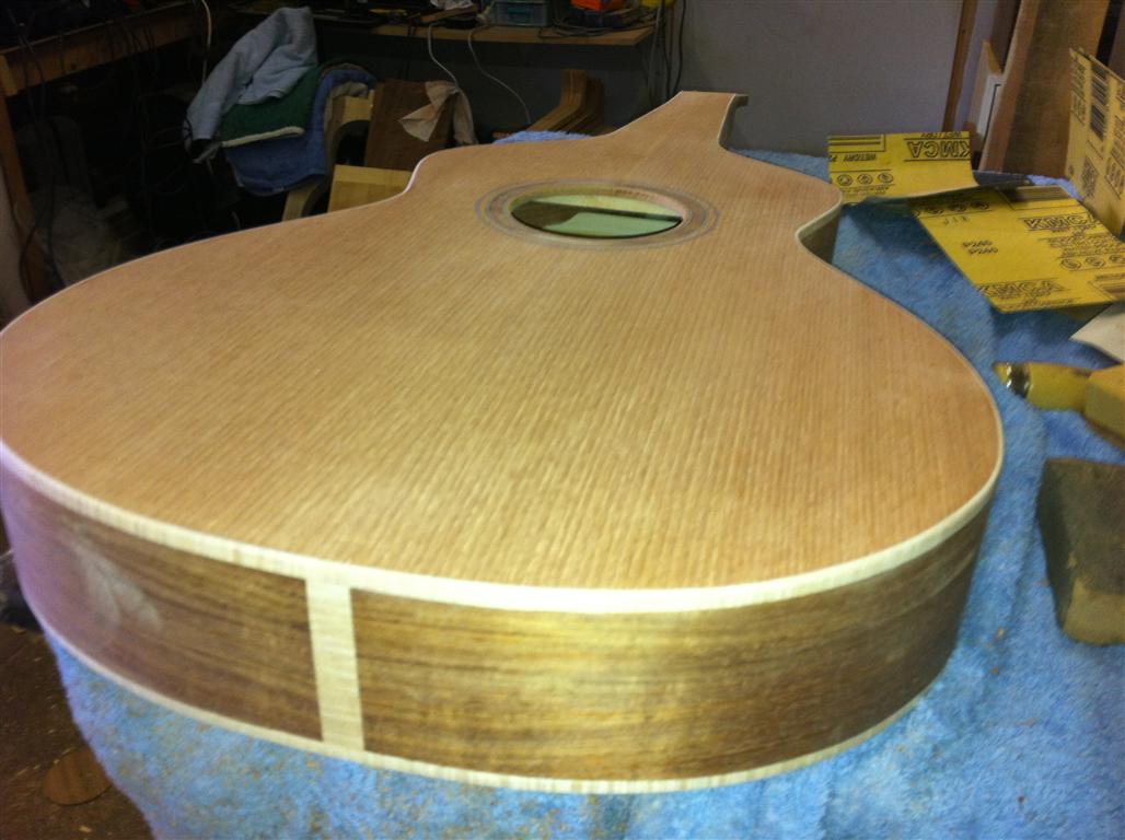

Top and back are on and the bindings completed.
I'll be pore filling in the next couple of days John.
That Surian has pores like the grand canyon so I'll let you know how I get on.
I did put some shellac around the soundhole when I was putting in the rosette and it came up a lovely golden colour, a lot different from the pinkish tinge it's got now so I'm hoping that the Z-poxy will give it a nice vintage looking vibe.
