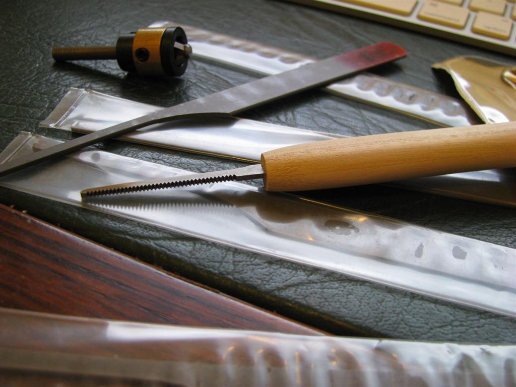

Well then Kim, looked what arrived from Uncle Stewmac today.
The new ramp files and saws plus the bridge pin hole contersink bit.
The new saws look great much better than the old Stewmac bridge saw.

Yes Bob, spotted this kit myself in the recent stewmac catalogue. Planning to lash out for this, as well as the reamers I asked about the other day....and a couple of other things of course, to make it all worthwhile!!!
Frank
Frank

Let us know how the Stewmack saws and files perform Bob. I am currently using jig saw blades ground down for ramping. Works fine on the treble strings but a bugger on the base.
Cheers Maurie
Cheers Maurie
