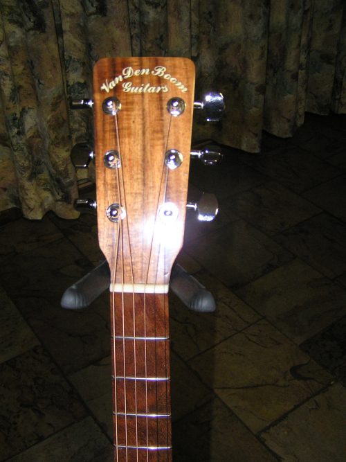

I have used a vinyl decal for my headstock logo for the past 10 guitars which I sourced from O/S. It's simple as you can see, but under lacquer, I like it and want to keep using it.
Does anyone know of an oz supplier that could do this?
I am not really interested in water slide decals - I have tried them but could always see the feint outline of the backing transparency.
Otherwise it's back to O/S supplier!!
Frank
I need a new supply and have been trying local suppliers but the couple I have tried have a go but can't do it. The black line edge around the letters and fine nature of the characters are the issue.Does anyone know of an oz supplier that could do this?
Frank
