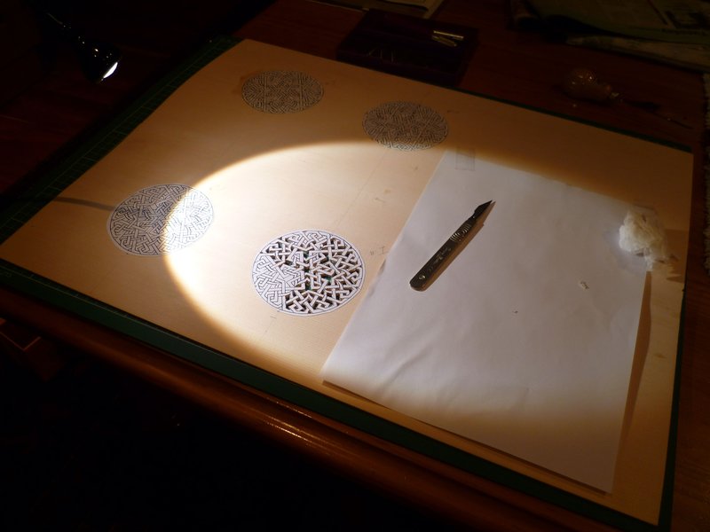

Today I got started on some practice runs for the cutting of the lute rosette. The rosette is cut directly into the top so there's no margin for error. I aim to use a variety of cutting tools on the practice rosettes and work out which one suits me the best. In the pics below Im using a No 10A scalpel blade. The rosette drawing is glued to the top of the top and a circle of paper is glued underneath to reinforce the area around the rosette.
Re: Lute Progress - Test runs for cutting the rosette

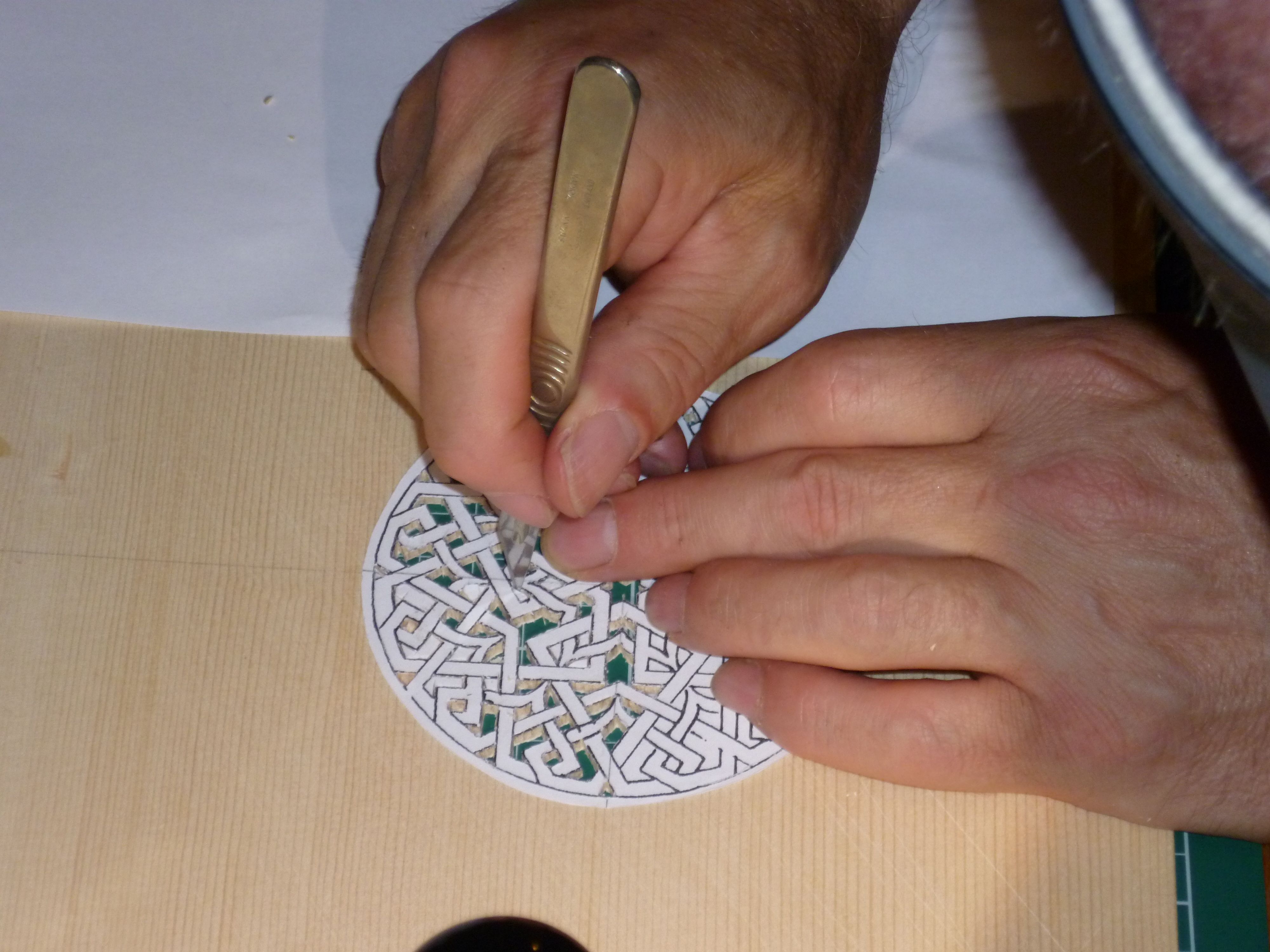

Looking really promising there Martin. Are you changing the scalpel blade regularly or have you done all that with the same blade? Of course once you've carefully gone through & cut all of that, as Kim pointed out, you've then got to go through & clean up the cuts/edges without breaking anything....just to cheer you up
I imagine that if it did split you could wick in some CA, is that a viable/recognised repair or is the top basically a throw away? Fairly good looking bit of practice wood you have there too or is that a bit of arsewipe spruce? (Can you tell by all these questions that I'm fascinated by this?

CA will stain spruce a piss yellow....vitamin "B" piss yellow at that Nick.
Better to not break it but would imagine that a bottle of HHG would be nice to have sitting ready in the warmer.

Lovely work Martin. And good on you for having the patience for a practice run!
I have an article somewhere by Lyn Elder about cutting rosettes where they mention doing the first stabbing cuts from the underside into a cork backing piece, and leaving the paper glued to the rosette as well to support the thing a little more. then you turn the thing over and clean up the cuts and do the 'weaving".
Also mention wetting the spruce a little to help the cutting.
I'll scan it for you tonight.

The scalpel blade lasts for one quarter on the rosette and then I change it out. The spruce is some of Graham Heins Engleman. As Kim correctly points out CA glue will stain the spruce. Splits can usually be fixed up with hide glue.
The key yo avoiding splits is to have the rosette reinforced on the underside with the paper and also to work on a cutting mat. Order of cuts relative to grain direction must also be addressed. Most importantly one must fight the urge to push out the cut outs until all the cuts are done.

Matthew,matthew wrote:Lovely work Martin. And good on you for having the patience for a practice run!
MT
Lundberg does his cuts from the underside similar to Elder. Lundberg also stiffens up the spruce with shellac or varnish after the cuts have been made and before clean up.

Hey Martin are you using the scalpel to cut all the way through the wood or using a jewlers saw to cut the areas out and following up with the scalpel for clean up?
Looks like a good job for some nice tunes and and maybe a glass of something to ease the nerves.....
I'm using a scalpel to cut all the way through....I've got a variety of blades here so am finding which one is the best for the job.
A glass of wine is probably not the best thing to have at end during a rosette cutting job.....I actually got into major trouble with a scalpel during a binding job last year and the root cause was alcohol in the workshop. the workshop is now a booze free zone.
