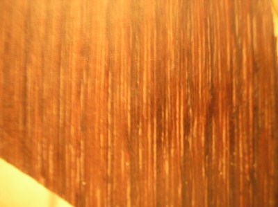

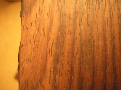

I tried a few drops of tobacco brown Trans tint in a bit of the rosewood Timbermate and it worked very well. The pores came out a very dark brown.
Here's the fill with just the Timbermate rosewood ... And here it is with the tobacco brown added to the filler...Much better!
Some said the finish will darken it and some not so I'm taking no chances. This works fine for me.
Thanks for all the replys.
