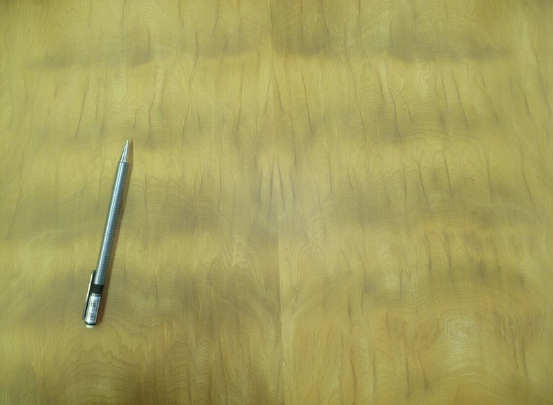

I probably should be posting pictures to some of my restored posts, but I confess I've gotten myself immersed in a couple of new project guitars, including one with swamp kauri backs and sides. I managed to get some chunks of "white bait" figure and sliced up 4 sets of backs and sides. This is the first time that I've worked with swamp kauri and it's proving to be something of a surprise.
I have never worked with wood that was so hard to work, and yet floppy like cardboard. I used the thinnest set off the saw for this current guitar, and the back is only down to 0.130", but feels floppy as hell. It's going to be an OM size. I'm seriously wondering if I should be laminating this or something to stiffen it up.
Anyone out there having experience with this stuff -- Christian? Does one have to leave swamp kauri seriously thick, or am I in the ball park thicknesswise even with "normal" bracing?
Have never convinced myself that I really like ancient kauri, but being 30 - 40,000 years old makes it very "cool" and of course very "kiwi". This guitar is something of an experiment that I promised I would do if I ever got my hands on some pretty wood (and there's enough material left for 3 more). From the pic, which is only sanded to 120, you can see the little "white bait" swimming through waves.

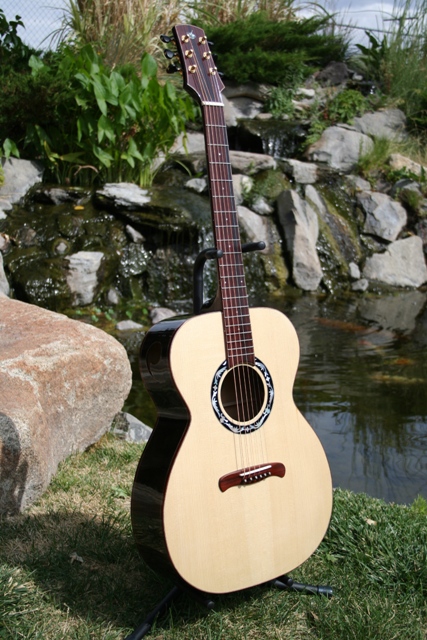

I built an OM from ancient kauri and adirondack last year. This was a very interesting experience, like you I thought the tap tone was lifeless and dull. However when the instrument was finished it was remarkable, it had sustain on top of sustain. The instrument eventually sold and the new owner absolutly loves it. I had it back in the shop for final setup work after 6 - 8 months and had to agree with his opinions. It had opened up and was a wonderful, resonant guitar.
I wish I still owned it! Oh well, I can always build another one............

Hi Tim,
You have there a very nice set of Whitebait Ancient Kauri, i say Ancient because the difference in age between Ancient and Swamp kauri is huge. Both can be used to produce great looking and great sounding instruments but only a small percentage of the wood is suitable.
don't be worried about your thickness it is fine.
It feels floppy because of the grain orientation, whitebait only appears when the boards end grain is running almost parallel to the face, yours looks like its somewhere inbetween which is great cause you will have a bit of flame too.
your choice of guitar size is perfect too, I think it works best in the smaller models. I can concur the sustain is amazing.
I would urge you to have a bit of a practice bending the stuff as in my experience highly figured Ancient Kauri is notoriously difficult to bend, especially tight venetian cutaways.
look forward to seeing the progress of it,
our Aussie friends will be very jelous indeed when they see this wood come alive.
if you need any further advice i'm more than happy to help.
happy building Tim !!!!
cheers,
Christian.
