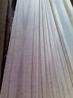

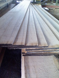

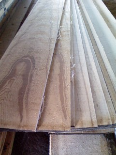

Pics of some Paulownia as promised.
Paulownia 3.jpg (24.96 KiB) Viewed 22841 times
Paulownia 1.jpg (22.68 KiB) Viewed 22841 times
Paulownia 2.jpg (26.21 KiB) Viewed 22841 times
These pieces are 350mm x 10mm backsawn for surfboard laminations. I will photo some quatersawn boards next time I cut some. This log was 16 years old with a centre diameter of 67cm.

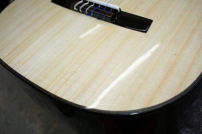

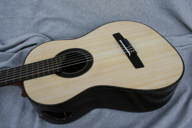

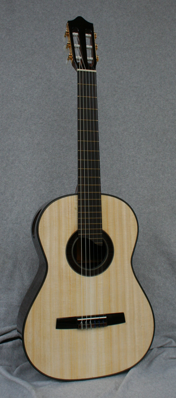

Hi Guys, here are some pictures of my Classical with Paulonia Top and MBW B&S.
Sound better than my spruce version!

Hi JJ ,
Thanks for those pics , that's a nice looking Guitar , Is there different species of Paulowinia and do you think the density varies depending on where it grows, You've convinced me to try some In a flamenco . Thanks for your feedback .
Paul.

I think there are quite a few variant depending from where its grown , I got mine from China ( plentiful! ). Ya, I want to make a flamenco too with it!
