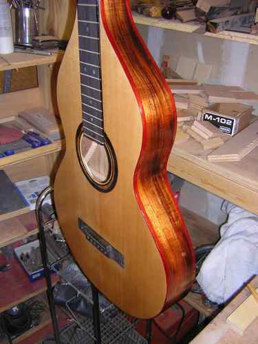

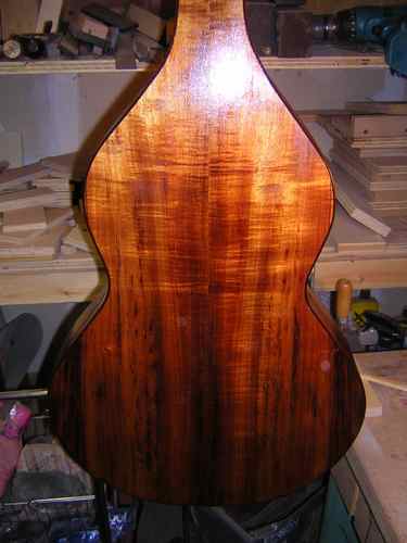

Another weiss builder
Ha!
25 foot radius.
Bad build.
Gonna keep it fer meself!
Pretty from a distance!
Oh, first coat.
Brushed!
25 foot radius.
Bad build.
Oh, first coat.
Brushed!
- DSCN1642.jpg (20.47 KiB) Viewed 7895 times
- DSCN1639.jpg (23.65 KiB) Viewed 7895 times

Looks pretty bloody good in the images Alan but its how she sounds that counts the most. String the bugger up and give us a listen..

Hey Kim, that's my first coat, so I got a while to go.

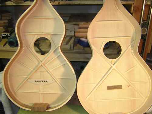

Which bracing plans did you follow or is it your own design?
It looks pretty good to me.

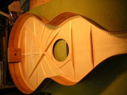

Anyway, I took the stew mac plans, and loosely based the bracing from that.
Those plans called out for 3/8" x 3/8" for the x.
So I made them 9/16" x 5/16" roughly.
Tapered.
Also eliminated the lower bout brace, and other stuff.
In the pics, the git on the left is the koa one, the right is a maple back and sides.
You can see where I'm changing it around a bit.
The one that's alone in the pic is the koa one.
Setting up my bridge pins while the back isn't on yet.
Tapered.
Sweet!
- DSCN1583.jpg (16.83 KiB) Viewed 7824 times
- DSCN1585.jpg (19.55 KiB) Viewed 7824 times
