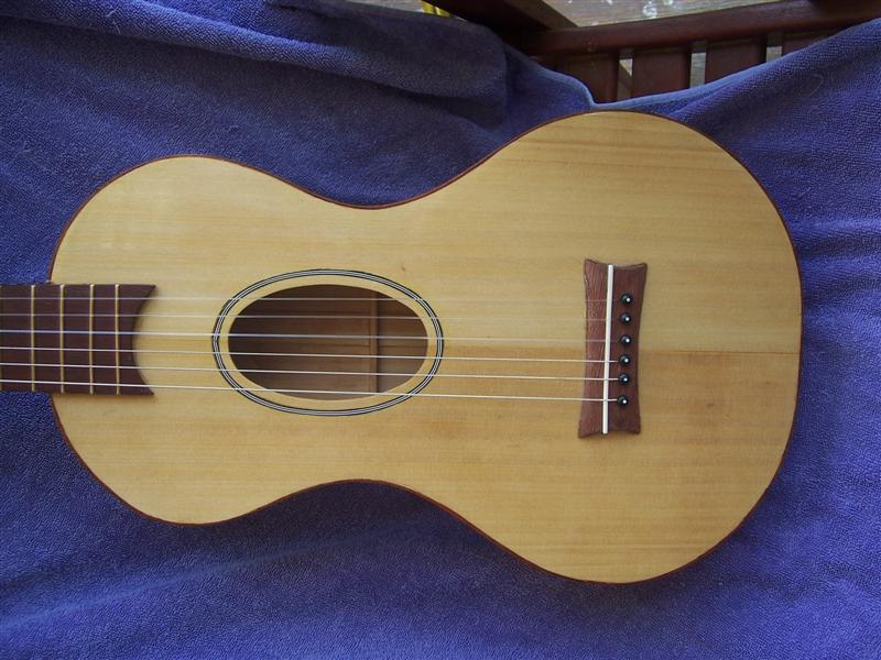

I built a parlorish guitar after La Prevotte with a Kauri top. I left it a 2.2mm and it sounded great.
100_3427 (Medium).jpg (82.42 KiB) Viewed 8226 times
